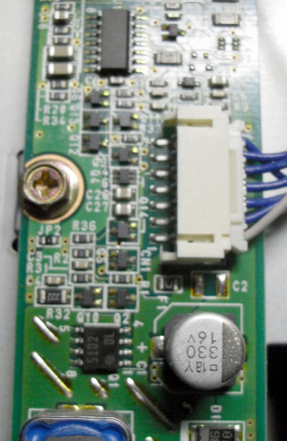

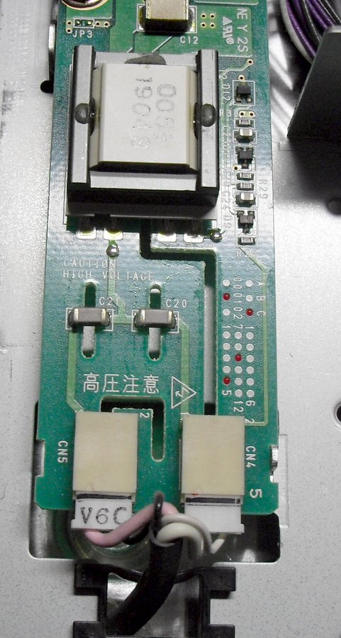

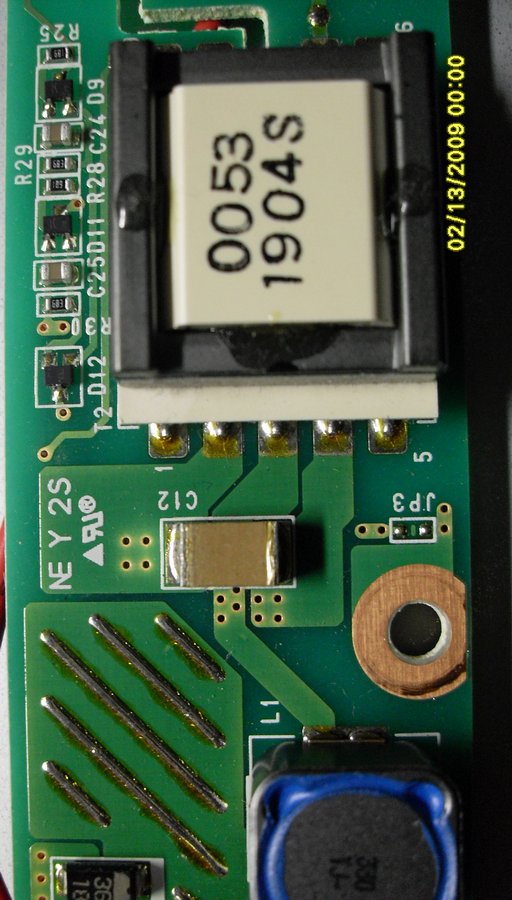

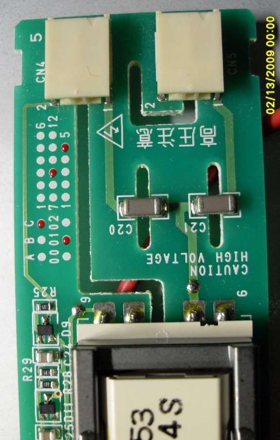

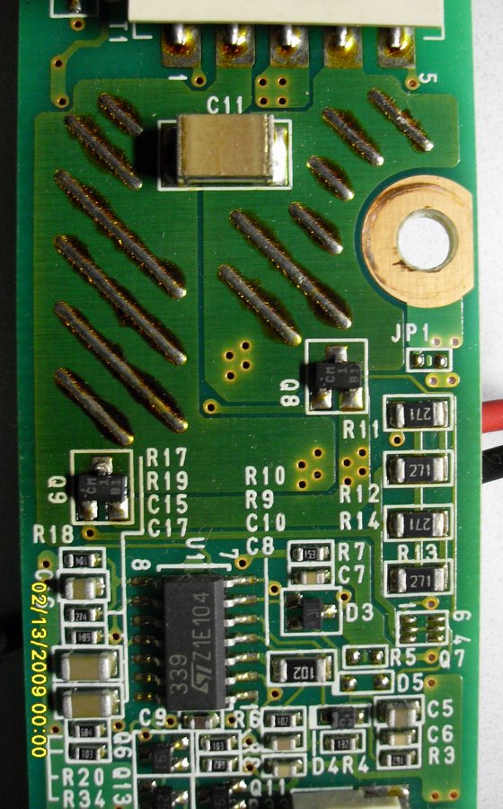

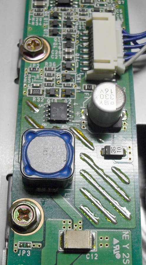

    Looking around the forums for an answer to my problem, I found none, so here I go.
    I got a NEC 1830 from eBay, stated that powered on but black screen. I bought it just because $25.00 shipped for a 18" is not that much and would be a very didactic experience. Well, my didactic experience is quite bad so far.
    I found a thread in another forum regarding this specific monitor. Then, on another page, I found references of the same monitor, same problem (inverter). It is signed "Cheers, Wizard", so maybe it is the same Wizard in this forum (hopefully, so he can give me some advice).
    So far, I've tried the resoldering of R11~R14, and C11 & C12. Measuring the Rs in question , all but R12 measure 268~272 (R12 measures 202Ohms).
    If I check Q8 & Q9, I get continuity on all three pins (shorted?). Then if I measure resistance on C11 & C12, I get 0ohms (shorted also?).
    If I turn on the monitor and turn on the lamps with my lamp tester, the monitor works OK (except maybe the issue with the PSU, that humms when in standby/no signal)
    Any advice (besides throwing the inverter to the dumpster) would be greatly appreciated.
    --- I posted pics of the whole inverter, but in sections, for it to be clearer ---

            Re: NEC Multisync 1830 XtraView - Dead inverter
            Reason this particular failed is the transformer shorting out and pumping low output in one of transformers and shuts down.
            I use scope with probe 10x set and volt/div .1 and around 20uS sweep for sine wave. If one transformer is low amptitude than other then is busted. I don't have to probe directly, I lay side of the probe against the ferrite core where halves meet. Works well on flyback and SMPS transformers since I can't hear very high frequencies so this scope is what I visiually check.
                The most likely reason that the transistors(Q's) and caps are reading 0 (zero) ohms is that they are across the transformer coils. Tough to short those caps as they (from what I've read) are the ceramic chip type and in the in the picofarad range. (1uf = 1,000,000pF)
                Also, try reversing the probes of your ohmmeter when you test a suspected component. Many meters present enough voltage/current when testing on the low ohms setting to forward bias (turn on) diodes and transistors. You get a reading one way, but when you reverse the probes, you get nothing or a different reading than the first one.
                Are the fuses good?
                If you power it up, does one transformer get warm and the other stays cold?
                Toast
