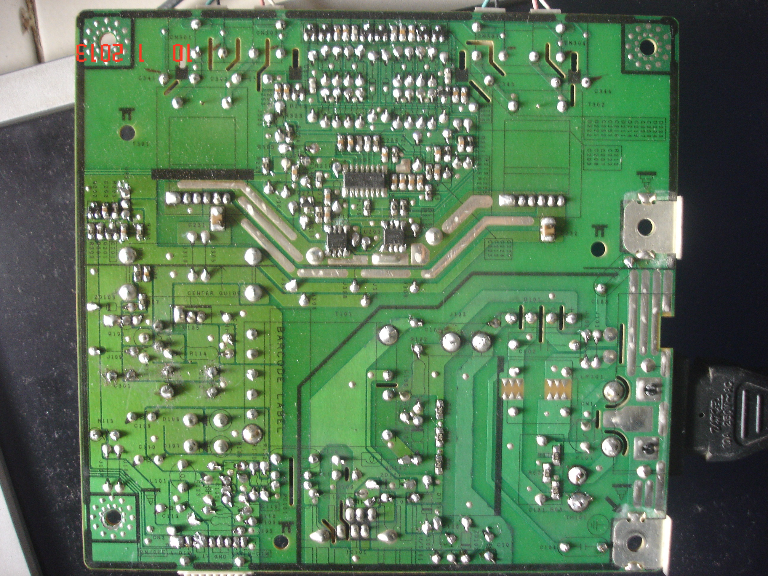

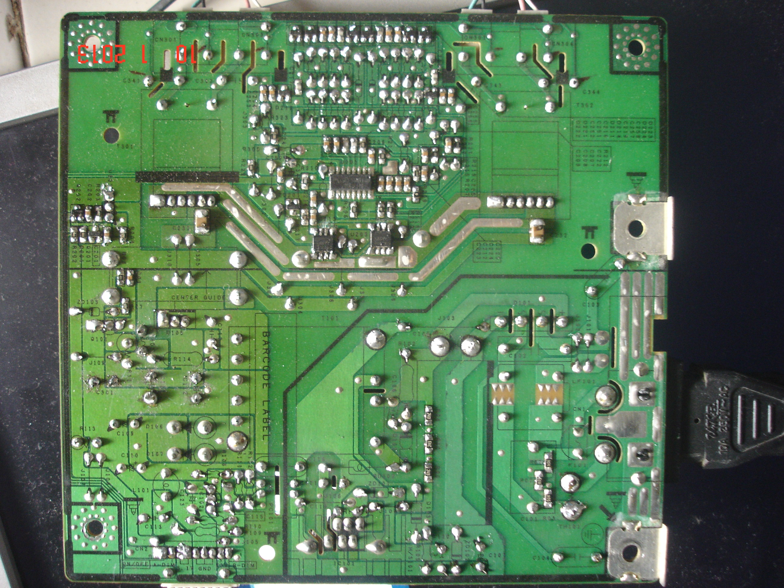

                #387
                Re: Problems with Samsung 740N monitors
                Today I re-soldered all the remaining joints. Now when I did a cold start (after all the soldering)...the backlights remained on for an hour or so.
                But again the flickering resumed. Although now i notice the flickering is less frequent.
                Am attaching new pics of the solder side of the board.
                Next I plan to physically check the lamps.
                Please advise if any other checks need to be done to reach the core issue.

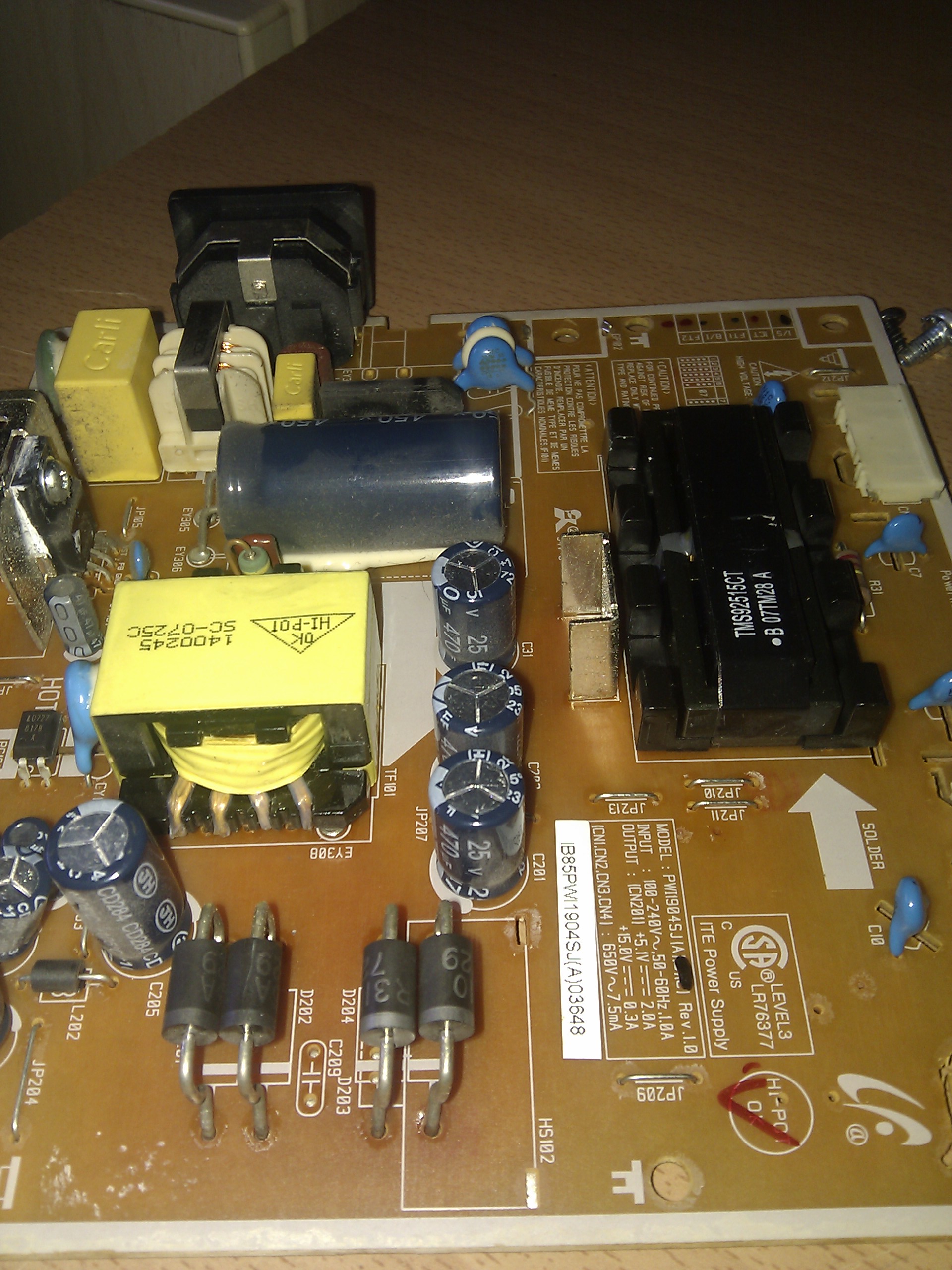

                  this is a pretty old thread but thought i would add to it. i have a syncmaster 930b, with the same board that everyones having capacitor troubles with (ip-35135b). the monitor made a buzzing noise, the backlight dimmed and i just got around to taking it apart to take a look. on the board the 2 8-pin mosfets going to the inverter transformer looked like they had a tiny hole burned through the center. when the monitor died it let out the fried electronics smell but since i waited so long to look at the problem the smell was long gone. i just ordered a new set of mosfets and am waiting for them to arrive and hope that fixes the problem. after reading all these posts im surprised the caps weren't swollen. the 820uf caps are samxon branded and the 1000uf caps are capxon branded. im starting to think i should preemptively replace them. im also curious why the mofsets just burned up in the first place, these things shouldnt burn up if the circuit was properly designed. i tested the resistance on the transformers and the readings on both were nearly identical. anyway thought i would share my experiences here since this forum gave me some insights
                  oh and i only find 1 fuse on the board labeled f101, cylinder shaped orange thing in line with the ac plug. i looked where everyone says the pico fuse is and i never found it. everything else on the board seems to be working fine though, i still see an image on the screen when i hold a light up to it. would be strange if they didnt include a fuse on this board but might explain why the mosfets blew
                  and 1 last edit. i just looked more closely at the 820uf samxon caps and the top isnt flat, its kinda of pushed out a little so im thinking it will be a good idea to replace these
                  • Behemot
                    • 4845
                    • CZ
                    #389
                    Most likely Samxon GF, their only bad series I am aware of. Replace on sight. Samxon GT is good substitute. Other than that, I source Chemi-Con KY's from Digi-Key with 20 mm height.
                                the ones i ordered were 565-1553-ND from digikey. chemi-con KY series 25mm height (hopefully theyre not too big) i figured they would be a suitable replacement, since the ones were a bit bulged on top i figured wouldnt hurt to replace them, i would at least like to get a little more life outta this monitor even though i bought it used, and for cheap.
                                • bowlofpudding
                                  • May 2013
                                  • 4
                                  • usa
                                  #396
                                  just got the 25mm height caps today, test fit them and theyre too big by like 2mm. they hit the top of the cage. probably shouldve done my homework before i ordered. so i guess ill be looking for the same caps but at 20mm height

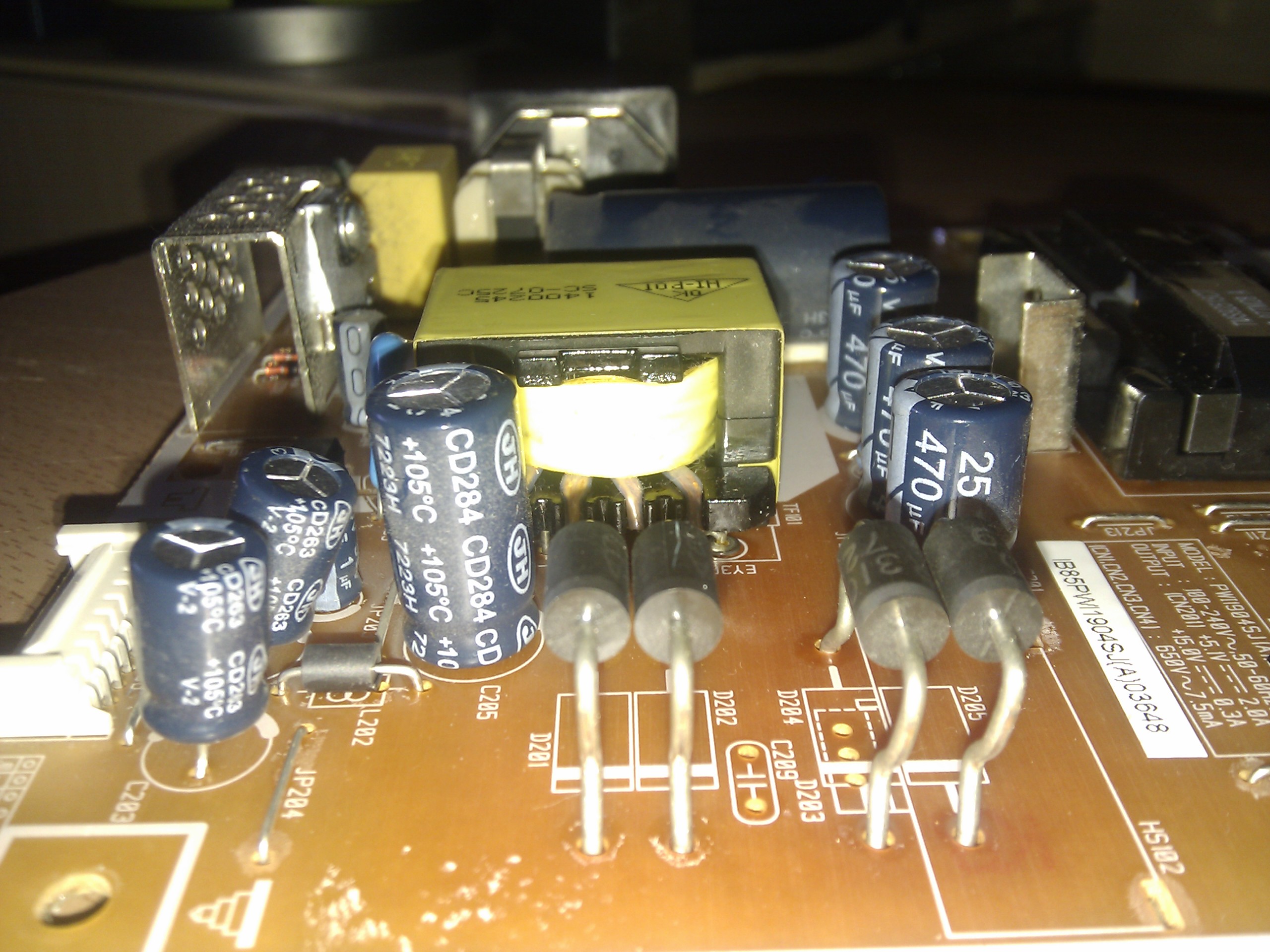

                                        Hey guys,
                                        Am i the only one that has this powerboard in my Samsung 740N?
                                        See the attached pictures. The caps seem fine and are labeled 'JH'. What should I do? Does anyone knows what this board is and if it has the same problems with the common ones?
                                        Thank you
                                        • Rtech
                                          • Jul 2010
                                          • 1095
                                          #400
                                          The TMS Inverter transformers do fail,you need to check the secondary resistance of them
