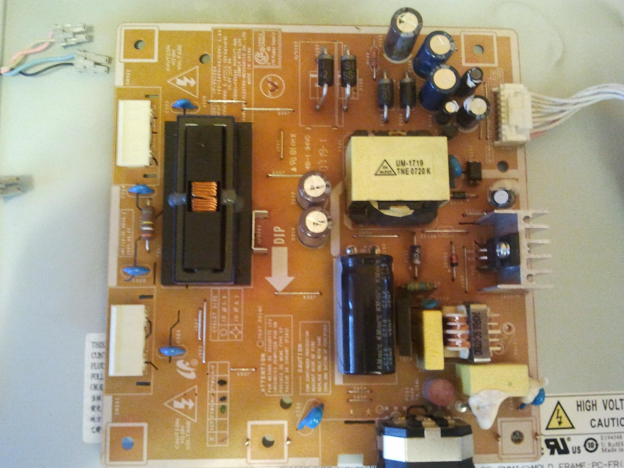

              Hello all,
              stumbled upon this thread and forum while fixing a 740N for a friend.
              As usual opening it showed 2 cap's 1000uf 10VDC blown up. Changed them just now, and the monitor turns on to stanby. Glad i fixed it, i put it to my pc to test it for a few hours.
              than i saw what i didnt see at first. the monitor lights up, and after 2 secs kills the lams. the picture works but dark. i shut the monitor off, turn it back on, same thing happens.
              i'm going to open it again tonight, and search for that blasted 3A fuse i didnt know about, BUT... if the fuse isnt working, should the light come on for 2 secs than shut down?
              any ideas on whats going on ?
              ty in advance
              md
              p.s. i'll be scrolling thru these 15 pages slowly today, to see if i find my answer, so if its there soz for asking
              p.p.s. the capacitors that i put on are 1000uF 16V instead of 10V
              'till all are one.

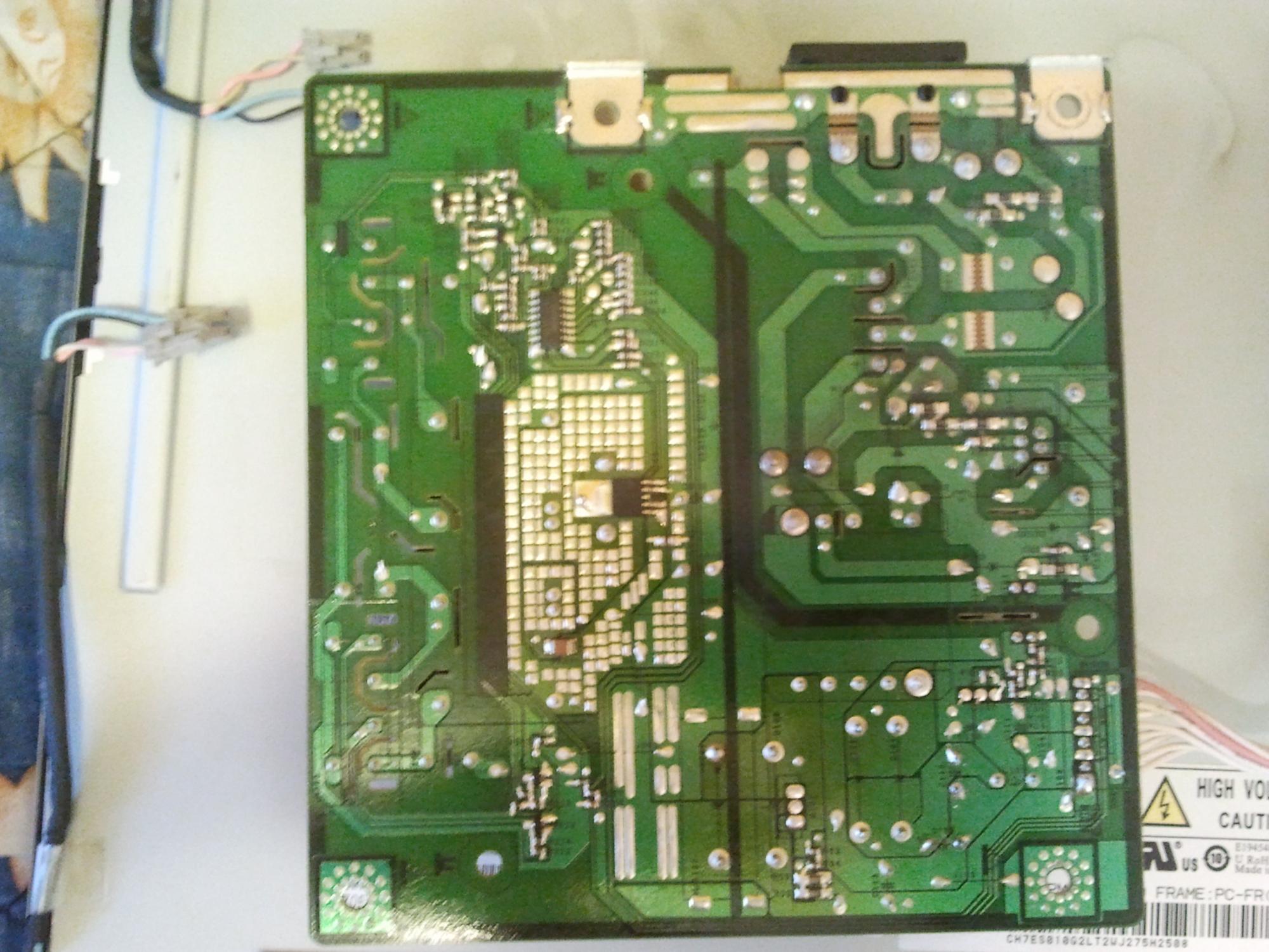

                  #328
                  Re: Problems with Samsung 740N monitors
                  hello, and thnx for the welcome.
                  It's a definite yes for 2 seconds to black.
                  i'm reading the guide now.
                  I do have a multimeter.
                  I'm upping the pic's as i have not seen this ver of psu board here yet (still browsing the thread tho)
                  i have changed the 2 blue ones that are in the pic
                  alas the pics are not the greatest, as i only have access to my galaxy s camera...

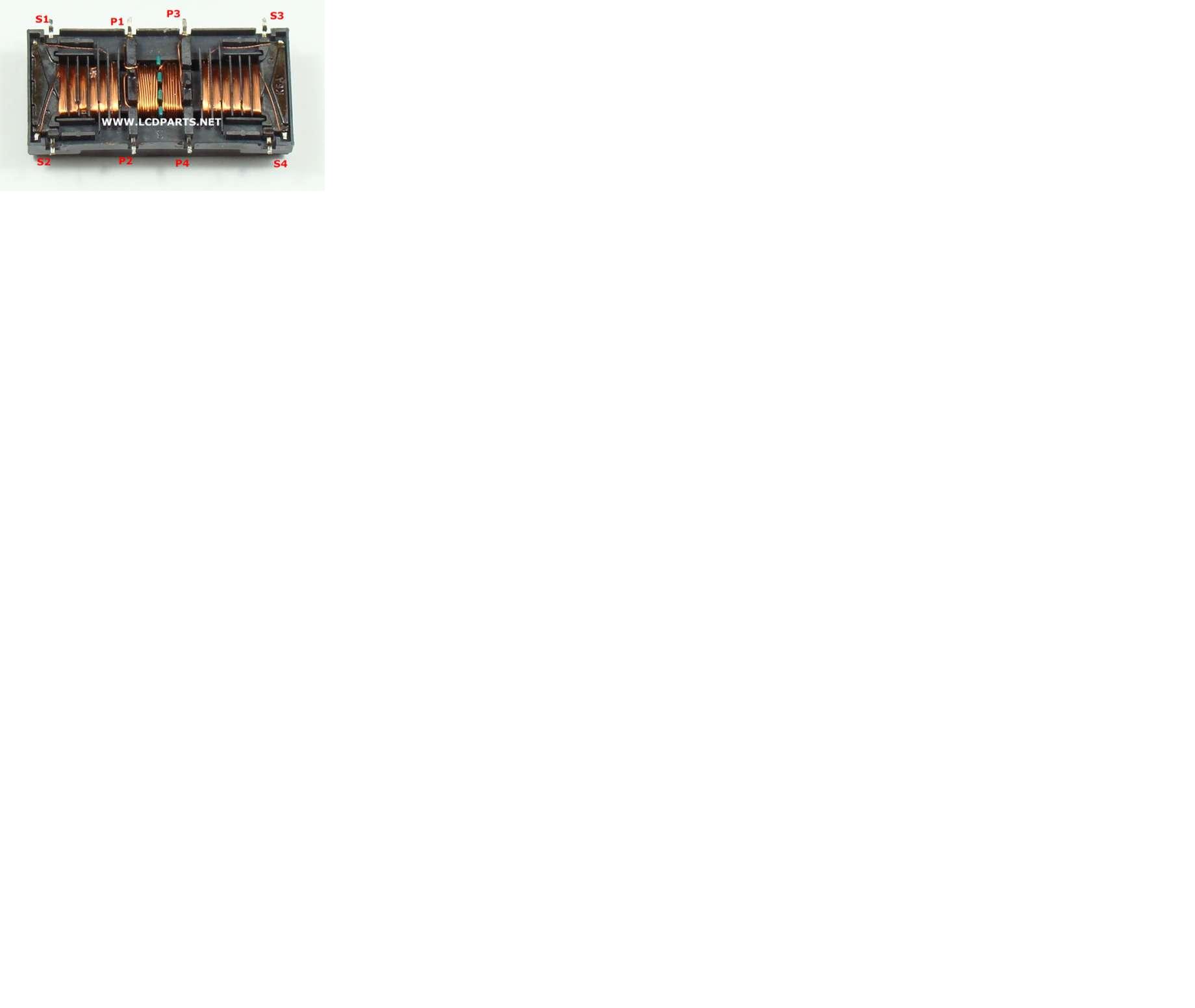

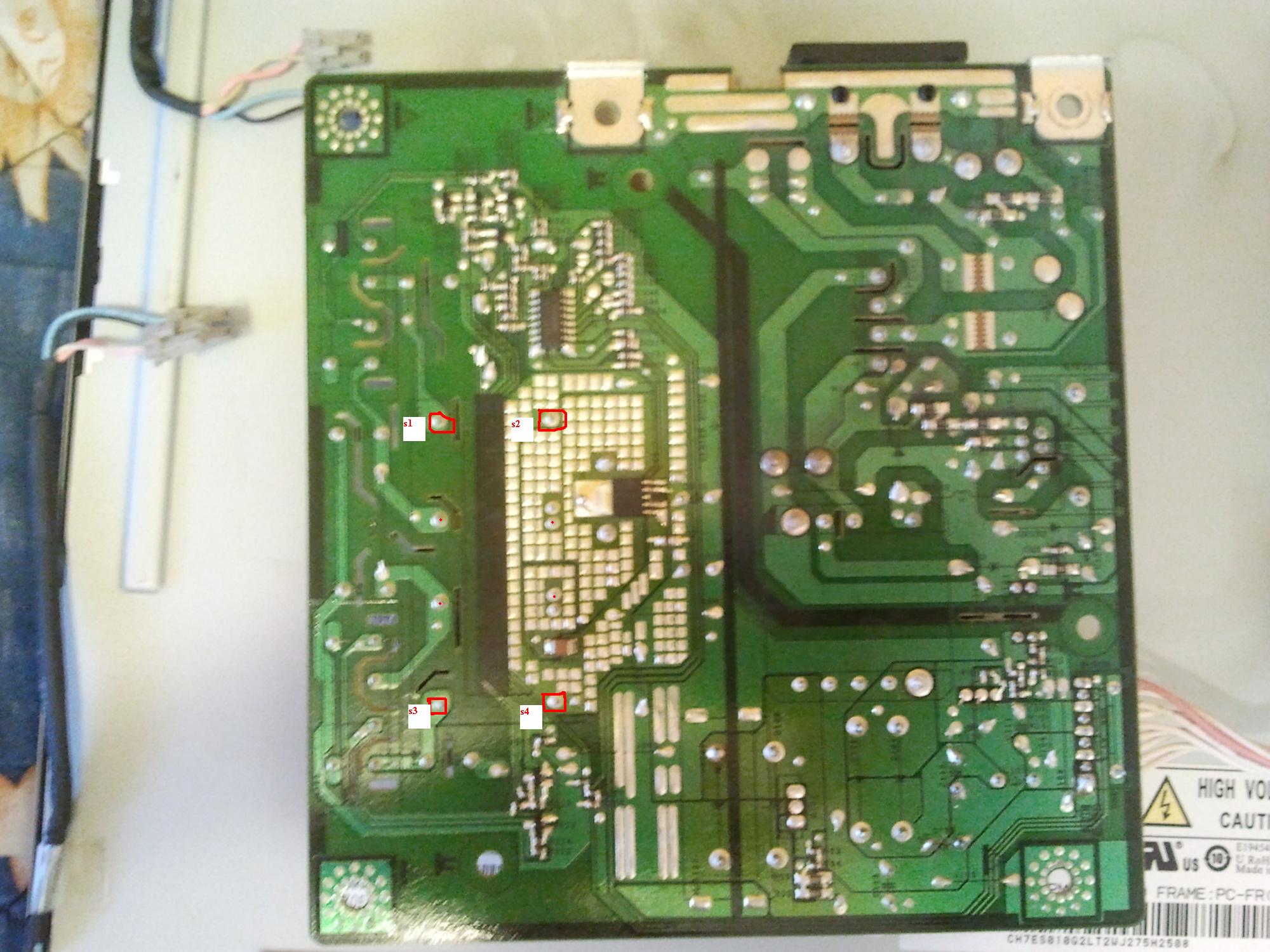

                    #329
                    Yes pics are a bit blurry for troubleshooting however it is usually big bits that go wrong on these.
                    As it is there canwe start with the inverter transformer - big rectangular part
                    Can you test as follows@ No power to board, set meter on ohms 2000 and
                    measure S1 to S2 and S3 to S4 as shown in attachment
                    Post results in ohms.
                    Have you any spare ccfl lamps or a panel (even a broken one)

                        #331
                        Hmm unusual for BOTH secondaries to be out.
                        Here are the pins to measure on the back (I Think)
                        not very good at back to front geography
                        If they are try again.
                        • moondoggie
                          • Jun 2012
                          • 15
                          • Serbia
                          #332
                          yep, those are the ones. My cartography is good it seems, and so is yours

                                        • 7870
                                        #339
                                        Great - that more like it - On th eback of the power board between where I marked S2 and S4 there is a component with 4and half legs can you make out a part number on it?
                                        Can you try for pictures of the main board front & back.
                                        Then probably connect it up and do so voltage tests at the connectors.
