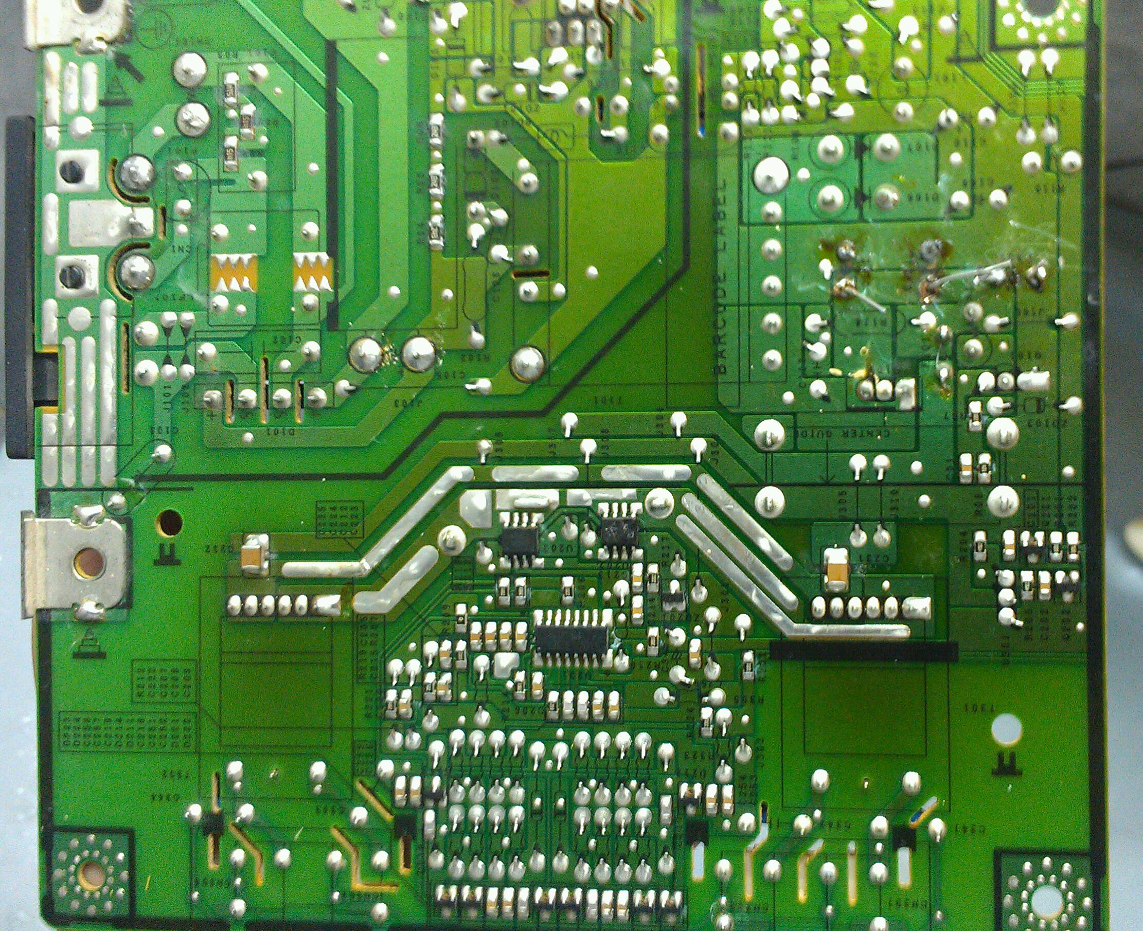

    You found the little green fuse under the the left hand side halfway down under the glue between the heatsink and the capacitor.? If it is back in the set what is the voltage on each side with respect to a ground screw. If it is out of the set can we have a picture of the back. Also can you test the secondary windings on the inverter transformers.

      Yes I have checked the fuses, both near the heats ink and near the power plug (cylindrical one) both are short. I could not understand where to measure the voltage on board. Cantilever please highlight it
        Re: Problems with Samsung 740N monitors
        OK I have marked for testing S1 to S2 and S3 to S4 But as you are getting NO flash I am more concerned with other items.
        In the pink Square that looks a bit burnt on the picture - is it ok
        In the Yellow squares the items are not soldered???
        In the Red Squares check that these are not bridged

          The voltages between s1 and s2 as well s3 and s4 are zero when testes the board alone. The pink 8 pin component is 4502C and it looks in bad condition, I'm not sure if it's fine ( how do I check it). Those capacitors in yellows squares are soldered. In one of the red square that seems bridged is the fuse. And the 2nd red square is not bridge.

                4502C
                If any reading is less than 30 ohms you might have shorted mosfet. Remove from circuit and repeat the tests to verify.
                Some mosfets are more than 3 pins. To test those, identify the part number and search for its datasheet. Once you find the datasheet, the pins will be designated source (S), gate (G), and drain (D). It will probably be documented as S1, S2, G1, G2, D1, D2.
                Simply test
                a) black on pin S1- red on pin G1 - record ohms
                b) black on pin S1- red on pin D1 - record ohms
                c) black on pin G1- red on pin D1 - record ohms
                Repeat for the "2" pins. That is S2-G2, S2-D2, G2-D2.
                Note: a shorted mosfet would likely cause a very brief flash of the backlight or no backlight.

                  Thanks for your help :-) . I will check the mosfets once I find the datasheet.
                  One more thing I've noticed is the voltage across the DC pins of bridge rectifier is above 300V. Is this OK?

                    DC voltage at Bridge should be 1.41 x your mains AC voltage - you can also check that at the BIG CAP - carefully test to see if it holds steady for 7-10 seconds.
                      I just read the part number on mosfet and it's 4502C AA5NP if my eyes caught it right. My main AC is 240V that means bridge rectifier is ok same voltage is across big Capacitors around 328V. NOW I'll be checking mosfet .

                            I just replaced all these caps, even those that are not inflated and my monitor "Samsung 740N D" works!

                                    I finaly managed to fix my 740 Samsung with the PSU like the one pictured in the post above!
                                    I had to replace the three 820uF capacitors, the 3amp micro fuse and one of the 8 pin ICs on the solder side of the board.

                                        Its a surface mount mosfet (AF4502C). I replaced it with a SP8M3.
                                        It also works with 4620 (I temporarily stole one from another working PSU)

                                          I think we usually suggest replacing both mosfets as a pair
