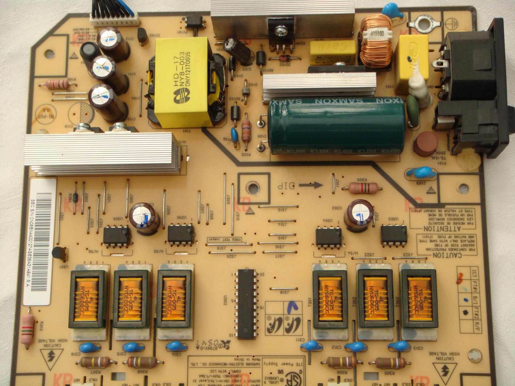

      Here is my board

      between the to point from F301 i have 800ohm. I thinks the fuse is gone
        Re: Problems with Samsung 740N monitors
        so i tried a glas Fuse. But still nothing. The fuse will not go again. So what can i try.

            I followed this thread and successfully revived my Samsung 740N after replacing 3 bulging caps 820uf 25v with 1000uf x 3 25v. Had to substitute 3A pico fuse with 3A glass fuse (with fuse cover wired nicely to the board) because I'm unable to find pico fuse here after visiting every local shop near my place. Thank you .. thank you .. thank you for all the guidance

              where is this fuse. is it the brown one next to the power plug?
              The fuse is a 3amp pico fuse.it looks like a resistor but is totally green.You cant see it in your picture because it is hidden under the white glue, near the caps you circled.

                    Hi guys,
                    I have 214T Samsung that first become dim, than after few hours stopped to work at all.
                    I guess first capacitors are gone, than pico fuse.
                    I opened it and it looks like 4 capacitors a blown 820uF 25v x2 and 330 uF, 25v x2.
                    So I got the capacitors and about to solder them in.
                    However I am not so sure about picofuse, I bought 135V 3A pico fuse , but the problem is that I can't locate it fuse board. I have one "suspect" (greenish thing with black "ring" in the middle) but I am not sure.
                    How I can be sure? Is there any marking on pico-fuses to distinguish them?
                    The other question, since I am not specialist in electronics, does pico-fuses have polarity? And if yes, how to tell right one?
                    The fuses I bough have no marking besides writing "LF 3A" on them.
                    Can anyone please help me?

                      I have seen these power supplies with and without a fuse for the inverter. If there is one it's usually hidden around the two schottky diodes under some glue.
                      Yes the fuses are usually marked on there body,and there is no polarity.
                        Picofuses are usually marked PF on the PCB. For example, PF801.
                        PS. A picture of your board would help. Follow the instructions in my sig file below to attach your pictures.

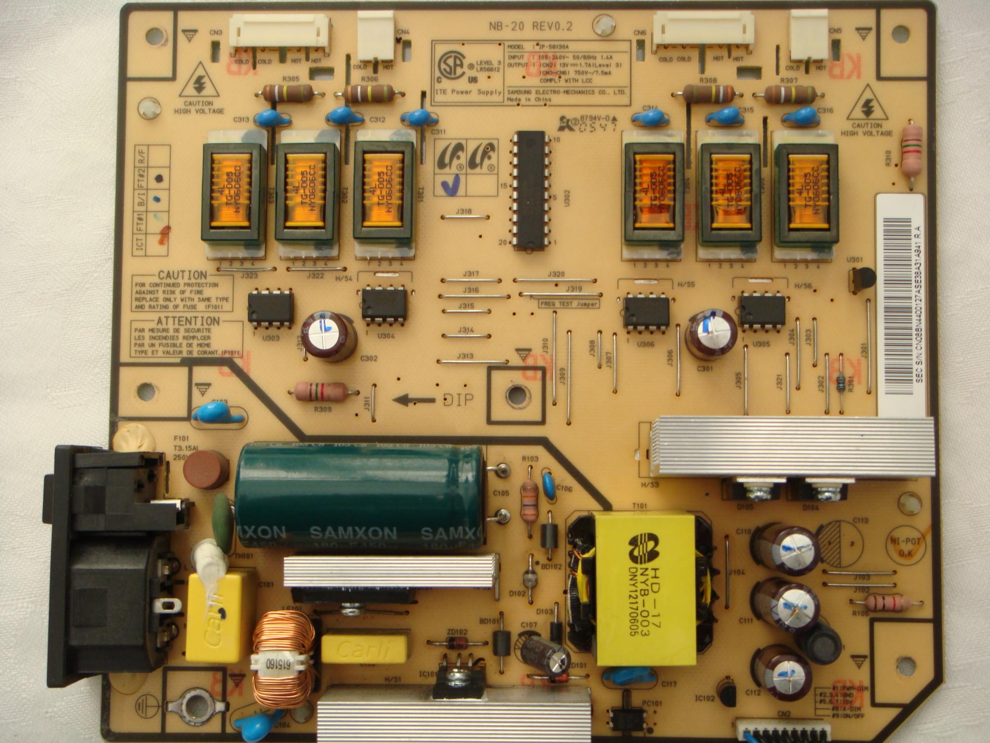

                          please review attached images.
                          As you can see you can clearly see blown caps, but I can't locate pico fuse.

                            Nice photos! Your photos justify why we ask for photos of your board. You clearly have 4 bulged caps. Replace the 6 caps, C301,C302,C107,C110,C111 and C112 with good quality caps like panasonic FM or FC series from digikey.com. You can leave the large green Samxon cap alone.

                              I don't see one either on the front side. Sometimes a fuse is located on the backside. Check there.

                                Thanks guys, replaced the caps and it works.
