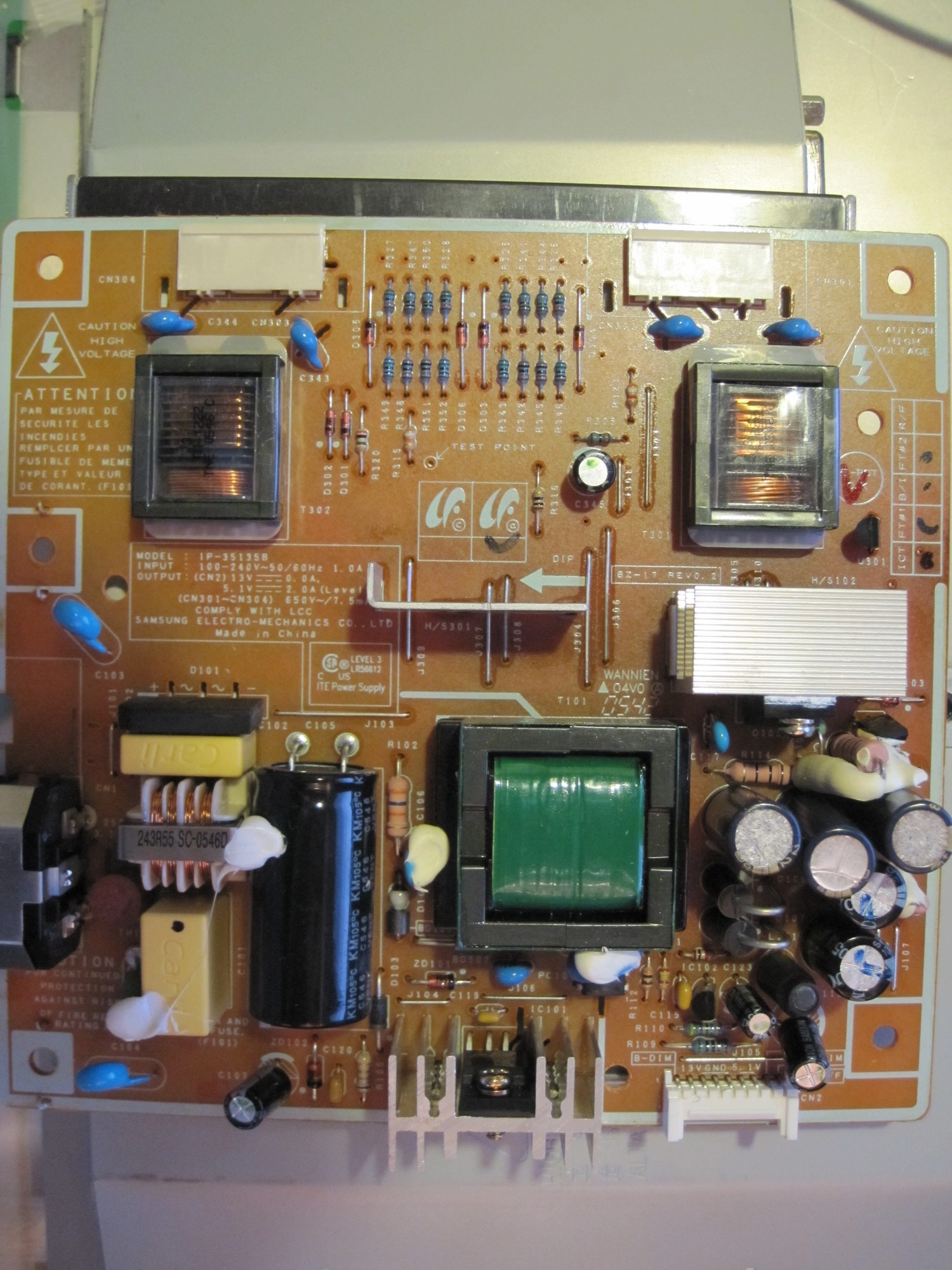

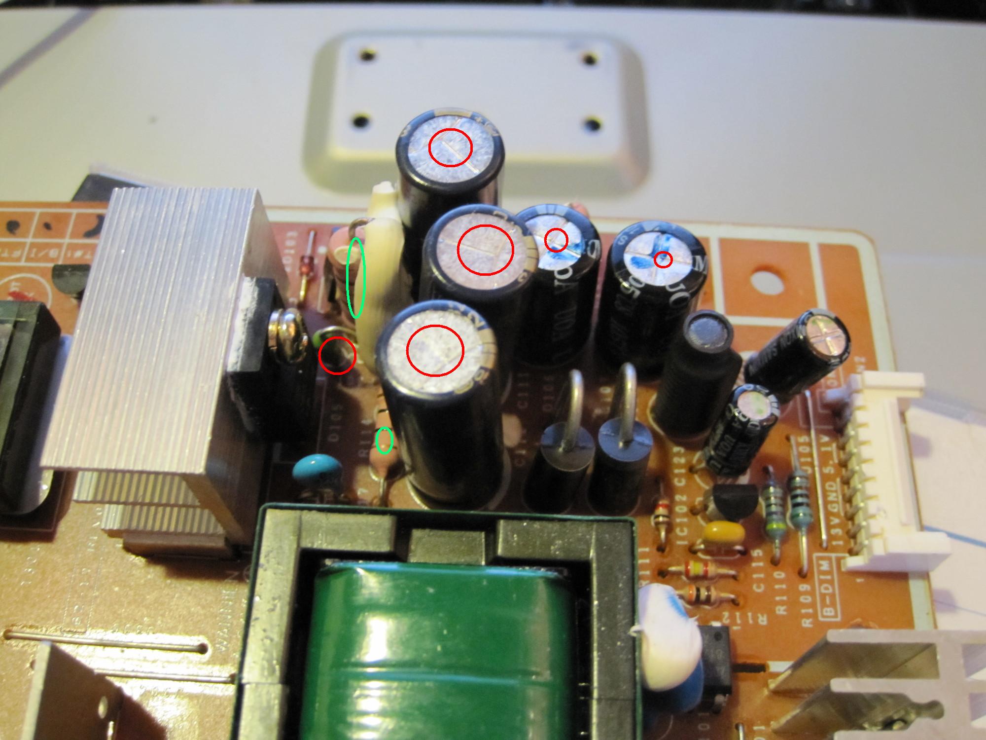

                    Ok, here goes. Great forum!!! I'm new. Electronic Newbie attempting fix.
                    Samsung 730b same PS as everyone is posting here. Symptoms: Power LED on, picture can be seen. No back-light what-so-ever.
                    Read this thread 2 times.
                    Replaced bulged SAMXON 820uf 25v X 3 w/ digikey part # P11221-ND Panasonic 820uf 25v X 3
                    Pico fuse F301 was open, replaced w/ digikey Part # F2315-ND
                    Tested, still same issue, picture with no backlight.
                    CN2 is showing 5.1v and 13v.
                    Inverters are 1325 and 1318 ohms cold.
                    R104 resistor near pico fuse tests to 10ohm as rated, other resistor next to fuse in glue tested to 176 ohm within tolerance of 180ohm +-5%.
                    Replaced SAMXON 1000uf 10v X2 for fun with some used ones...no change in symptoms. Any ideas I can try??
                    Pic 3 Key. Red = Replaced Green = checked while I was there in the area.
                    Pic 1 - Top side
                    Pic 2 - Bottome side. (no making fun of my soldering! )

                      There is one question you have not asked, so I will do it for you. Why was the pico fuse blown? Hint: Assuming it was not a typo, F301 would be in the inverter area....

                          The usual reason a fuse blows is it was trying to carry too much current. The usual cause is the inverter drivers have shorted. You HAVE answered one question - the fuse hasn't blown again. The question is are the drivers OK?

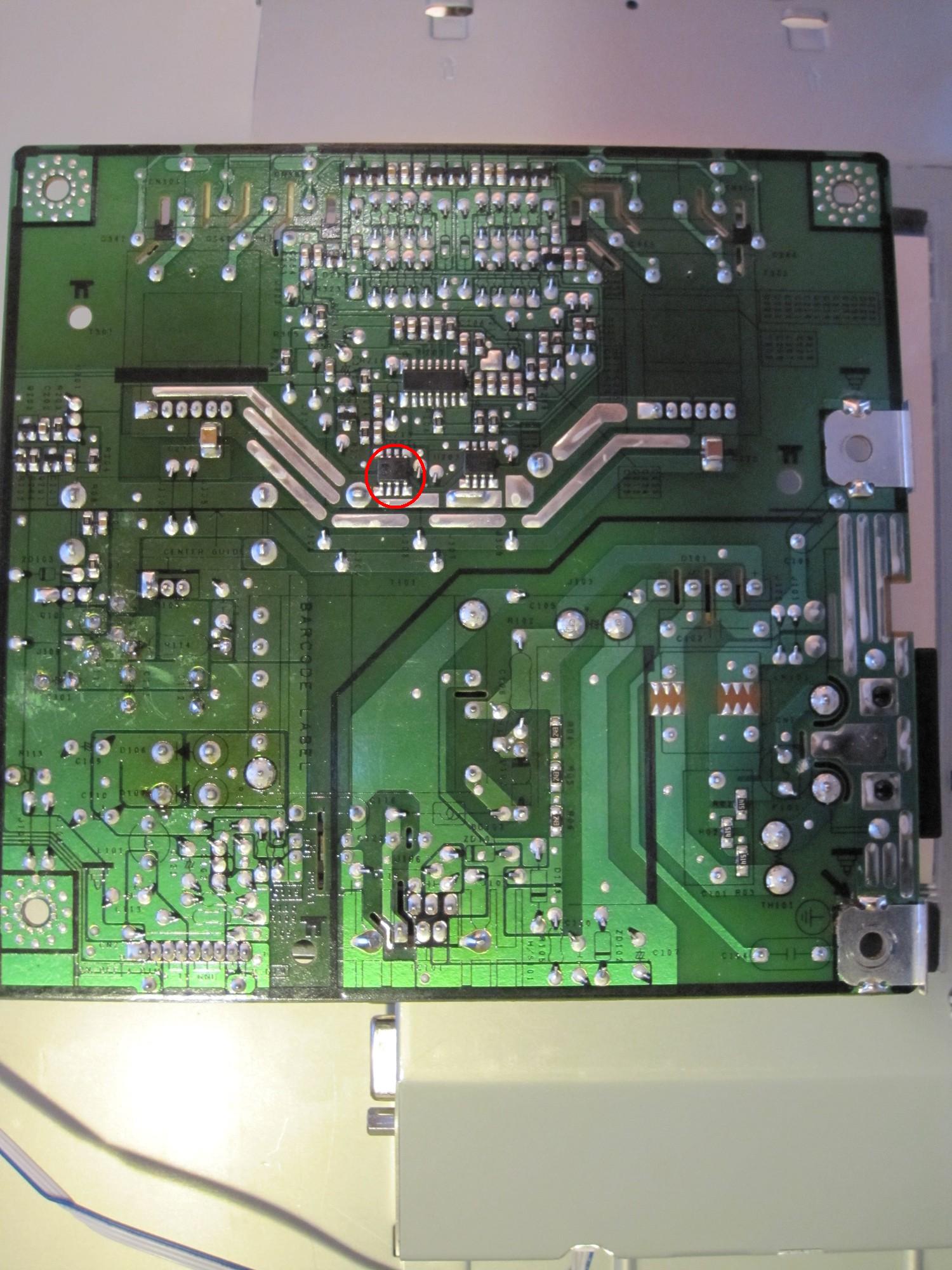

                              Attached picture I circled this little 8 pin chip. My eyes aren't the greatest, but the one next to it appears to say
                              | 45020 |
                              | AA5RW |
                              The one circle appears to be a bit burnt on the one side....google didn't turn up anything on those numbers.....anyone tell me what this little chip does? Is this the inverter driver plainbill refered too?

                                Ok, now I'm answering my own questions!!
                                those tiny chips appear to be a 4502C mosfets. But when setting my DMM to diode test and checking per another post I found, both the good looking one and the burnt looking one are getting pretty much the same readings accross the various pins. Which makes me think they are not shorted?? Anyone who is a master care to comment on my findings and maybe point me further. Thanks.

                                  Well, my eyes aren't anything to brag about either. Those are the inverter drivers, but from this distance I can't tell if that one is burnt or not. A bigger picture would be a big help. And if one is damaged, it's not impossible that both are bad. The usual practice is to replace both if either is bad.

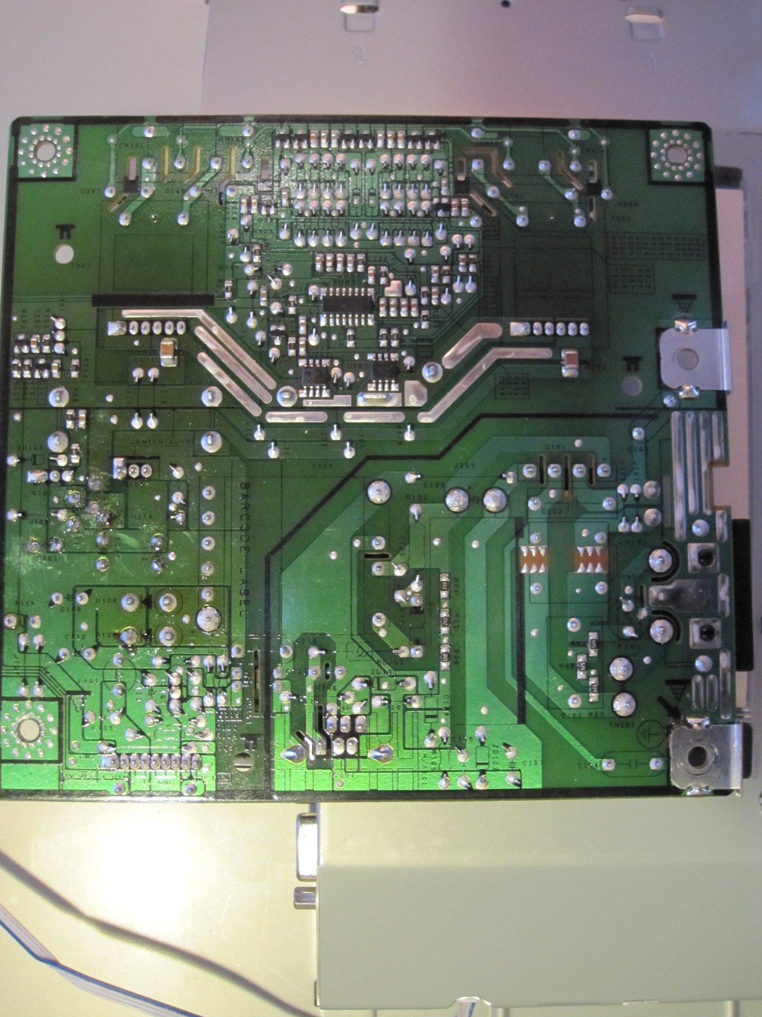

                                    MY wife took the camera today, so no pictures until tonight.....I think the one is burnt...but I thought it would show shorted on my meter in comparison to the other.
                                    So I guess I could replace both and see what happens? Now to see if I can find the mosfets and wait another couple days for shipping...grrrr.

                                      $16.09 worth of parts (shipping included) and a couple hours of a newbie's time and its fixed. My monitor is a Samsung 730B. Replace 3 bad caps, 1 pico fuse and 2 inverter drivers. Replaced the 4502C mosfets with MMDF2C03HDR2G from Mouser.com and bingo, backlights are lit. Monitor fixed. Thank you especially to PlainBill, as well as the rest of the forum contributors this is a great resource!!
