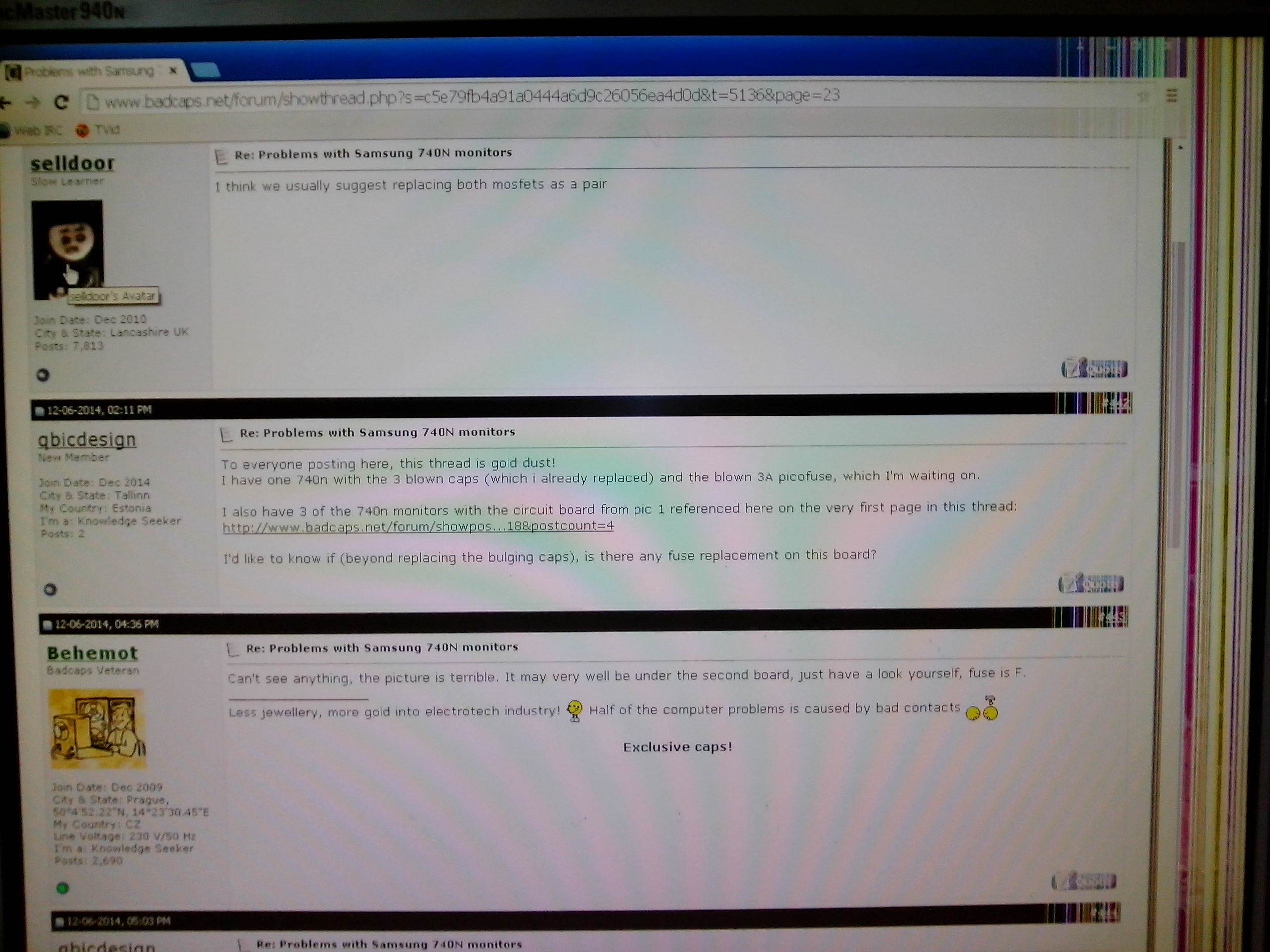

    To everyone posting here, this thread is gold dust!
    I have one 740n with the 3 blown caps (which i already replaced) and the blown 3A picofuse, which I'm waiting on.
    I also have 3 of the 740n monitors with the circuit board from pic 1 referenced here on the very first page in this thread:
    https://www.badcaps.net/forum/showpo...18&postcount=4
    I'd like to know if (beyond replacing the bulging caps), is there any fuse replacement on this board?
    • Behemot
      • 4845
      • CZ
      #442
      Re: Problems with Samsung 740N monitors
      Can't see anything, the picture is terrible. It may very well be under the second board, just have a look yourself, fuse is F.

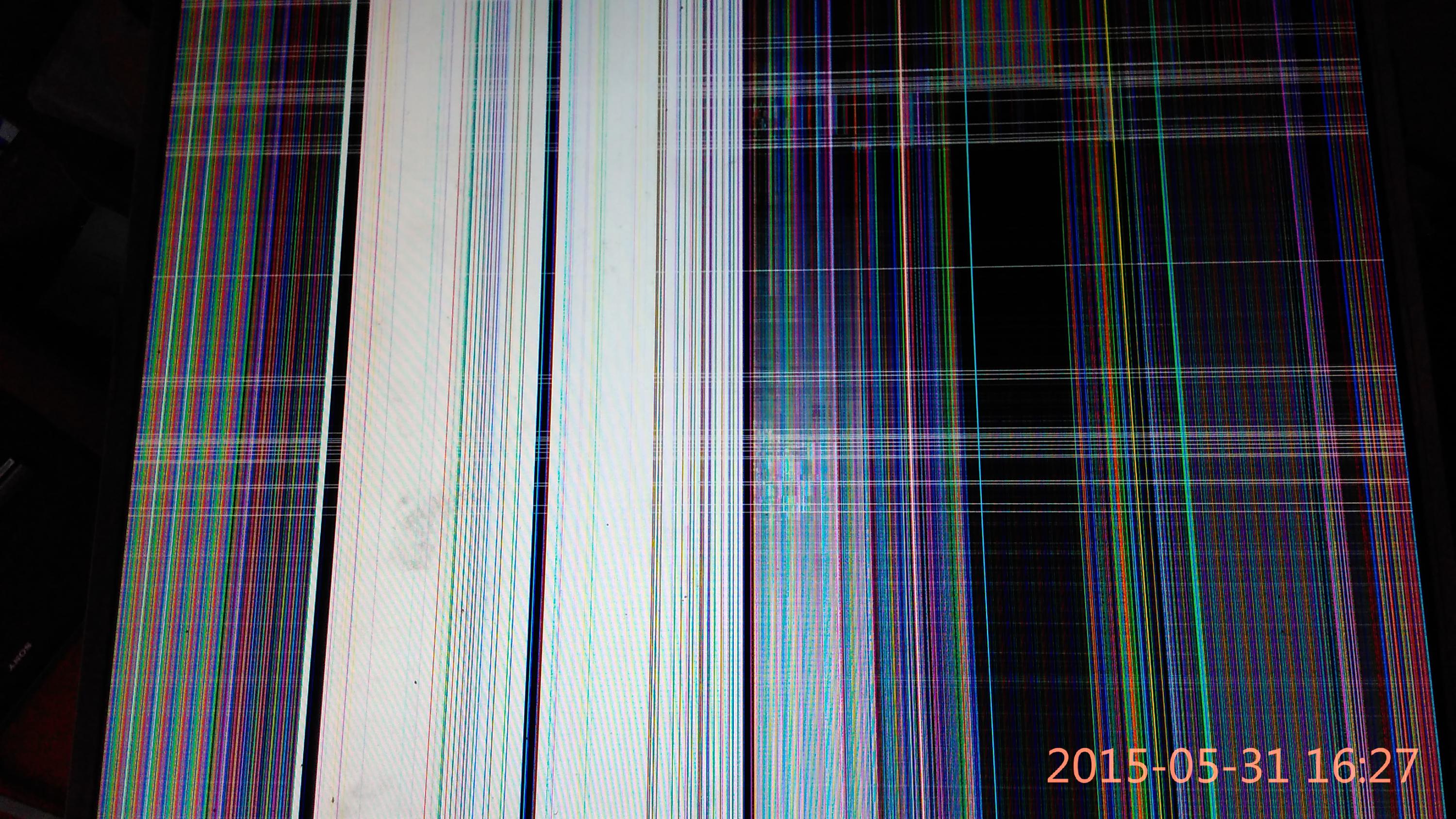

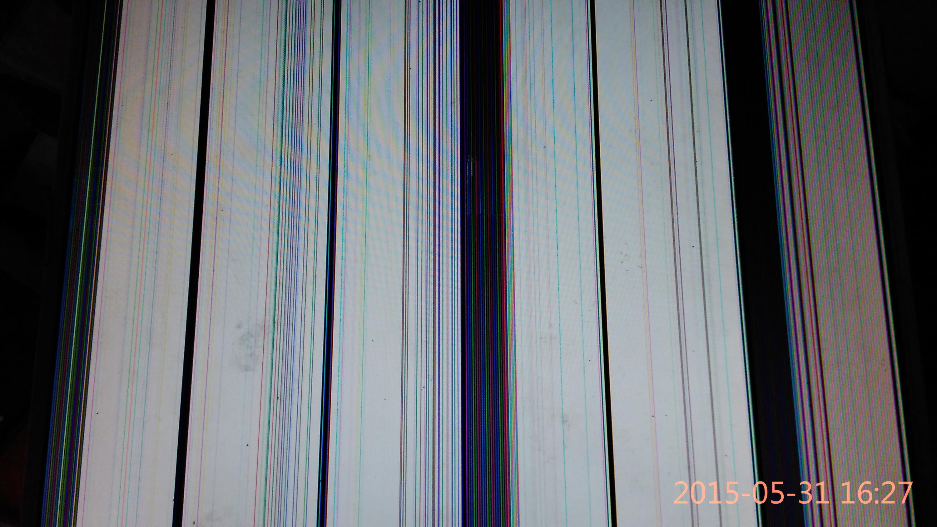

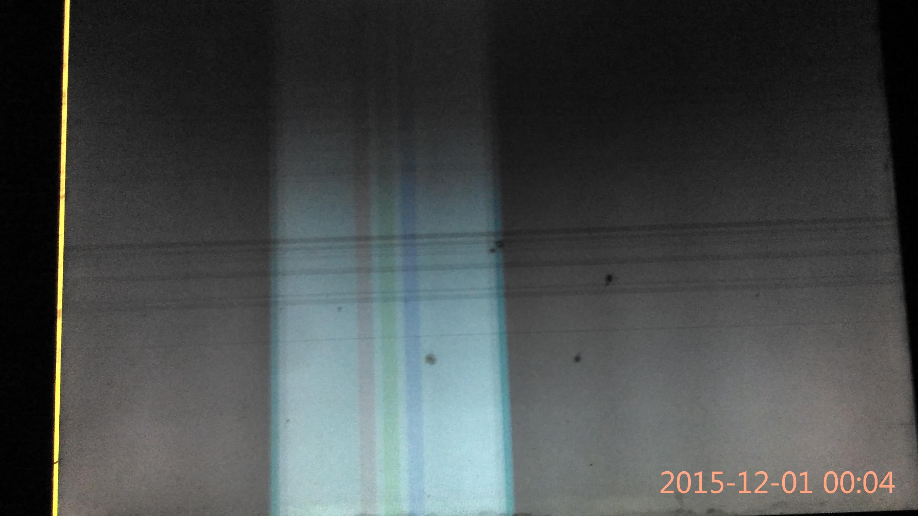

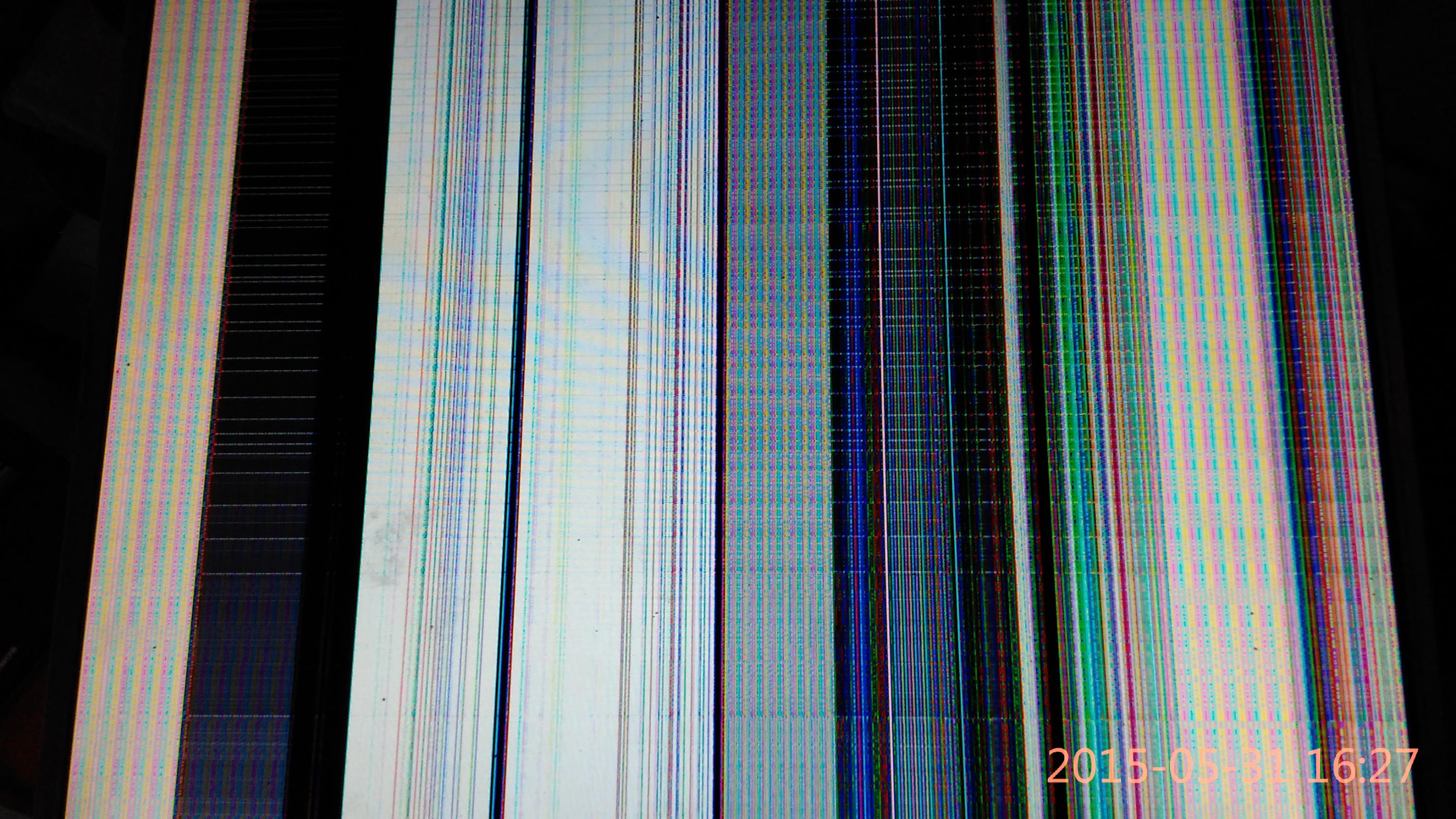

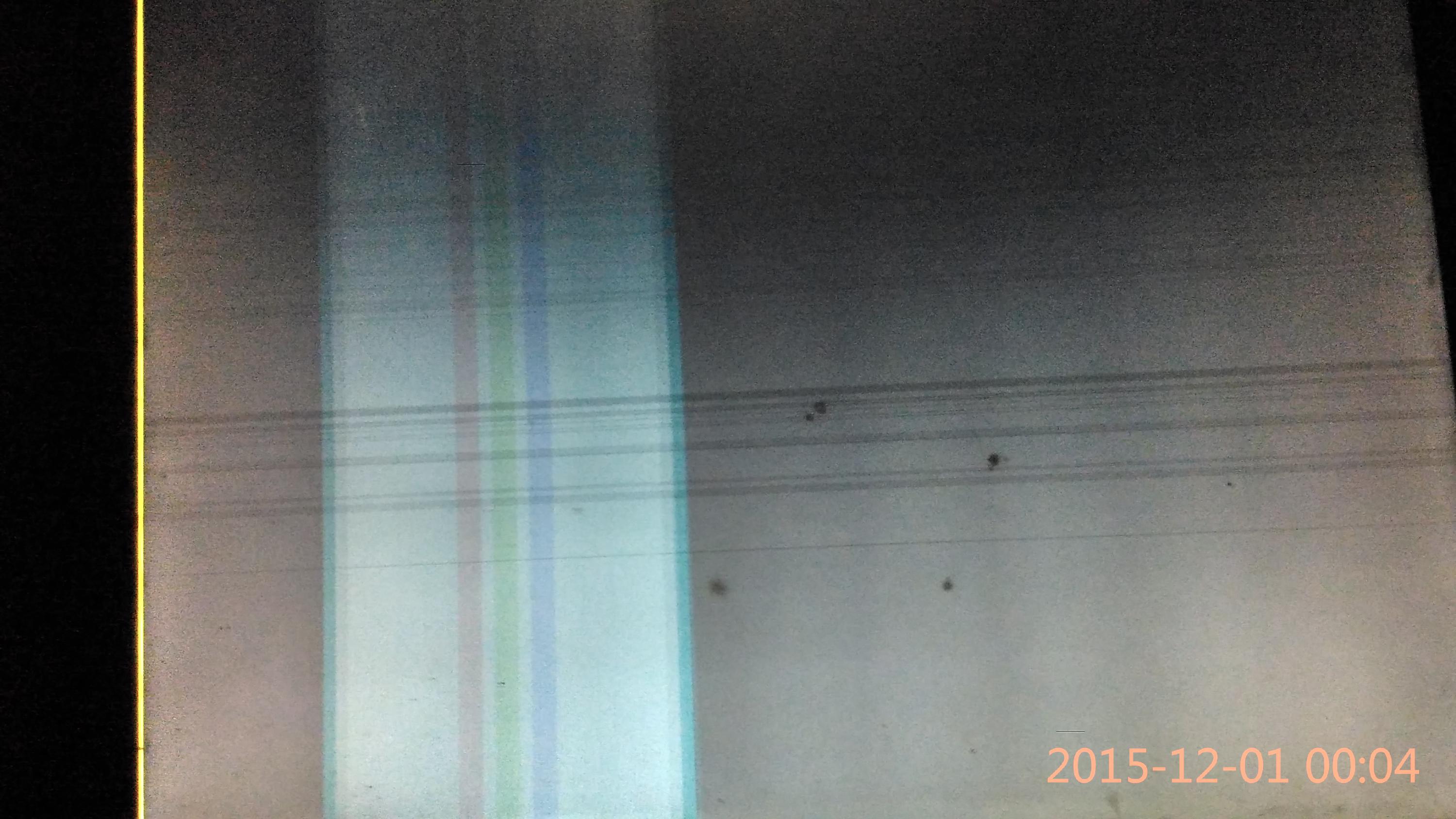

                                  reset cable no display
                                  • tvl_svl06
                                    • May 2015
                                    • 23
                                    • india
                                    #457
                                    Samsung 740n some line vertically,no display
                                    • tvl_svl06
                                      • May 2015
                                      • 23
                                      • india
                                      #458
                                      monitor screen shot

                                          #460
                                          how to solve this problem
