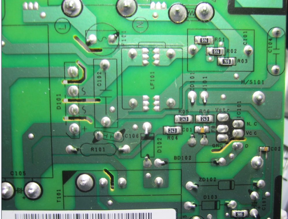

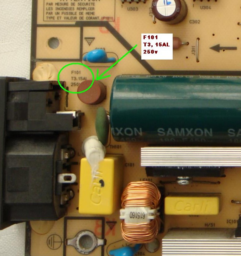

                        Samsung LCD 740nw Led flashes and no picture
                        Hello ... The problem I have with my monitor is that when connected to the grid is turned on the power button is blinking and not showing me anything on the screen even in a message that has no connection to the pc. Thanks & Regards .........
                        help
                        • PlainBill
                          • Feb 2009
                          • 7034
                          #272
                          Re: Problems with Samsung 740N monitors
                          help
                          1. Do not post pictures inline. Use 'Manage Attachments' - below the text entry area.
                          2. Do not use pictures you found on the internet. The first one has obviously defective caps. The second shows only a fragment of the power supply.
                          PlainBill

                            #273
                            hello apologies
                            Some possible solutions
                            where to begin to test
                            all coils are in perfect condition
                            status as verefico (dm0465)???
                            thanks
                            • PlainBill
                              • Feb 2009
                              • 7034
                              #274
                              hello apologies
                              thanks
                              Start by replacing all the electrolytic caps except C105? (the big yellow one). At least two of them are defective.
                              PlainBill
                              • celtronics2011
                                • Sep 2011
                                • 12
                                #275
                                problem solved
                                capacitors were only 10v/1000 microfariados
                                thanks
