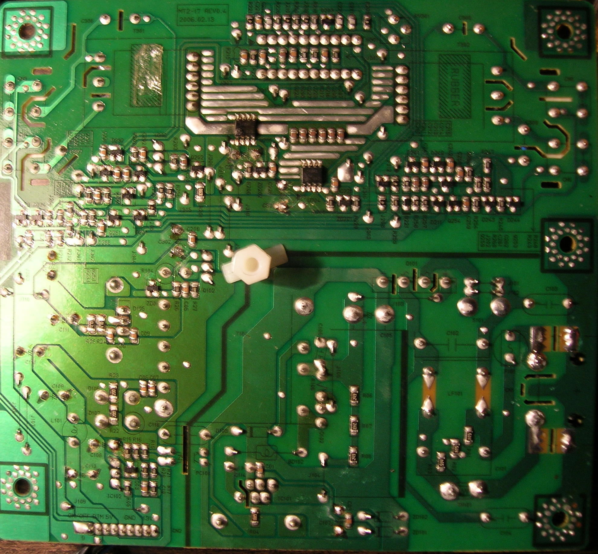

          Hi everyone. Here is my story.
          I got this samsung 721n, which happened to have a psu discussed here.
          At first it has no image, no lamp power, and i don't remember the state of the power led.
          I disassembled it, there were 3 bulged (two 820uf/25v and one 330uf/25v) CapXon capacitors.
          I replaced all the caps on the board (with exception 820uf with 1000uf). How stupid of me, I haven't done any measurements before i did the replacement. Then I connected it all together and plug AC in. At first it was in off state, after pushing power button there were no image or lamp light, power led begun flashing about 2Hz and some ticking noise along. Now i done some measurements of 5v and 13v lines, which were 0.06v and ~2v (i don't remember), then removed AC plug.
          Next thing I done is completely stupid. I disconnected cable that connects IP board and scaler board, and connected AC plug. Something started burning rapidly, smoke coming from below the IP board.
          I put everything apart, on the solder side of the board i saw just burned U205 component with SP8M5 marking on it.
          It's the first time i gone that far in repairing, I desperately need your advice before i burn something else and throw that lcd in trash (new IP board is just too expensive here).

            Here's the likely scenario: As the caps deteriorated the components were subjected to increased voltage spikes. Eventually U205 shorted, overloading the power supply.
            After you replaced the caps the shorted U205 still overloaded the power supply. When you tried powering it up with the logic card removed the increased current caused U205 to flame out.
            You should be able to readily find replacements for the SP8M5. It's a Rohm part, and the datasheet is readily available. I've seen equivalent parts from other vendors.

              Thanks!
              I was unable to find Rohm's, so I ordered IRF7389 and FDS8958A instead.

                  PlainBill, thanks a lot!
                  I replaced U205 with IRF7389TRPBF and the monitor came back to life again!
