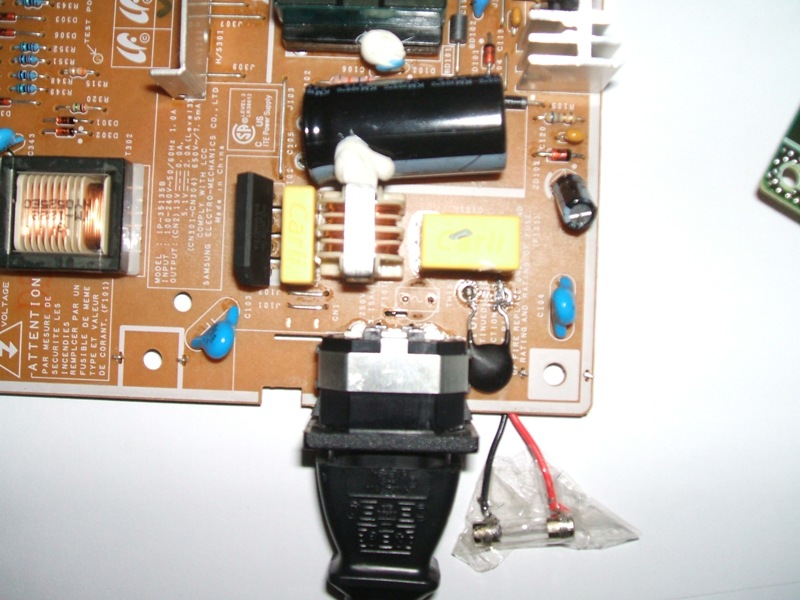

      Hi Eveyone,
      Finally It is working here,If you guys weren't here i never would be able to fix it this is the first time i repaired a LCD.thanks everybody.
      I replaced the D2SB60 with KBL405 which i found one of my old CPU PSU and broke another one and found MF72-005D9 put that instead of SCK-053 as PlainBill said.
      KBL405 is 4A is that really a issue??and does anyone have any idea what may have caused to short the rectifier?

        I was about to post that I found the KBL405 in the 172N dead board that I have, when I saw that you have made it work using that very same part. I don't think that is an issue.
        As for the SCK-053 replacement, I guess it is OK what you did. It is used in the 172N too, along the KBL405, so it is OK.
        As for the reason it shorted, now that is a good question.....
        Now you have to find a fuse ....
        And congratulations

                                    Oh dear. The new fuse blew within a second. The screen flashed at power on.
                                    Are there schematics for the power supply?
                                    Is it worth putting a slo-blo fuse in for F301?

                                      No. The inverter circuit is drawing too much power. It is necessary to determine WHY the fuse blew. It could be a bad transistor, bad transformer, bad CCFL, bad cap, etc. Putting in a slo-blow fuse will allow it to work for a slightly longer period, but not so long as to allow meaningful troubleshooting.

                                        check for componet that is hot, mainly smd 8pin mosfet
