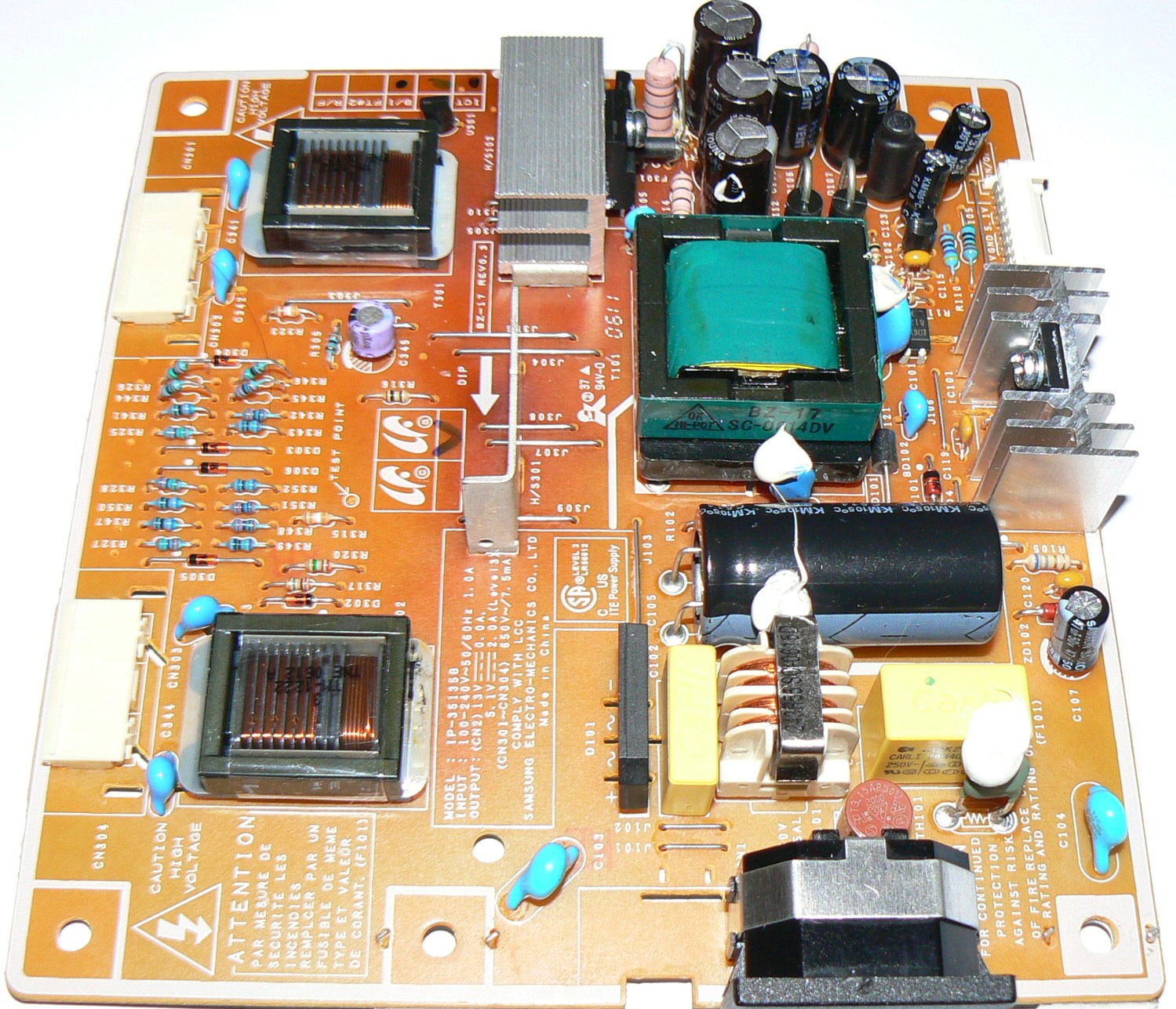

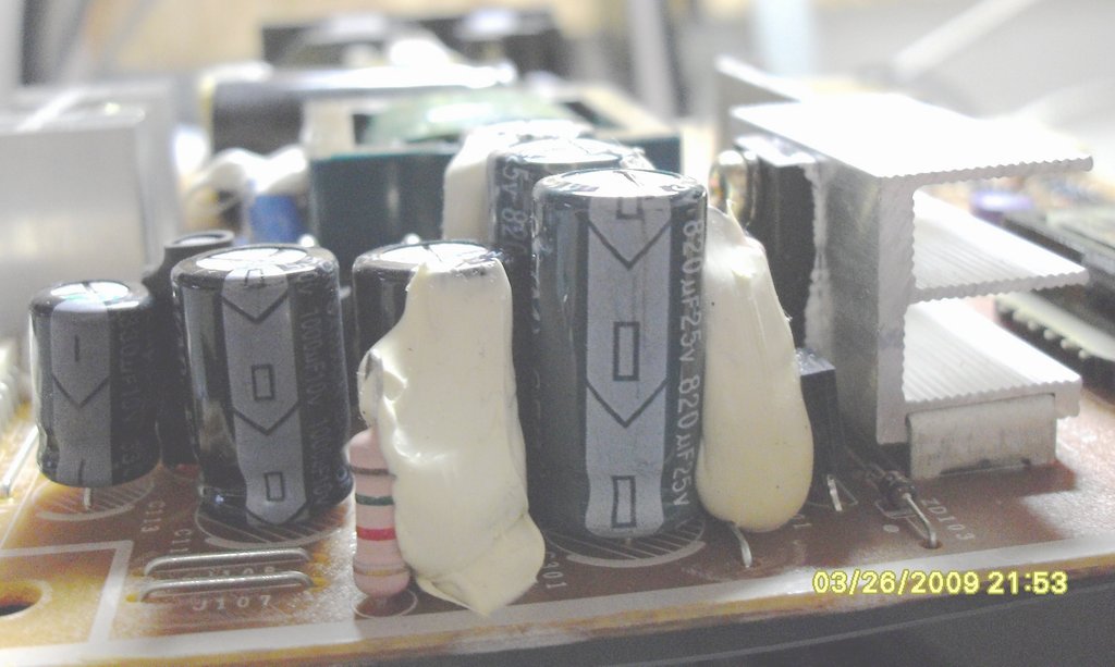

    Seeing the picture, I assume you changed the three caps to the left (of your picture). You must get out ALL the CapXon caps in there, not just the three to the left. try To stay as close as possible to the original capacitance - if they are in parallel, 2@1000 & 1@470 are OK (I've even done a 2200+470 in an emergency case three months ago). Removing the fuse to isolate the inverter section for further tests (as per Wizard suggestion) is a good idea.
    Again, what (brand,) V Rating/Series/capacitance are the remaining caps you have in there? I have a 940T board that has two 1000uf@10v and another 330uf@10v - those might be the ones on the 5v power rail. If the reference voltage (5v) is wrong, the other one would be wrong also. As per Wizard suggestion, measure the 5v output. Here's a pic of my 940T board (from a Dead screen LCD unit). It should be the same as yours (pictured before recap).

      What about the small capacitor in the hot side of SMPS?
      This filters the hot side DC supply for the SMPS IC.
      Oh yeah, I forgot about this little guy.... it makes the 5v line bounce ....

        Sorry for the late answer, i was sick these couple of days.
        Still no improvements, I replaced ALL capacitors from a working 740n monitor and i still cannot find the problem. 5V line is ALWAYS ok. As soon as i turn it on, 5V line reads 5.1V and stays that way. All resistor have been checked and they have the same value as the working one. I am starting to think that the big green transformer is the problem, because every other part has identical readings as the working monitor.
        Can i attach an external power supply to supply the 13V line and where should i attach it?

          Honestly I don't know (at this moment) what to suggest to you, but I doubt the Transformer is bad. It serves to change the AC (120/240) into DC (it "downsteps" the voltage for it to be rectified). I guess it is changed into 13v and the downstreamed once again to 5v.
          Once I did what you are trying to do (inject voltage) on a Samsung monitor (a 173s) and the issue didn't finish as I expected. Wait for suggestions from PlainBill, Wizard, PCBONEZ, Toasty or one of our other seniors.
          But something echoes in my head : what replacements did you use? You took them from a working unit, but what did you take? CapXons? Post info.

            Thanx for all the help so far. Yes, they were all Capxons. Caps definately arent the problem. Thats the third set of caps in this board .

              Ethernet, I've just reviewed your posts, and it seems like we're missing something. The symptoms you describe are very unusual (yeah, I'm sure you've figured that out). I'm trying to rationalize them against what I know about electronics, and I can't. That means either I don't know as much as I pretend to, or some of the things you have reported are incorrect.
              Perhaps you can answer a few questions I have.
              1. I noticed you reported 750 volts across the big capacitor. That is VERY unusual. What is the line voltage in your area? In the USA we use 120 / 240 VAC, monitors use 120 VAC. For 120 VAC you should measure 170 volts, for 240 VAC you should measure about 335 volts - DC in each case.
              2. Wizard had suggested you disconnect the inverter section from the power supply section. Did you do that?
              3. If you did, does the green transformer still make noise?
              4. What test equipment do you have - VOM or DMM? Make and model number?
              PlainBill

                  750V was due to a broken DMM i forgot to mention that later.
                  1. Line voltage here is 230V AC
                  2. & 3. I disconected the fuse to the inverter and the green transformer is making less noise and does not stop working (when the fuse is in place, transformer is working for 2 sec then stops working, then starts for another 2 seconds...)
                  4. DMM Velleman DVM 760, ESR meter
                  13V and 5V line was measured on CN2

                    Broken DMM is not to trust and cost of a new good DMM is too inexpensive against repair one so we buy another. Unless we have fluke which I'd certainly send it in for repair.
                    That noise is cycling on overload or overvoltage tripping. We call it buzzing, tweeting, chirping etc. That's what a good SMPS design should do.
                    If it still making tweeting with this disconnected, then SMPS still have a problem.

                      As Wizard said. Check for parts generating excessive heat, in particular the diodes on the output of the transformer.
                      One relevant thing to remember: Transformers RARELY fail. But that is not the same as NEVER. It is usually a royal pain to change them, tho.

                          With this fast reaction of SMPS IC, we hardly could detect overheating. Solution is use meter with PSU disconnected from mainboard and not plugged in for power, unsolder the main power transformer completely off the board. This will give you easier time measuring in ohms (diode check is not always 100%) on everything not just outputs.
                          Very RARELY we find a bandit PSU that had bad SMPS IC! :o
