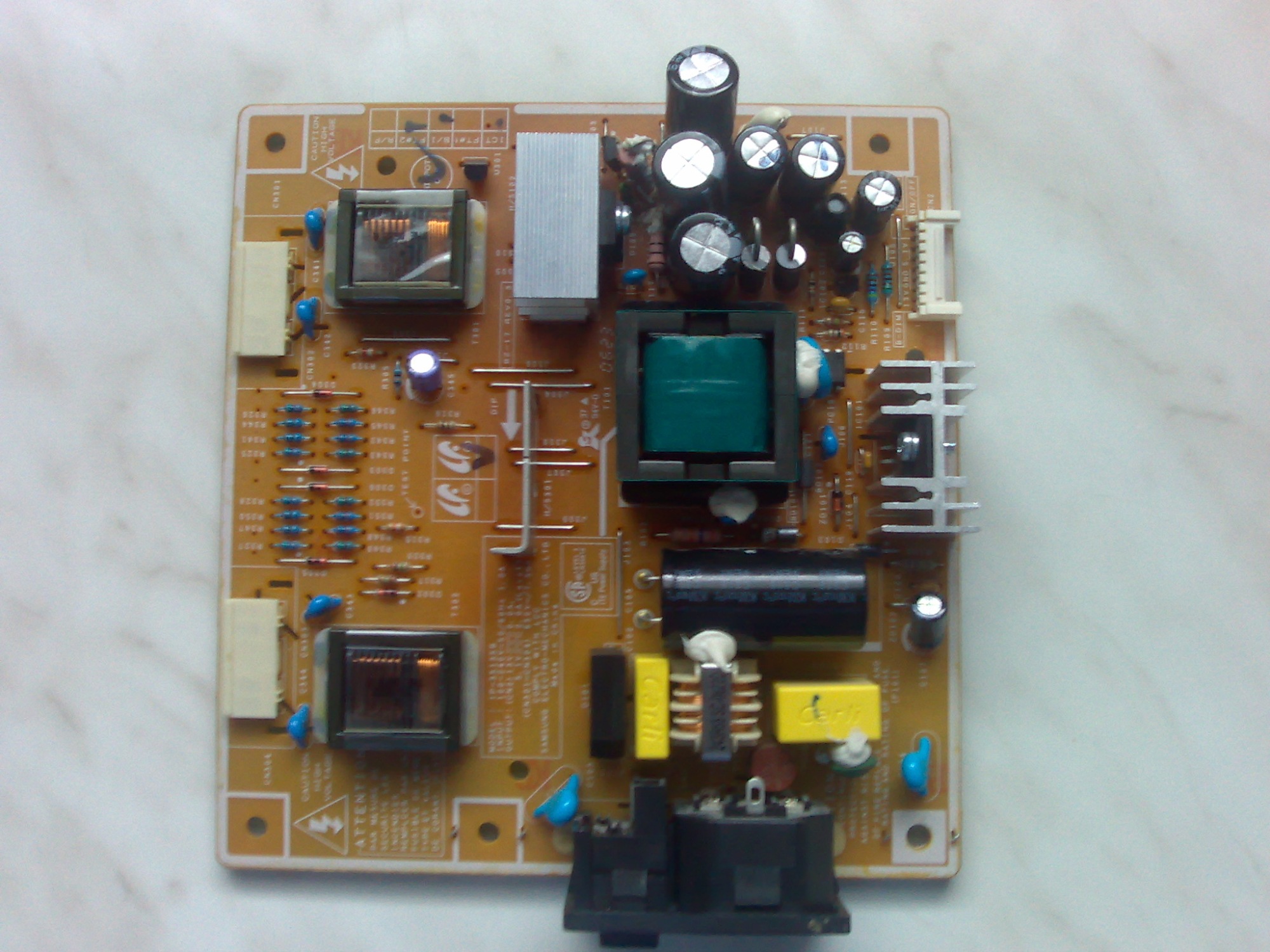

                          Greetings to all
                          I have changed 3 820uf capacitors and 3A fuse and now the CCFL lamps start for a second and they turn off again. After two seconds they startup again for a second and turn off again. I checked 13V line and it reads 18V and just as the lamps turn on for a second voltage drops to 13V and comes back to 18V when the lamps turn off. What can be the problem?

                            #93
                            Re: Problems with Samsung 740N monitors
                            Originally posted by ethernet
                            Greetings to all
                            First of all, welcome to Badcaps.Net
                            Post a picture of your board to see if we can see something suspicious. You might have more bad components in there. Post also brand/series/ V rating and capacitance rating of remaining caps. That would help you to get the info you need.

                                  #96
                                  You guys here are quick. Didn't expect a reply so soon.
                                  I replaced all caps again and no luck. I put in 3 CapXon 25v 1000uf. I did that on my friends monitor and his is working like a charm. Mine just wont stay on. Itried 2 1000uf + 1 470uf and the problem remains.
                                  1. I turn the monitor on,
                                  2. Big green transformer starts to make hissing sound and 13V line reads 18,3V
                                  3. Lamps go on for a split second, 13V line reads 10-13V
                                  4. Big green transformer stops making noise and lamps turn off 13V line reads 18,3V again
                                  5. After two seconds transformer starts making hissing noise and we are back at step 2. and so it goes round and round.
                                  And i tried to messure voltage on the big capacitor (450V) and it reads 750V!! If the capacitor is rated at Max 450V how can it read 750V?
                                  Can this be a faulty transformer or is it something else?
                                  Here is the pic you requested

                                    #97
                                    Do not power up again, you will kill the HV section on the inverter! Time to disconnect the link to the lamp inverter so you can keep troubleshooting the feedback section.
                                    This feedback usually tap the important voltage which is 5V on this board, I do see a microamp regulator feedback (is that a TL431 in there above the optisolator IC?). Measure that 3 legged device and one of pin should be 2.5V if not, either resistor network or that device is bad. Ohm all the resistors.
                                    Are you using low ESR with high current ripple capacitors?
                                    Remember, always measure: cold side voltages with cold ground or hot side voltages with hot ground, not cross each other when where to put DMM probe on the particular ground plane in this SMPS.
                                    Cheers, Wizard
                                      Still no luck,
                                      i detached the 3A fuse so the inverter wouldnot startup a did everything you said Wizard. All resistors check out, and yes, on tl431 there is 2.49V. I am using low ESR capacitors and i still dont have a clue what is wrong. Do u have some other advice i could try? I would hate to throw away this monitor for a problem that maybe cost a few bucks.
                                      I noticed that voltage dropped to 16.30V when i removed the 3A fuse. Is this information helpful?

                                        #99
                                        Still not good. What is your reading on 5V while other 13V is at 16V?

                                          #100
                                          I was busy eating, now I can think and talk,
                                          Keep fuse disconnected for now.
                                          while checking the 5V as I asked, ohm the rest of resistors have you? Some of the circuit better unsolder one end of resistor and recheck. I know some places is SMD resistors makes it bit tricky. What about the small capacitor in the hot side of SMPS?
                                          This filters the hot side DC supply for the SMPS IC.
                                          Also I check stuff in the hot side resistors as well.
                                          Remember to discharge the main capacitor with piece of 100K resistor after power cord is unplugged for your safety if working/troubleshooting this.
