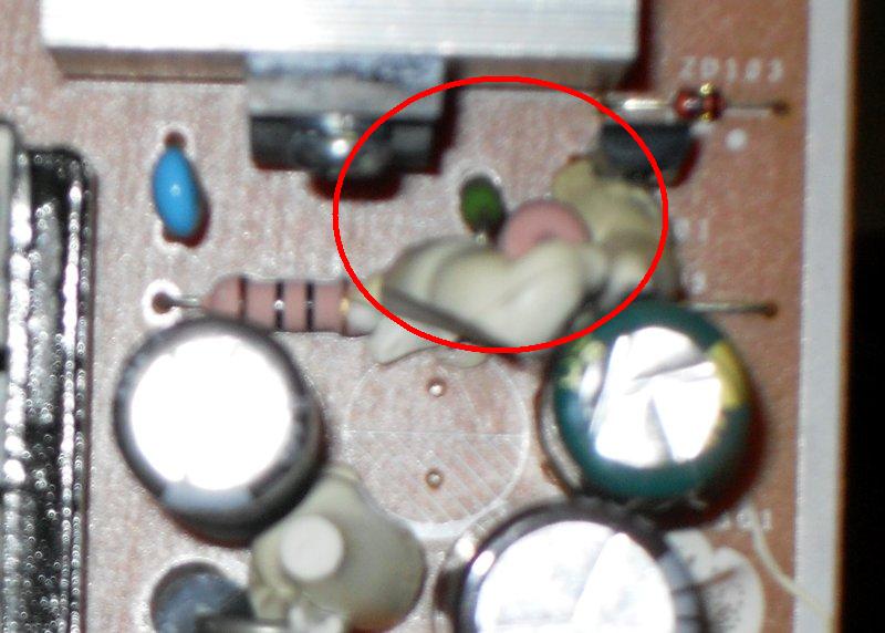

      hi where is the 3A pico fuse found?

          I have not got a board with me, but from what I can see , there is a red fuse behind A/C connector,cylindrical in shape,but the one you may be after is possibly alongside of the big filter cap that is laying on ita side, its black and look like a diode or inductor,as I said I cant see properly from pictures,just check it out.

            It is located under all that white stuff, at the side of a resistor, just at the side of the offending 820uf 25v caps.

              This was ever resolved?
              I have a 940T with the same PSU. Power led brights in a beautiful blue color, but no image or backlight. Also, I can't get V readings on the three bloated caps on the pic. I have replaced ALL the caps in the board (except the little one on the inverter side. As soon as I get image, I'll mess with that.
              Problem solved. While changin the fuse, checked the resistor at its side.
              Resistor under the white stuff was badly/cold soldered.
              Removed solder, resoldered, and now power flows in all the board.
              And for the V readings, one of the jumpers was also badly soldered. I reflowed the solder on it, and problem solved. Too bad that after the LCD came to life it has a green line (like 2~3 pixels wide) across the right side.It has been narrowed down to the LCD Panel itself, as I have another unit and the problem moves if I exchange the lcd panels...too bad, excellent image and no damage to the screen ...

                      If the fuse keeps blowing something is drawing too much current. Possible suspects are (in order) the switching transistor (on the large heatsink near the top of the large cap), the bridge rectifier (black rectangle near the bottom of the large cap), and the large cap itself. Use and ohmmeter and check each one out.

                        Thanks PlainBIll Just checked the board carefully and found that green colour part in between cylindrical fuse and blue capacitor has burnt(just below the yellow cubic) I really appreciate if someone can name them for me and get the value of that green thing looks like a resistor to me.Thank you guys.

                          Post a pic of your board , of the area with the suspected bad component.

                            tell us the letters/numbers on the board, probaby a thermistor, and any markings on it,
                            post pictures of your board if you can

                              Yep. If you can't post a pic, the marking on the silkscreen can help. I should have suggested that before.
