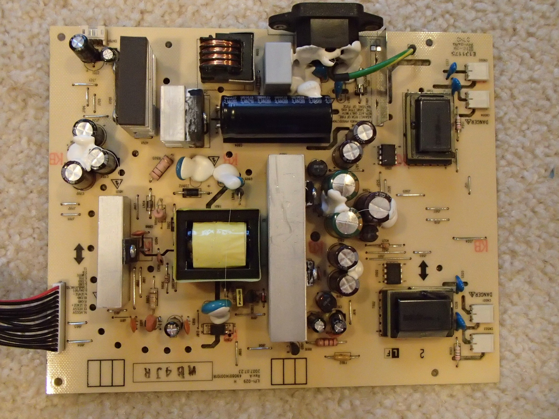

    Turning the monitor on/off shows the image for a second then goes to black. I can read the screen using a flashlight.

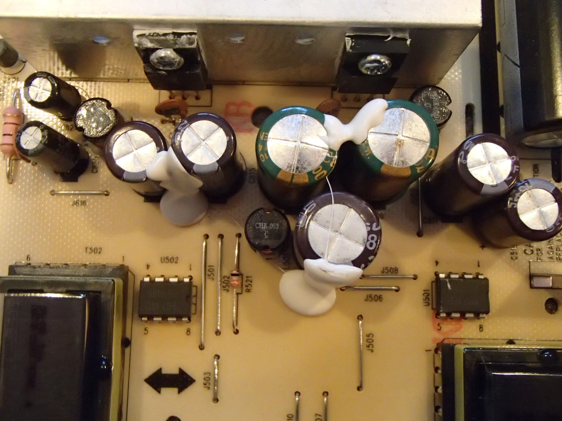

    It looks like the inverter board has a few domed caps so my assumption at this point is that is the cause (see images).
    Board Front -

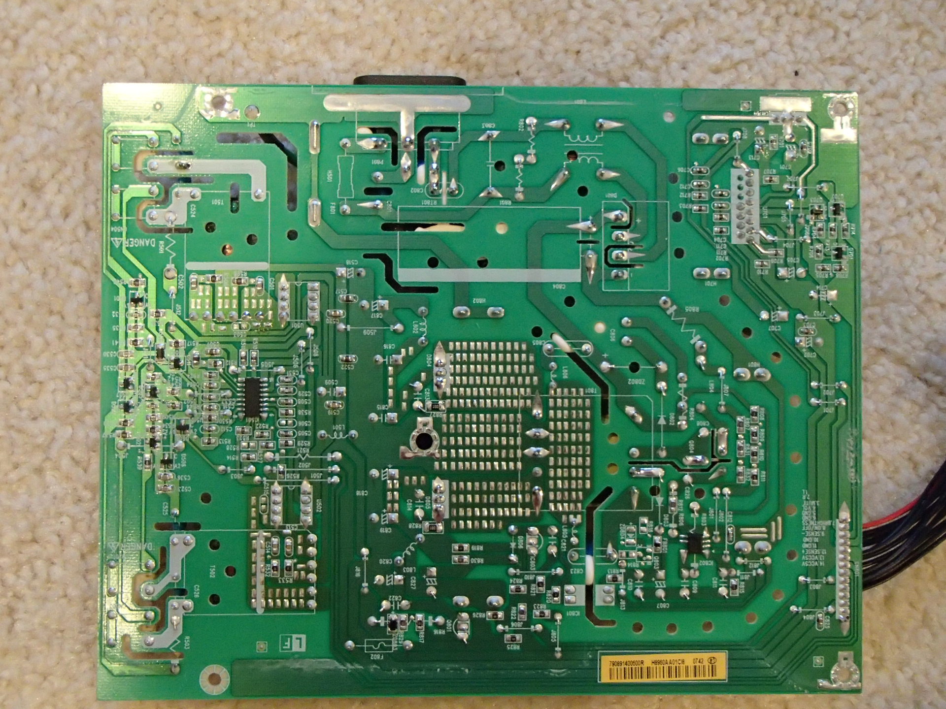

    Board Rear -

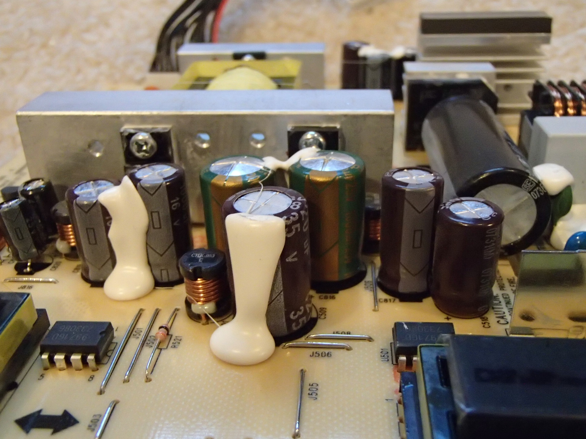

    Caps Side View -
    Caps Top View -

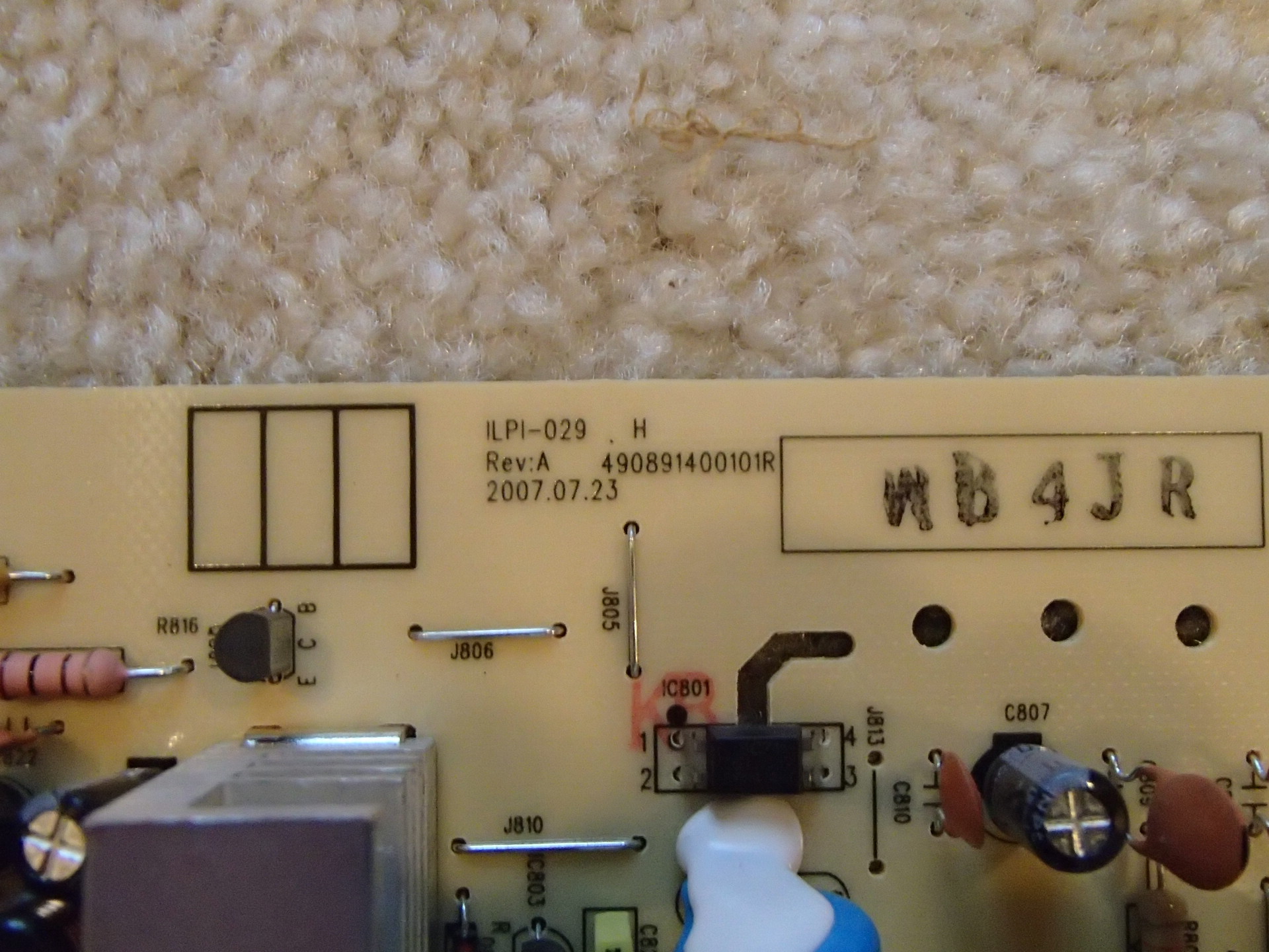

    Board Part Nbr -
    Board Rev Info -
    Performing a search I found a few sources in Asia for the 490891400101R board for $20 including shipping.
    http://www.aliexpress.com/item/Free-...976031099.html
    http://www.aliexpress.com/wholesale?...=490891400101r
    Most of the forum posts here recommend replacing the caps with quality ones. Any updated opinions on which way to go? If it's replacing the caps then what is the best source and which do I need?
    Thanks in advance for your help!

      good question, if your ok with the solder iron, I would try replacing those 2 bulging, low esr caps from digikey maybe, more caps could be bad but that's where I would start.
        Re: HP W2207H Screen to Black in a second or two
        If you get the replacement board, it will probably come with those bad caps that they should not use in the first place.
        You can get good caps from digikey or mouser. I use PANASONIC FM/FC/FR series for all my repair works.

          Thanks you nomoresonys and budm for the replies!
          I think I'll try the capacitor replacement first and buy the board if all else fails.
          I've done some fine soldering in the past (XBox, iPod, small and large appliances).
          I have a Radio Shack dual wattage soldering 'station' (20/40 watt). Is this OK?
          The existing two bulging CapXion caps are identical -
          1000uF 25V
          > - > (negative lead indicator)
          GF 105°C
          P740
          VENT
          Measurements -
          Diameter: 12.5 mm
          Height: 20 mm
          Lead Spacing: 5 mm
          I went to Digikey and here is what came up -
          Digi-Key Part Number: P12379-ND
          Manufacturer: Panasonic Electronic Components
          Manufacturer Part Number: EEU-FM1E102
          Description: CAP ALUM 1000UF 25V 20% RADIAL
          Lead Free Status / RoHS Status: Lead free / RoHS Compliant
          Full specs at link: http://www.digikey.com/product-searc...ader=search_go
          Would this be an acceptable replacement for the two bulging caps?
          Do I need to replace the "white glue" with some other adhesive (RTV?) after the caps are replaced?
          Thanks again for both of your help! (can you hear my sigh of relief? )
          - Bob

              Oh nice! The HP w2207 monitor! I have replaced and fixed about 5 of these monitors! These monitors almost always bulge at the same spot and yes those caps are almost always to blame! Once those caps are replaced with quality caps, your monitor shall return to stable power.

                Can I ask what caps you used? I had a few other questions in my post #5 above. Can you help with those as well?
                Thank you!
                - Bob
                  FM/ FR/FC are all OK to use, no need to put the glue back on.
