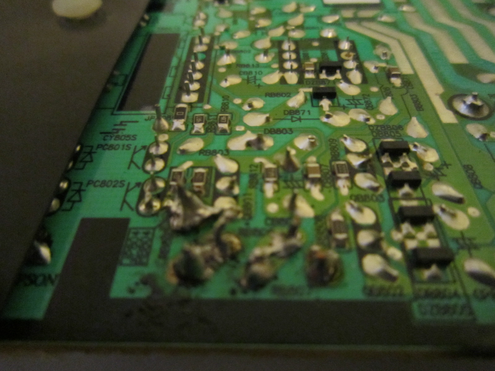

                    Sorry to let everyone know but a week later and I am back to sqaure 1. The monitor does not turn on, no blue power light and no picture (as was posted originally). I am suspecting that the resistors and capacitors may have been fine and there is something else wrong with it however, why would it turn on after changing those parts. I did not hear any bang so I don't think anything is fried.
                    If anyone else has any other ideas I should try (1 last attempt) before I scrap it. It's just unfortunate cause it looked like the capacitors and resistors did the trick however..

                      i would check/re solder all the joints on the new parts you put in it first it could very easily be a bad soldered joint.

                        Can you post some photos of your soldering work - in better lighting than the first ones.
                        Check the main fuses again. Are they still OK?

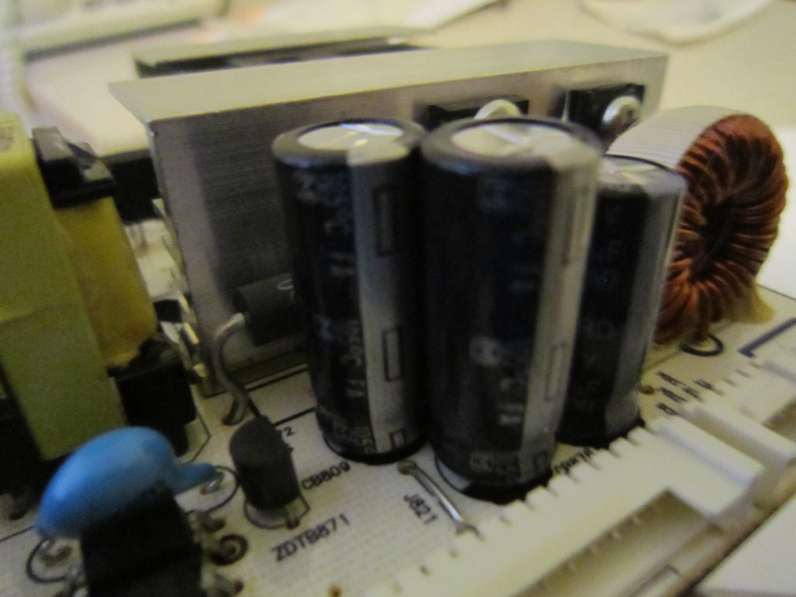

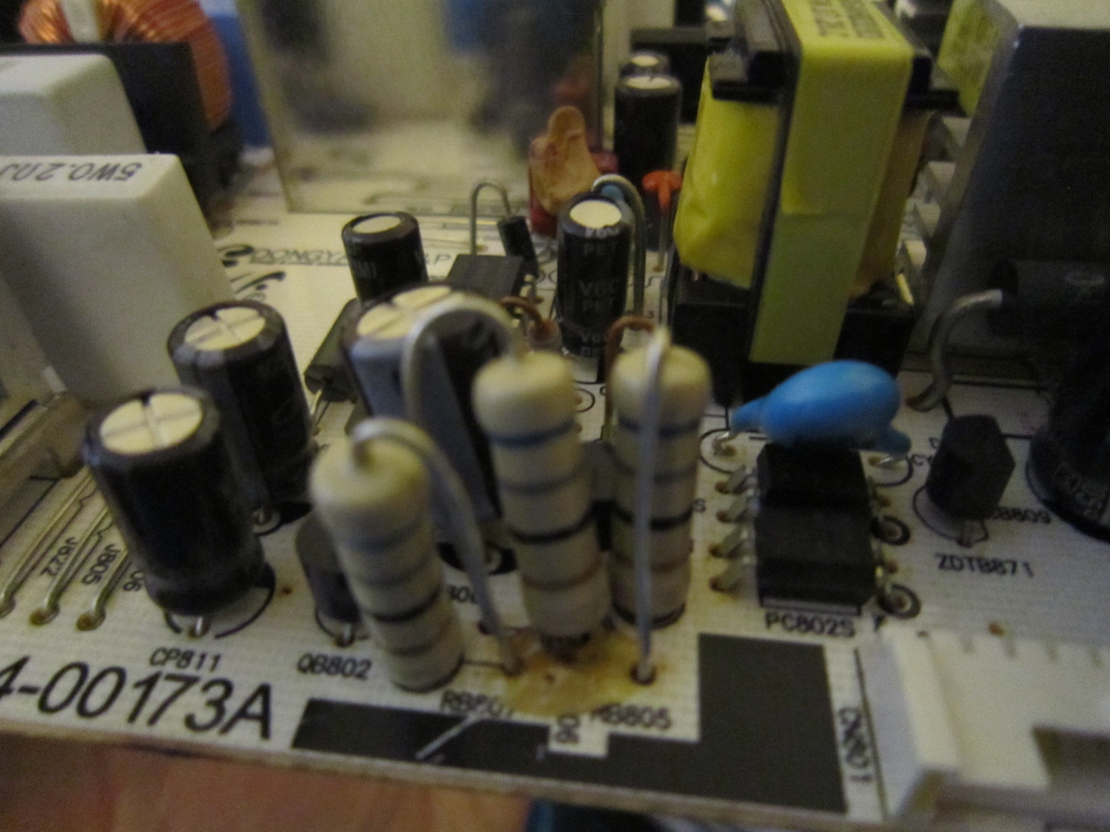

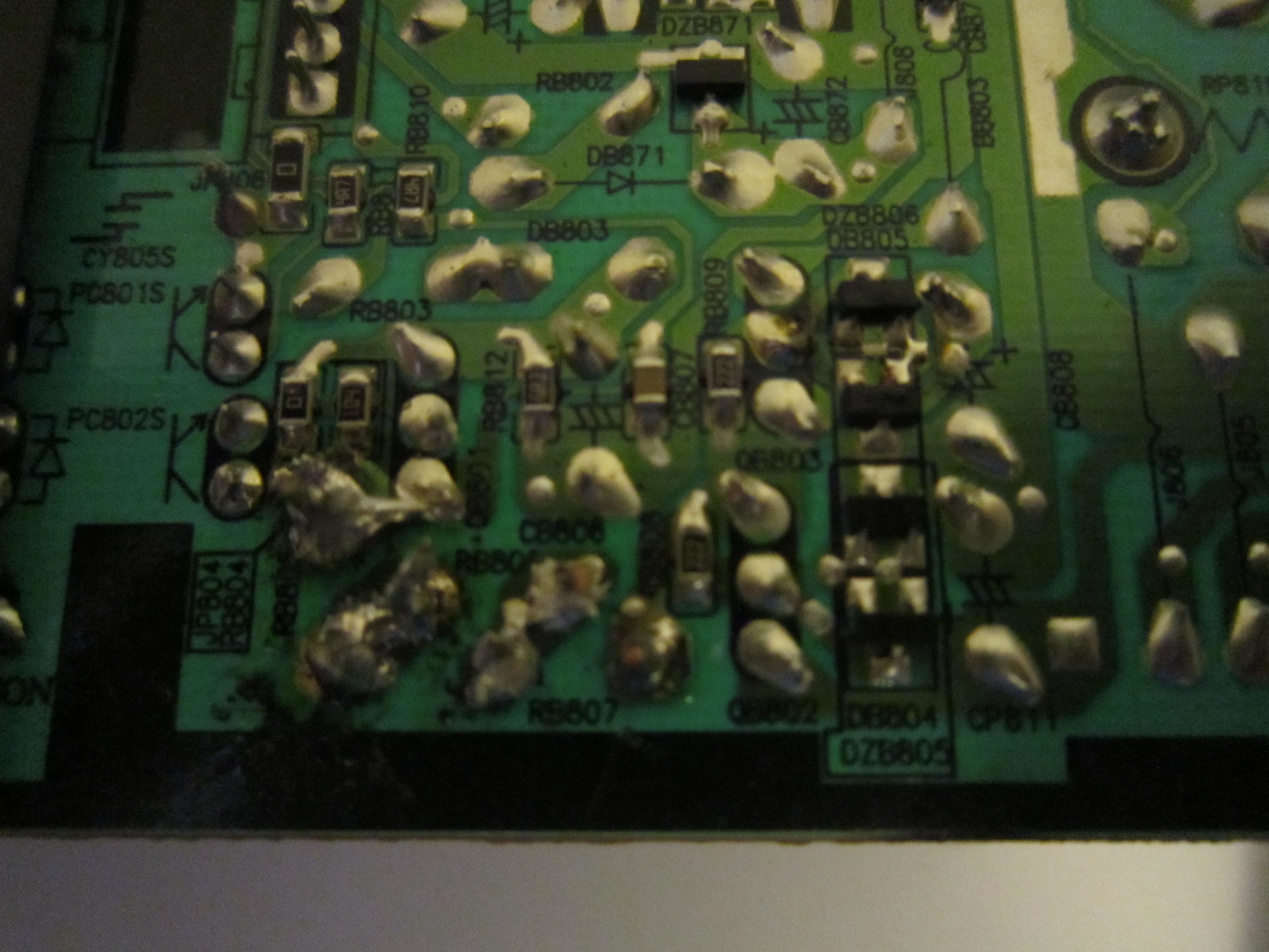

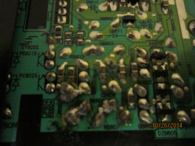

                                So i disassembled the monitor and have attached some pictures. Hopefully they are clear enough to make something of it.
                                I do not have a multimeter yet, but I could get one if need be. I just figured with the cost of the parts, I would go ahead and change them.
                                I did not change the fuses nor did I change the remaining capacitors that people say potentially could cause issues (cm862 & cm 863).
                                As for the fuses, do they have to be ceramic? I couldn't find ceramic ones at the electronic parts store but did find the clear, glass ones (for 1 dollar).
                                Thanks again.

                                  Yup, that definitely looks like a soldering problem. When done properly, you have this shiny little mound, that forms a metallurgical bond.
                                  I suggest you watch this video and try again. http://www.youtube.com/watch?v=I_NU2ruzyc4
                                  I'm not sure if one of those resistors is fried or not. You could probably start with new resistors, since they are so cheap. It looks like some of the solder may be bridging and actually touching another solder joint.
                                  Just solder like the guy shows in the video, and you'll have 6 shiny joints. Then make sure to trim the leads this time. Good luck.

                                    Yes, you should try to clean up those solder joints to start with. I also see what might be a lifted pad, but the images are too dark to tell for sure.
                                    Another good video is this one: https://www.youtube.com/watch?v=fYz5nIHH0iY
                                    And the first one where he discusses equipment: https://www.youtube.com/watch?v=J5Sb21qbpEQ
                                    If you don't have a multimeter you should get one. Aside from testing the fuses, you will need it for voltage measurements and further troubleshooting if cleaning up the soldering doesn't help.
                                    You can use glass fuses, but ceramic ones are better for safety. If glass ones blow hard they can sometimes explode.

                                      And to state the obvious: remove all of the brown glue on the entire board. In the background on one of your photos I can see another component covered by it. It's a tough job, but very necessary.
                                      If this glue isn't the cause of the problem with your 245 right now, it will be in the future. Usually the glue causes components to fail, which leads to collateral damage in other components.

                                        Agent 24 you may are right about the lifted pad (if I think I understand what that means). I tried to hold it down with extra solder but don't think it did a good job.
                                        What I will do is remove all solder, clean it up a bit and post some picture of the board all cleaned up and then maybe you can clearly see the lift and advise.
                                        Re-atari, any ideas on how to remove this clean (or the easiest way)?
                                        Lumberjack, yes some solder, although minute, is touching another point but it was like that for a week before it broke. Like I say I will clean it up and post some photos and take it from there.

                                          Yup, there definitely might be a lifted pad. As mentioned above check the polarity of the caps. If you have replacements for the caps you didn't change last time, do it now. They probably aren't the problem, but they might be, and they are, most likely, going to give you problems in the future so you might aswell change them now and same yourself some time and headache later.
