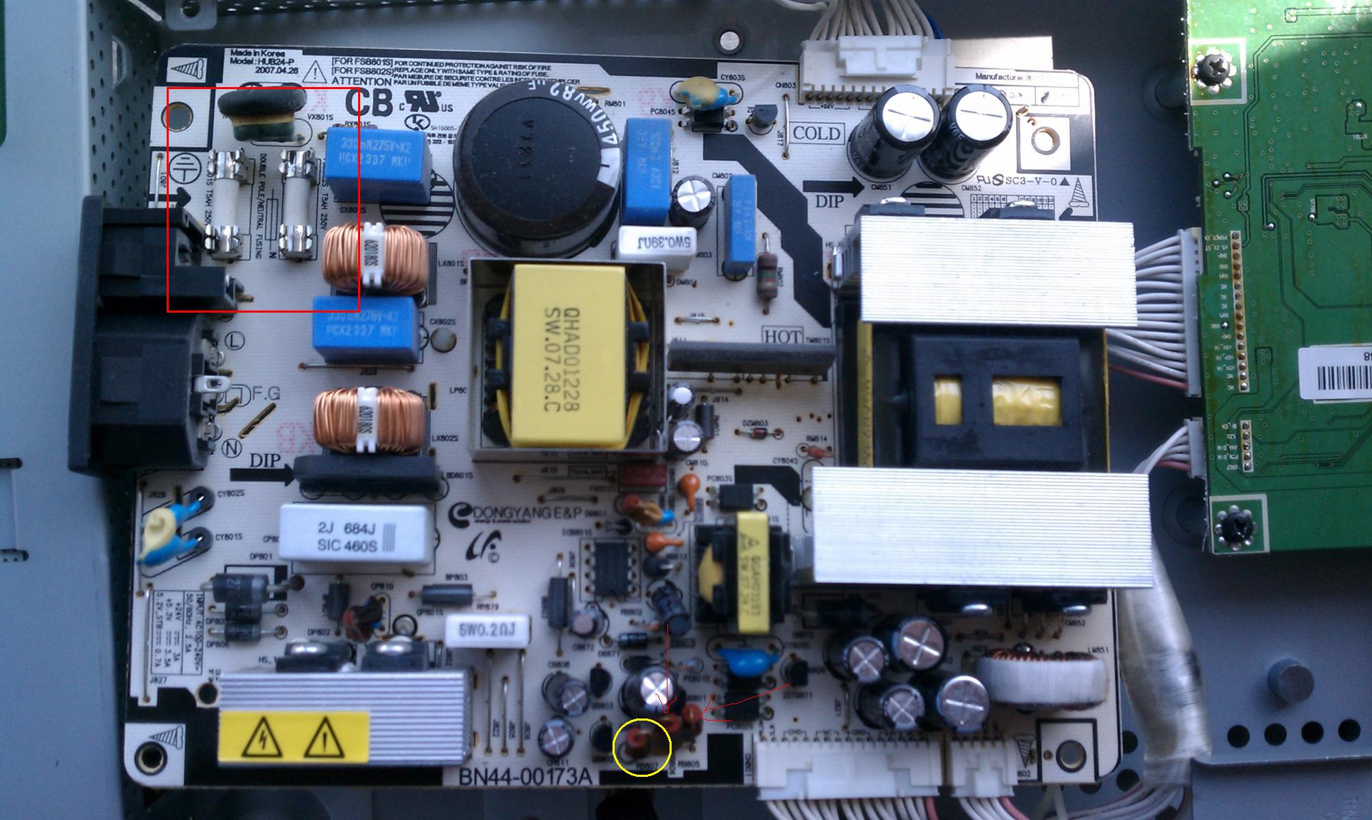

    You'll need to buy a digital multimeter. In this day and age, they don't cost an arm and a leg. Maybe somebody knows of one you could buy fairly inexpensively. I've had mine for years, so I don't know the current best deals on them.
    I think your problem might be with at least 1 of these 3 resistors. The glue turns brown and becomes conductive. You'll need to check the resistance on them. And we can also check voltages in other places with that digital multimeter.

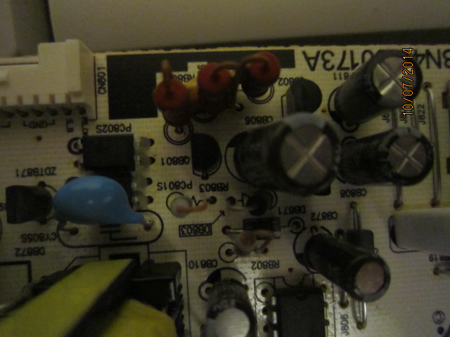

      I will get a multimeter. Now as for measuring the resistance, do I need to desolder the resistors off the board to test it or can I take the measurements while they are on the board? Also, what measurements should they be/read.
      I do see a lot of glue on many of the resistors, including another that is not mentioned in your three.

        Most of the time its best to remove at least one leg for accurate results. Since the glue is holding everything together. Here's what I'd do. Take some desoldering wick and remove the solder on the 6 legs of the resistors. Grab the whole thing and pull it out (all 3 resistors and the glue) You need to get the glue off anyways, and this method might make it a little easier. Then measure them. Look at the colored bands to find the ohms. Lots of places online will tell you how to read the colored bands.

          I just did a couple of these monitors (245BW), one of the 3 68 ohm resistors was open, Don't worry about the glue just break it away. I replaced all 3 resistors, You will also want to check the capacitors on the inverter board and see if they are bulging, if they are replace them. on mine 2 of the 4 caps were bad, again I replace all 4.
          If I remember the bad resistor checked open in circuit and was the one next to qb802

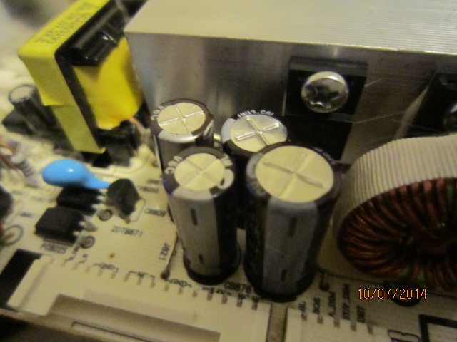

            R_J, I am not sure about the bulging on the capacitors. I attached some pictures of the capacitors in my first post, not sure if you can make anything of them.
            Do I need to do anything with the white fuses? Should those be replaced too? I guess once I take these components off I can take them to my local electronics store and show them so that they provide the correct parts for me as I wouldn't know what I am looking for.
            However, let me start with checking them first and I will post back.

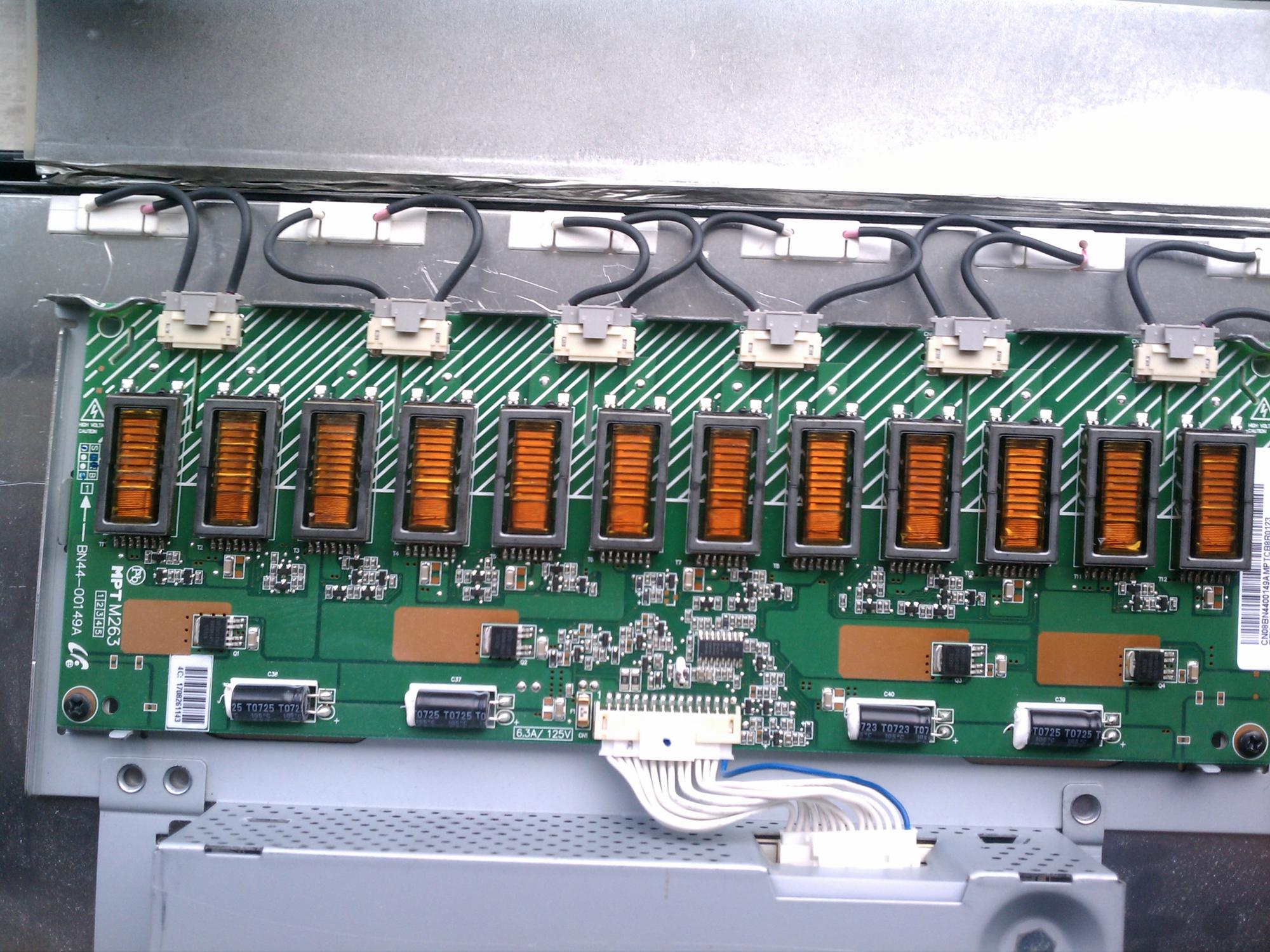

              Check the caps on the INVERTER, thats the long board on the left with plugs going to the backlight lamps, The ones on this inverter were CapXon 220uf/35v (green with gold text) If they are another brand they may be ok

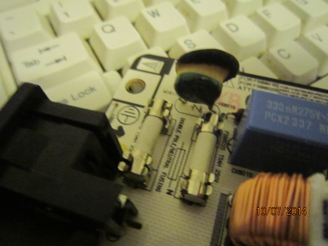

              Does the led on the front light? If it does the fuses will be fine. My guess is that one of the resistors (68 ohm) are bad and thats all. replacing it should get the monitor working.

                You lost me on the inverter Not exactly sure what you mean on the left or what I am looking for. Do you happen to have a picture.
                As for led on the front, no it doesn't light up (blue) when I press the power button.

                  You need a multimeter to check the fuses, they should check 0 ohms, they are ceramic fuses thats why they are white.

                        The fuses are those %%^^ ing white things in the forth picture you posted.
                        remember writing this: "Do I need to do anything with the white fuses? Should those be replaced too?"
                        "Is there a way to check the fuses. Not sure why they are white but if that is just paper can I remove it to see if the filament is blown?"
                        Check those 3 resistors in the picture in post #2 if one is open it is bad and needs to be replaced. That is most likley all thats wrong. There is no need to replace all the capacitors.

                              The fuses are the long narrow white things with silver ends and they look like stone (ceramic) in the middle. They should test short, or 0 ohms on a multimeter. I doubt they are the problem because I think they burn black soot when they go, but you never know.

                                I uploaded a picture of the power board, The fuses are in the red square, they can be poped out of the silver fuse holders. I have circled the resistor I found to be bad and have arrows to the two others I replaced,
                                On the monitors I repaired the standby voltage was working, this was indicated by the front led coming on. If you don't have the front led coming on then there will be other problems (ie: the fuse's check open)
                                If the the front led does come on then the standby circuit is working and the next most likely thing to check would be the resistor which if open and not the 68 ohms it should be will cause the main power supply to not turn on.
                                If you do a search in the forum for 245bw there is lots of information, but there are also two different power supply boards in this monitor.
                                If you don't have a meter etc to check this you could take the fuses out and have someone with a meter check them, same with the possible bad resistor, all 3 resistors should check about 68 ohms each if two check 68 ohms and one checks a lot higher it is the bad one.

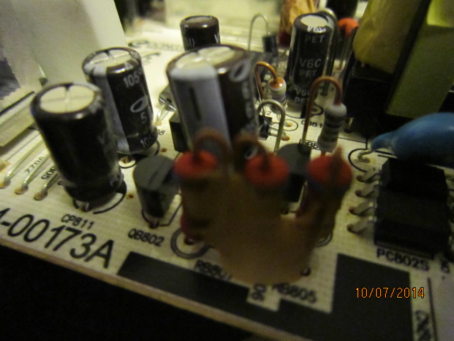

                                      Thanks so much for reaching out. So perfect timing. I got all the parts (3 - 68 Ohm 2W resistors, 2 - 1000 uf 16 V 10X24 capacitors ) solder/desoldered the parts on the board but when I turn it on, all I get is a white screen. The blue light on the power button however is working now.
                                      Note: I did test some of the resistors, capacitors and fuses however, since I wasn't sure if I tested them correctly, I decided to change everything since I got the parts for cheap.
                                      Any ideas? What did I do wrong?
                                      What I should also mention is that I only replaced 2 of the capacitors (the 1000uf ones). I did not replace all 4 not bec
                                      If you need pictures of what I bought or what I see on the screen (although like I say completely white) please let know.
                                      Thanks again.....
