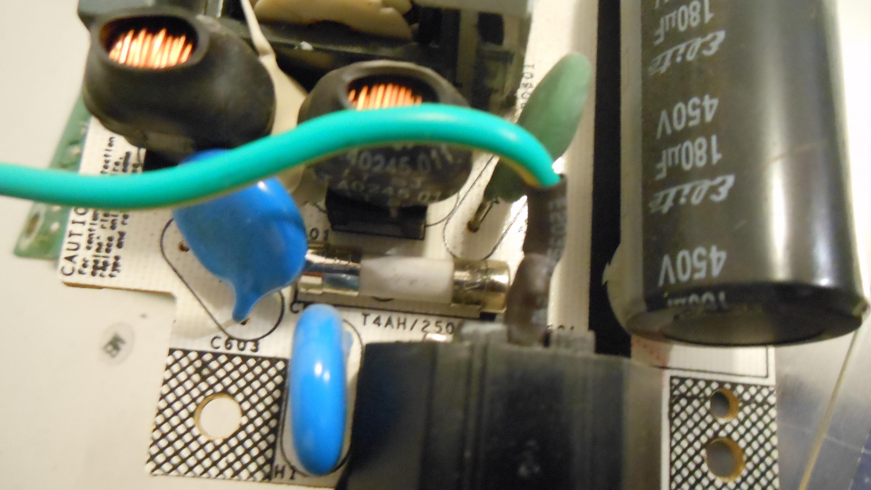

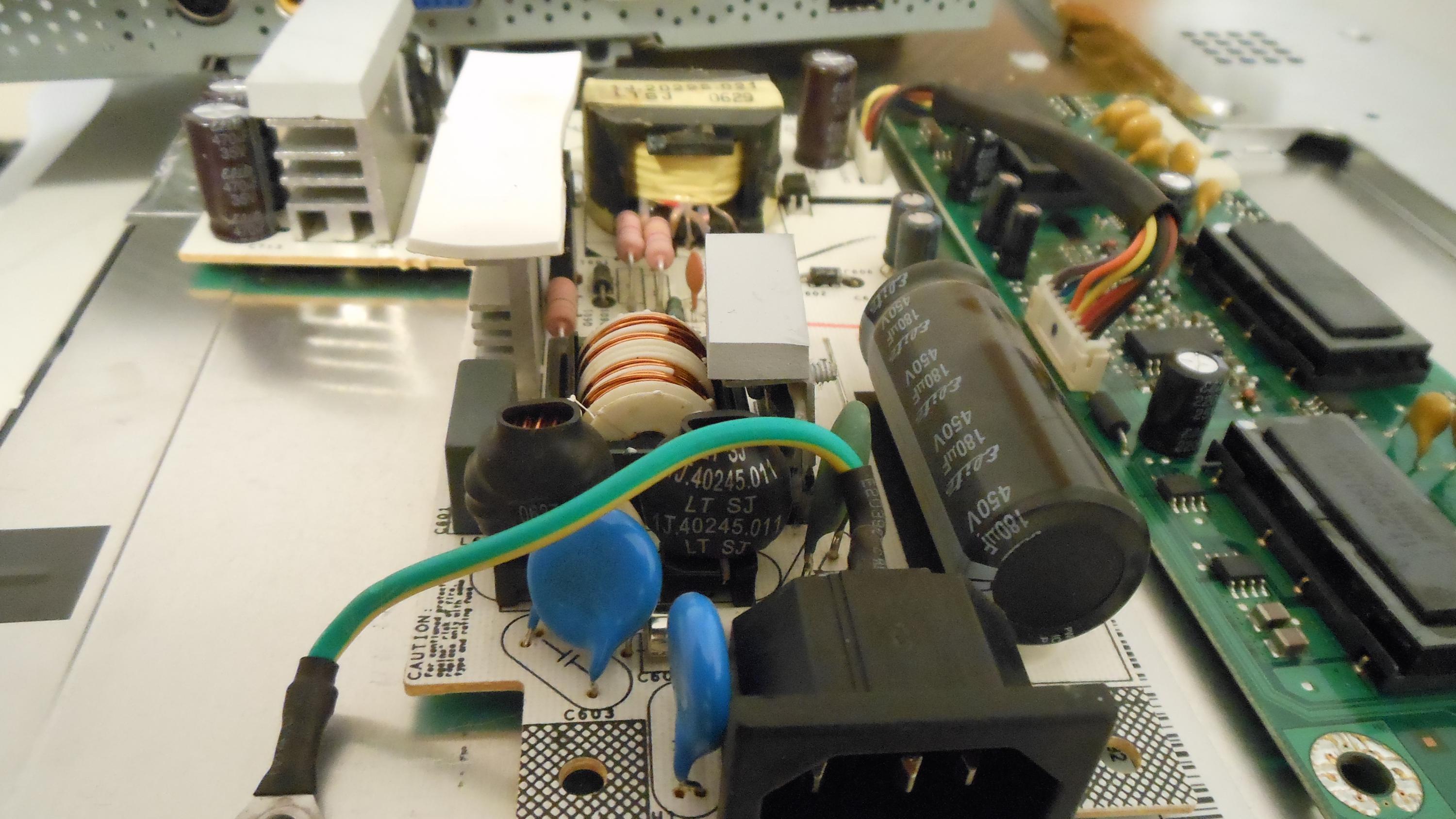

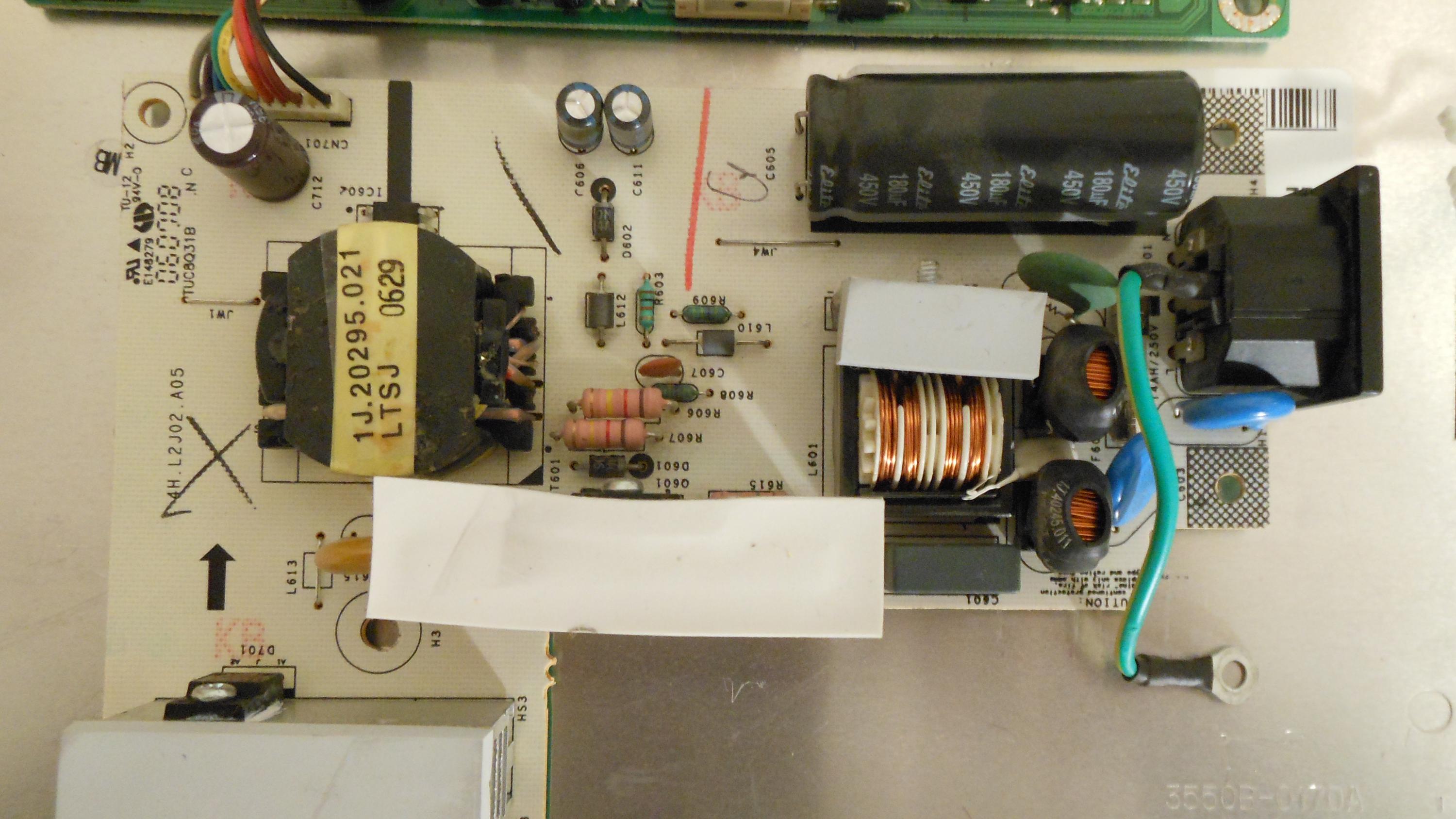

    My trusty Dell monitor is having issues and flickering off, sometimes for minutes at a time. The front panel buttons still glow yellow as usual, so power is still going through. When it flickers off and the dvi input is disconnected, it doesn't show the usual "no input signal" image so I'm pretty sure the problem is isolated to the monitor.
    After much effort I managed to take it apart (I'm a newbie) but can't readily identify any points of failure.

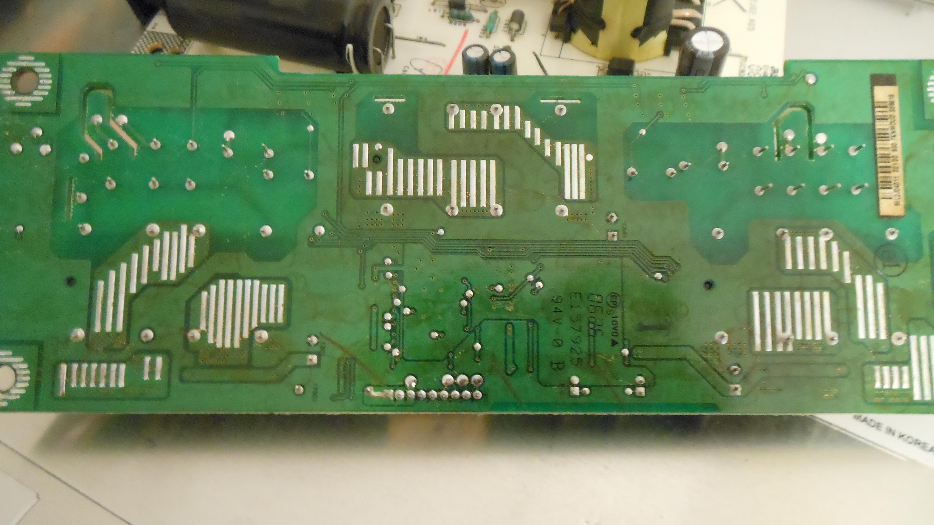

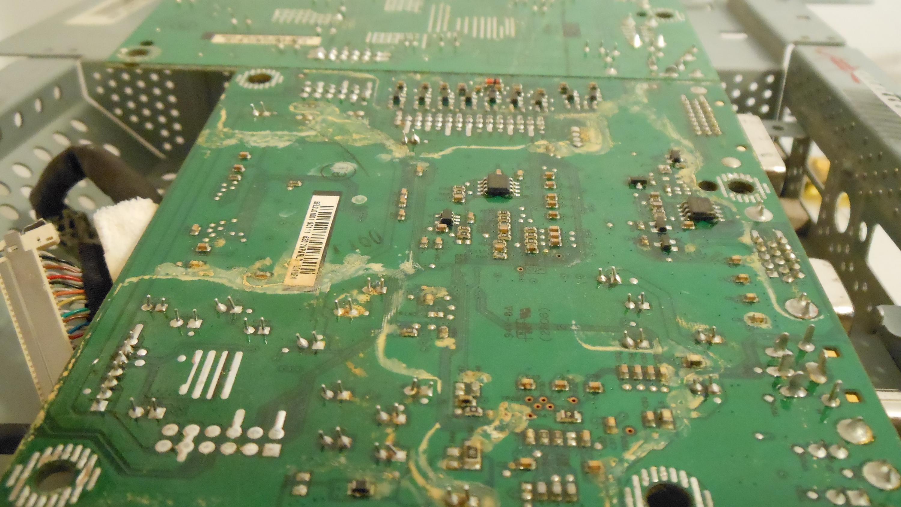

    Here we go. (I just realized the backs are useful as well. I'll those up soon if these are not clear).

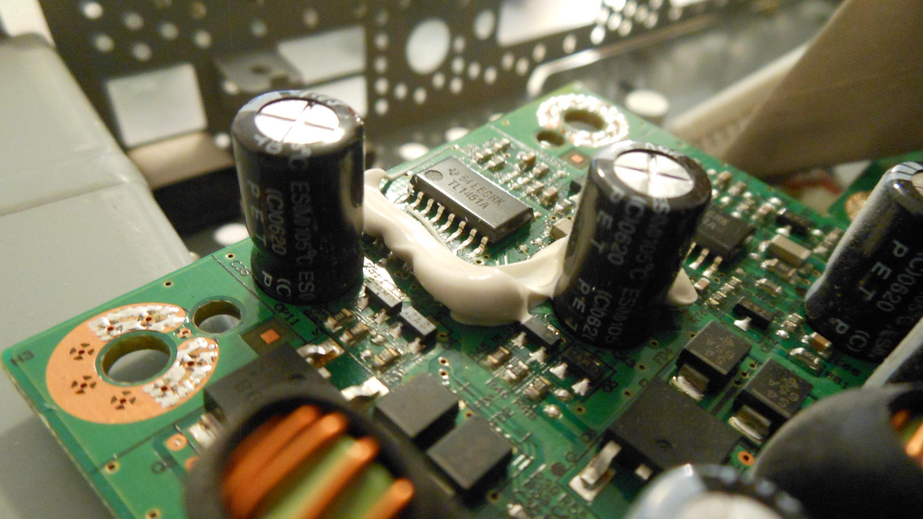

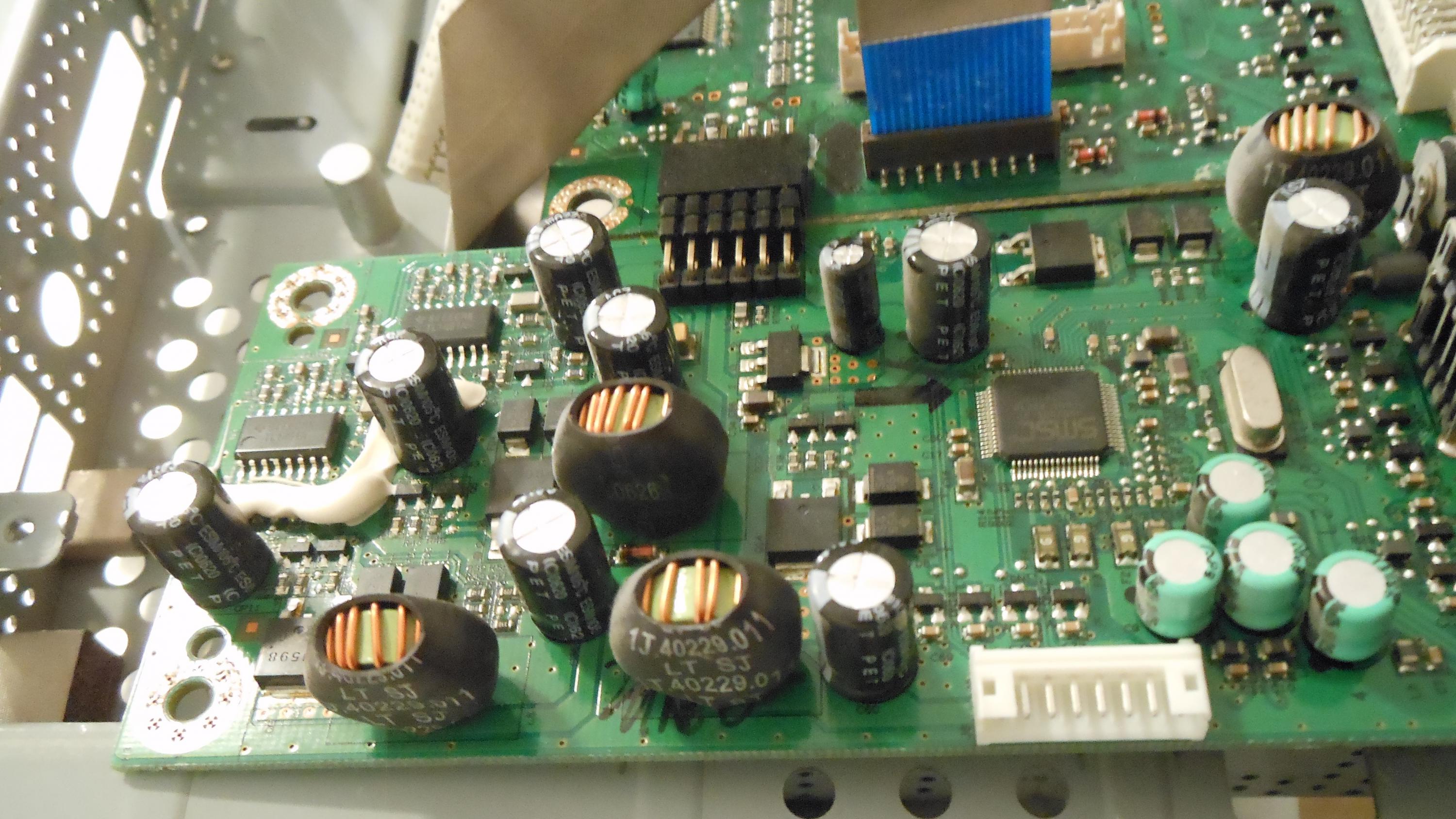

    It looks like one (next to the middle inverter transformer) of the 3 caps on the inverter board has domed top, or is it just the reflection.
    You may also want to read this thread:
    https://www.badcaps.net/forum/showth...007#post447545
    BTW, when it flickers off, does the LED on the front panel also flick off?

      Re: Dell 2007WPF Flickering Off
      No the LED on the front panel stays steady the whole time.
      Are you referring to the inverter transformer in the first picture and the two small black domes near the power supply plug on the right hand side?
        OK, the first picture is the power supply board, the second picture is the inverter board and 3 black inverter transformers. Now, do you see the cap with domed top?
          • 31151
          it is domed, the 3rd side-angle pic confirms it.
          goto say btw, i think that's the best set of foto's i'v seen someone post.
          what cam was it?

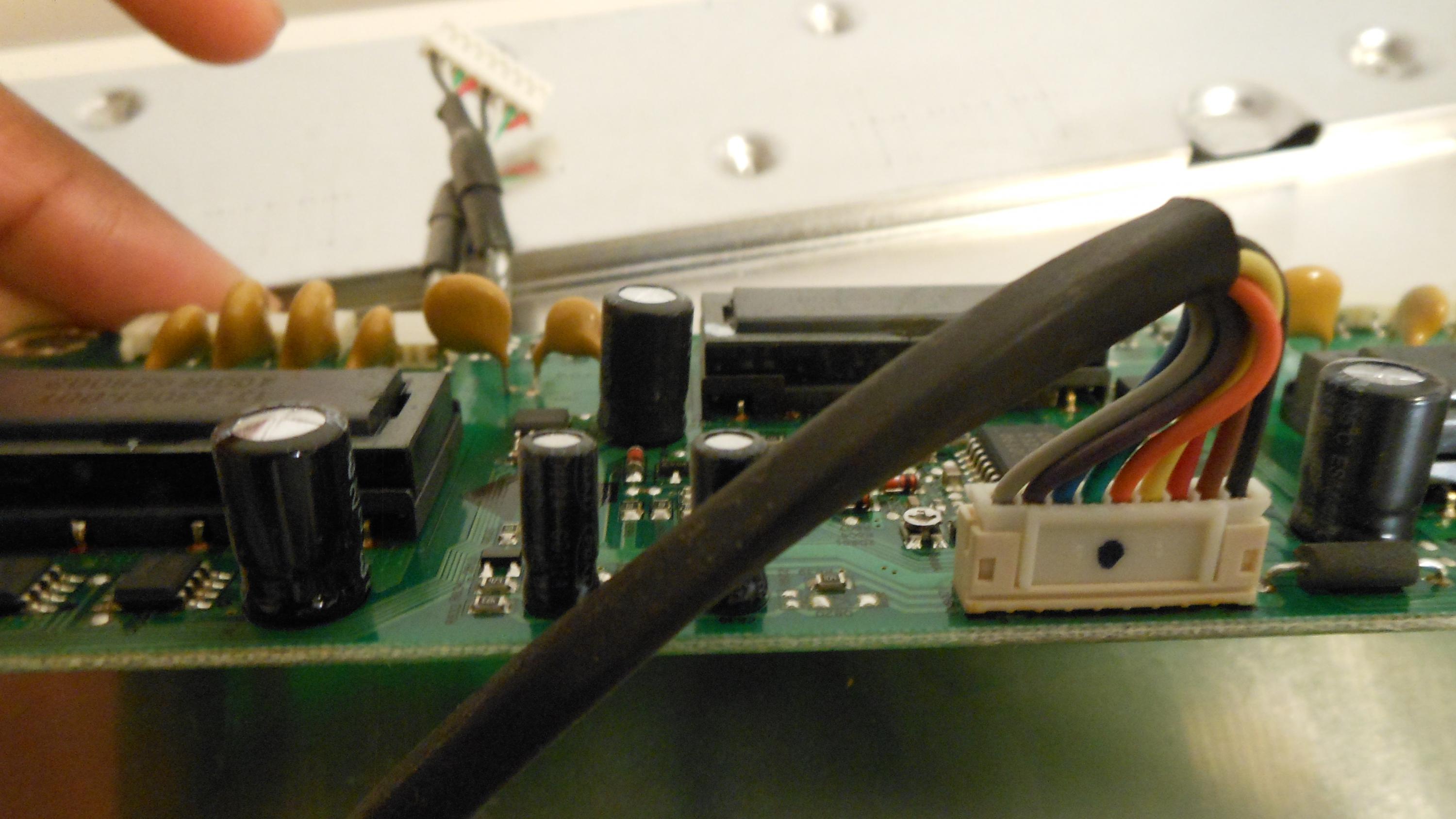

            @stj Thanks, I read a few posts and knew you guys need good photos to help
            Just an old nikon coolpix s6200 point and shoot I had lying around.

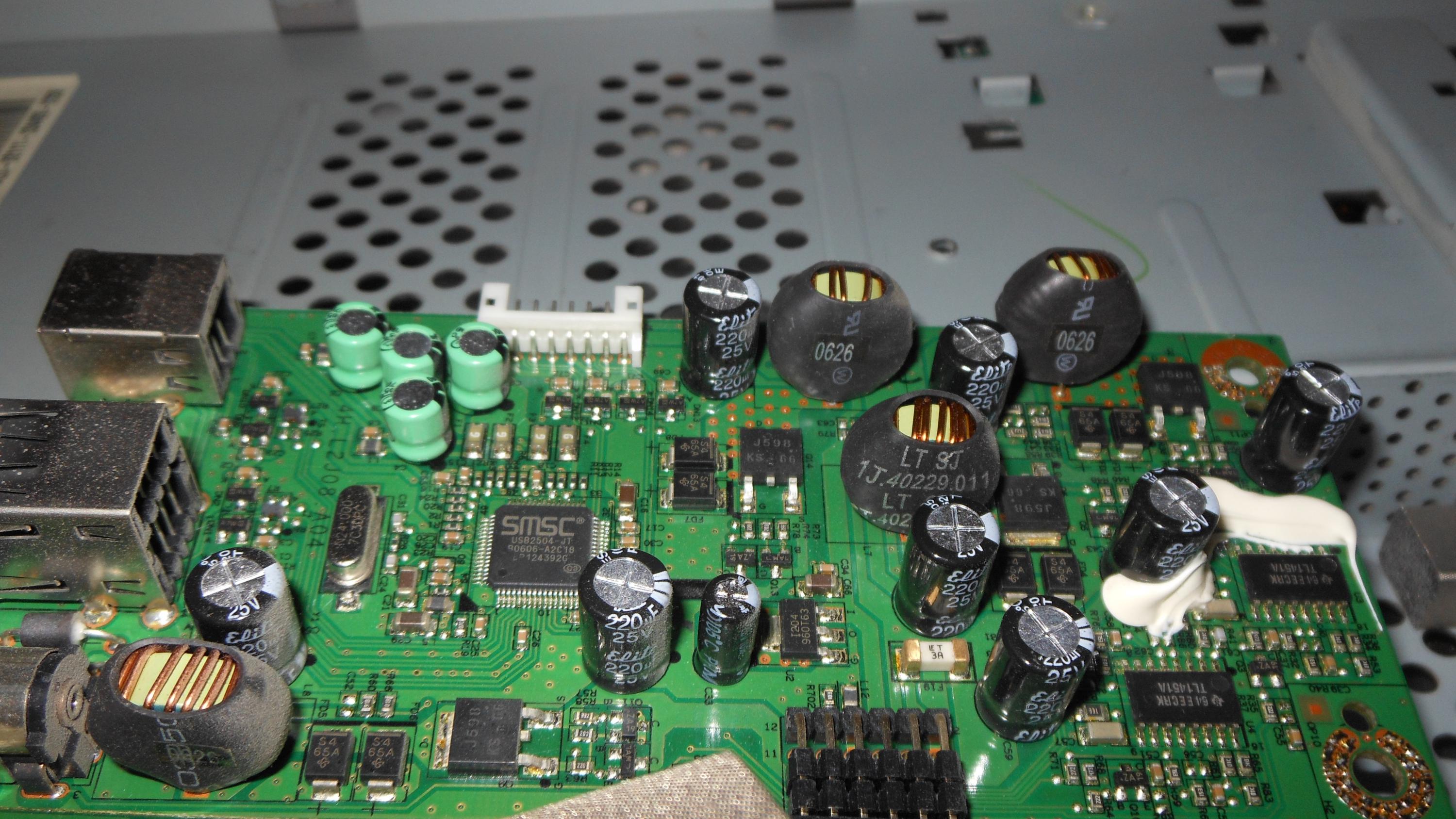

            I took a few more picks of the inverter to make sure. If it is indeed bloated, you think a swap could fix it? Does it sound like its the source of the problem I described?
            Can you visually tell if that fuse is dead?
            I also included pictures where there's some glue. How would you go about removing the glue to check the components underneath?
              I would replace all 5 on that inverter board since we already see that you have bad caps. You have to use Ohm meter to check the fuse,

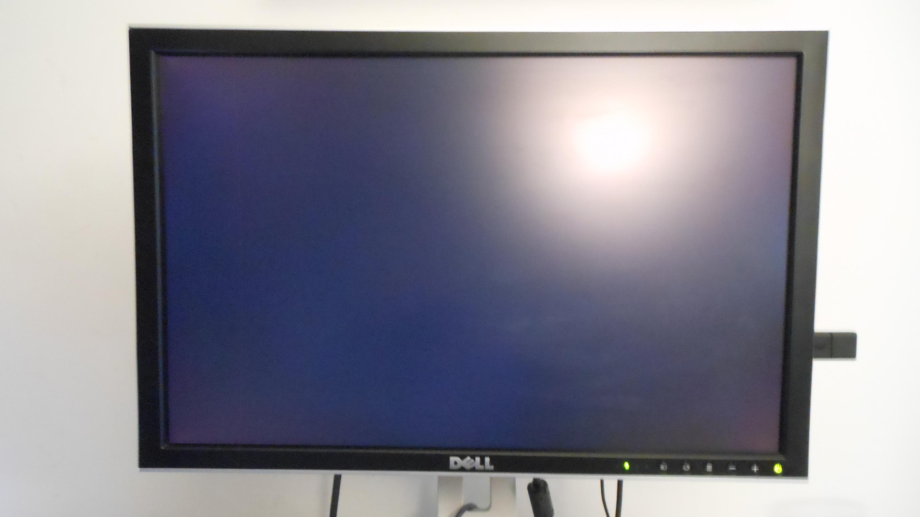

                              Good news and bad news. The capacitors were replaced. All 3 big ones but the problem persists. It's so depressing, I really thought I had it in the bag.
                              As you can see, monitor is on and power button is yellow (its orange when computer is off) but screen is black.
                              Any other ideas?
                              Anyone think this might be related to my PSU + GPU?
                                1) check fuse on inverter board.
                                2) verify new inverter caps are correctly installed.
                                3) re-seat wiring harness on inverter.
                                4) re-seat inverter ccfl connectors.
                                5) measure voltage at fuse on both sides with respect to ground.
                                  looks lit in the picture ????
                                  Try it in a dark room or look at the monitor from the back (this might show light leaking out through some small holes
                                  post a full picture of the back ?
                                    It sure does looks like the backlights are on. Did you put the LVDS cable back in place correctly?
                                    • aatroxed
                                      • May 2014
                                      • 24
                                      I will post pics but the monitor does turn on and I can use it. It just turns off intermittently for minutes at a time and at random. It's been fine for past 5 hours for example.
                                      • bammbammfran
                                        • Apr 2014
                                        • 476
                                        well, that is not what you posted the first time !!
                                        "As you can see, monitor is on and power button is yellow (its orange when computer is off) but screen is black."
                                        Might be weak bulbs, could be a power supply issue which is why I recommended changing those caps too while it was apart
