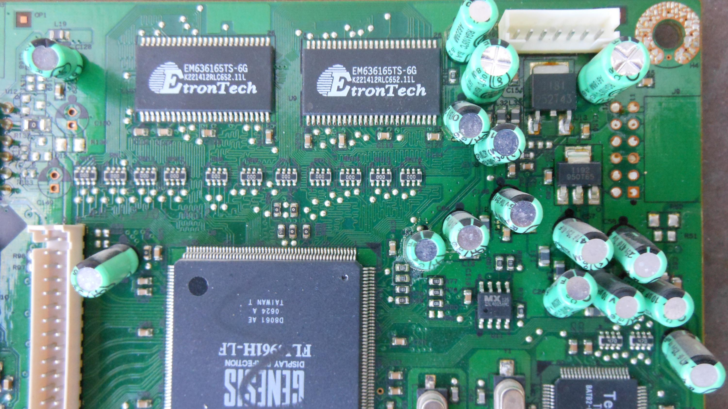

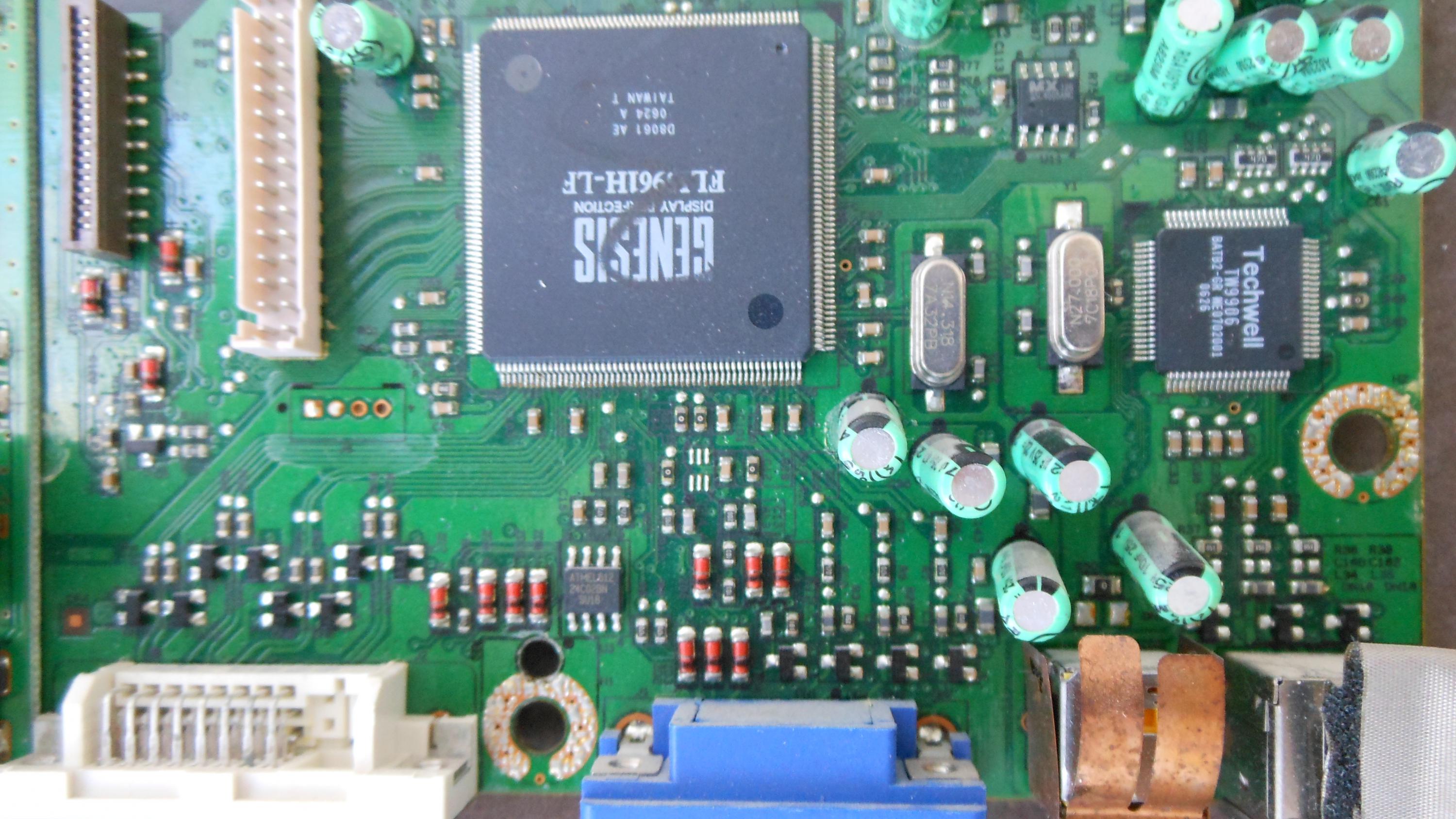

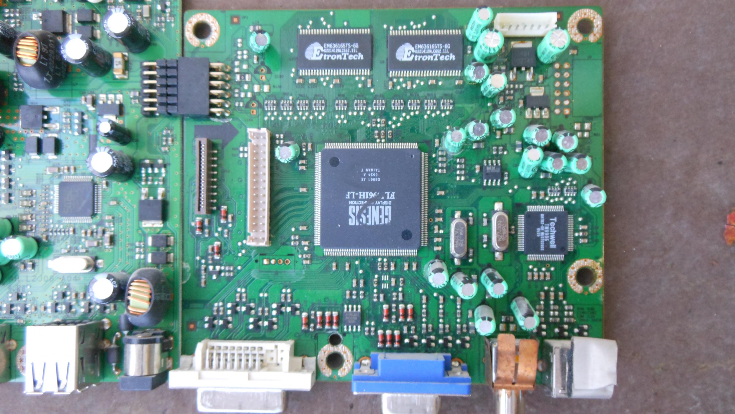

    Originally posted by aatroxed
    I'll take new pictures but are they not included in the original post that has pictures attached?
    They may be but it is not clear. As your photos are from the side of the boards on an angle, there may be regulators etc hiding behind other components. We would need a photo taken straight down on the board showing everything in on image to be sure.
    -David VanHorn
    • aatroxed
      • May 2014
      • 24
      #42
      Re: Dell 2007WPF Flickering Off
      I hope I got the right boards. I'll open it up soon again if not. I disconnected the monitor's usb ports power supply; doesn't seem to have changed much.
