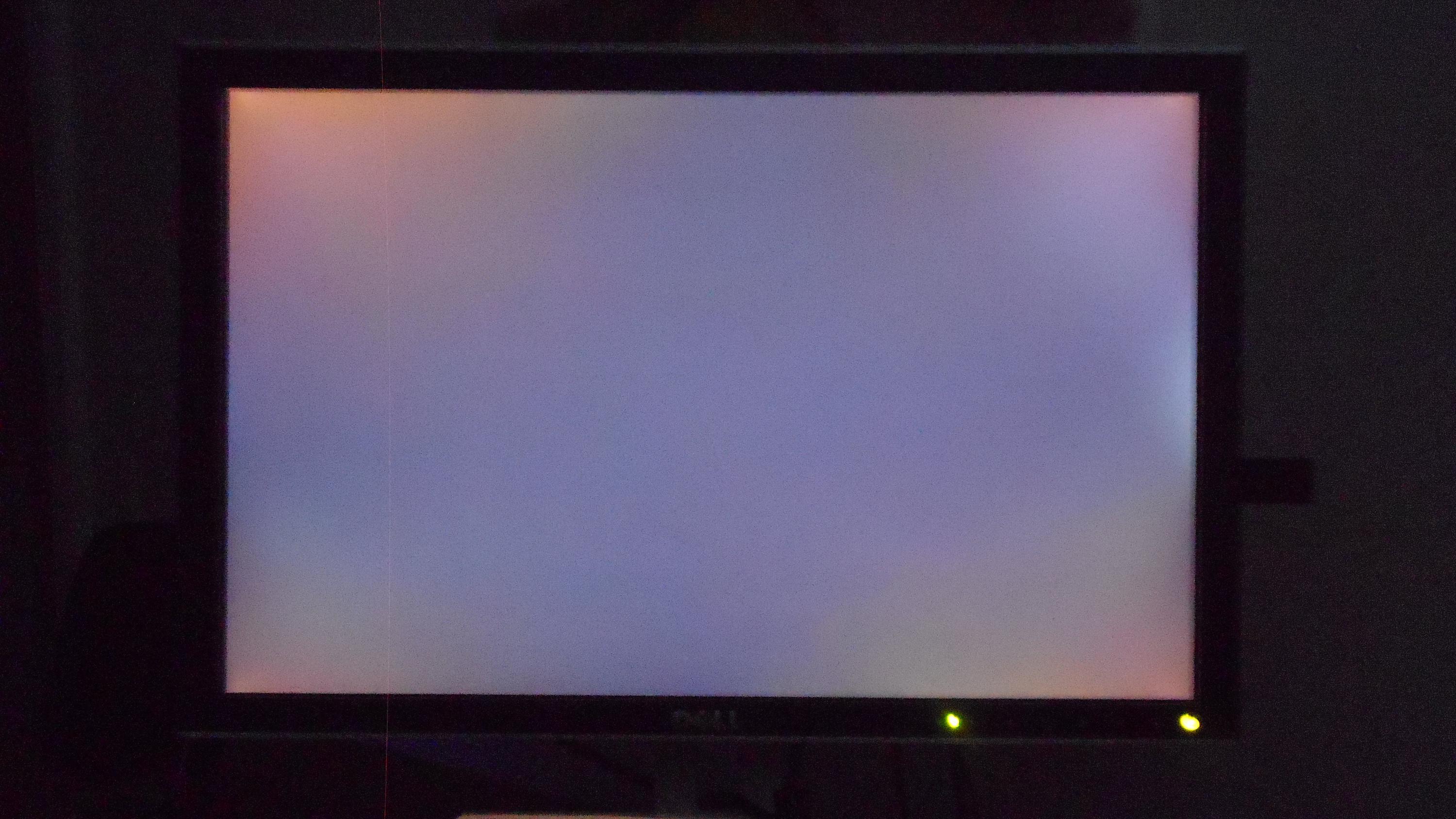

              "As you can see, monitor is on and power button is yellow (its orange when computer is off) but screen is black."
              Might be weak bulbs, could be a power supply issue which is why I recommended changing those caps too while it was apart
              Sorry, I guess my wording didn't come across clear in the OP.
              "The front panel buttons still glow yellow as usual, so power is still going through." That's what I meant that the monitor stays on but nothing displays on the screen.

                Re: Dell 2007WPF Flickering Off
                Originally posted by bammbammfran
                looks lit in the picture ????
                Try it in a dark room or look at the monitor from the back (this might show light leaking out through some small holes
                post a full picture of the back ?
                Hmm, here's a pick with lights turned off...
                It doesn't look that bright in person, that's the camera but the screen is "on", no display though.
                  It appears that it stays lit as far as the backlight are concerned
                  This can be sometimes be confirmed by light shining out through holes in the back of the lcd panel.
                  If that is the case, the power supply and inverter are probably ok and the issue could be in the main input board
                  Near the plug that has the wires that power the main board are two black chips that have 3 pins on one side (center pin might be clipped back) and there is a larger tab on the opposite side of the pins
                  What are the numbers on those two chips.
                  DO you have a dc voltage tester ?
                  on the video, I Did not really see flickering , but it looks like it blacked out and then came back on by itself ? Is that what it did or did you unplug something to make it black out ?
                            I just watched the video. It looks like the picture goes out but the backlights and power LED stay on. Is that correct?
                                It's not the inverter then, if the backlights stay on. Plus if it was, replacing the inverter would probably have at least changed the fault somewhat.
                                I did see earlier you had the idea it may be your PC. It is possible a faulty video card could cause loss of signal but not cause a "no signal input" message.
                                Before trying the hard stuff, have you tested your computer with a different monitor, or your monitor on a different computer?
