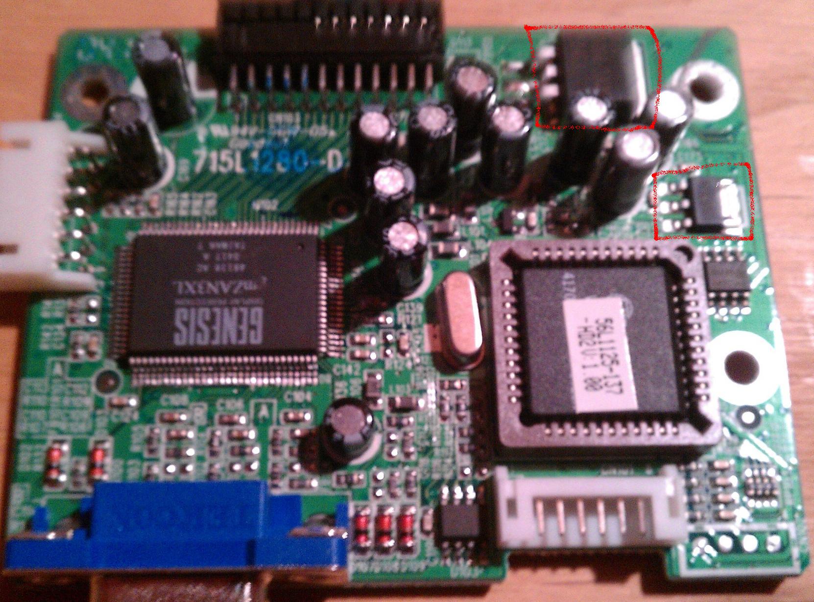

                              • jschiefer
                                • Nov 2009
                                • 19
                                #155
                                Re: Dell E153FPB Back Light problem
                                Also, When I hit the menu, the display stops flickering for the 2 seconds it takes for the menu to come up, then continues.
                                • retiredcaps
                                  • Apr 2010
                                  • 9271
                                  #156
                                  Take it apart and post some pictures following the instructions in my sig file (earlier post).
                                  --- begin sig file ---
                                  --- end sig file ---
                                  • jschiefer
                                    • Nov 2009
                                    • 19
                                    #157
                                    Okay, Here are some pictures. I took a bunch and these are the best. Hope they work. I had to resize them, I hope I didn't lose too much quality.
                                    • retiredcaps
                                      • Apr 2010
                                      • 9271
                                      #158
                                      There are 2 voltage regulators on the main/logic board.
                                      1) List the part numbers off the chip.
                                      2) With your multimeter, measure the DC voltage of each pin with respect to ground.
                                      3) When the problem occurs, re-measure the DC voltage on each pin.
                                      4) When the problem occurs, also measure the DC voltage of each connector pin between the power and logic board (yellow/red cable).
                                      We are looking for any fluctuation in DC voltage to see if this is causing the monitor to flicker.
                                      • jschiefer
                                        • Nov 2009
                                        • 19
                                        #159
                                        Okay, I got the measurements. I apologize. I didn't mean for it to that long, something came up.
                                        Anyways the numbers on the chips are:
                                        AIC 1084-33CM 584G3 (larger one) PDF Datasheet
                                        BS18532G3 (smaller one) Maybe the end is 63? I couldn't find any information on this chip.
                                        The first chip, (1084-33CM)
                                        0v --- GND
                                        3.26v --- Vout
                                        4.69 --- Vin
                                        The second, (BS18532G3)
                                        0v ---
                                        1.77v ---
                                        3.24v ---
                                        I think these are okay after looking at the datasheet.
                                        Here is the molex connector coming from the PSU board to the video board.
                                        Starting with the yellow pin at the (top)
                                        Y-2.97
                                        Y-2.89
                                        Y-11.66
                                        Y-0 ???
                                        Y-5.05
                                        R-0
                                        I checked these measurements twice, and with a second meter. They are within .01v. The voltages didn't change when the monitor is more blurry than times when it is not.
                                        • retiredcaps
                                          • Apr 2010
                                          • 9271
                                          #160
                                          Yes, they are okay.
                                          Well, I'm out of ideas.
