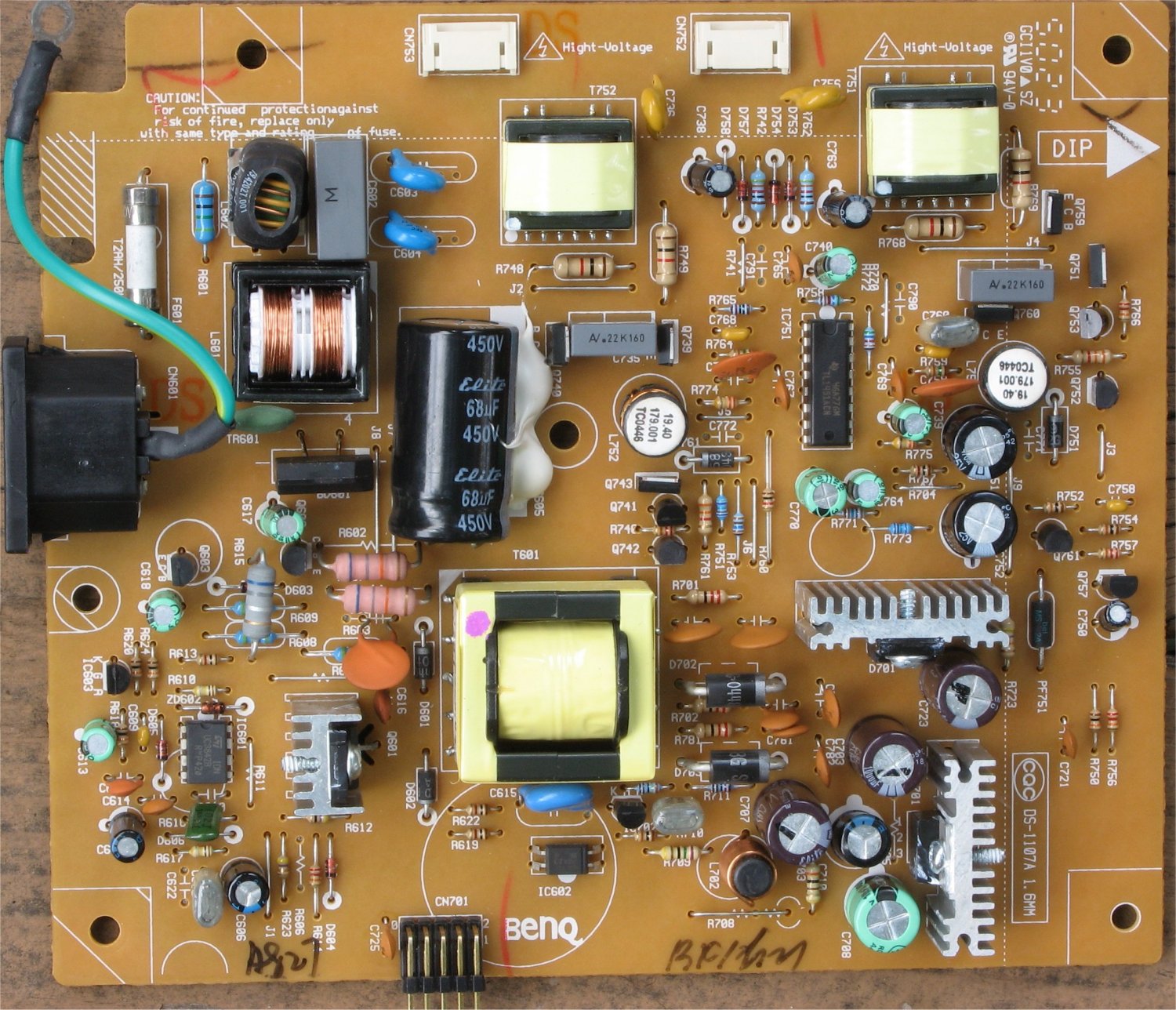

                        Probably a leaky transistor. Provide GOOD pictures of the inverter board and we can identify twhat to test.

                          #32
                          Re: Dell E153FPB Back Light problem
                          ok will do, the picture is attached of the Inverter Board.
                          • PlainBill
                            • Feb 2009
                            • 7034
                            #33
                            Great picture!! I've marked it up. The four transistors circled in red should be checked with an ohmmeter. We are looking for differences between one pair and the other.
                            Also, two transformers were circled in blue. Resolder the leads on all of them.
                              Thank you very much for the quick reply. I will resolder and check with Ohm Meter tomorrow.
