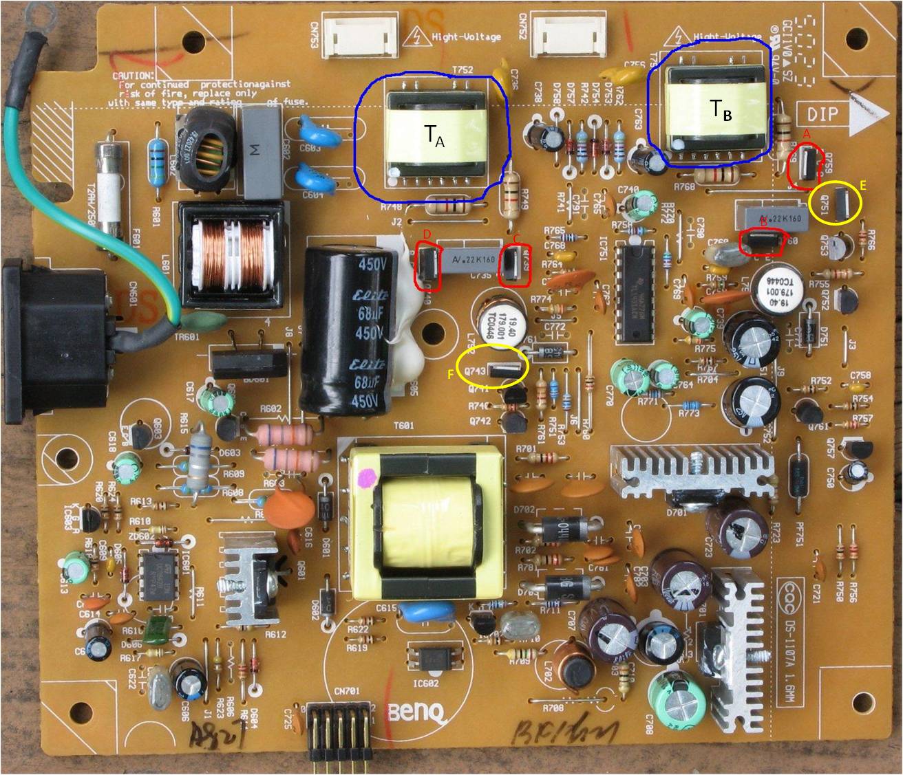

                A friend gave me a Dell E153Fpb monitor. It has the same problem that has already been discussed here. The Fuse (PF751) seems to have blown. I measured the transistors (see enclosed pic) and they seem ok but i wanted to get a 2nd opinion on my measurements.
                I used the diode check feature:
                Transistor A:
                Emitter(Red lead)-Base(BLack lead): 0.5V
                Emitter(Red lead)-Collector(BLack lead): 0.183V
                Transistor B same readings as transistor A
                Transistor C:
                Emitter(Red lead)-Base(BLack lead): 0.499V
                Emitter(Red lead)-Collector(BLack lead): 0.182V
                Transistor D same readings as transistor C
                Transistor E and F have markings of J598. Cant find it on the net. So i used resistor measurements between the 3 leads.
                Transistor E:
                Pin1(Red)-Pin2(Black): 7.61Mohm
                Pin1(Red)-Pin3(Black): 25.37Kohm
                Pin1(Red)-Pin2(Black): 0.493Kohm
                Transistor F:
                Pin1(Red)-Pin2(Black): 7.68Mohm
                Pin1(Red)-Pin3(Black): 25.39Kohm
                Pin1(Red)-Pin2(Black): -128Kohm
                I also re-soldered the pins of the inverter transformer.
                I have a spare 2A fast blowing fuse but i didnt want to put it into the board until i was reasonably sure the the mosfets were ok.........
                Do you think if i have resoldered mosfets and transformers that this will fix the problem. Any think else i should do to help prevent fuse from blowing again in the future?

                  #108
                  Re: Dell E153FPB Back Light problem
                  I would also check Collector to Base on the four 5706/5707's,and then the associated E and F if necessary.The fuse can fail for no particular reason(maybe age...like me),and I also resolder the transformers, the grey caps behind them and the two coils behind them.
                    Transistor A:
                    Transistor C:
                    I assume the above measurements are in circuit? I measured a similar working Benq board and I get like readings on the E-C in circuit. I get 0.177V and I know my board works.
                    Transistor F:
                    Is that a negative 128K ohm reading or a typo?
                    I think resoldering all the transformer pins and the c5707s and J598 should be all you need.
                    PS. Great clear focused picture.

                            #113
                            Well, i resoldered all the tranformer pins and the pins of the transistors.
                            I put the new fuse in and its working fine.
                            Bad thing: The only fuse i had was a 3.0A Fast blow fuse. The original fuse was 2.0A. So i will probably have to order the 2.0A fuse but for now it seems to be working.
                            Thanks for the info retiredcaps.
