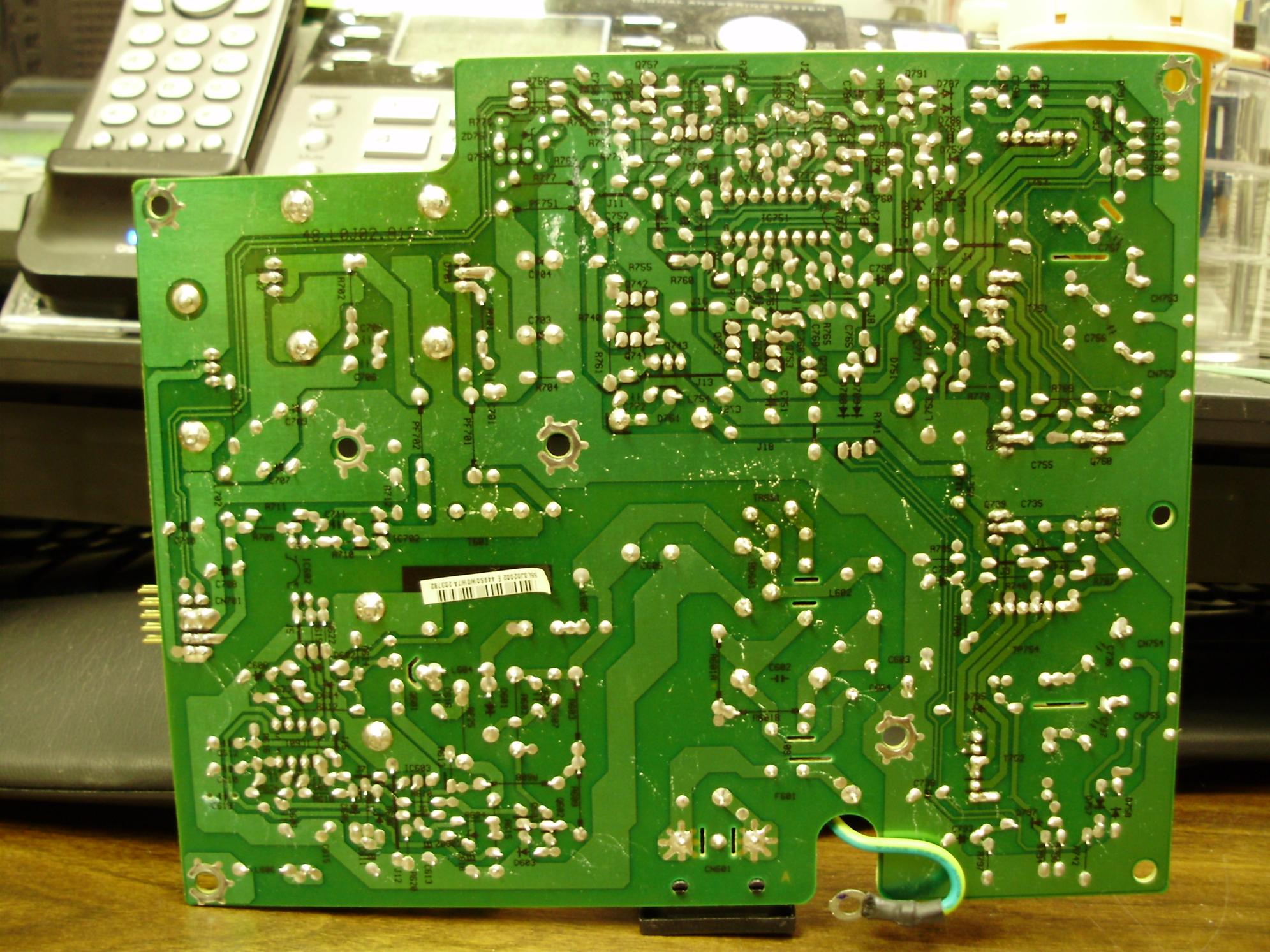

    Take a good quality picture of both the top and bottom of the power supply / inverter. Don't use someone else's picture this time. There are at least two different versions of this monitor. Attach it to your next post.

      Thank you PlainBill, I will upload pictures tomorrow. In the mean time I tested the transistors again and I'm getting continuity between the collector and emitter, which means they are bad right?

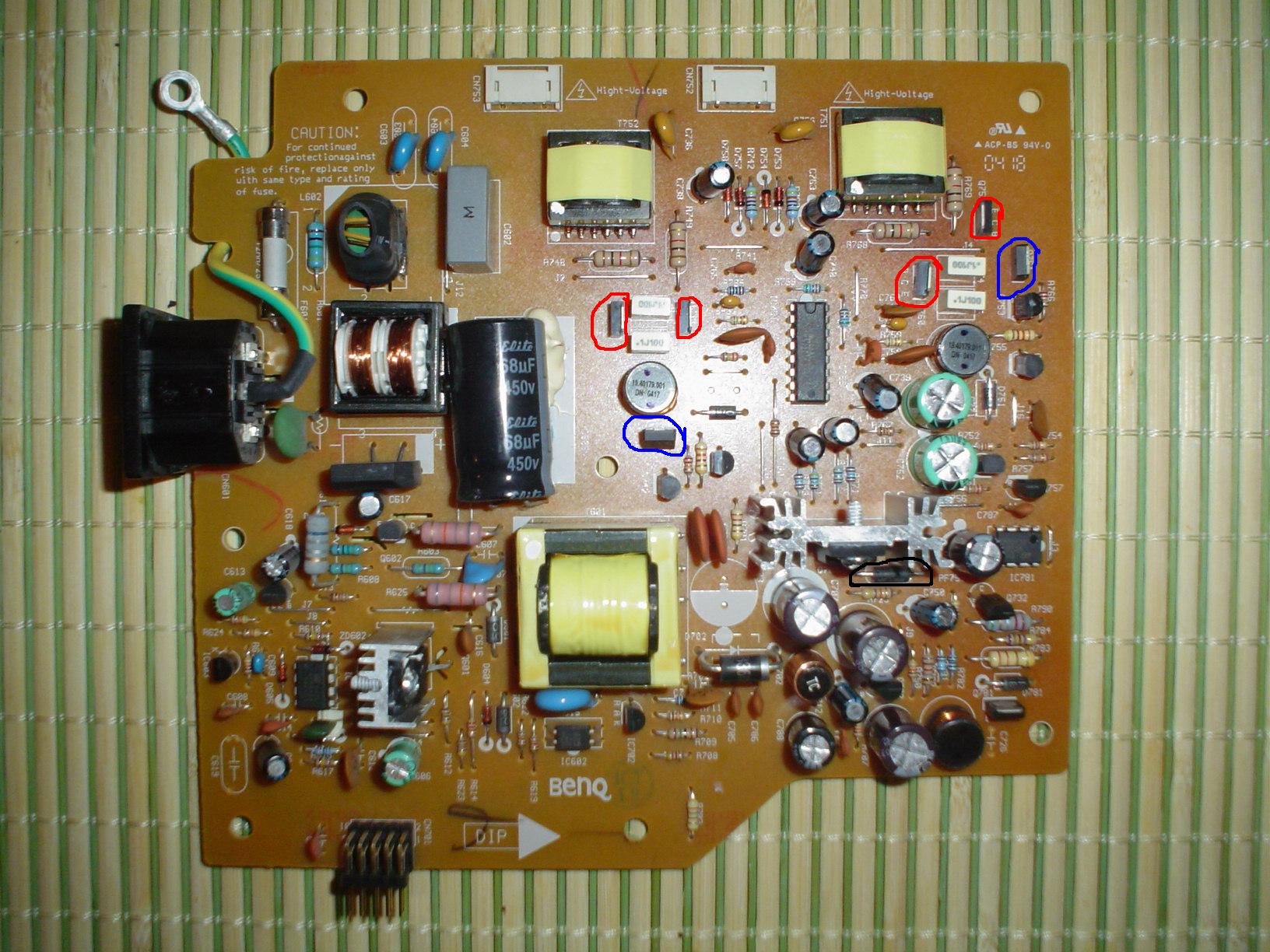

        Define 'continuity'. If you mean 10 ohms or less, you are exactly right. This is a fairly common problem with these boards. Here's what you do:
        Check for C-E shorts on all four transistors (circled in red). If only one of a pair is shorted, replace both. Check the FETs for shorts (circled in blue). Replace if shorted, natch. IMPORTANT: Resolder all terminals on the transformers, even if they look good.
        The parts can be found on eBay. You can buy kits of all parts, or if all you need are just the transistors you can buy them.

          The Dell E173FPB I repiared is at it again. When I plug it in I see the Dell Logo for just a split second and it goes dark. Using a flashlight I can see the Dell Logo is still there, just not lit up. I have replaced the Pico Fuse and all 4 of the C5707's and it worked for a few weeks. Now its back to doing the same thing. I have resoldered every connection that even looked funny. I paid particular attention to the spots reccomended on the forums. Any other idea's or things I can test? Thanking you in advance.
          Pictures are attached

            If you resoldered all 4 Inverter Transformers then it is possible that you have a failing CCFL
            Its is probable that you now have a failed C5707 again due to the initial fault being missed

              You are correct. I just pulled the C5707's out and checked them with my MM and 1 was bad again. I replaced all 4 just to be sure but now 1 of the legs on one of the C5707's refuses to take any solder. I cleaned the area and am using rosen core solder but it will not take solder. I think that spot has just be soldered too many times. Im going to scrap this monitor also. Thank you for your assistance Sir
