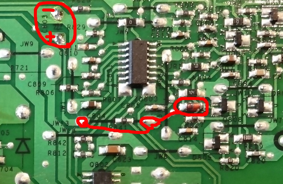

          Ok Guys, I think you might be spot on the ball with the Zener.
          • Removed JW13 and measured the capacitor voltage: 5V more or less.
          • Just to rule it out or rule it in, I removed the zener and tested the voltage across the 10ohm resistor; it had (I think) 0.8V drop across it
          Do I have to replace the zener? Do you think it failed as a result of another failure in the circuit? How do I know the specs to replace the zener with? It was reverse biased (it seems) so the reverse bias break down voltage is important, I gather.
          What do you think?
          PS: Sorry about the photo, my camera is broken had to borrow a camera to take the below, hope that's high res. enough. I thought I'd clean the board with isopropyl but it ended up with hazes and streaks, tried to clean it to the best I could...

            Re: Dell ST2410b Backlight Shuts Off
            This is the result with isopropyl?! It seems all corroded..
            For the zener you can download the inverter ic IC801 datasheet and see the Absolute maximum ratings, at the voice Vcc that is approx. the rate of the zener.
            "Do I have to replace the zener?" yes. "Do you think it failed as a result of another failure in the circuit? " I don't know but it's probably an overvoltage that shorted the zener, maybe for one of the big caps.

                  #48
                  Put it of 7V and go for sure.. its for protection you can trash it away and test the monitor all hooked up and see if works.. then replace the zener

                    #49
                    Sorry, what did you mean by "Put it of 7V and go for sure.."?
                    I have removed that zener diode and hooked it all up. There's a full image on the LCD. BL_ON about 2.5V but still no light. So I disconnected the the BL_ON from the Video board and routed 3.2V from the Power line in to the BL_ON for the slim chance that it may require TTL logic levels. Still no light.
                    Should I check the waveform being fed in to the output transformers to make sure there is activity on the output stage? Do you know what the voltage levels are in to the primary of the transformers that drive the CCFLs? My ameture scope can only handle about 80V input, so I don't want to fry that.

                            #53
                            "Sorry, what did you mean by "Put it of 7V and go for sure.."?"
                            I mean put it at 7v (the zener) and you are sure.
                            You have the pinout of the inverter ic so check the waveform of the 4 outputs, pin 6,8,9,10. If you find that waveform then check those sop8 chip dual mosfets Q801 and Q802.
                            As you can see from the diagram selldoor posted each dual mosfets have pin 3 at the supply voltage (Vin) for the inverter circuit , that is the same as the voltage at the cathode of D705.
