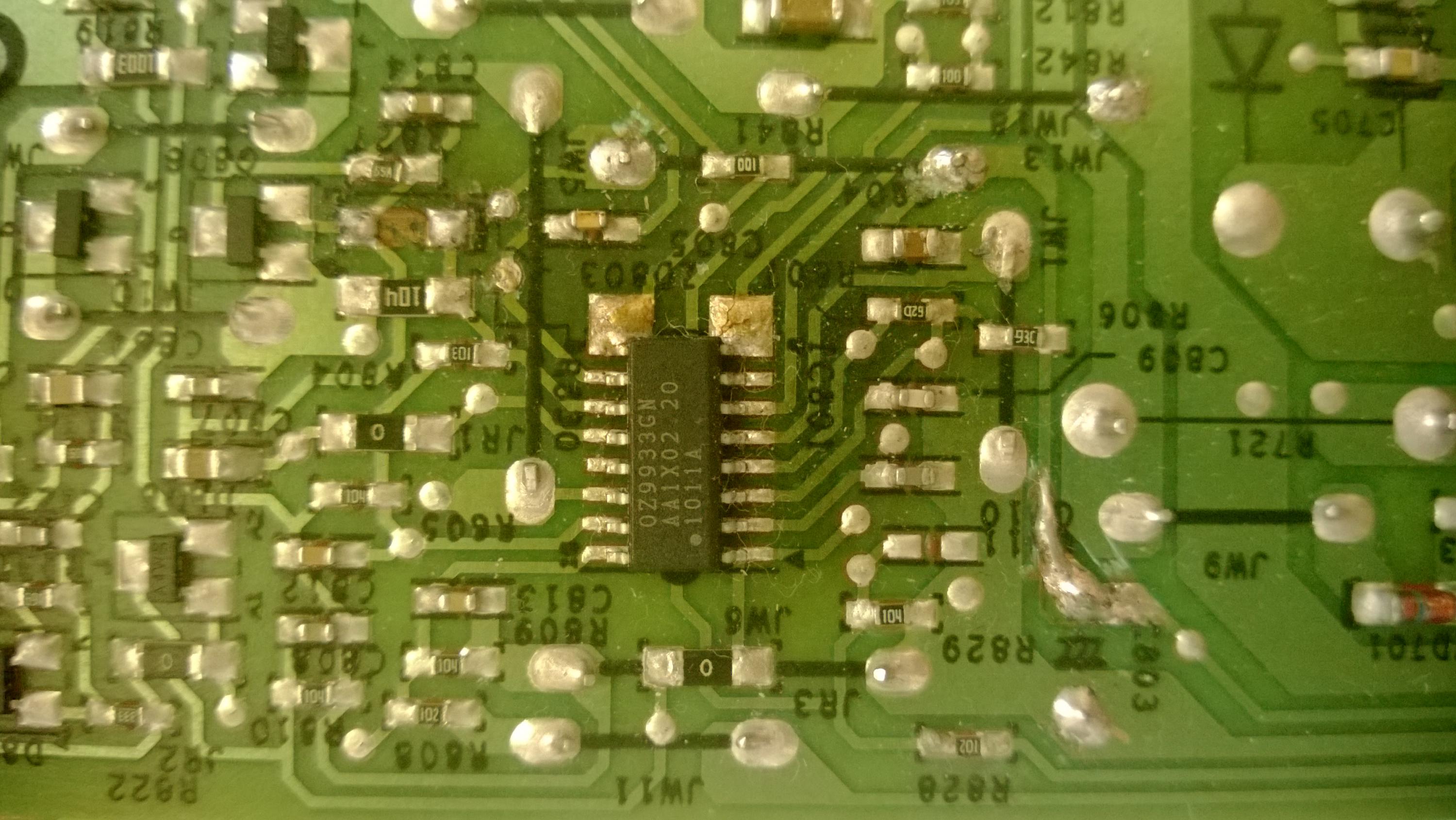

    I'm ashamed of the desoldering to be honest. I'll manage a shot and upload it.
      #62
      Re: Dell ST2410b Backlight Shuts Off
      Sorry guys, work, life etc getting in the way...

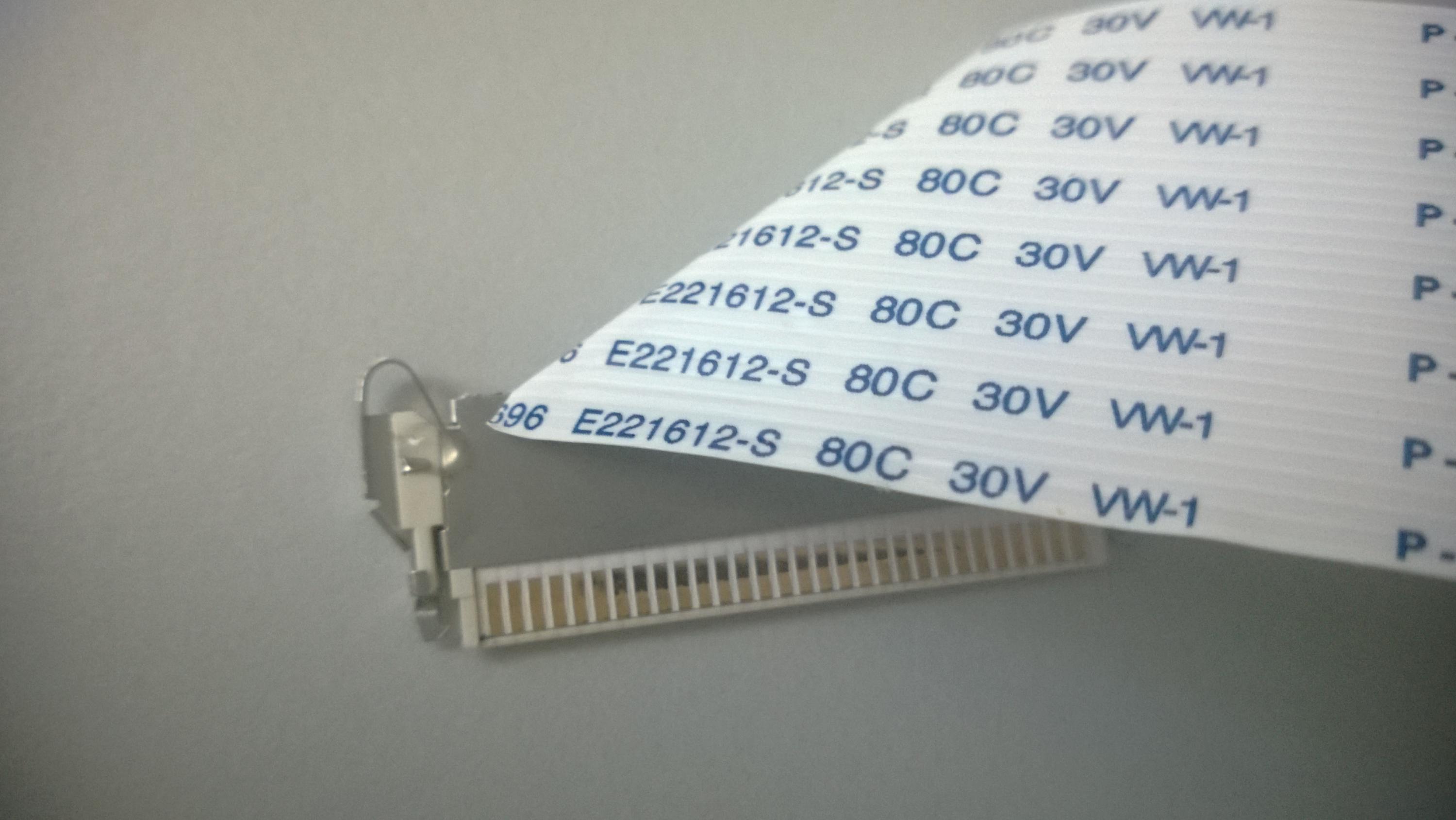

      Anyhow, even though the soldering looks bad (with the board being browned and all) I think it might not be my current problem after all. It seems like somewhere between me ordering the inverter IC and soldering it on, the LCD (LVDS?) ribbon cable has ripped. Which would probably explain the symptoms I am getting for the time being.
      Now need to find and order that!
        #63
        Does anyone have any ideas on where I might be able get the ribbon cable I posted just before?
        Label: P-TWO AWM 20696 E221612-S 80C 30V VW-1
        It's 30 lines/"pins"
