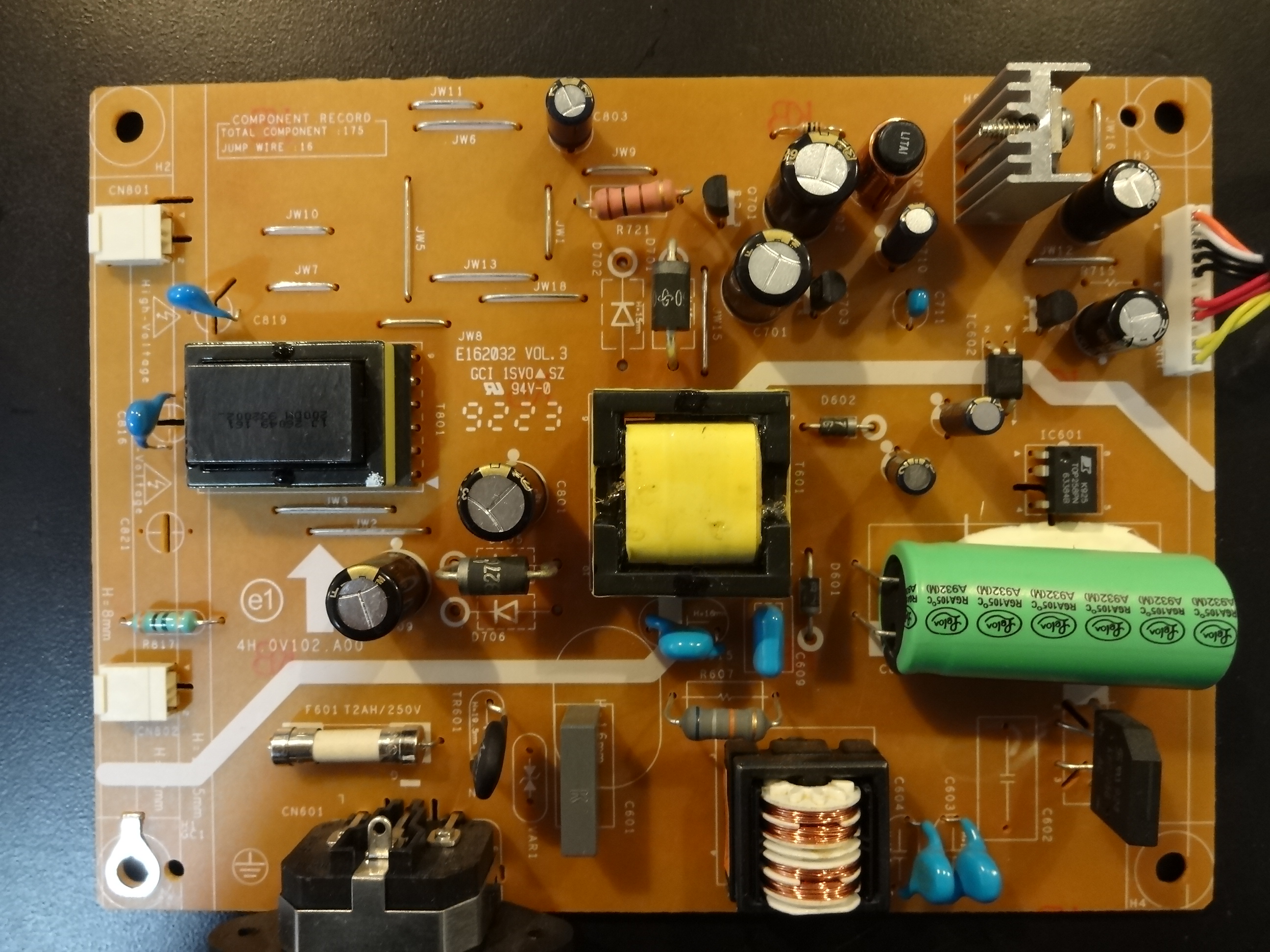

    Dell ST2410b Backlight Shuts Off
    Hey I've got a 24" Dell LCD. When it first gets video input the backlight will work for about one second before turning off. None of the caps were visibly bad but I went ahead and replaced all of them except the big one. Unfortunately it's doing the exact same thing still. Any ideas?

      Please post a photo of the back side of the board.

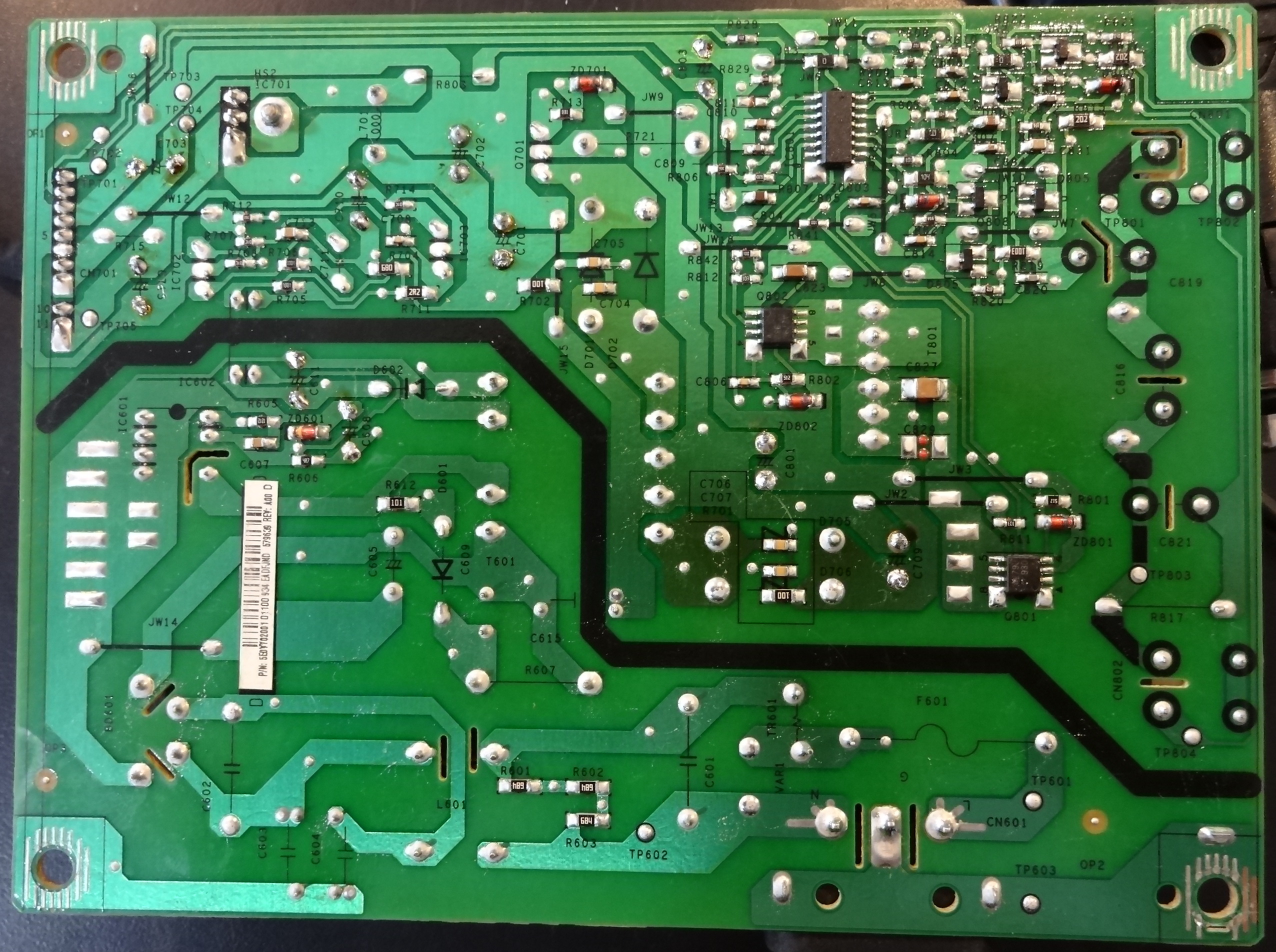

        Pictures of the back side:

          Re: Dell ST2410b Backlight Shuts Off
          Suggest you check mosfets Q801 and Q802 for shorts. I can't read the part numbers.
            I've never tested MOSFETs before but I found this guide saying how:
            https://www.badcaps.net/forum/showpo...4&postcount=19
            So I tested the resistance between the pins and didn't find any shorts, everything was at least a few kiloohms.
            Oh at the part number on them is A2790 and "930" on the second line.
              Try checking the resistance of the secondaries of inverter transformer T801. They should be approx. within 3% of each other. If they check good, then you'll have to take look at the ccfl wiring and the ccfl's themselves. If you have a spare ccfl around, then that would be even better.
                Currently looking for a datasheet on it, it's part number 1J.26049.161
                There are six pins on one side and four on the other, but two of the pins on the side with four are not connected. Anyway to tell which are the secondaries just be looking?
                  The transformer only has one primary (Half bridge drive circuit to drive the primary side) and one secondary winding, the secondary winding is connected to the C816, you can measure right at the C816 legs but you will not be able to tell if it is good or bad since you do not have another transformer to compare it to. You may have to have test lamp to find out where the problem is.
                    Guess I wasn't paying attention, but this 24" monitor has only 2 ccfl's? If yes, as budm suggested, using his link build a test ccfl that you can use for troubleshooting.
                        Alright, I rigged up a couple of 14W test bulbs and they both stayed lit so I guess I'm looking at at least one bad bulb in the monitor. Thanks a lot guys!
                        EDIT: So one things has me scratching my head. I hooked up one of the screens CCFLs at a time along with a test lamp and determined which bulb wasn't working. But in both configurations my test bulb stayed lit, where as I would have expected to shut off after a second or two when hooked up along with the bad bulb.
