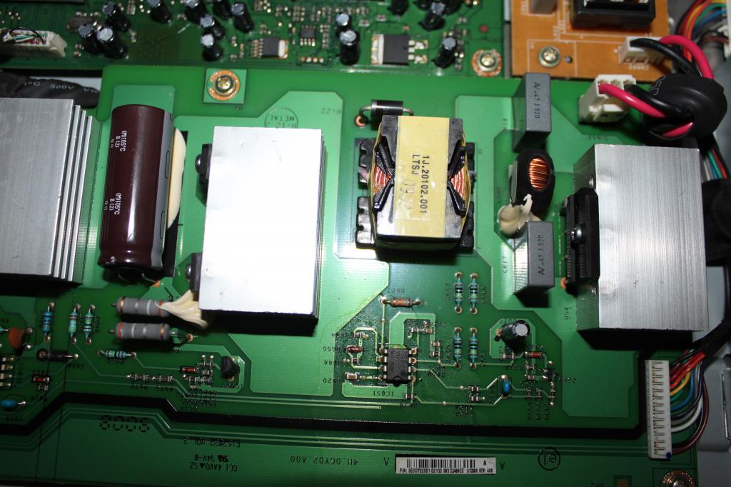

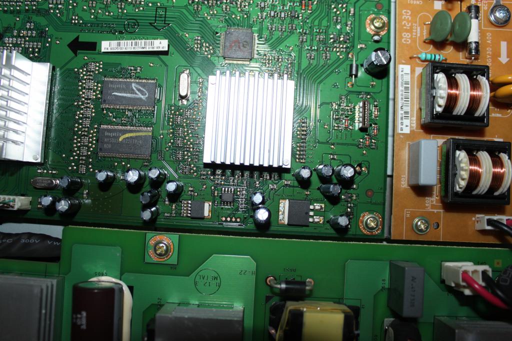

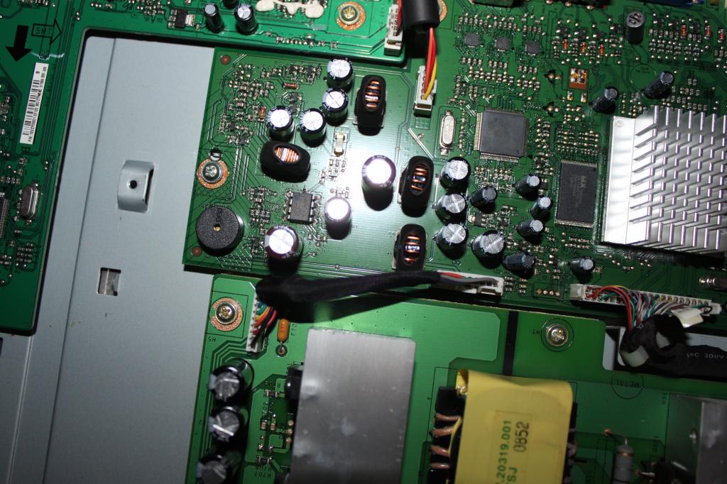

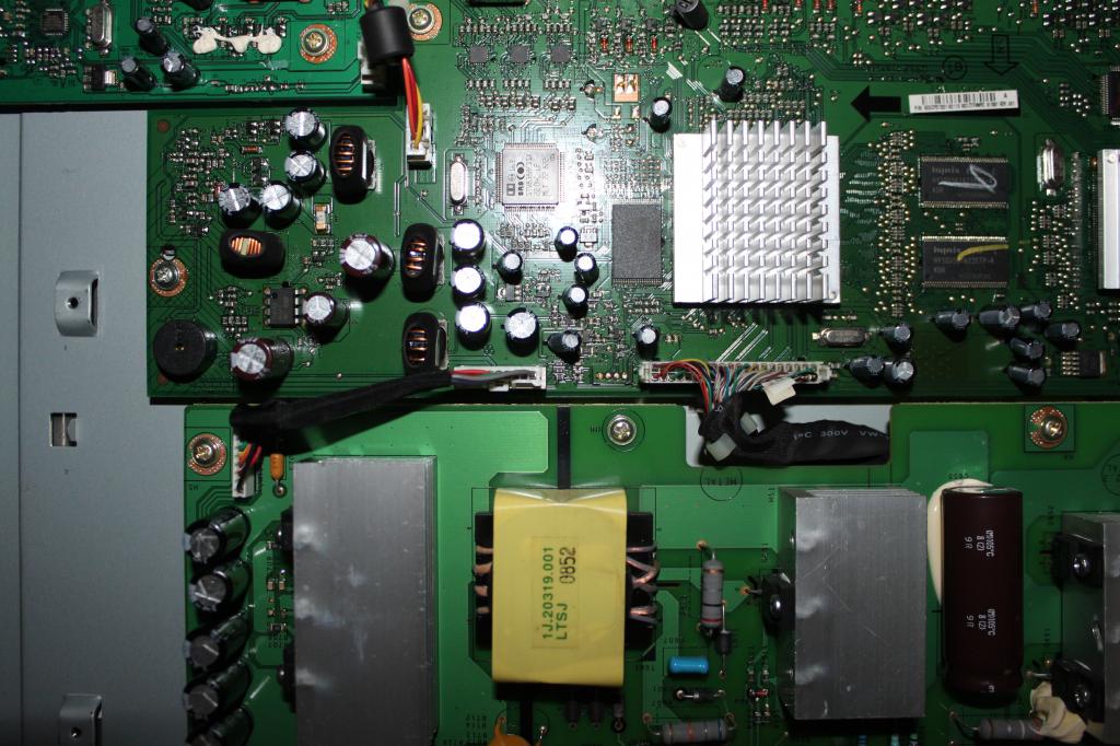

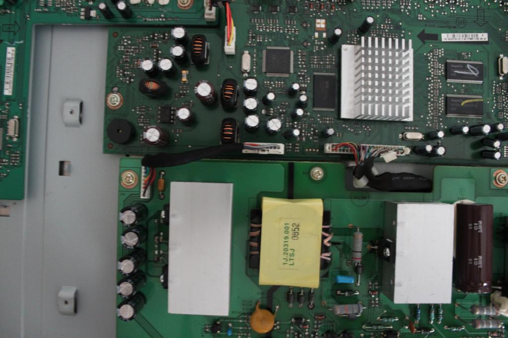

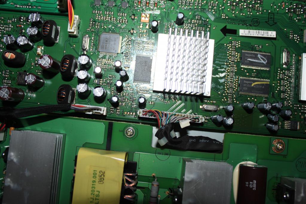

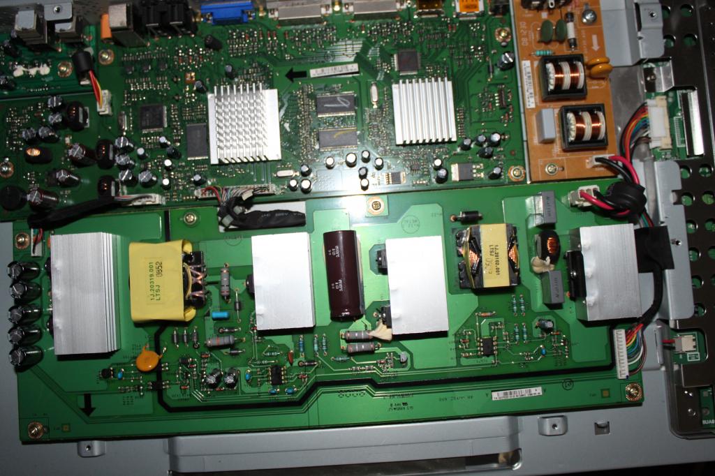

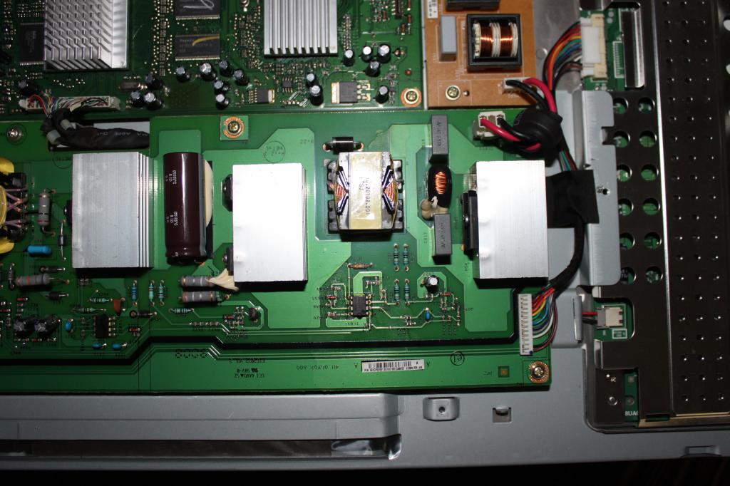

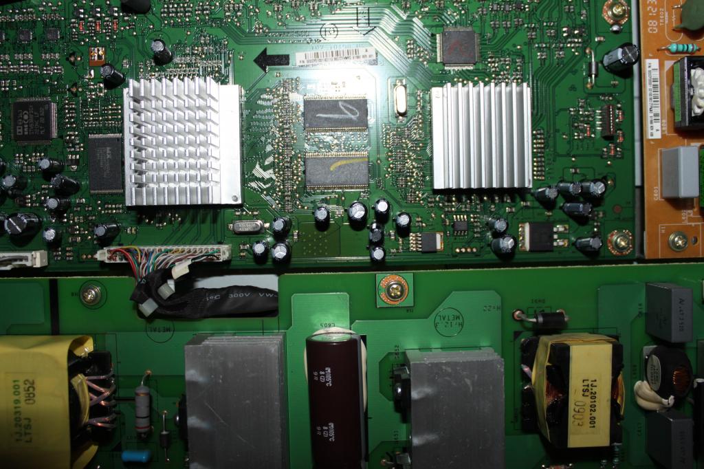

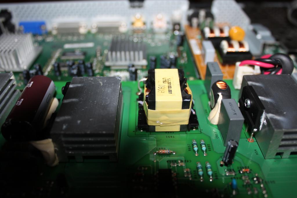

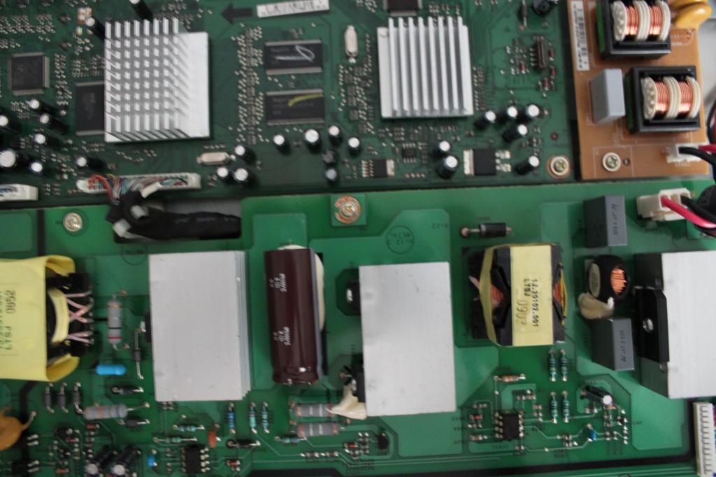

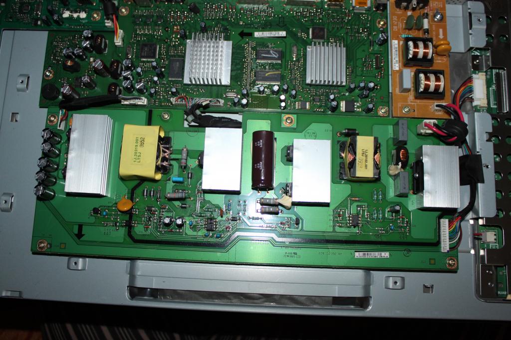

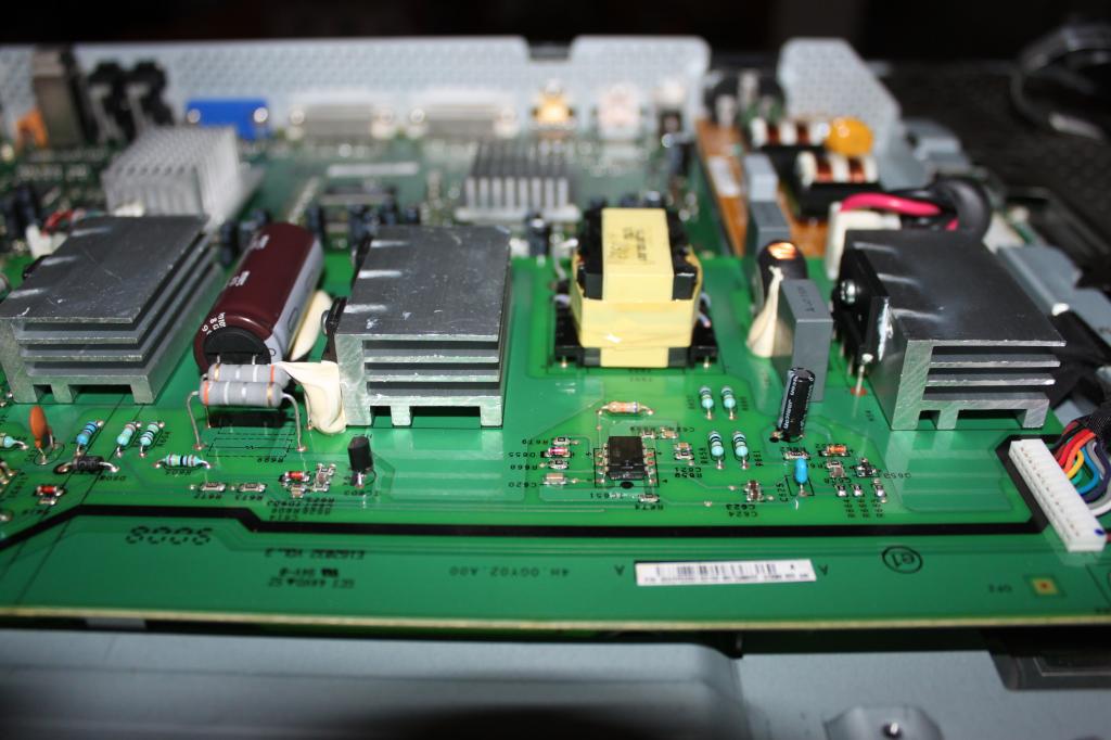

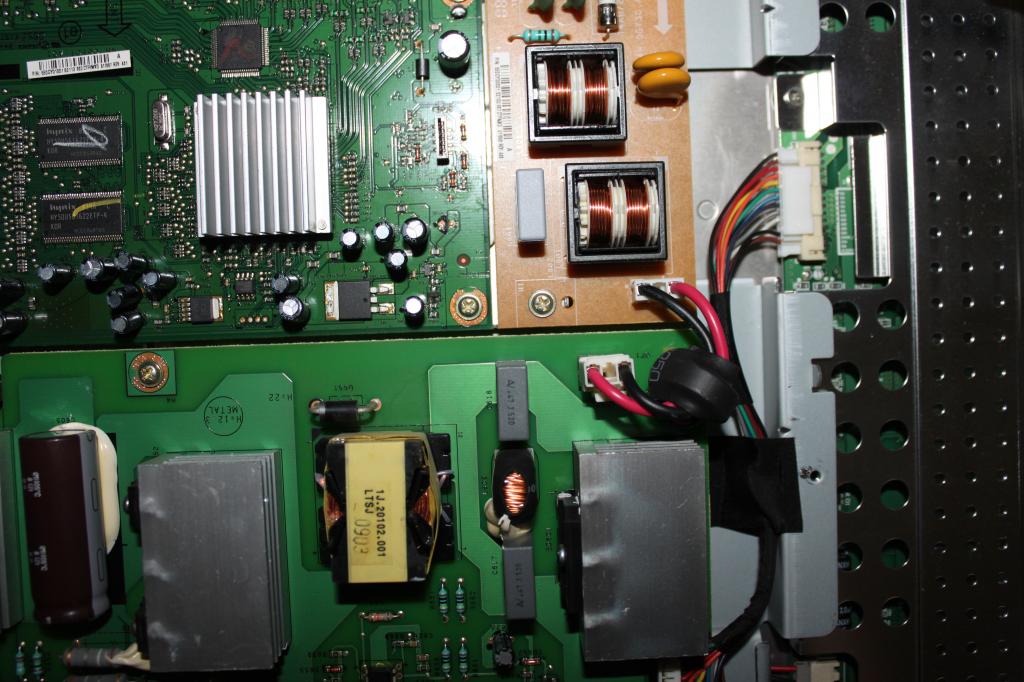

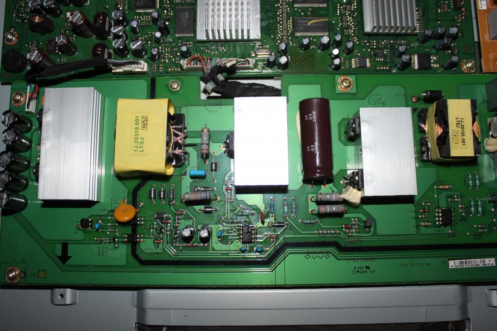

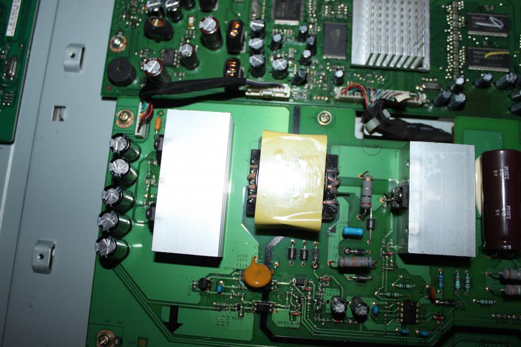

    I have taken some photos:
    However, I don't see anything wrong (visually).

      Re: Dell 2709w No power
      Great - can you edit your post and take them off - post on the forum using manage attachments so they dont drop off and to save them being loaded every time we look at the thread. - Thanks

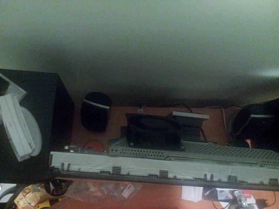

              So I've installed a fan, on the metal case which protects the circuit boards - for cooling purpose. It worked an entire day. But after few hours of standby - during the night, in the morning, the LCD screen is not responding. I notice an attempt to start, but in the end it fails - black screen. So the "stress" was present, while standbying.
              Now I'm thinking that the fault might be in the main power board. I've inspected the capacitors on the boards - none of them looked suspicious.

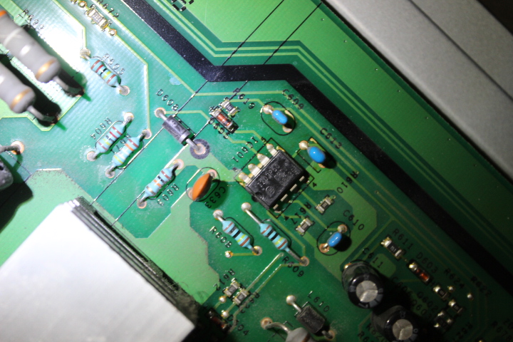

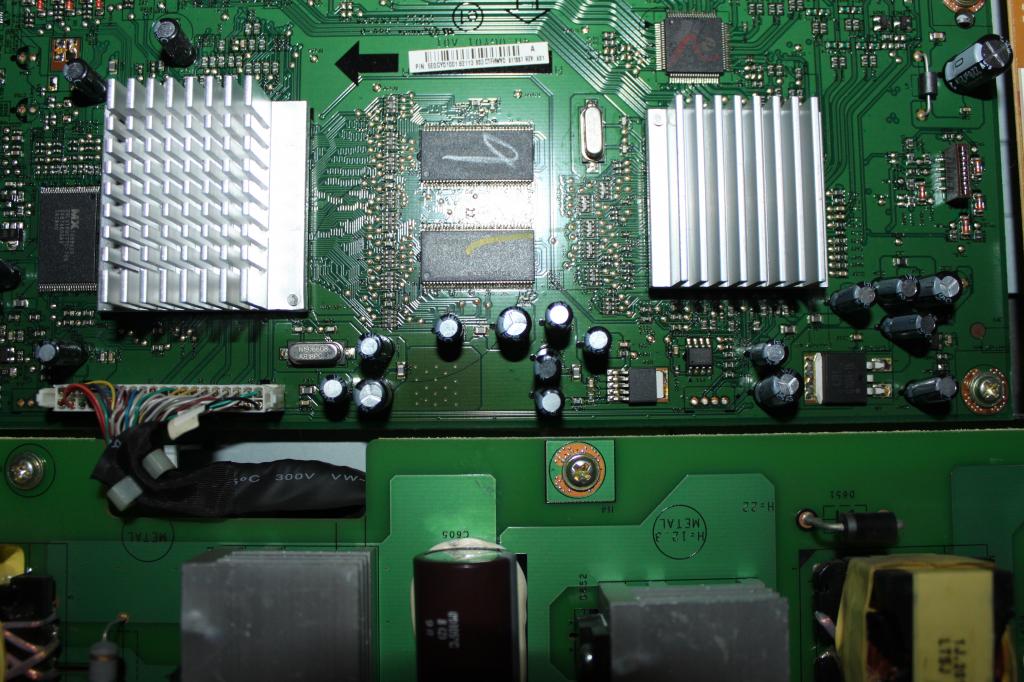

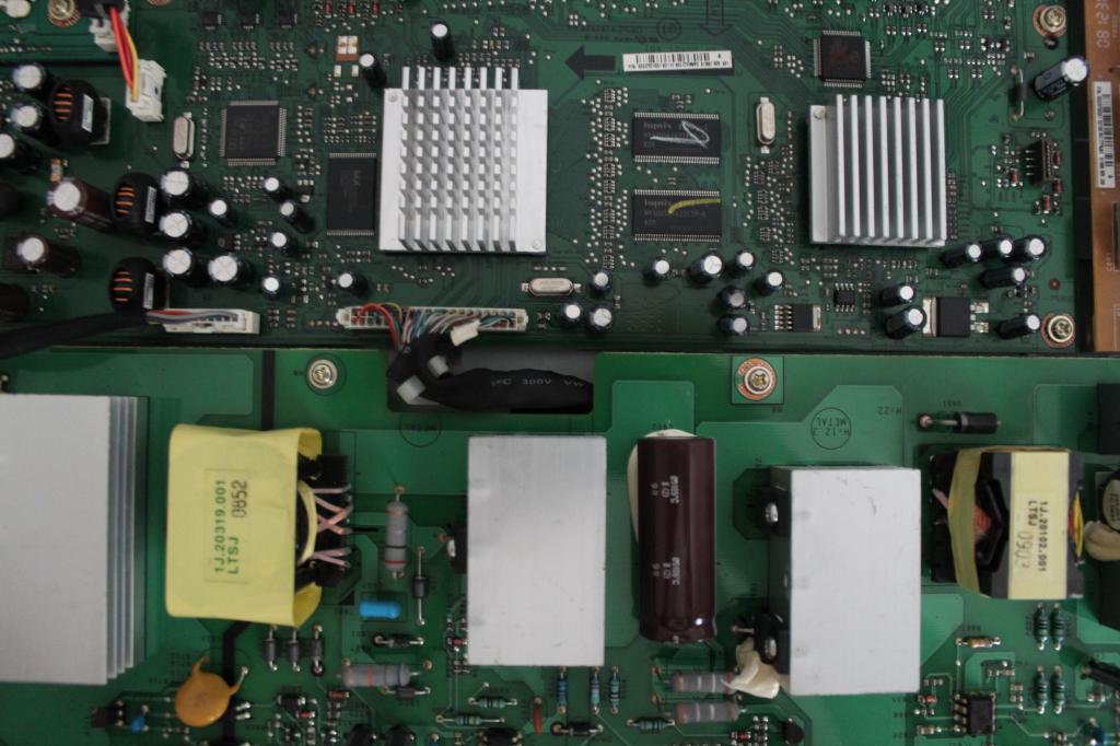

                I've made several photos with a part which looks weird - 1203P60 - the 8 pin part. One has no writings on it ( IMG_5555 - IC651 ). Could it be burned out?
                These could be one of the reason my LCD screen fails and goes black?

                  Follow-up: It seems that overheating is not the issue. LCD fails to start but after several attempts you get it working. At the beginning only the screen fails, the menu responds just fine. After you get it up&running everything is fine - no blackouts.
                  So the temporary solution for now is to plug/unplug the power cord, until you get the screen working. Obviously I deal with a faulty electronic part, but it wasn't identified after the visual inspection. Not yet
                  An alternative solution would be to leave the monitor always on - picture on or standby.

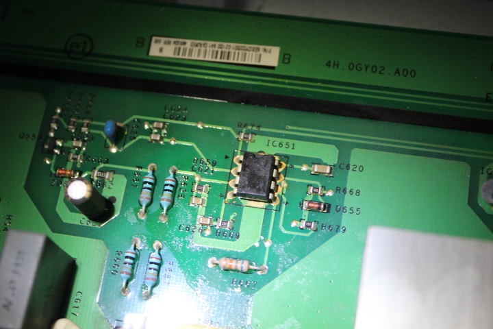

                    hi folks. I have this monitor broken because of a storm. I have detected the Q601 shorted (the K3679) and the R603 completely destroyed. I'm trying to find the transistor (not easy yet), but my main problem is that I can't read de value of the Resistence, even in the pictures posted in this thread.
                    Please, can anyone help me with this issue?
                    I'm not sure, of course, that changing this two components the monitor is going to be ok, but that is my first step I thing.
                    • diif
                      • Feb 2014
                      • 6978
                      • England
                      #90
                      R603 is Brown/Black/Orange/Gold 10k Ohms 5%
                      Check also IC651 and D651 and also R699 and R670. I obtained an identical monitor damaged after a power surge with this damage

                        • 3
                        • spain
                        #91
                        thank you for this information diif. I will check what you say. Now I am trying to find the damaged transistor. Not easy directly in electronic shops yet here in Madrid.
                        • diif
                          • Feb 2014
                          • 6978
                          • England
                              Q601 on my monitor was fine. It was IC601i replaced as well as the other components i listed above.

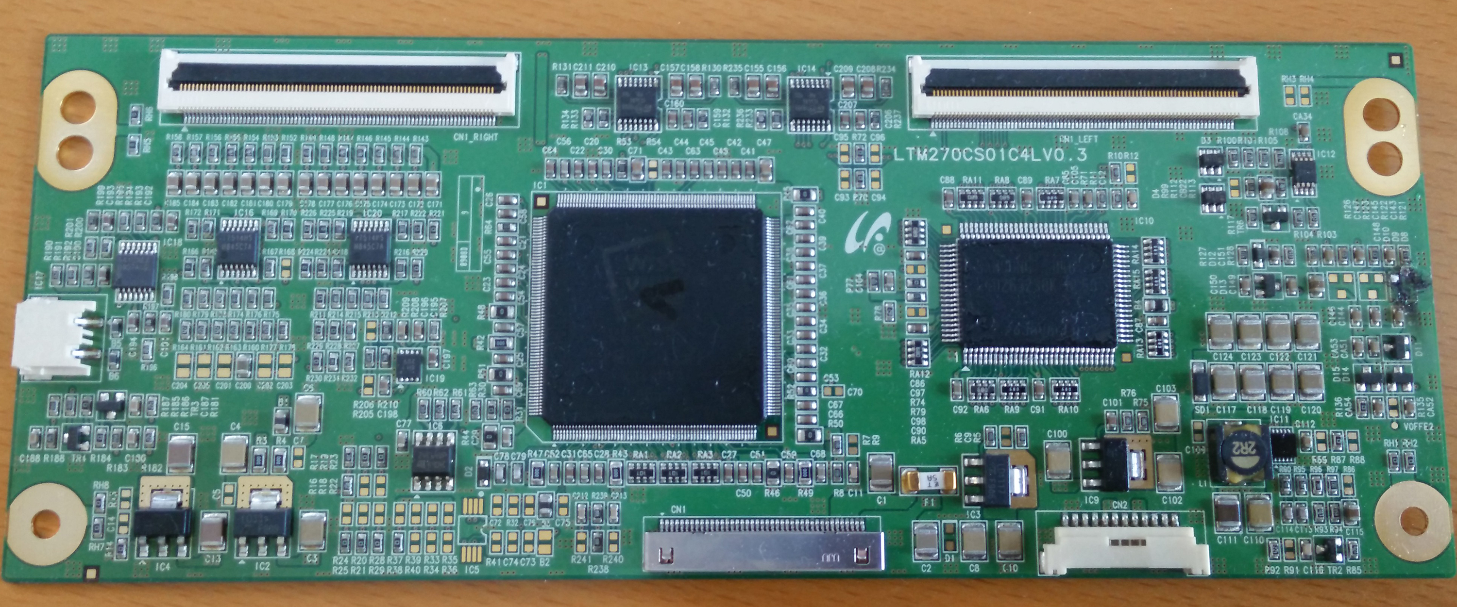

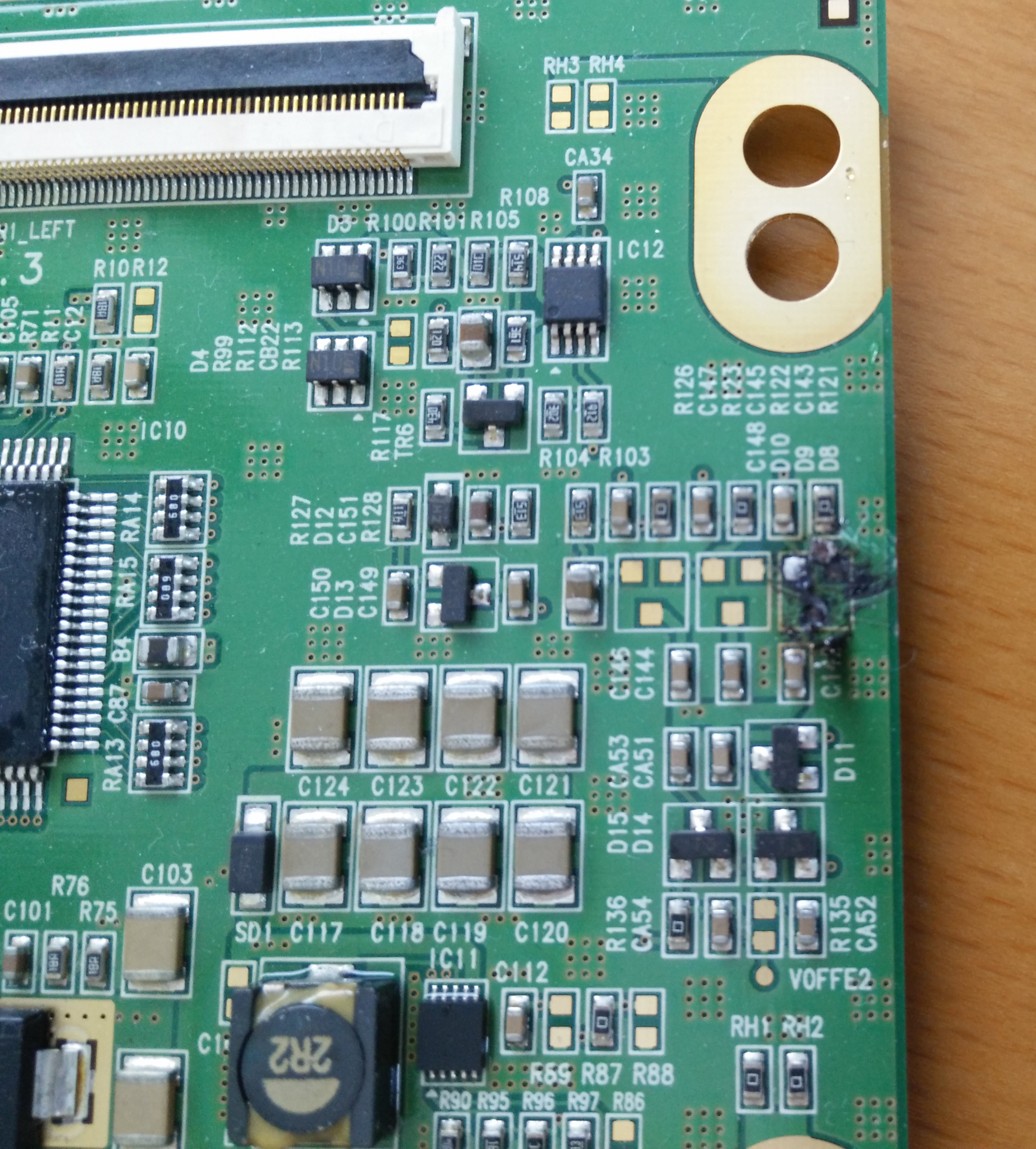

                                  Hello friendly people of the badcaps forum!
                                  So this is what is wrong with my monitor:
                                  It powers on and I can hear the beeps from the onscreen menu however the menu isn't displayed. The backlight does turn on. So the problem seemed to be in the t-con board. I opened it up to find the broken part and there it was, a burnt diode. I tried finding a diagram to find out what part it was without success so I took a shot in the dark and tried to replace it with a HSMS-286E without success.
                                  I have included pictures of the board and you can see which part failed.
                                  When I removed the part after I attempted to fix it i accidentally tore off the solder pads
                                  Does anyone still have this board available and is willing to send it? Otherwise I'll have to nose around the fleabays
                                    Originally posted by ytsoc
                                    Back with good news.
                                    Thanks to Neil who sent me his board so i can copy that eeprom, i got my monitor up and running again.
                                    Bonus i managed to fix his board too by reflowing the same bga chip.
                                    Hi, my monitor got into the same state as yours - power switch is on (blue), it is detected by pc but it is completely unresponsive and cannot be turned off.
                                    Is there a way how to fix it for a complete newbie like me?

                                          i've own 2 of them and one was faulty. the fault was similar to some described here. it's started with picture distortions once and then, quite rarely to spot. it's slightly similar to degauss function in old CRT type monitors when display shatters or ghost picture artifacts. that usually start after some period of constant work ~1-2h sometimes 4h. it also does happen that it hang on standby and was not able to start, the power button was blue but not responding the only cure was to unplug from power.
                                          forgot to mention there were sight of earlier repairs as i bought it second hand. the panel lid time in service menu says some small value compared to similarly aged unit i own. i suppose it had backlight replaced.
                                          i've started with taking it to the professional service but it give up early. the check of voltages around power and video processing boards does not traces anything unusual.
                                          then i took it to friend for reheating of SoC at 350C. it helped for week or 2 but problem returned. rarely than before but still disturbing.
                                          the second attempt was to add laptop cpu fan at SoC heatsink. i've placed it so that it lays via some heat conductive rubber on top of lower heatsink and lean on the edge of second heatsink. the output air flow is directed toward this second heatsink. forgive me but i don't remember which one is main SoC, the lower or higher one. perhaps higher so air is going via it. off course fan is connected to some 5v found on board. it is hearable but hard to notice in work envinronment. i've tried 3.3V supply but rpm was too little i think.
                                          and this was it! no any problem return after fan mounting. it'a already like 2 months and works without any problems.
                                          hope this helps someone!
