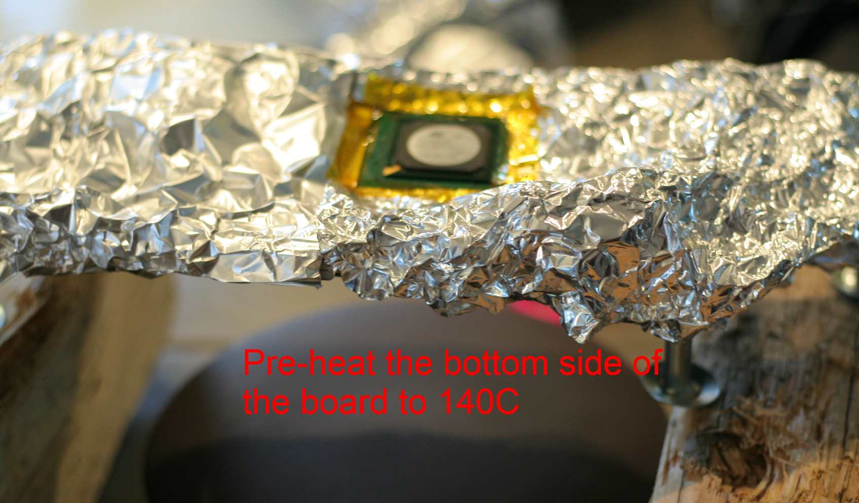

                My Dell 2709w didn't start, no signs of life except the blue power light.
                I opened it and measured a steady 24V supply, w/o much ripple. Disconnecting the back-light module didn't do much, so that was clearly not a dried out capacitor issue. (Back light is always the biggest consumer and the heaviest load on the 24V supply.)
                Then I was very lucky to find this awesome forum, especially the 2 page chat between ytsoc and Neill, which has enough details to fully characterize this type of failures. Post #4 is simply amazing, thank you Neill! My monitor had 3.3V and 5V supplies up and running. The ring oscillator of FLI30366 (416 pins BGA) was running at the right frequency (post #7). The heat sink was warm indicating life.
                I2C keyboard connector signals didn't have any activity, stuck at about 3.3V. All this led me to conclude that the malfunction was identical to the one that ytsoc successfully diagnosed and cured.
                Some of the BGA balls got disordered! The only solution – re-flow.
                If proper equipment is available re-flow process is relatively simple and straight forward. See it yourself in this YouTube video – slowly preheat the board from the bottom to 140C-150C and complete the profile to 210C-220C from the top.
                https://www.youtube.com/watch?v=lhZhHFO9x0Q
                But without this equipment this job is anything but trivial - people use heat guns and ovens.
                Oven produces nice even heat- great for solder but very bad for plastic parts and electrolytic caps. There were too many of them on this board so backing it in an oven at 200C wasn't a good idea. Heat gun solves this problem by generating localized heat, but that isn't very good for BGA re-flow, because the chip is super hot while the board is still too cold. Here is one of the most successful posts of at-home-re-flow with a heat gun. The main conclusion is – patience and temperature monitoring:
                http://forum.thinkpads.com/viewtopic...609846fcadad6c
                Additional critical element in the process is flux, which is needed to improve solder-stickiness. ytsoc mentioned it in post #34 and it is shown in the above video. W/o this re-flow has much poorer chances and the fix won't last long. Kingbo RMA 218 seems to be a very good choice. Please don't use Rosin Paste Flux.
                I ended up preheating the board to 140C with a simple crepe maker. Temperature monitoring was done with a Digital Laser Infrared Thermometer (and Fluke Type-K thermocouple for double-checking). The top side of the board was covered with foil leaving FLI30366 exposed. The rest of the temperature profile was performed with a heat gun at a rate of 15C per minute. The monitor is working great again.

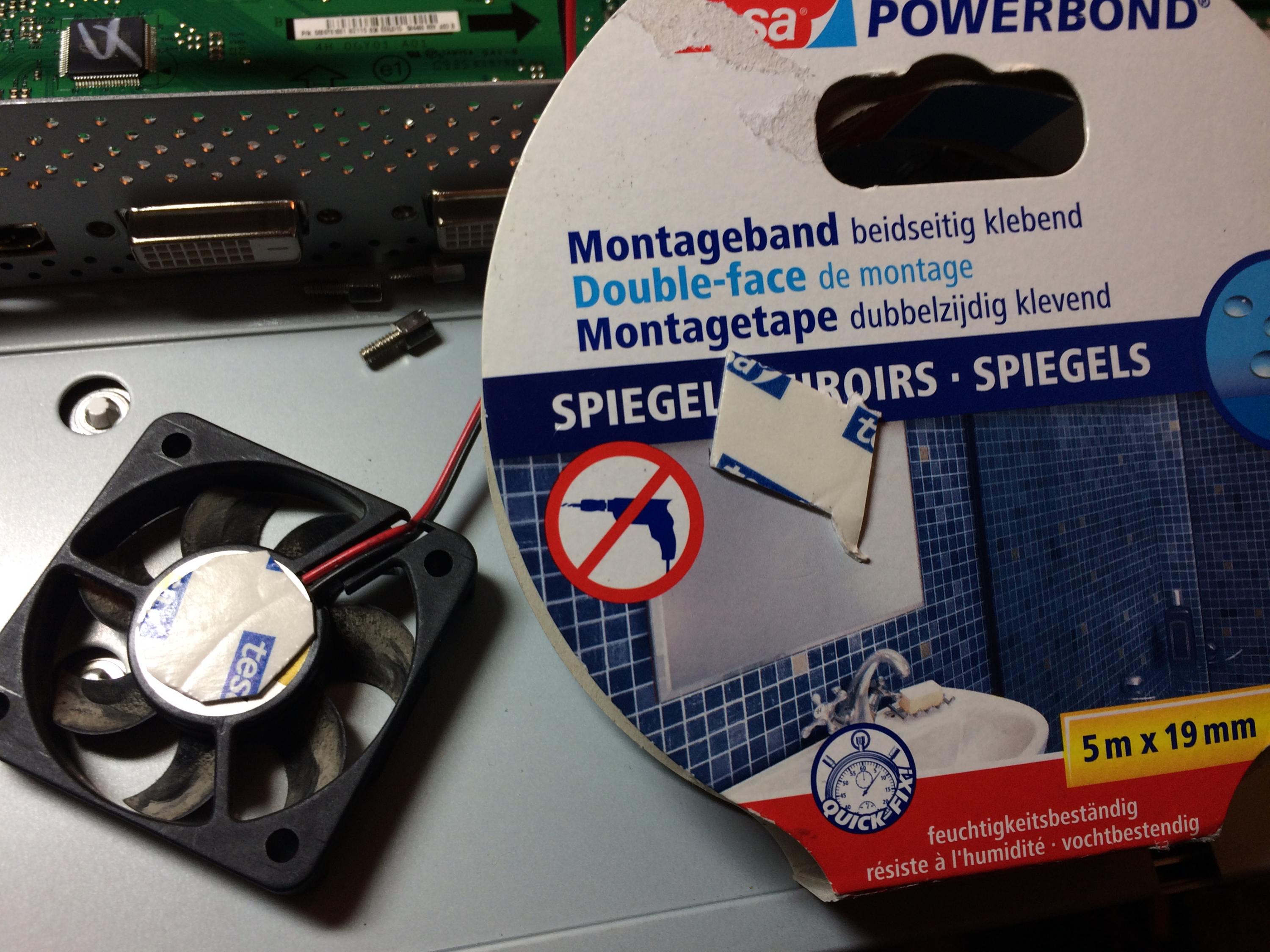

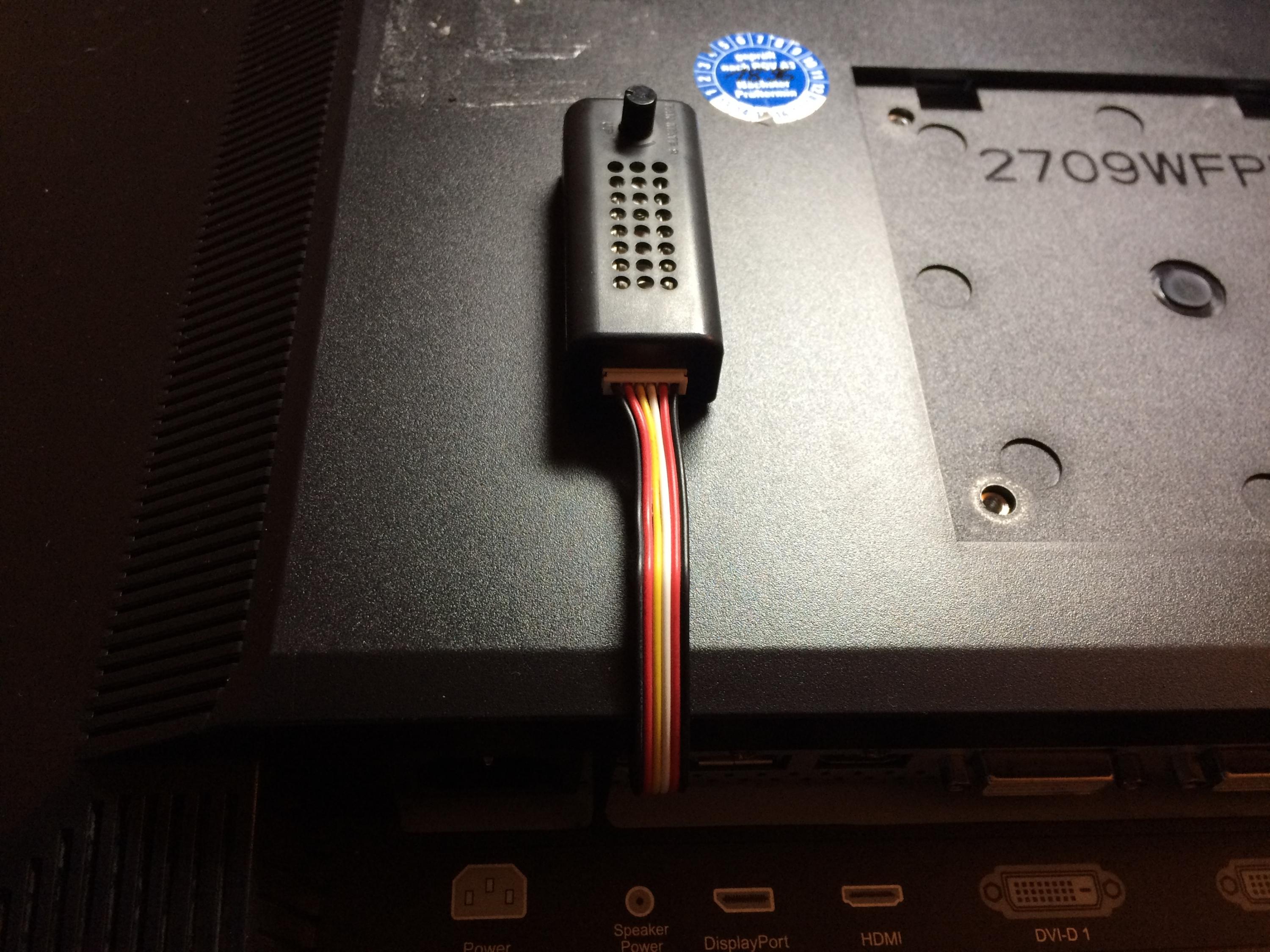

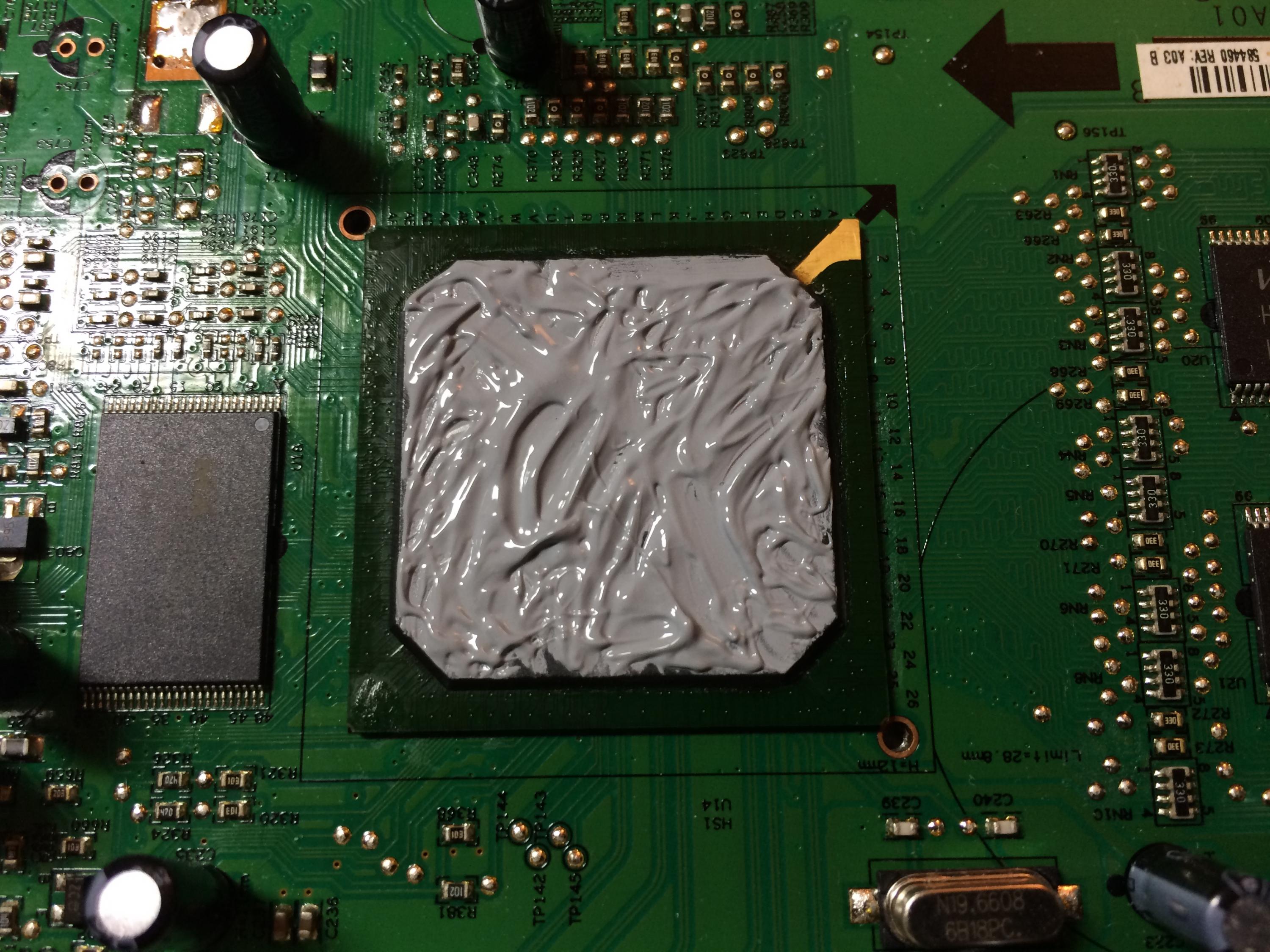

                          just wanted to say "Thank You" as you helped me to fix my Dell 2709w.
                          I've reflowed it (preheating with a cooking plate; hot air SMD gun; put some new compound on the chip) and now it works again.
                          Also I've added a slim fan (from an old Pentium 1 system) together with a voltage regulator to the 12 V output . The fan was sticked to the heatsink. The fan is really quiet and ensures a constant flow.
