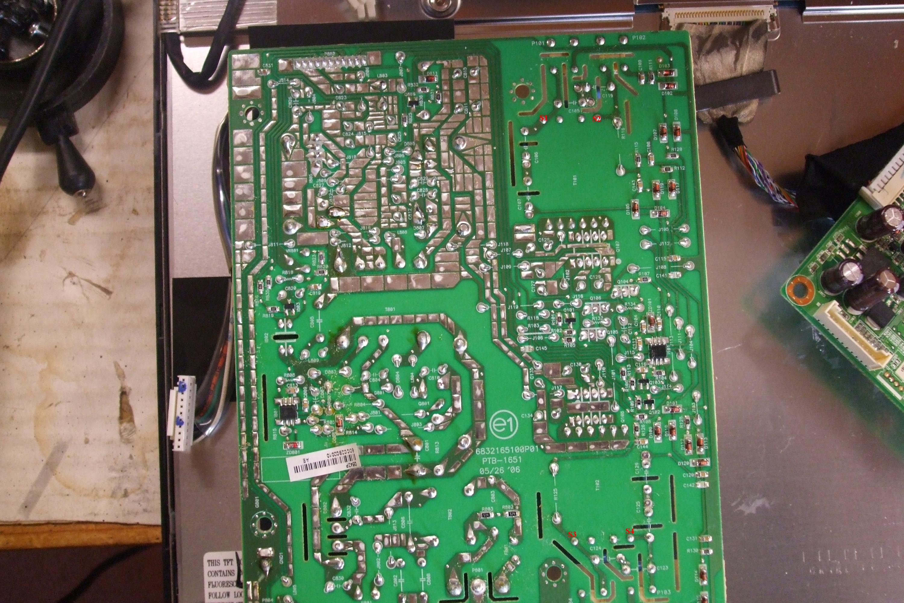

    I've done back over this thing, without boards connected, power out pins 1 thru 4 bounce between 5.1v & 5.3v, pin 9 between .5v & 1.7v. Connect boards, pin 1 thru 4 5.24v steady, pin 9 = zero volts, and the power LED no longers comes on, I don't know what changed.
    • maybenever
      • Dec 2010
      • 158
      #42
      Re: Dell 1707FPt No Power
      Update, since the only thing I've done so far that made any difference was reflow joints on the AC inlet end of the board, I went back and reflowed & re soldered all joints. Connect AC power, steady voltage on output pins. Connect logic board and ribbon going to power button. Plug in AC, my green LED light, on (before I pushed it). Been there before. All voltages at connection pins steady and correct (as far as I know). Press power button, green LED light, off. Press it again, on. I cycle it several times, and it works good. Plug in spare ccfls, turn it on, no back light. Now, power button won't turn off. Unplug AC & replug, power button does nothing, dead again. Disconnect boards, output voltage now bounces between 5.1v & 5.3v, and when it does that, the power button does nothing when connected. What the hell is going on?

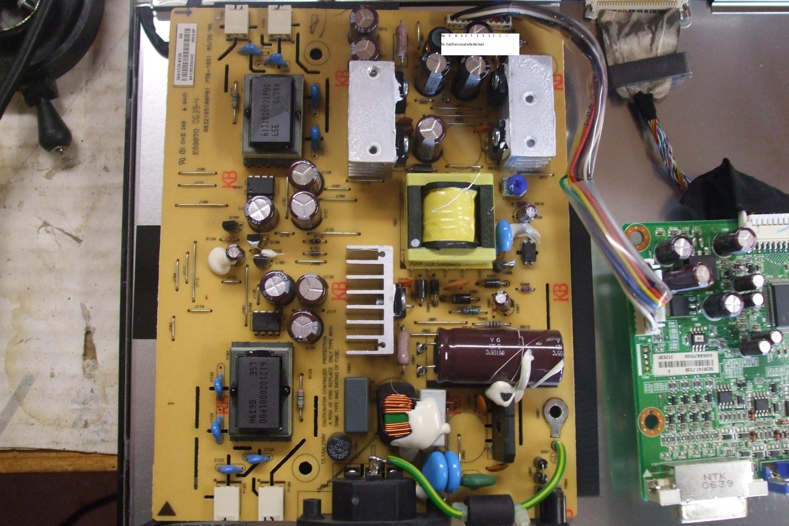

        I may have missed it but have you tested the inverter transformers.
        Cant see how they would affect the voltage problems you have but may as well test them as if they are gone they may not be replaceable
        POWER OFF Meter on ohms 2000 measure s1 to s2 and s3 to s4 on the attached pic.

          #44
          S1 to S2 = 443ohm S3 to S4 = 442ohm

            #45
            Ok the secondary windings on the inverter transformers are good.
            Can you connect the ccfls that you know work and disconnect the main board.
            With mains power to the powersupply Can you get a 3v battery or 2x1.5v in series and connect negative to ground and positive to bl on.
            Probably nothing will happen - is there a pson pin? if so try putting the 3v+
            to that instead of the Blon.

                #47
                This is the way I'm numbering the pins. You'll have to blow the picture up a little to see my text.

                  #48
                  Well as pins 9 10 and 11 receive around 3v then just try it on each of them
                  (one at a time) without the main board connected but with the lamps connected.
