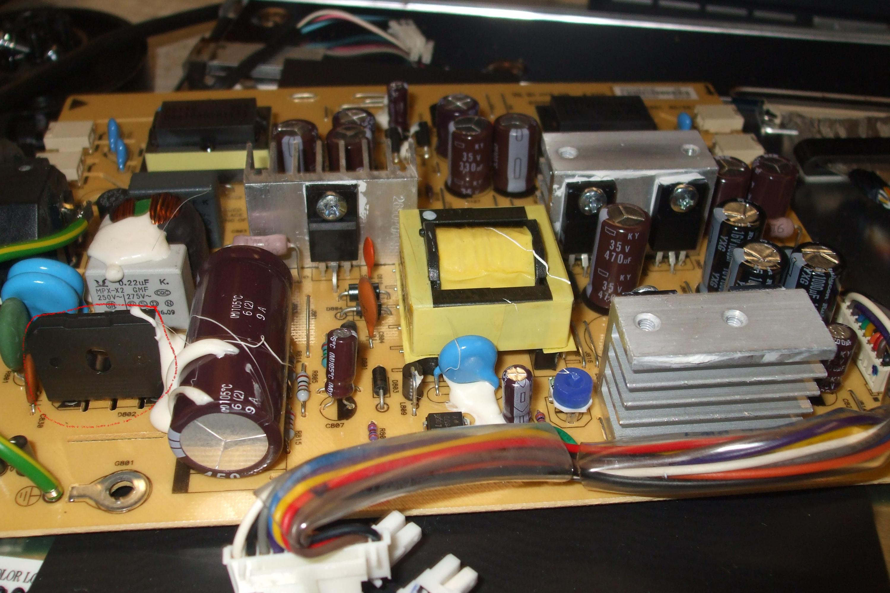

Dell 1707FPt No Power
  • maybenever
    • Dec 2010
    • 158
    Re: Dell 1707FPt No Power
    What brand was the 10uf 50v cap (yellow)?
    Chemi-con KY
    • retiredcaps
      • Apr 2010
      • 9271
      Originally posted by maybenever
      Chemi-con KY
        Connected boards together, AC power connected, my 5.25vdc fell like a rock to zero. Took them back apart, powered up, got the 5.25v, then it started falling to zero like in the beginning. What next?
        • retiredcaps
          • Apr 2010
          • 9271
          Well, either something is dragging down the 5V or something is failing, but not outright failed.
          You could try replacing the caps, but I don't know if that will fix it.

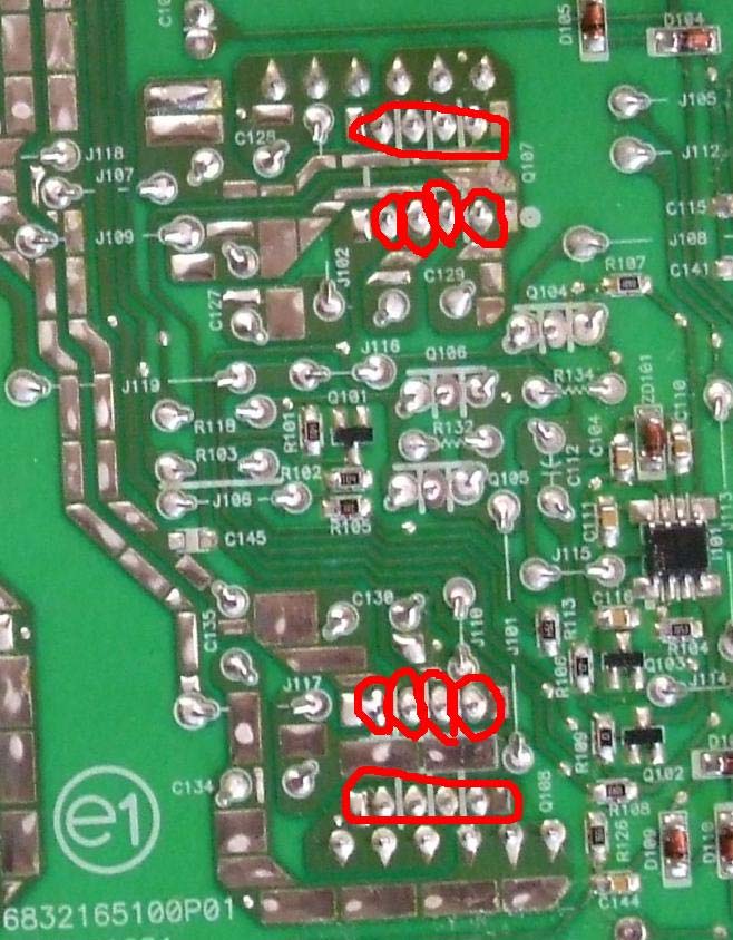

            Please test Q107, 108.
              budm Re:
              It will be tomorrow before I can do the test.
              What does D802 do? Markings are U4K8 80R K468. When my voltage is steady at output pin, I can track 123vac from power cord connector to this rectifer (I think that is what it is), beyond it I get 185v (I assume it's ac). When the 5.25v output starts droping, this voltage also drops, to like 75v, also the voltage across the large filter cap drops to 48-50 volts. Am I on to anything here.

                • maybenever
                  • Dec 2010
                  • 158
                  Budm
                  Test on Q107, lower pins left to right, pins 1 thru 3 = open, pin 4 = 1615ohm
                  Test on Q108,""""""""""""""""""""""""""""""", pins 1 thru 4, all = 1610ohm
                                      I made a mistake on this report, those reading were 1715 ohm & 1710 ohm. Q107 is not a good reading, right.
