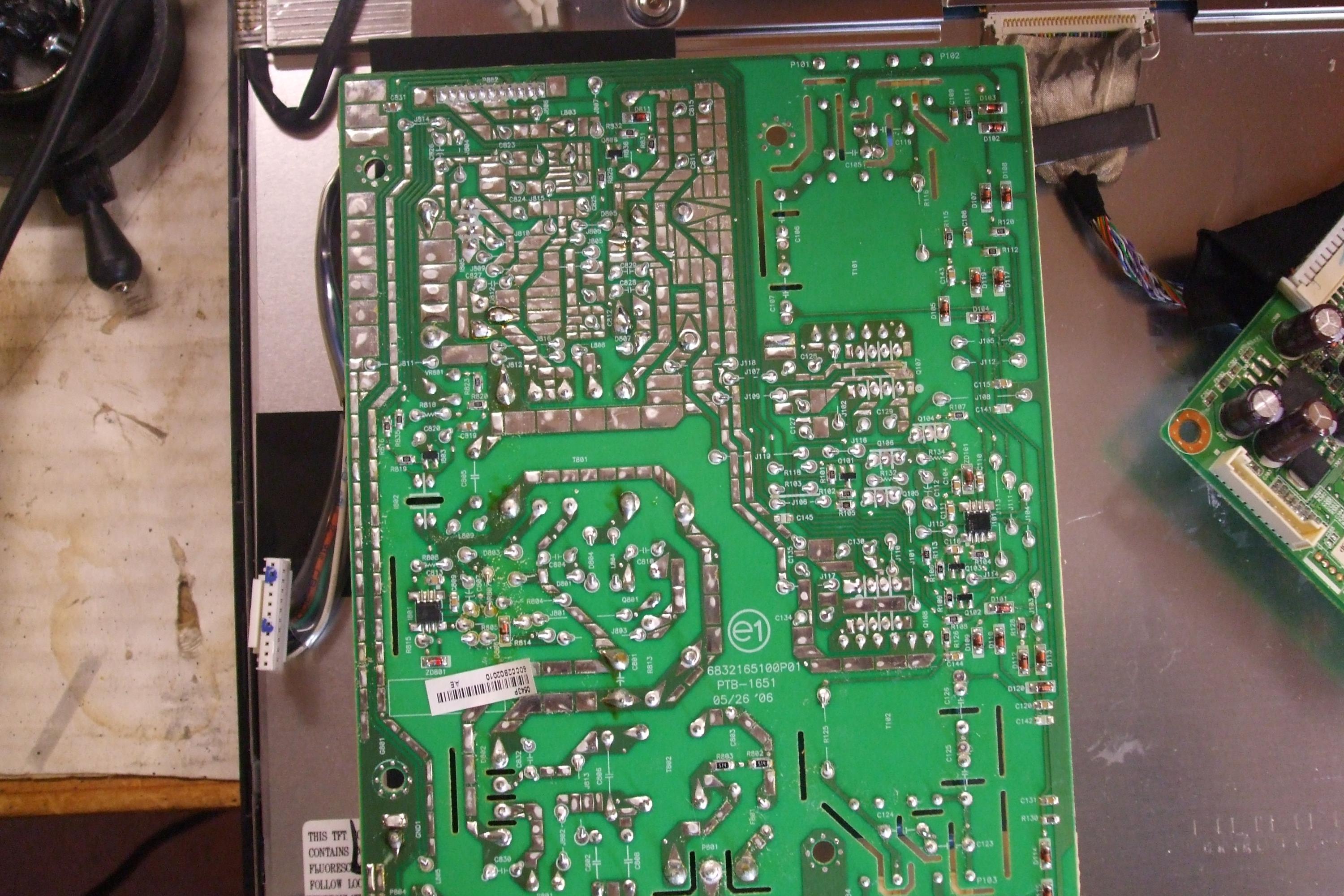

    Dell 1707FPt No Power

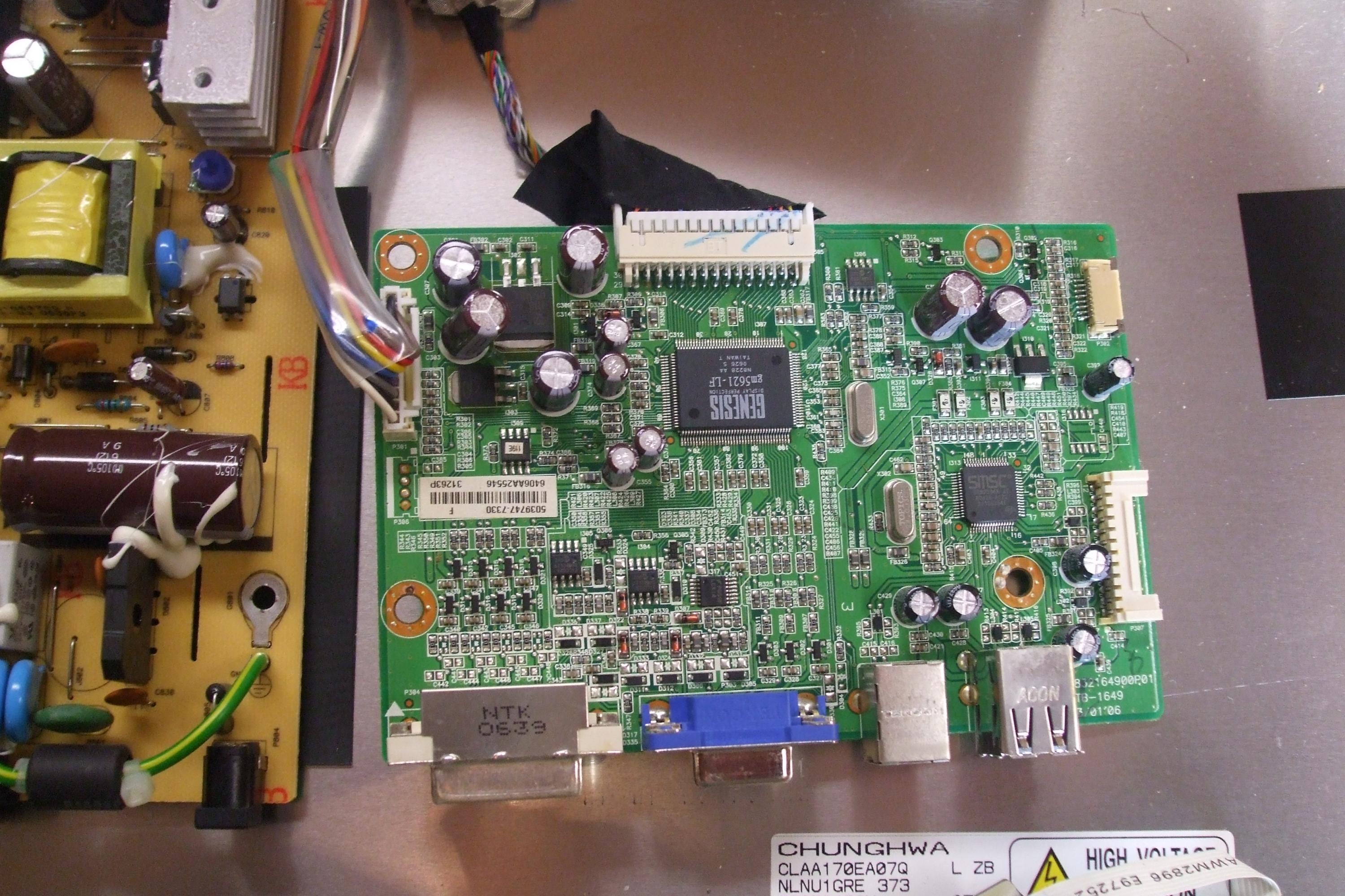

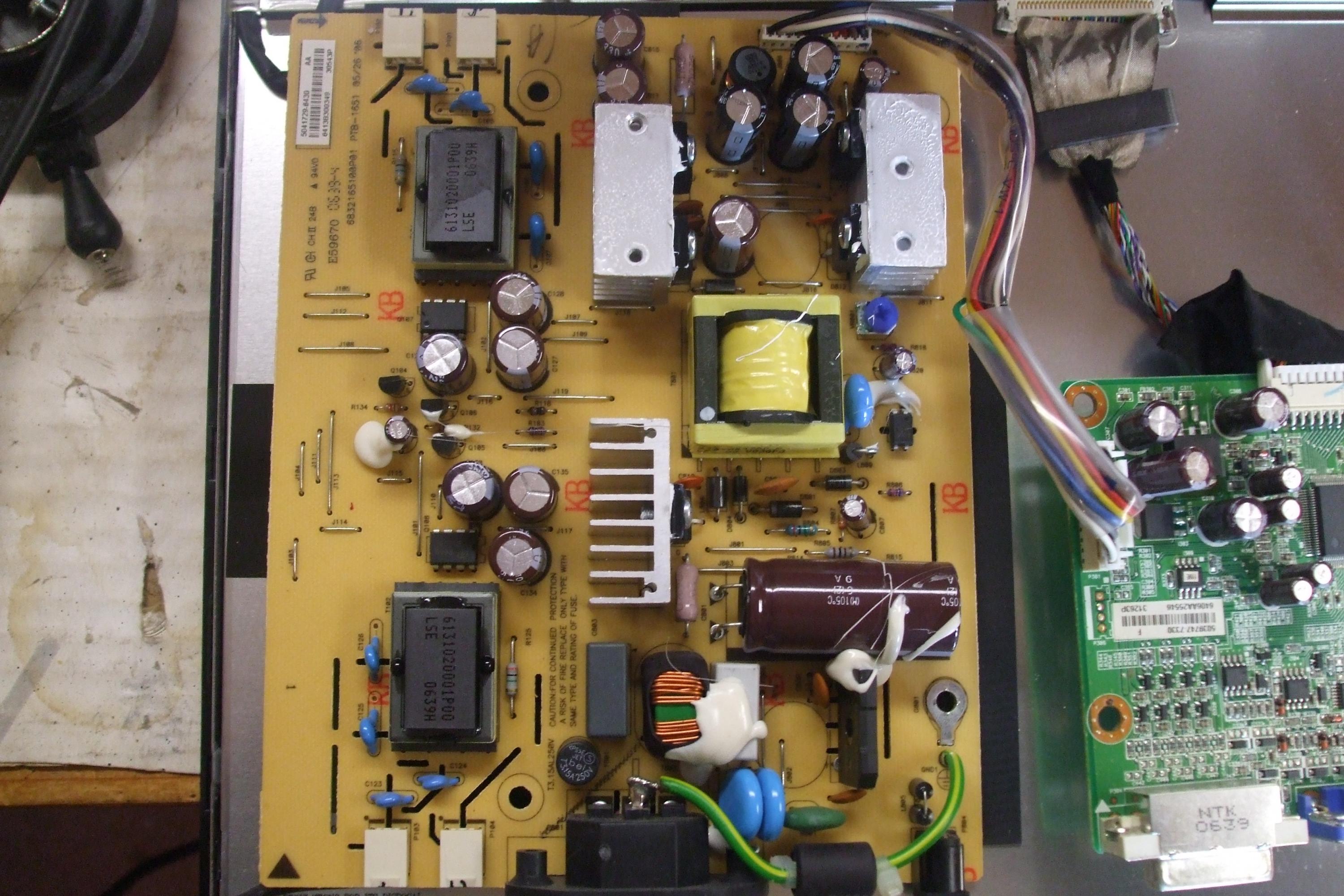

    I got this monitor apart and I don't see any for sure bad caps. I've read all the threads on this monitor, but no one ever listed the pin voltage going to the logic board. When I first put AC power to the main boad, I get 2.45vdc at the two top pins, then the voltage starts falling, finally going to .o1 volts.
    I have 163vdc across the large filter cap. Am I kooking at a cap problem somewhere?

              • maybenever
                • Dec 2010
                • 158
                Re: Dell 1707FPt No Power

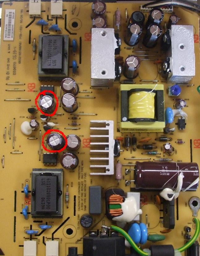

                Does this picture help any? I've got most of those caps on hand (panny FM), I've got them all in the correct uf, but Dell used larger volt caps than most, I'd have to get some of those.
                • retiredcaps
                  • Apr 2010
                  • 9271
                  I suspect someone has worked on this board before. I don't recall seeing United Chemi-con KY caps on a power board mixed in with Rubycon YXG. Both brand and series are good quality.
                  The fact that it fails when heated could be a cap problem or a bad solder joint.
                  If it was my monitor, I would reflow each capacitor joint with some fresh 60/40 solder and retest.

                  • maybenever
                    • Dec 2010
                    • 158
                    I'm going to work on it right now, I'll get back. I wish I knew to proper output voltage, seems like one pin should be 12 or 14 volts. No markings on either board (thanks dell).
                    • retiredcaps
                      • Apr 2010
                      • 9271
                      Who makes these two caps? What brand and series?
                      --- begin sig file ---
                      --- end sig file ---
                      • maybenever
                        • Dec 2010
                        • 158
                        It looks like SU Scon 0627 (M) 220uf 35v
                        • retiredcaps
                          • Apr 2010
                          • 9271
                          I would replace those two for sure with Panasonic FR/FM/FC.

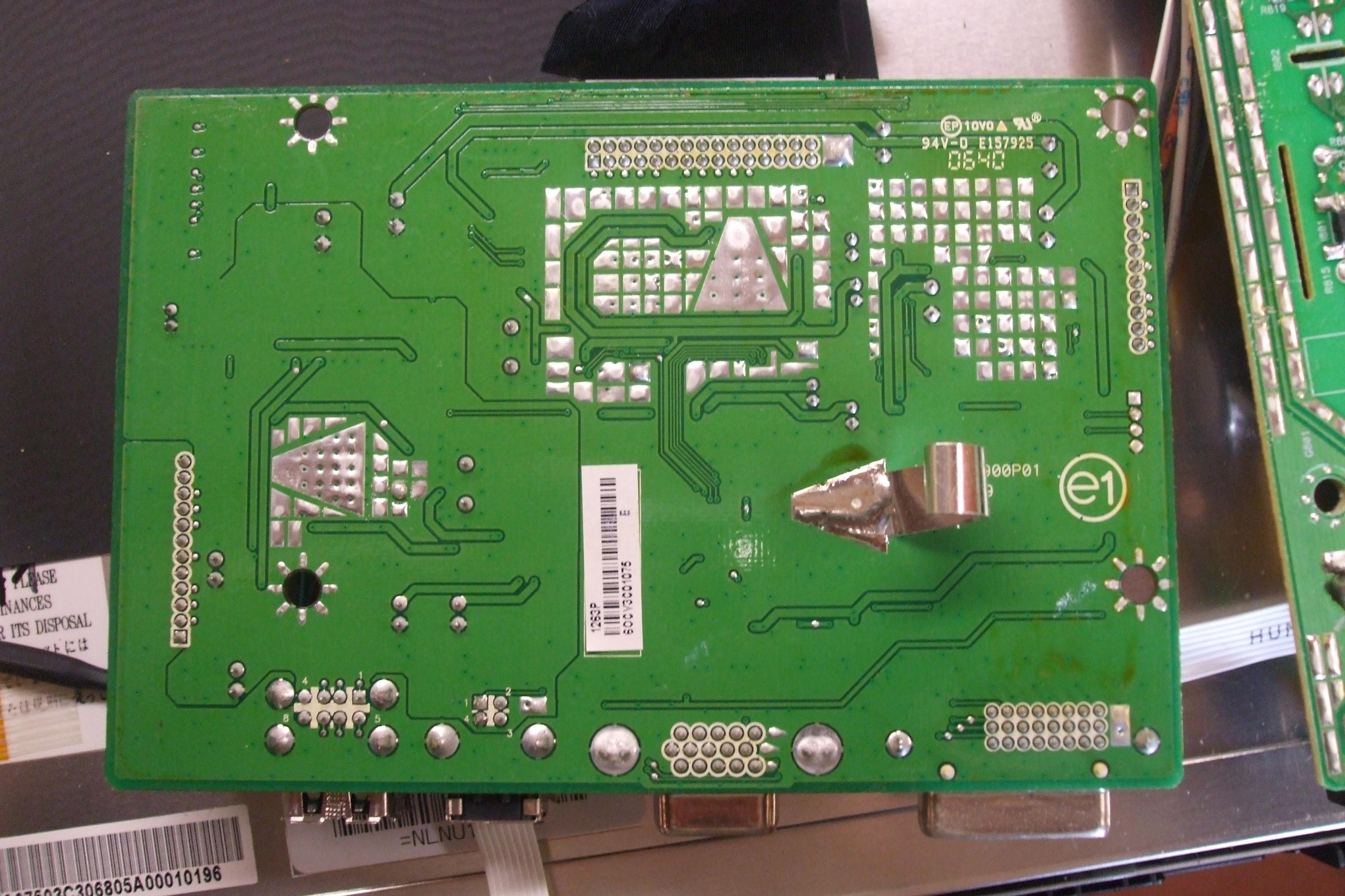

                            I'm going over the back of this board with a 10x glass, if someone has worked on it, damm, they're good.

                              I could be wrong on that. It is just surprising to see 3 different capacitor brands used. If they were all one brand, then I wouldn't suspect anything.

                              • maybenever
                                • Dec 2010
                                • 158

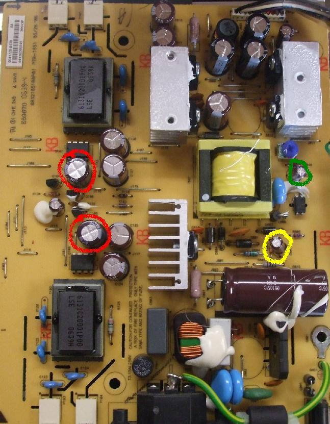

                                I replaced the 220uf caps (circled in red), no change, voltage flopping between 5.14v & 5.25v, held board in front of heater a few seconds (a 35,000 btu space heater), voltage started dropping. I replaced the 10uf 50v cap (circled in yellow), voltage held steady at 5.25v on all 4 top pins. Pin 9 steady at 1.68v. After a few minutes (all voltages holding steady), I held it in front of heater, damm, the voltage did not drop, only flopped between 5.14v and 5.25v again. Unplugged AC, had a beer, plugged it back in, voltage steady again. Gotta be going in the right dirrection.The cap circled in green is a 4.7uf 50v, that one I don't have. Tomorrow, I'm connecting boards together and see if it has any life. I'll get back.
                                • retiredcaps
                                  • Apr 2010
                                  • 9271
                                  The yellow one is the startup cap. That would have been one I would have suggested next to replace after a 60/40 reflow.
                                  The Su'scon had to go though.
                                    That 4.7uf cap is a Su'scon, is it a startup cap?

                                      The green cap is on the other side of the optoisolator. It may be part of the feedback circuit?

                                        What brand was the 10uf 50v cap (yellow)?
