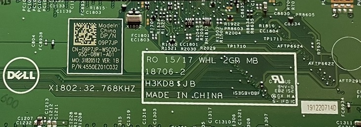

    hey guys, hoping for some pointers to repair an eBay bought "faulty" laptop.
    Ill try and give as much info as I can.
    Dell Inspiron 17 (7786) Laptop
    Service Tag: 5J0NHT2
    Bios: 1.9.0
    When I received this , it would only flicker on the KB backlight for a second, then off and on.
    Then it started getting weirder!
    Sometimes when attaching the AC power supply, and pressing various pre-boot diagnostic keyboard keys... it did try to boot, in fact out of a hundred attempts, the laptop did actually boot into the Bios ! but never has since...
    At present, when i connect the AC power supply, it turns the Fan on full power, 3x amber flashes, and 5x white flashes can be seen (with or without anything being attached to the mobo (just power button) and with or without ram installed...?
    I am able to use the power button when it does this, to turn it off. But it doesnt power on again unless i disconnect the power supply and reconnect it?
    Now, i would call this 'progress' since it was doing "less" when i received it.... lol
    Even though there is no power LED I am seeing various voltages around the board, 19v, 13v, 3.3v, 1.3v, 0.7v?? . not sure if these are exact....
    I am not seeing any hotspots under a thermal camera (at all) ?
    Here is how i have only been able to get the status LED to come on.;
    1. disconnected battery and bios battery (lets say for argument that the main laptop battery has been removed completely for all experiments)
    2. disconnected mains power supply.
    3. press and hold power button for 30 seconds
    4. reconnected the mains power supply
    at this stage the white light (beside the jack) comes on after 10 seconds, stays lit for several seconds and goes out again, and stays that way no matter what is pressed. Again the only way to get it to do anything again, is to reconnect the bios battery, disconnect and reconnect the power supply, and it goes back to full fan running, KB backlight on, 3x amber and 5x white lights come on.
    I have tried multiple combinations of pressing and holding keys during boot but nothing works. even tried to do the bios recovery method but again nothing happens.
    Its very strange that I did manage to get the laptop to just one time boot into the BIOS so surely that tells me everything is (mostly) working to some degree ?
    I have been able to extract the current bios from it using a programmer , which I can attach if allowed? it doesn't look to be corrupted but then again i dont have anything to compare it too. I dont want to programmer-flash anything back to the bios chip just yet until im certain the bios could cause these startup problems .
    Would be grateful for any tips on where to look for likely faulty components and next steps to pinpoint exactly whats wrong.
    Here is a pic of the back of the board showing the part number etc etc
    Click image for larger version  Name:	IMG_7094cropped.jpg Views:	0 Size:	91.6 KB ID:	3161779
    Click image for larger version  Name:	IMG_7098.jpg Views:	0 Size:	1.20 MB ID:	3161780
    Click image for larger version  Name:	IMG_7083.jpg Views:	0 Size:	1.15 MB ID:	3161781
    Click image for larger version  Name:	IMG_7082.jpg Views:	0 Size:	1,017.0 KB ID:	3161783
    many thanks

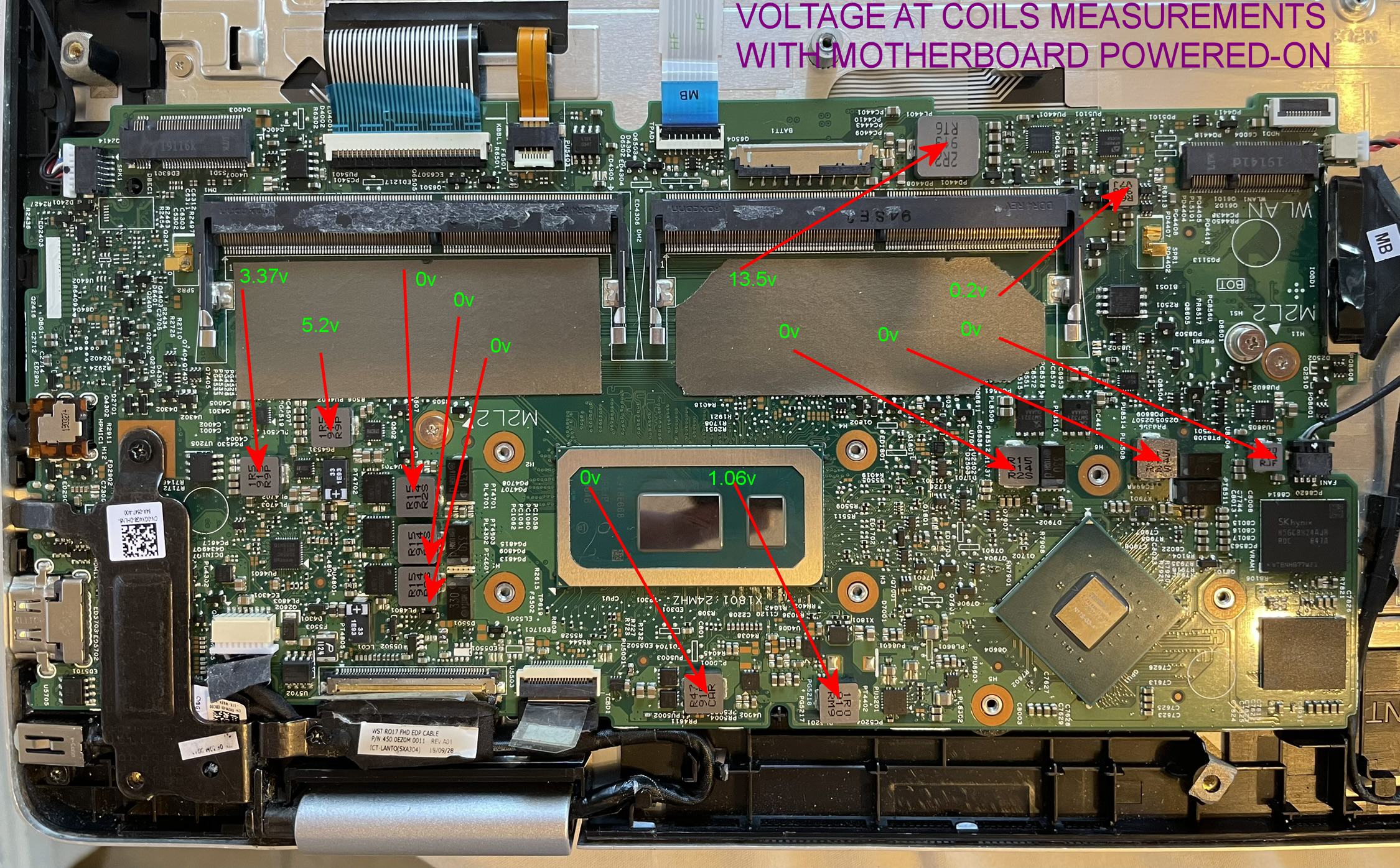

    Resistance to GND measurement on all coils(no power attached) to begin with.
    Voltage on all coils after powering it on.
    Link schematic,if available.

      V at coils when power supply connected (still with laptop battery removed).
      Note- Laptop powers itself on to the error LEDs, once power supply is connected.​
Name:	Dell Insp 17 7786 VoltatCoils.png

        The resistance to GND readings seems good and likely there is no shorting.
        Going by the voltage measurements,you have 3V/5V/1.05(PCH Power) only. 13V on coil indicates its NVDC design and main power rail is fine. The motherboard is stuck in S5 stage.
        Missing Ram voltage on coil is sure indicator that mb has not reached even S4 stage.
        Look for Ram IC,download datasheet or any other schematic with same IC, and check the enable pins.
        Missing VCORE/GPU is not the issue here as they will rise only after ram voltage is ready.
        So i'll suggest to check why ram voltage is not ready and that may give you some clue.
        Fighting it out without schematic is bit tough and may not be always successfull but majority of them can be solved with experience and patience.
        Good luck.

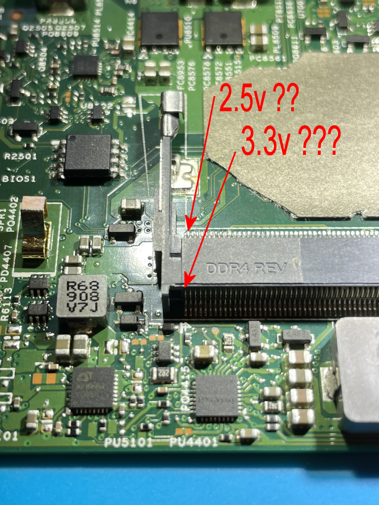

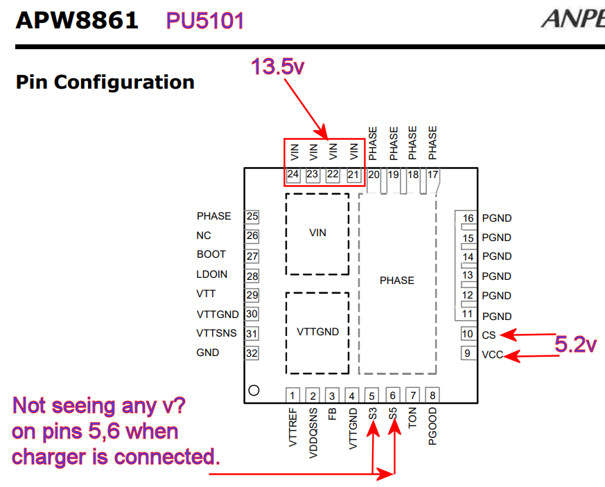

                  PU5101 on Pg 51 is your ram ic. Pin5/6 are enable pins.Check voltage on pin9/10/21 also. Note that enable will come after switching only.

                    Hi again, thanks for pointing out the IC.
                    So, i checked the voltages on pins 9/10/21 (see diagram below).
                    (Note:The power button on the laptop is basically useless after connecting the charger, as the laptop goes straight to S5 mode, but the button does switch it off ok).
                    Okay, so on Pins 5,6 I wasn't seeing any change when the charger was plugged in (am i looking for a quick on and off voltage here ?)
                    Where do i go from here ? many thanks for your help with this.

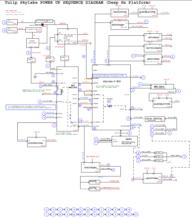

                      Absence of PM_SLP_S3/S5 is not a good sign .Does the power button has 3V and on pressing it goes to zero and bounce back to 3V?
                      The power button press goes to SIO and in turn SIO sends this feedback to PCH and then PCH will get activated. Here the PCH is not being asked to activate/not getting activated after receiving the signal from SIO. Can confirm after you give me the measurement.
                      Page 102 has the timing diagram.Check where you get stuck.

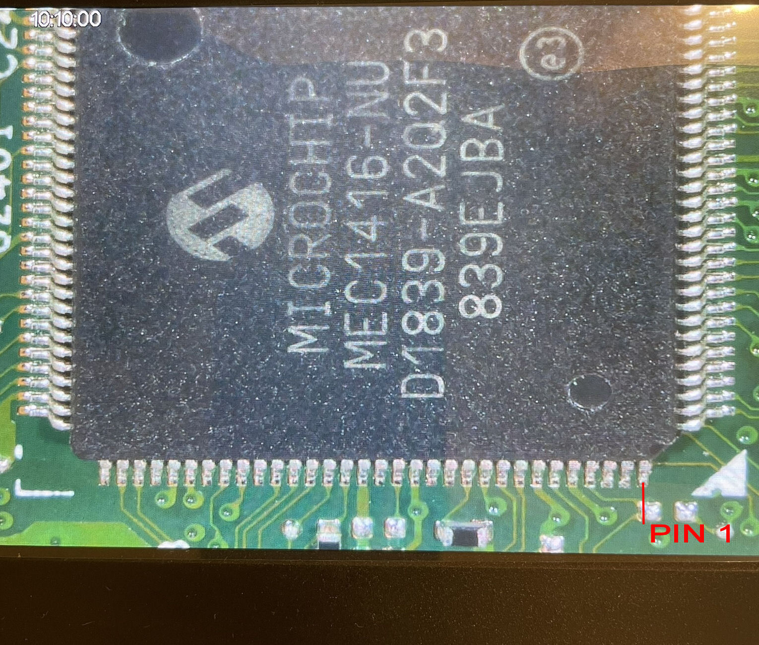

                        I then checked the SIO PIN-2 when the power button is pressed and it drops to 0v also. (and is 3.1v before button is pressed).
                        I checked a few other voltages at the SIO (first row only);
                        PWR BTN Not Pressed vs PWR BTN IS pressed
                        PIN 01 - 3.3v - 3.3v
                        PIN 02 - 3.3v - 0.08v
                        PIN 03 - 3.14v - 3.13v
                        PIN 04 - 3.14v - 3.13v

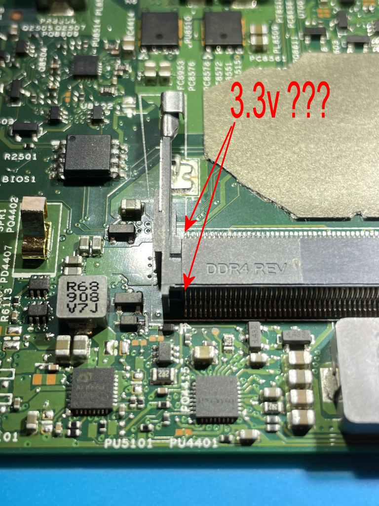

                        ** On a random check with the LED flashing (S5) , I tested the voltage on the very last pin of the RAM slot #2 (nearest to PU5101) and I'm getting 3.3v ?? on the outside and 2.5v on the inside ??
                        Surely that cant be right for SODIMM ? Shouldn't I just be getting 1.2v ? (note: On RAM socket 1 I do not get any voltage present on the last RAM pin ?)
                        Click image for larger version  Name:	RAM_v_3 (Medium) (1).png Views:	0 Size:	1.20 MB ID:	3164145
                        What's next area I can check ? thanks

                          Ram slot does receive 2.5V(VPP),3.3V(SPD)-so perhaps nothing wrong there.Pin27-RSMRST# is pulled low and should be 3.3V instead. Its pulled low means its in reset mode.
                          Measure resistance to GND on RSMRST# pin. Should be 10K or higher.
                          Have you flashed the bios?

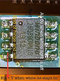

                            Tried to measure for any resistance on SIO Chip Pin #27 - GPIO123/SHD_CS# to GND, but I got no value at all on the multi-meter (also tried another meter just to be sure).
                            No, I haven't tried to re-flash the bios, but I did take a copy of it before I started doing anything, using a programmer.

                              Meter not showing any reading means meter is set to alower scale. Set your multimeter to 200K scale and then measure RSMRST# pin resistance to GND.
                              I'm not a bios expert though i do manage my own requirements of building a fresh bios from manufacturer's update files. You should make a request in "BIOS SECTION" and there are very capable people in that subforum who will build a fresh bios for you.

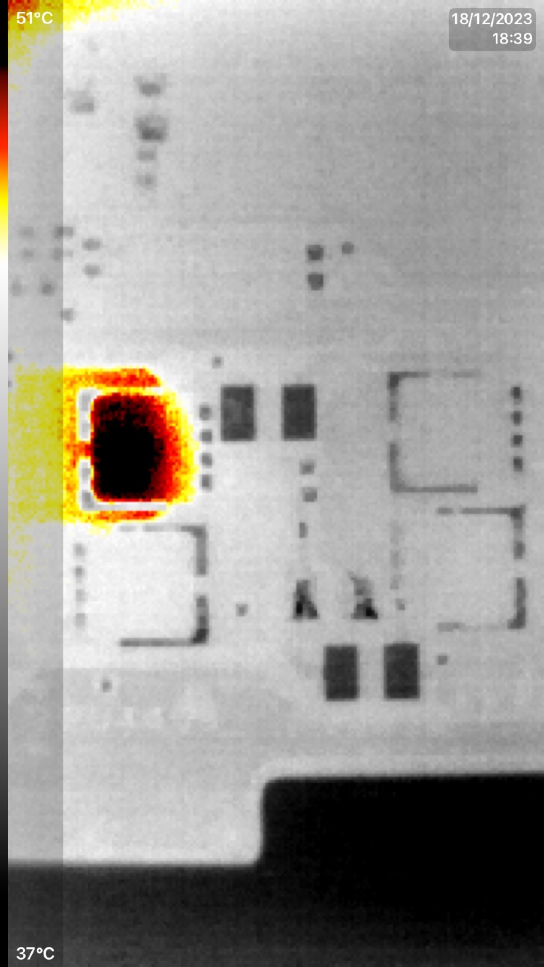

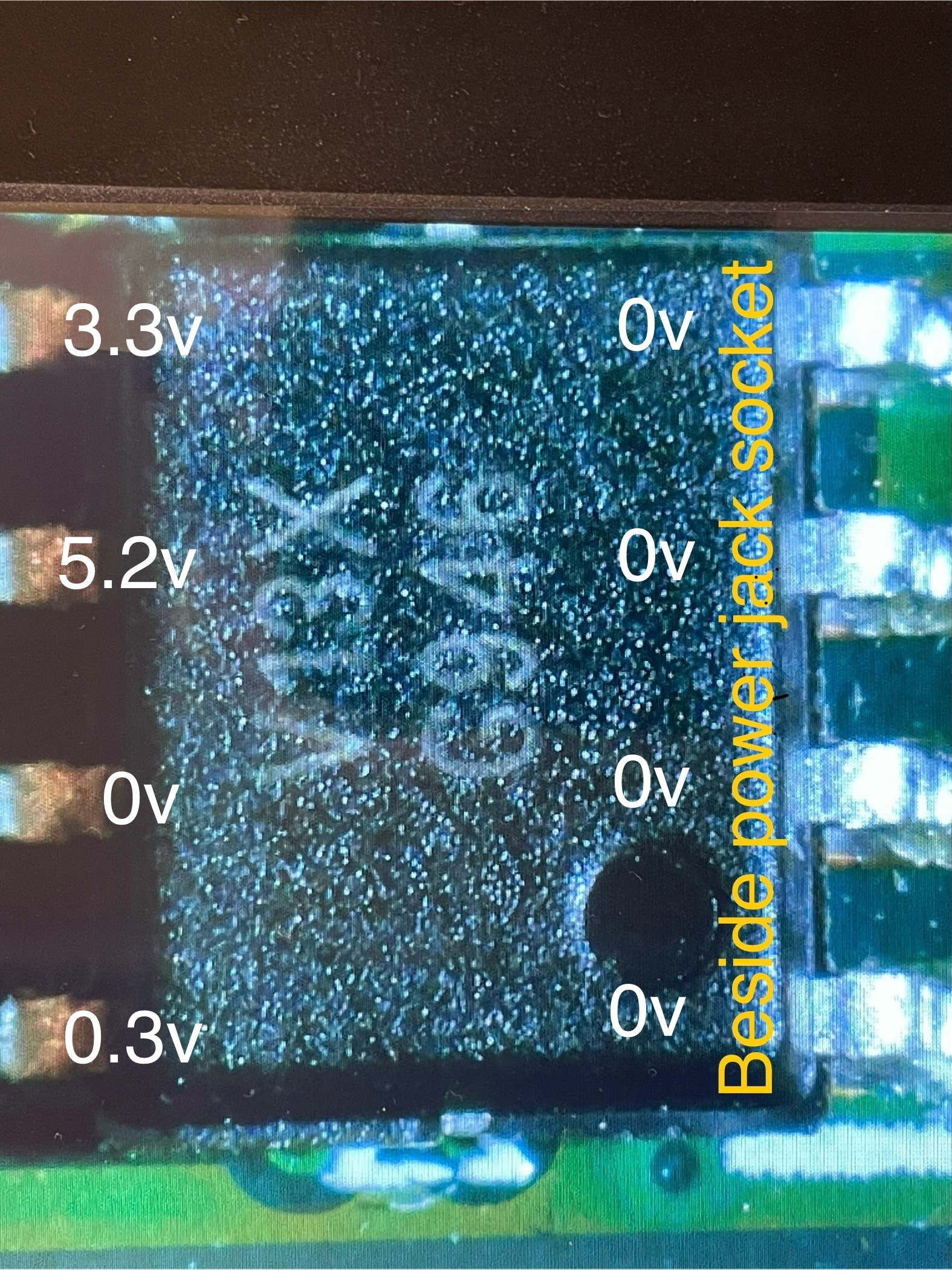

                                meantime, something has changed after all the poking around this laptop. The original fault evolved from just the laptop flashing the KB backlight and nothing else, then it went into a state of flashing 3 amber and 5 white leds. Now the CPU has decided to get quite hot. Not perfect but seems like progress lol. All i need now is the GPU to come on and i will have picture ... i wish.

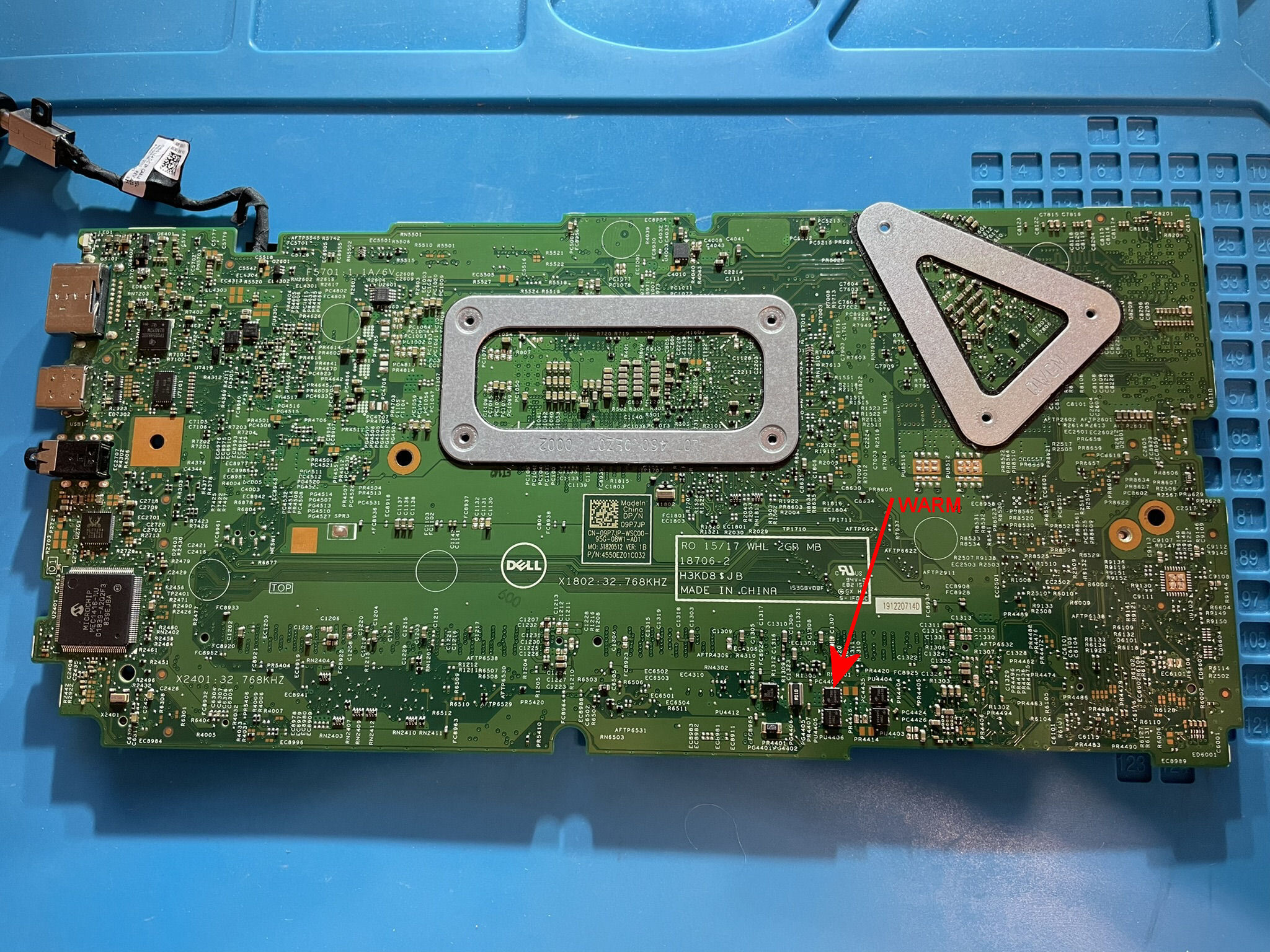

                                Also, i had another quick view over the board with a thermal camera and noticed a very slight temp increase on one of the mossfets on the other side of the board. There are 4 in a group and one displayed as hotter than the others. Maybe its meant to ? im not sure , but i would have thought all of them would be warm when activated ? Its not hot or even warm to the touch, but the camera did pick it up none the less, so maybe another piece of the puzzle found ?
                                image attached

                                  Is that mosfet PU4405? If yes, then it is part of charging circuit. This fet is expected to be warm if battery is connected and its charging-else should not be warm. Time to remove the fet from motherboard and do resistance check between
                                  01.Pin1-4
                                  02.Pin1-8
                                  03.Pin4-8
                                  Meter should be in Mohms range and not Kohms.

                                    Hi, I know i should remove mosfets for proper measurement but i thought id just test them in situ to see if any readings were way off and one of them was , and it wasn't the one that gets "warm" (red square) when charger is plugged in?
                                    As you can see in the image below, I'm getting a very odd reading (26 Ohms) between all the contacts on the lower-right mosfet (no matter which way round the probes are positioned). Whereas, readings are "normal" on all the other 3 mosfets (including the one that just warms (in red square)...?
                                    Could the lower-right mosfet be the culprit , and not the top-left one as first thought ?
                                    Click image for larger version  Name:	IMG_7132.jpg Views:	0 Size:	741.7 KB ID:	3165589
                                    • mon2
                                      • Dec 2019
                                      • 14673
                                      Start with fluxing and removing the nearby cap so it is not lost. Check the resistance again. Then flux and remove this likely shorted mosfet. Allow it to cool on your table test the resistance again.
                                      • zlr8r
                                        • Feb 2023
                                        • 101
                                        Thank you for advice. Just before I try that, I just noticed one other thing on a continuity test. Both Source contacts on these two mosfets, have a direct short to GND ? is that normal? thanks
                                        Click image for larger version  Name:	4-mosfets.png Views:	0 Size:	4.30 MB ID:	3165634
