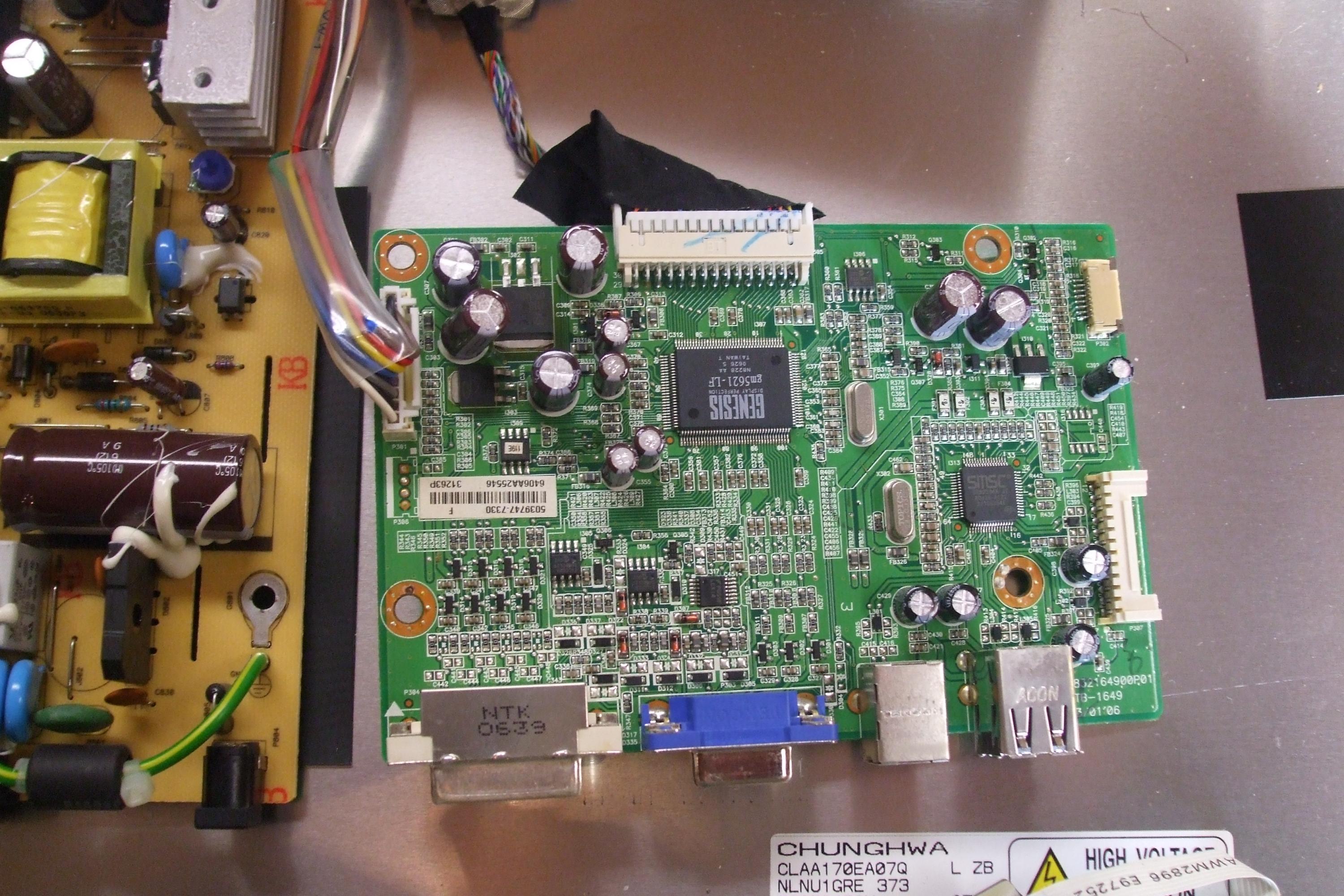

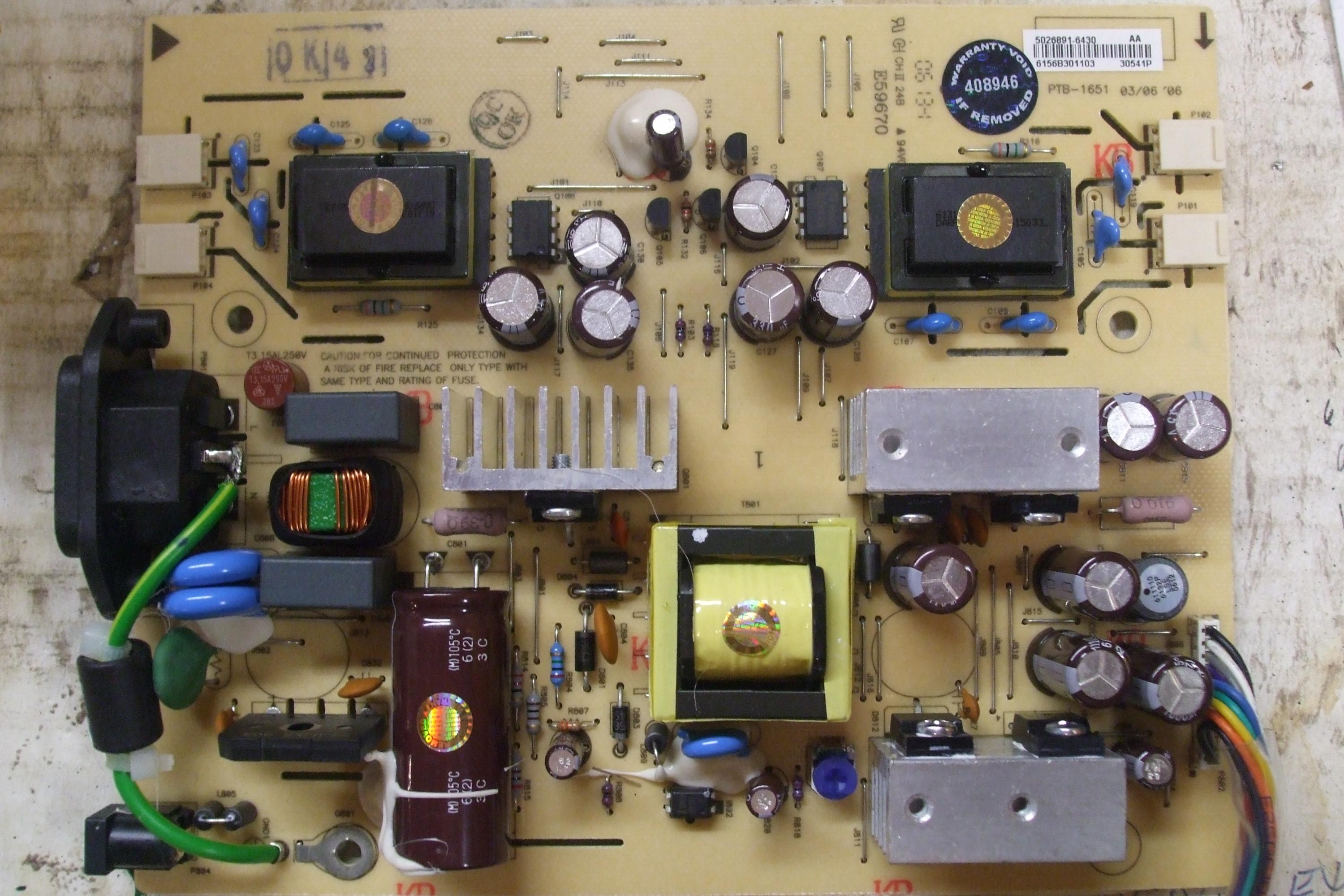

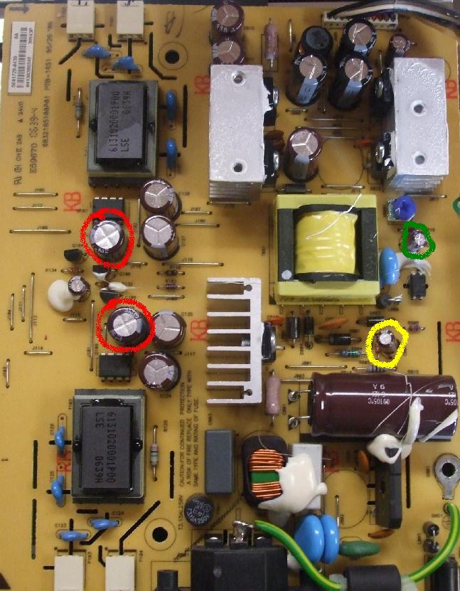

              Can we just recap on what you are working on - perhaps repost pictures top and bottom of any boards - what are you calling the inverter board? inverter transformers are on the power supply?
              Test any fuses and give board numbers F100 F200 etc
              Test and repost voltage on the main cap a) when plugged in b) when switched on.
              Test and repost the voltages measured on the connector between the Power supply and main board a) when plugged in b) when switched on. c with the main board disconnected, d) with the main board connected but the panel -lvds cable unplugged.
              If you have established which is the pson get a 500 ohm-1kohm resistor and with the main board diconnected jumper 5v to pson and see if the backlights come on.
              If not, is there also a blon pin if so, in the same way jump 5v to Blon as well.
              Best to set up the jumper then switch on the mains power.

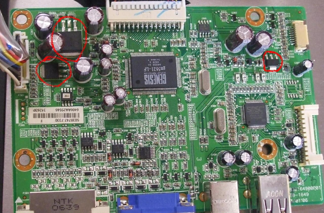

                      I count three voltage regulators on the main board. Please report the readings as per my guide.
                      There are likely no voltage regulators on the inverter board. There may be a voltage regulator on the panel or t-con board.

                        Would those be I301, I311, & I318? I've checked 318, it's 5v input, 3.3v output. I said 5v earlier, my bad. Have not checked the other two, if tha's the ones you are referring to.
                        Another correction, the voltage on the new board at the large cap is between 168.9 & 169.4vdc.
                        Her are photos of new board.

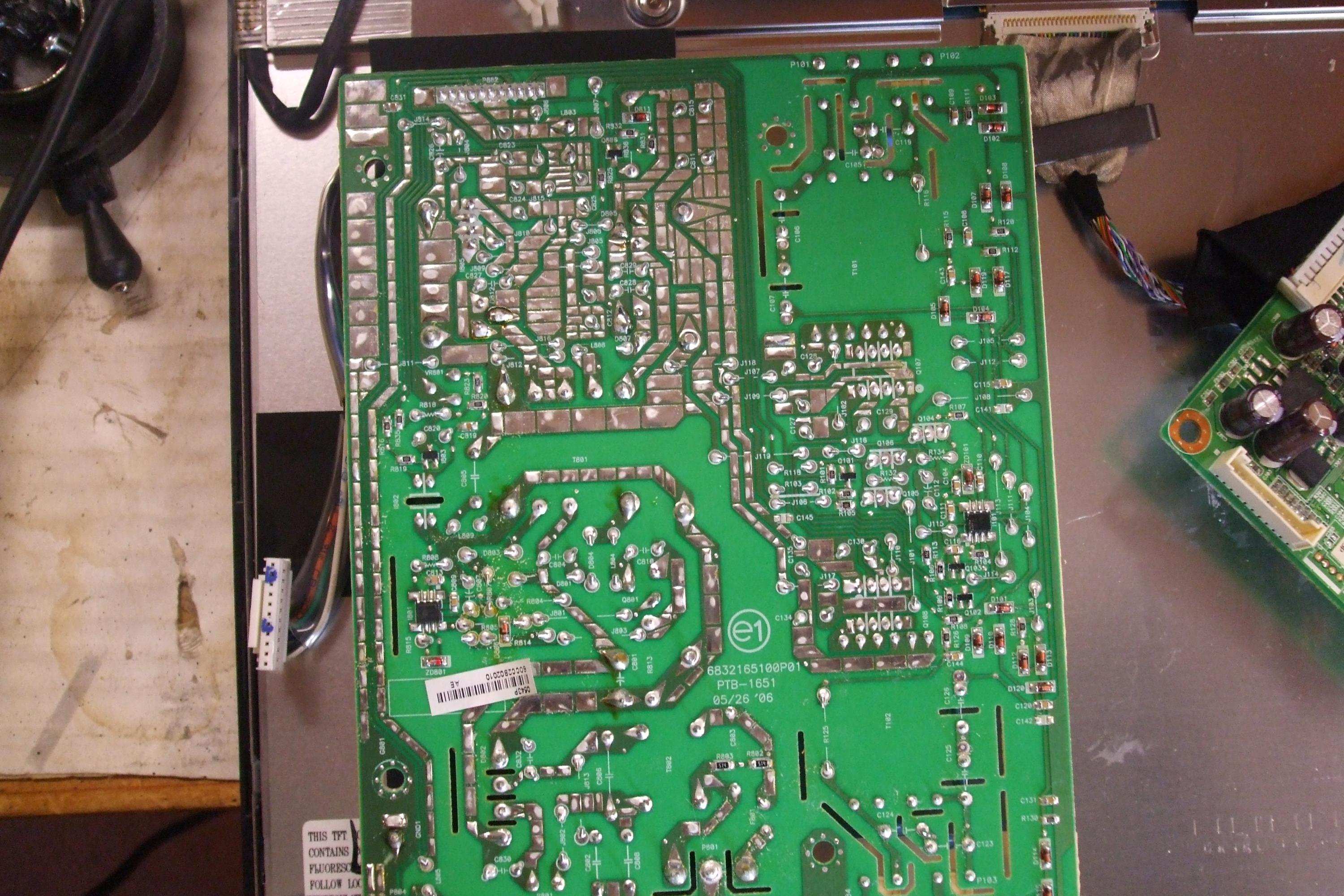

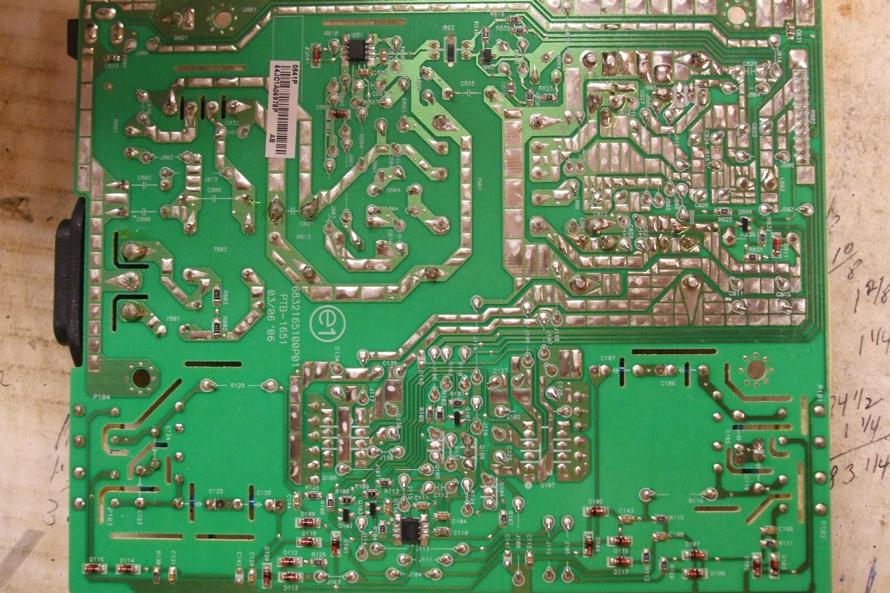

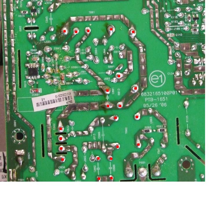

                          I know you did some reflowing but wonder if you did enough.
                          If this is an early dell board it may be suffering the Benq/Dell cold joint
                          disease. Which means nearly all the primary side needs reflowing.
                          Remove as much old solder as you can and apply fresh to the points in the picture. Check it over with a magnifier.

                            I applied flux and resoldered all these joints, but did not remove old solder. How about I do this on the new board, sence it almost fired up the ccfls?

                              Sounds good to me- there are are few odd looking joints on the new one - the bridge rectifier and C805 and a joint just below it which I think is on the transformer - im off for an early night.

                                I don't know what you are looking at, but see photo.
