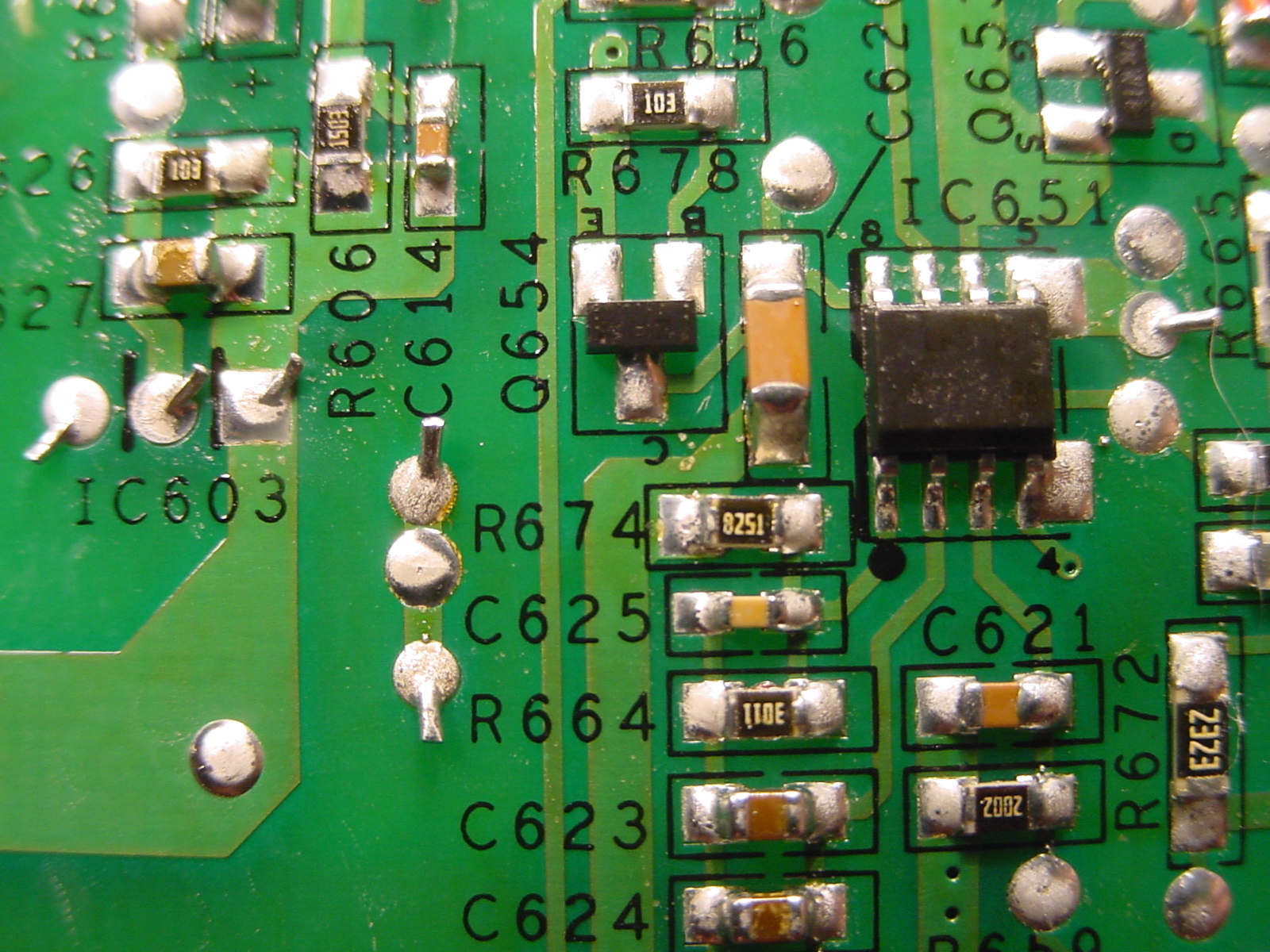

                Thanks for the list, on my PCB all the mentioned parts are blown plus these:
                R674
                Q654
                Earlier in this thread it was mentioned that R674 could probably be read as "8251". Would be nice if anybody can confirm this to 100% before I place my order

                  • sebr
                    • Oct 2010
                    • 79
                    #329
                    Re: Dell 2407WFPb Monitor - Bad Cap
                    Another SUCCESS here!
                    I replaced all the parts listed two posts above and the unit is working.
                    Beside that I highly recommend to change the five output caps and the three caps on the inverter, like some people here already suggested. They are also Elite brand.
                    PS: R674 is marked "8251", now I can confirm.

                        • sebr
                          • Oct 2010
                          • 79
                          #332
                          I'm talking about C711-C715 on the PSU board. I replaced them with Panasonic FC/FM caps just as I did with those three from the inverter. If after that your CCFL don't come up fully, I would suggest looking for cold soldering joints (inverter).

                                • sebr
                                  • Oct 2010
                                  • 79
                                  #336
                                  Here you go: https://www.badcaps.net/forum/attach...4&d=1316486210
                                    #337
                                    Here:
                                    R674 = 8251 = 8250 Ohms (I measured it to verify)
                                    R678 = 103 = 10K Ohms
                                    More pictures here:
                                    http://s807.photobucket.com/albums/y...ll%202407WFPB/
                                    More power supply board:
                                    http://s807.photobucket.com/albums/y...upply%20board/
