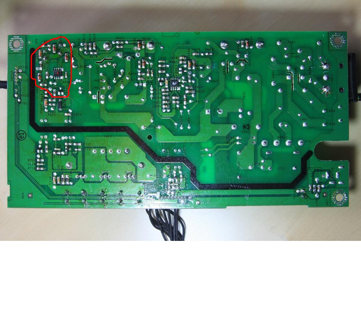

                        • sabretooth
                          • Apr 2012
                          • 62
                          #232
                          Re: Dell 2407WFPb Monitor - Bad Cap
                          Alright, busy times but got some time to clean up the circuit board and take a photo.
                          I'm pretty sure I've ruined it! See attached.

                              • selldoor
                                Slow Learner
                                • Dec 2010
                                • 7870
                                #235
                                Right - Help required from circuit experts - I attach a pic - I have guessed that the IC in question is a NCP1200A (got confused in the threads) Most of the connections seem obvious but struggling with where pin 8 goes. Sabretooth can you see the hole/pin I have dotted the yellow to - what is on the other side of the board at that point. Can you do a close up of the area.
                                Team -feel free to comment this is a suggestion only and we dont want to cause further damage.
                                  #236
                                  If I am correct, that HV pin is the kick start power input from the main DC supply through a bunch of resistors connected in series to drop the 325 Vdc from the main cap down to about 12~18vdc to start the SMPS, once it started, the power supply circuit inside the SMPS will switch from the HV pin to the VCC pin which is generated by the extra winding off the transformer.
                                  I have the 2407WFPB at home that I need to work on, so which board is this I need to look at?
                                  • selldoor
                                    Slow Learner
                                    • Dec 2010
                                    • 7870
                                    #237
                                    Power supply back – board number is 4H.L2K02.A01 position marked on attached

                                      • WillyBobz
                                        • May 2011
                                        • 11
                                        • England
                                        #239
                                        Pin 8 connects to R603 on other side of board as in the Diagram on the link in my previous response.
                                        I have checked this against a power supply board that I have on the bench.
                                        Sorry unable to take a decent picture (close up)
                                        • selldoor
                                          Slow Learner
                                          • Dec 2010
                                          • 7870
                                          #240
                                          Thats Great Willybobz - I forgot there is a high def pic earlier in the post.
                                          I think we just need sabretooth to test what pads he has got for continuity to the next joint then he can try and fit it. Any without continuity will have to be wired. Perhaps he can put a snipped cap leg into the "through" and a
                                          small wire from that to pin 8 rather than just a solder blob. Anyone any other ideas.
