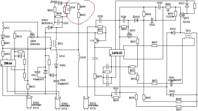

          #364
          Re: Dell 2407WFPb Monitor - Bad Cap
          Yeah, I have had a look at the components and it "looks" fine - so I am kinda hoping someone will be able to answer my 3 questions
          I want to find out the resistance between the 3 legs of Q651 when it is on the board. I get a very small resistance between the 3 legs (about 115 ohm)
          Also what is the resistance across the Zener diode ZD601 on the board? Again, I get a small resistance.
          Would a 2W rating be sufficient for Resistor R670 (0.23 ohm) - this is the only other component that has obvious damage
              Thanks again
              You need an transistortester to check Q651 and the ZD601
              When you R670 is damage there is more damage.

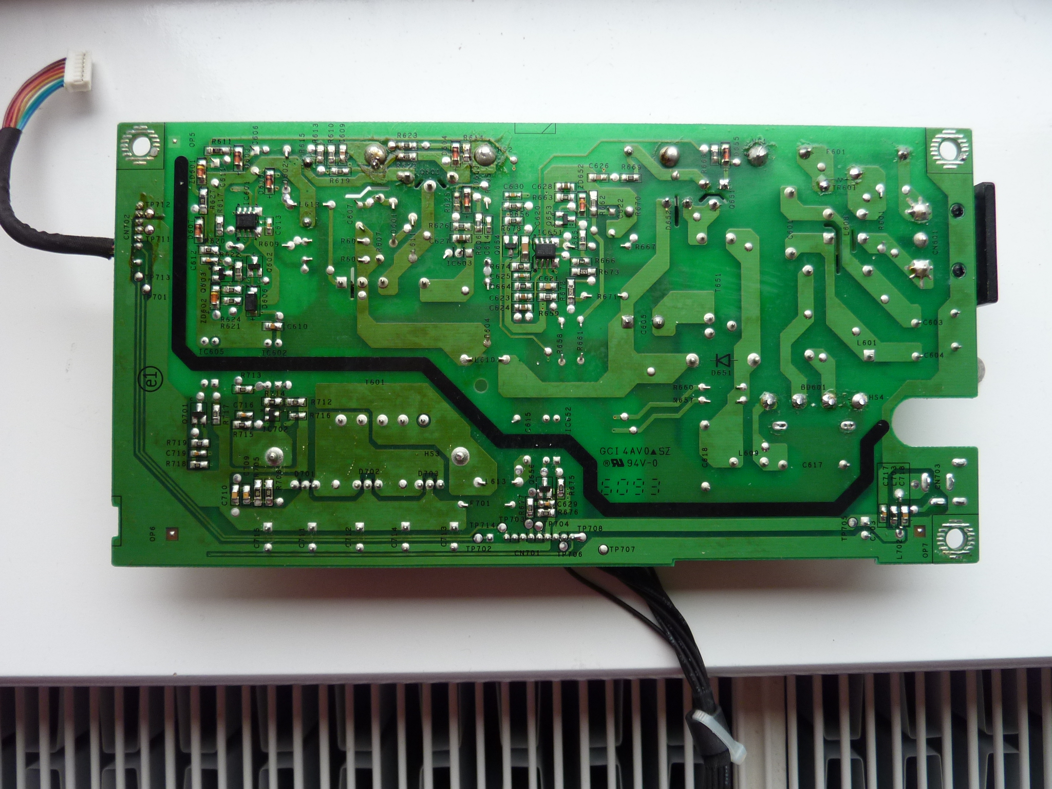

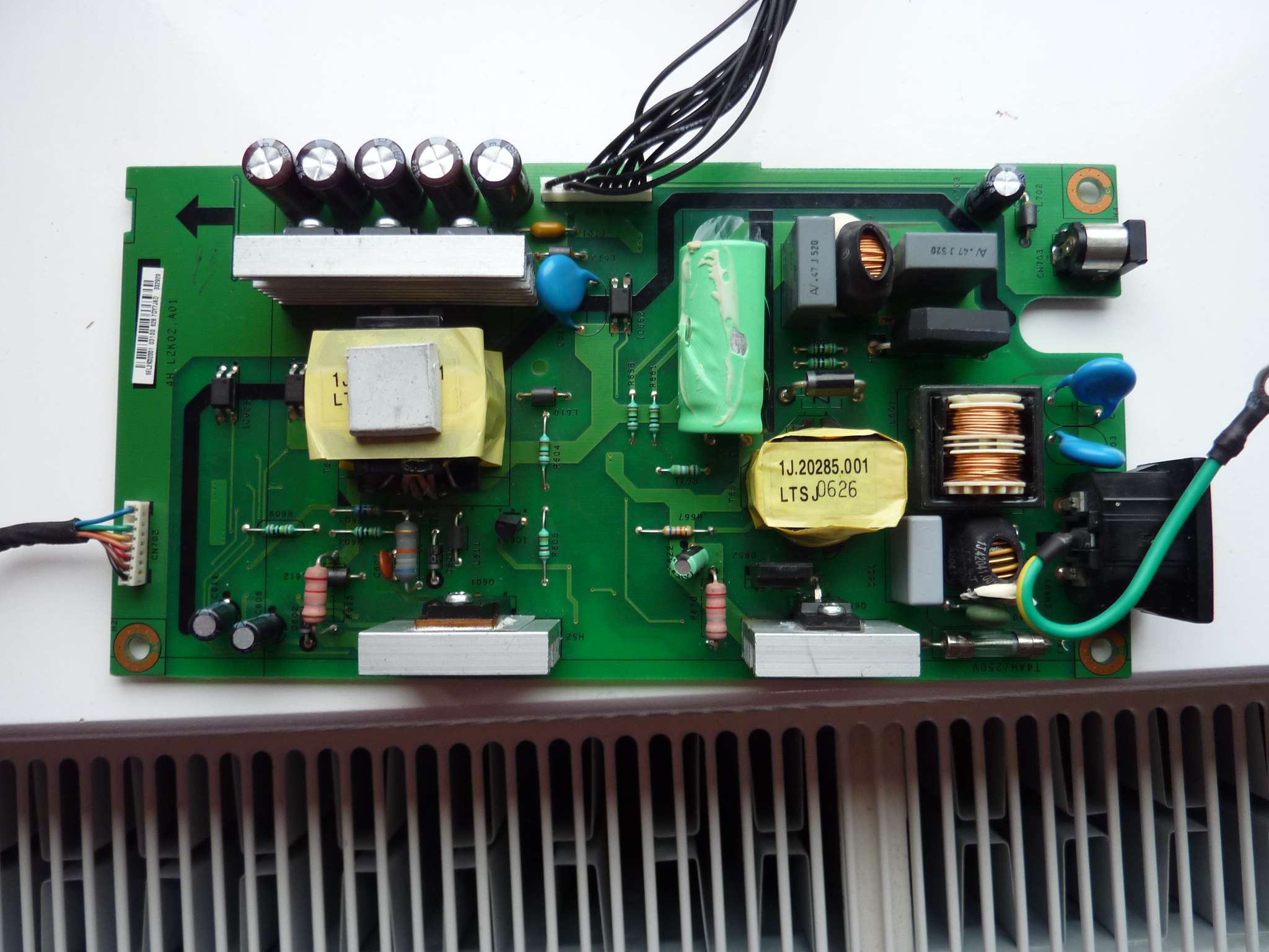

                      Re: Dell 2407WFPb Monitor dead psu
                      Can anyone help , I was given a Dell 2407 monitor with a faulty power supply model numer 4H.L2K02.A01
                      The 400v cap was leaking, R670 blown, Q651 (2sk3502) blown and the main fuse has blown.
                      I have replaced the 400V cap, R670, Q651 (2sk3502) and the main fuse, No bang but still no power out.
                      I then replaced the IC651 (L6561D) but still no power out.
                      I have the 300v DC @ L610 TO R605, 166V from R605 to R604 and only 19v from R604 to C614, after that @ T601 no volts.

                          Can you post a good clear picture of your power supply board
                          • terry
                            • Oct 2007
                            • 91
                            • Milton Keynes, Bucks
                            #373
                            Here are some pictures of the power board, hope they help. The large green cap is fine, the marks are where it was glued the other way up on the power board I removed it from.
                              Quick questions - I have to go out
                              The Big cap IS the right way round?
                              There is a small yellow torpedo fuse F701 just to the left of the big cap - does that test ok. Resistance and voltage both sides with respect to ground screw.
                              I think on the Main Board - all these posts and I cant spot a single decent picture of the whole board- near one of the connectors there may be a small black rectangular fuse with a 20 or 2.0
                              on it - if you can find it can you test it as well.

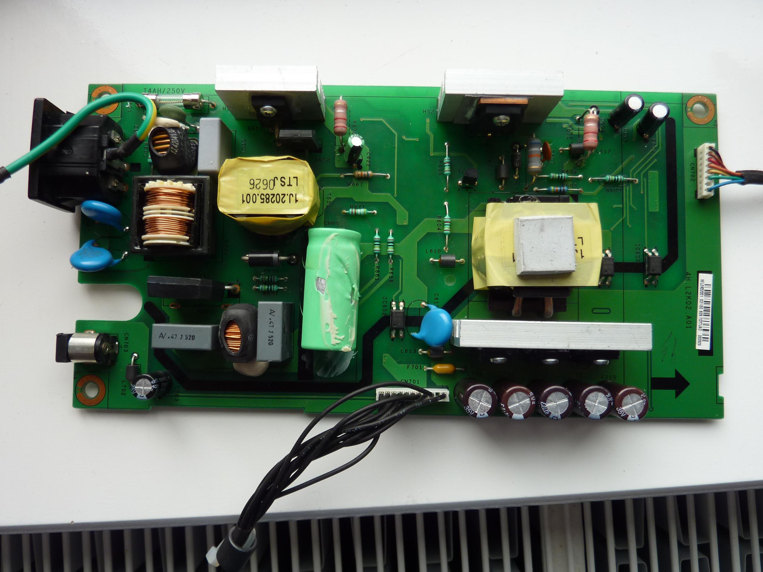

                              • terry
                                • Oct 2007
                                • 91
                                #375
                                The big cap is the correct way round, I have checked F701 and that's fine. I have had a good look at the board and I can not see any more fuses.
                                I have just uploaded some full size pictures to my website, if you want to have a look at them that would be great. www.linfotech.co.uk/psu1.jpg www.linfotech.co.uk/psu2.jpg
                                Terry

                                  #376
                                  Yes the small black fuse maybe is on the Main Board
                                  It was that I was wanting a picture of
                                  On the back of the psu the solder around one of the heatsink joilnts looks a bit odd touching the other trace? (maybe just the picture)- perhaps just try cleaning it up a bit.
