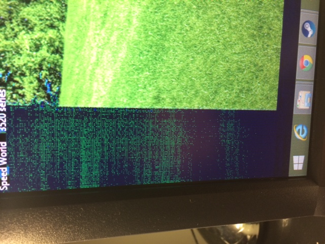

                Hi All
                I've just picked up a Dell 2405fpw and I'm experiencing some flickering issues and distorted colours. Can anyone diagnose what this problem is? I've taken two photos of the issue I'm seeing
                http://s27.postimg.org/xe1khj8jz/IMG_2718.jpg
                http://s27.postimg.org/5ryswup73/IMG_2719.jpg
                Just wondering if its the panel itself or something I can replace (whether it be a bad cap or logic board/port etc)
                Thanks in advance
                Cameron
                • Cam81
                  • Nov 2014
                  • 3
                  #508
                  Re: Dell 2407WFPb Monitor - Bad Cap
                  Sorry for the crappy photos I didn't realise they were this small. What I'm seeing are blue/green lines more pronounced on darker backgrounds or images (even videos). The lines aren't static, if I'm watching a video the artifacts will move around? Hard to describe.

                    #509
                    https://www.badcaps.net/forum/showthread.php?t=39740
                    • Cam81
                      • Nov 2014
                      • 3
                      #510
                      Sorry. Round two.
                      Attached photos. Have tried factory reset, DVI port/VGA port (same prob). Oddly different backgrounds and colours seem to be fine, in the last photo just by highlighting the icon it seemed to go away
                      Also tried running this tool which seemed to work (I think it was a coincidence) for about 30mins and then it went back to being problematic.
                      http://en.community.dell.com/support...529/t/18688000
                      Just not sure what it is? Does anyone know if its the panel itself? I'm not sure of the symptoms of a bad cap or logic board as its still powering on and functional despite the artefacts.
                      • selldoor
                        Slow Learner
                        • Dec 2010
                        • 7870
                        #511
                        Have you actually opened it up and looked inside??
                        Those are the pictures we need.

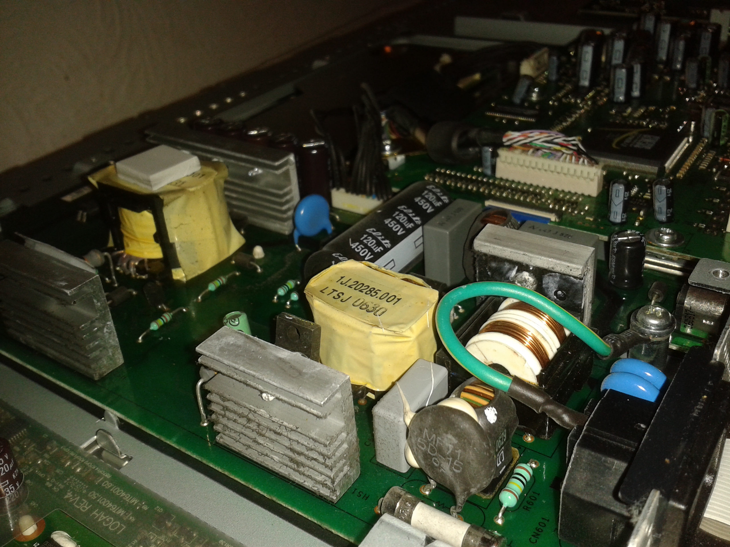

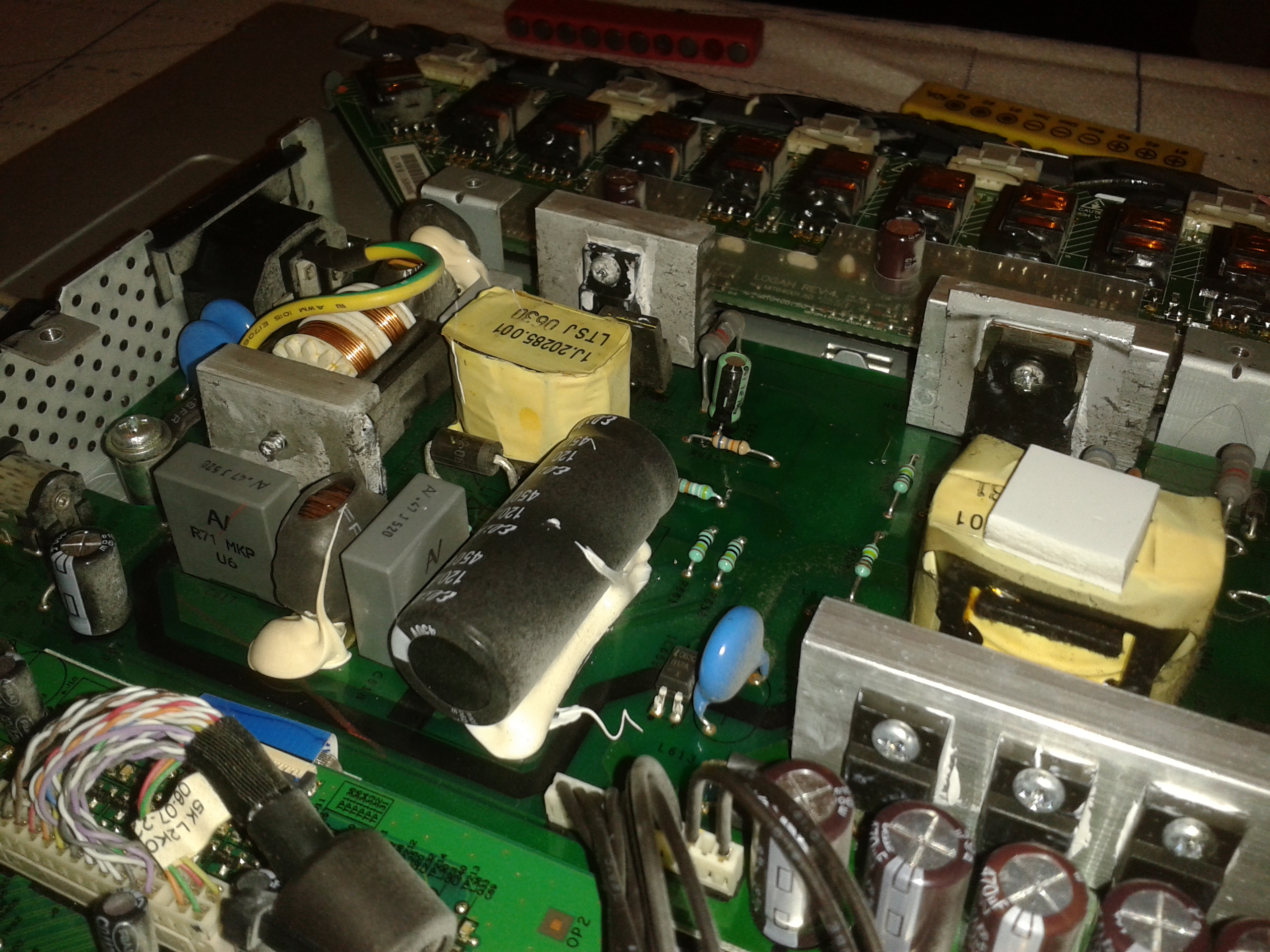

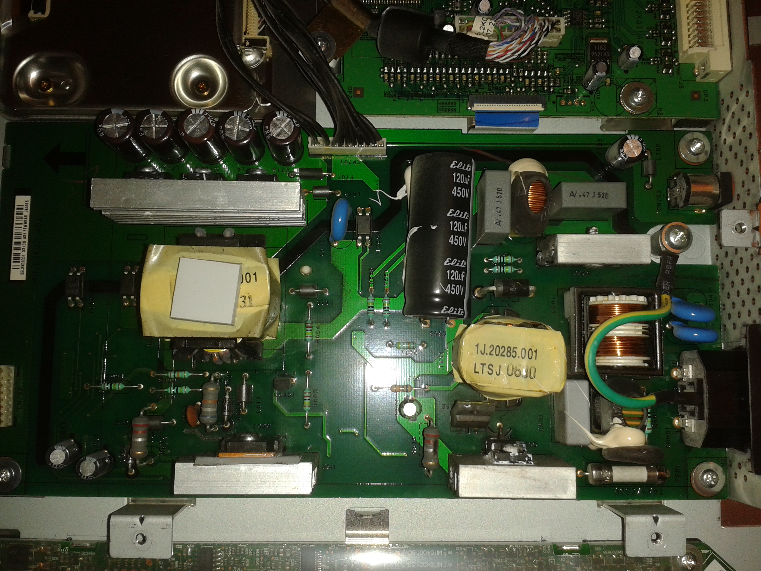

                          Hi there a new member here I have owned my dell 2407wfp for just over 8 years and its been fine - up until today
                          I had it connected up to one of those intelligent power extensions, when my PC is turned on, it turns on the monitor, when my PC is shutdown or put to sleep then the monitor turns off.
                          --back-story, please ignore information about PC as it's definitely the monitor with problems--
                          This morning I turned on my PC and was greeted with what sounded by rustling crisp packets followed by a pop. I thought something was wrong with my PC so I turned everything off at the wall and went to inspect the PC. I replaced the PC PSU with a spare and tried again, this time I was close enough to hear another pop/bang from the monitor instead and noticed it was not powering up.
                          I tested the fuse for the plug on the monitor and found it was fine, so I tried powering it up again and it just produced the same pop sound without powering up.
                          So fast forward to now and I have taken the monitor apart to check for damage. I was hoping there would be scorch marks or obvious signs of damage so I could look into replacing parts instead, but the power board doesn't seem to have any obvious (at least to me) signs of damage. I can see cream stuff on a few of the parts but I am assuming this is just glue.
                          Anyway, here are some pictures, hopefully the quality is good enough:
                          (also added as attachments)
                          I don't really have a great understanding of how all this works, I do have some very basic electronics understanding and have a voltmeter if someone could point me to where to poke to test various parts (I understand enough not to plug it in while all the high voltage stuff is exposed)
                          Thanks for any help with this.
                          • bicycle6228
                            • Dec 2012
                            • 14
                            #513
                            I can see in your 3rd photo that R670 is burnt, and it's just out of view, but it looks like C605 has the usual chemical leakage at it's negative lead. In all, there will be about 8 to 10 components needing replacement to get this board working, some of them involving rather tricky soldering of tiny surface mount components. http://home.comcast.net/~tomdempster...%20Service.htm
