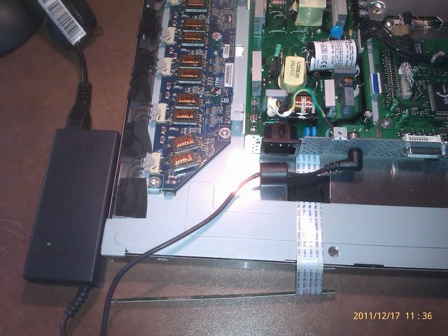

                        Got it fixed now. New approach though. I began to wonder what voltage(s) were supposed to be produced by the SMPS so traced out the circuit around the output transformer. The feedback for the buck stage is obtained via an opto switch that comes on at about 20V (determined by a LM431 variable Zener). Just the one 20V supply rail then! A quick hookup to a bench supply confirms a happy monitor when juiced by 20V@3A.
                        Because the final output is a bunch of diodes fed from the switching transformer, it's OK to run an external 20V supply straight onto the board (across the row of 470u/35V caps). The diodes block current from going back into the transformer. I tweaked the voltage around and monitored the opto switch switch-on point confirming that the SMPS is set to run at 20V.
                        Now, I remembered that I had a spare power brick from my previous Dell monitor and sure enough it's rated 20V@3.5A. Not only that, but the DC jack fits the Loudspeaker output - so I cut the inductor (L702) that fed it power from the main board and jumpered a wire to the 20V rail (photo). I also grounded the switch contact that tells the MB the speaker isn't plugged in, even though the power plug is in. Oh, and I left the fuse off the SMPS just incase it ever gets plugged into the mains by accident!

                            Thanks - well, once the bypassed PFC stage was out of the way, it was all down to the NCP1200 convertor. This particular implementation deviates from the typical application circuit in the datasheet - mostly around the VCC connection which has a SCR connecting an additional winding on the output transformer. I started running out of patience staring at this part of the circuit though.
                            All the semis were intact - 0.6V between appropriate junctions in-circuit, Zeners biased off-board etc. But the NCP1200 VCC hunted around 3V to 5V the whole time and I don't particularly like probing around 330VDC circuits so I didn't look into it much further.
                            I think there may already be a few misconceptions about this board - some seem to think there's a standby stage and a main stage, possibly because of the part description in the Onsemi datasheet? I suspect that the MB just shuts off the PFC when in standby using opto IC652 and adjusts cycle skipping via opto IC605 but other than that runs the whole thing as a low power (60W) convertor all the time.

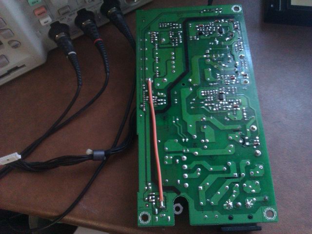

                                Tyan, the speaker socket/power mod is a simple three-step process:
                                1) In the photo attached below I have marked both ends of L702, which is to be removed from the PCB, with magenta crosses. De-solder or just cut both ends of this inductor (a bit of wire that passes through a ferrite bead on the component side). This isolates the power socket from it's normal supply circuit.
                                2) The short blue line shows where to solder a bridging wire to permanently ground the switched contact for the socket CN703 - making it seem that the speaker isn't plugged in. A blob of solder across C718 would also do the trick.
                                3) Run a decent gauge stranded, insulated wire between the points marked with an orange line. To get a good solder joint on the land between C713 and F701 scrape away the lacquer first. The other end of this wire goes down onto the middle pin of socket CN703 which is already quite well exposed for soldering.
                                That's really all there is to it! The central pin in the speaker socket may be a little smaller than the power-brick plug (2.1mm vs 2.5mm I think) If it doesn't connect very well, it might be necessary to roll a small piece of copper or tin shim to increase the diameter of the centre pin. If that's too fiddly then you can always swap the socket for the correct sized one, or find an adaptor lead. I slipped a slender wire crimp insert over the pin which worked a treat.
