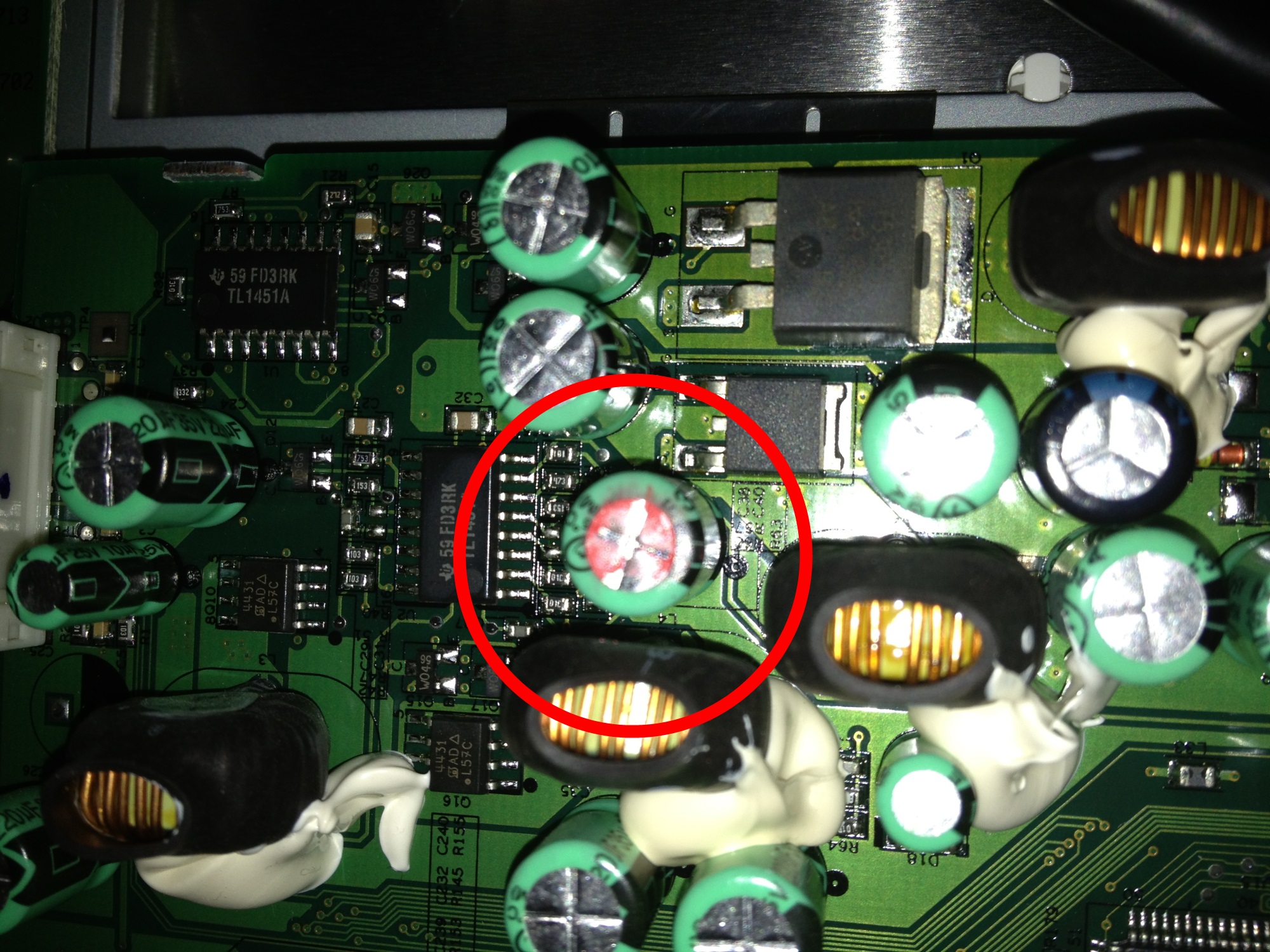

                            Re: Dell 2407WFPb Monitor - Bad Cap
                            Well I am joining this thread as well to say I have one of these monitors that encountered the same main cap with the same issue on one of the poles. Now I have ordered my replacement for that. But I have noticed that there is one cap on the video input board I would like your opinion on (bad or not bad?) The Cap is a 35v 220uf 105c. I have attached it here:
                            • jetadm123
                              • 2169
                              #394
                              Looks more like red ink from a marker. Leakage from a cap is brown in color.
                                It is coming from the edges of the top leaking inwards to the middle. I also thought it was just marker, and it isn't bulging. But I also never have seen marker look like a powderish substance.
                                • retiredcaps
                                  • Apr 2010
                                  • 9271
                                  #396
                                  If in doubt, replace it since caps are relatively cheap (probably 50 cents).
