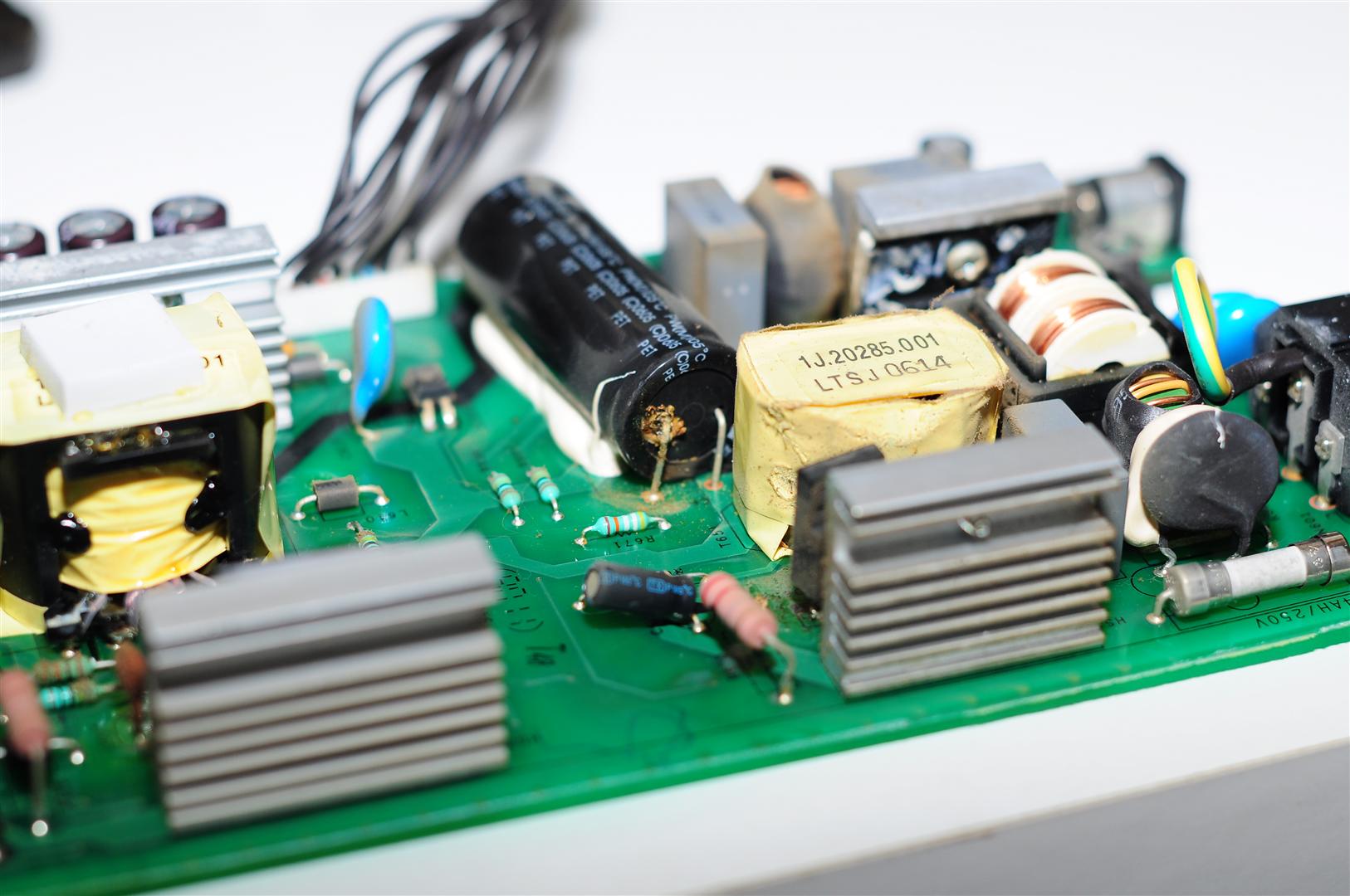

    Re: Dell 2407WFPb Monitor - Bad Cap
    If the monitor doesn't work after replacing these caps, check the surface-mount fuse on the smallest PCB, the one containing two DRAM chips and a large square IC. It is blown on the bad monitor I have here. It is labelled F1 I think or something Fxxx.
    You can buy very small micro pigtail fuses to replace it with. Not sure what amperage rating it is so I cannot be of help there. Someone here can probably help if it turns out to be bad. Just cut the leads of the new fuse a bit short, bend with pliers into a tight "U" so they fit snugly around the old fuse, and add new solder to each side, leaving the bad fuse in place. Other fuses might be bad, too.
    Thanks for the thread, BTW, I am going to use this info to hopefully repair this one.
    • Toasty
      • Jul 2007
      • 4171
      #62
      Originally posted by senquack
      <snip> It is blown on the bad monitor I have here. It is labelled F1 I think or something Fxxx. <snip>
      That's the video processing board. If it's blown there, then it's likely the regulator chip is toast. Right above the HDMI connector, IIRC.
      That could have happened because of a serious malfunction of some other component on the video board -or- the power supply went haywire and over-volted or bad caps in the PSU caused a very high ripple to be passed to it. Either way, you'll have to figure out the problem before just replacing the fuse. Those fuses get pricey fast.
      Toast
      EDIT: post a photo of the fuse and the markings please

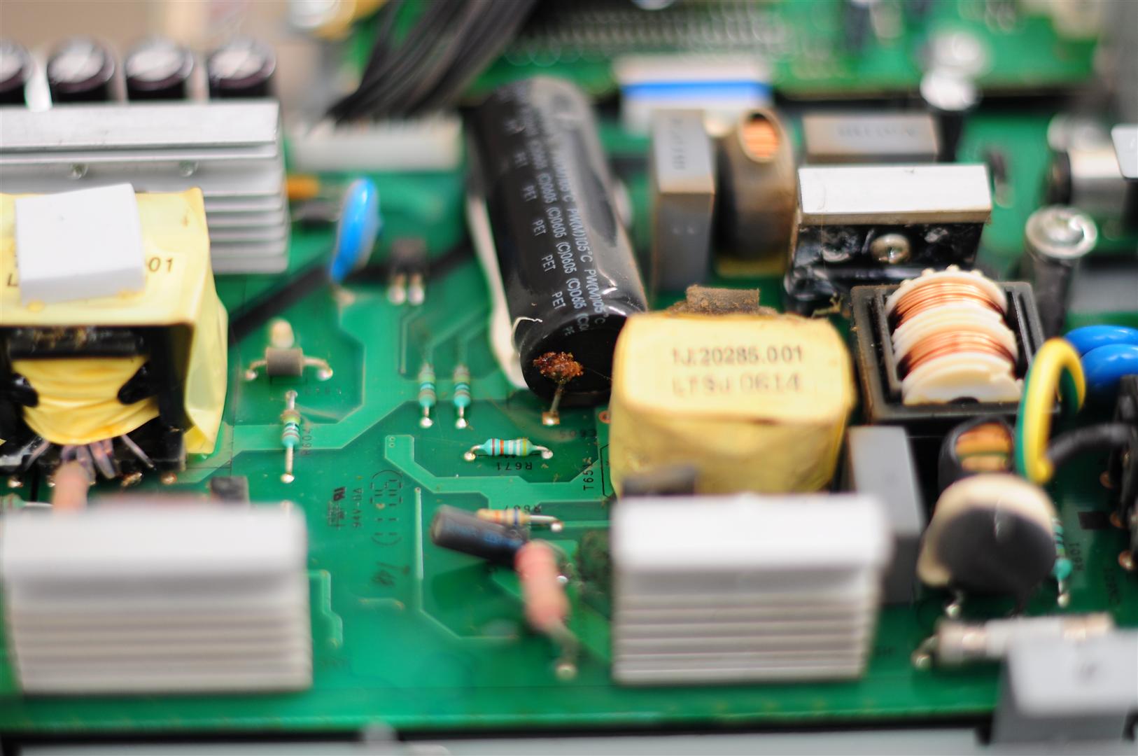

          #64
          Me too!
          Exact same problem. The photo on post #10 is identical to how mine looked. So much for it being unusual for large caps like this to fail.
          This is my first time to so I have found this thread invaluable, thank you all for your contributions, especially Toasty for his patience...
          Now the big Question...?
          Did It work? Has thewizard got his monitor running again? How about discopig?
          Will be doing this myself shortly and it would give me big warm fuzzies to here that it has been successful for someone else.
          Discopig are you going to replace all the caps or just the big bad one?

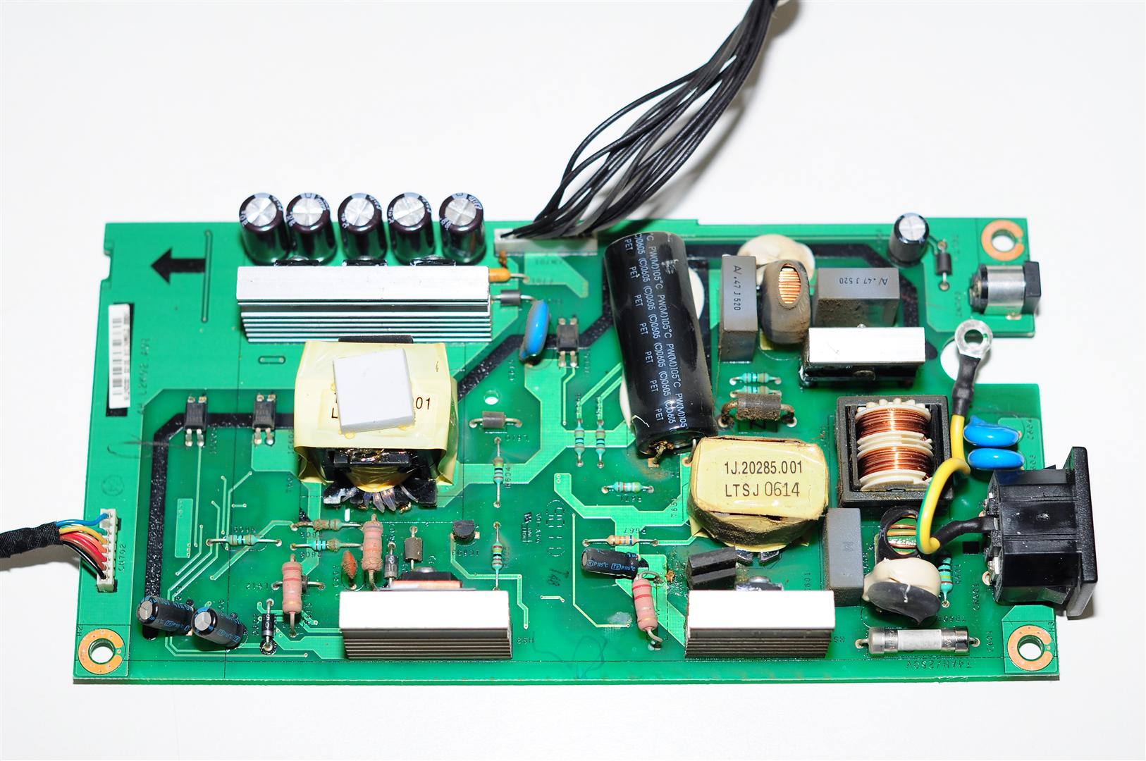

            #65
            Originally posted by nzrossi
            Me too!
            I replaced ALL the of caps on my powerboard, and I also replaced the 4a fuse and a burnt out resistor.... I did purchase all the parts from Farnells ( UK version of Element 14 ).. but out of interest there is a guy on Ebay which sells complete Cap replacement kits for most monitor models. Well excluding the 450v cap...
            Anyways, from there, after testing each cap individually after replacement, the fuse and the resistor, I powered on, and Bang... the fuse went ( wearing safety goggle or standing a safe distance is not a bad idea on first test if you are a newbie like me ).
            On close inspection of the power board... the board is looking scorched ( from wear not my testing ), So to be frank I am at a loss as to how to possibly fix this.. I have inspected all the parts on the board, and cannot see any damage. So I am suspecting the trouble is elsewhere or just plainly beyond my limited knowledge on the subject.
            Any suggestions?
            All the best Disco
            • jetadm123
              • 2169
              #66
              1) Please post some good focusesd photos of the top and bottom of YOUR power board. Use the "manage attachments" button to post your photos.
              2) As for the blown fuse, did you verify that you installed all the caps corrrectly? Check that the polarity is correct. Make sure there are no solder bridges .
              3) Indicate on your photo which resistor you replaced. This could be a clue.

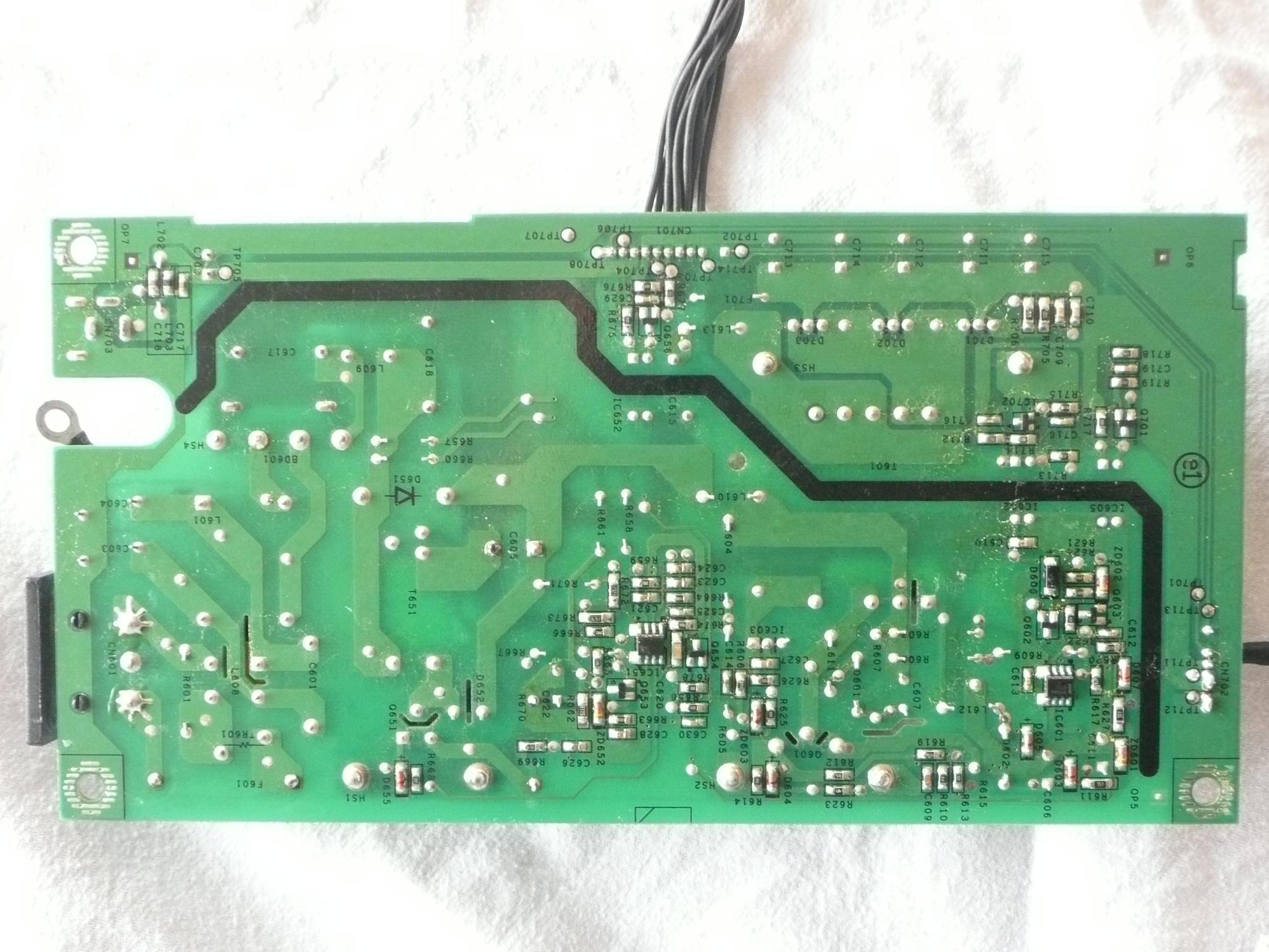

                      #70
                      One of the frustrating parts of trying to help people repair their monitors is the difficulty of getting information. Some monitors have service manuals available; others don't. Service manuals for Dell products are hard to find.
                      With the information you give, I can deduce a few things. The monitor was made by Benq for Dell. It's a 24" screen, so the power supply probably has main and standby sections, and a PFC front end. Searching on the fragment of a part number you gave generates only a few hits. Interestingly, one was on the ST Microelectronics web site.
                      The single most important piece of information we can get is a description of the problem; I've got a pretty good idea of that, no further details are required. The second most useful piece of information is pictures of the monitor - in this case, of the power supply. Attach them using 'Manage Attachments' - below the text entry area.
                      Now, if you would be so kind as to provide top and bottom pictures of the power supply, just maybe someone will recognize the related model of Benq, or have seen the same power supply in another brand of monitor - HP also buys their monitors from Benq.

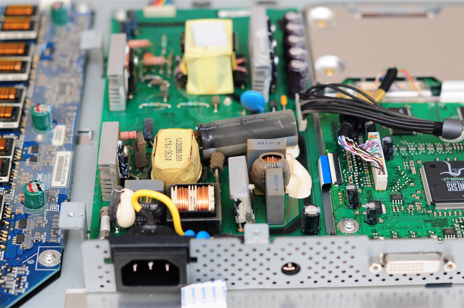

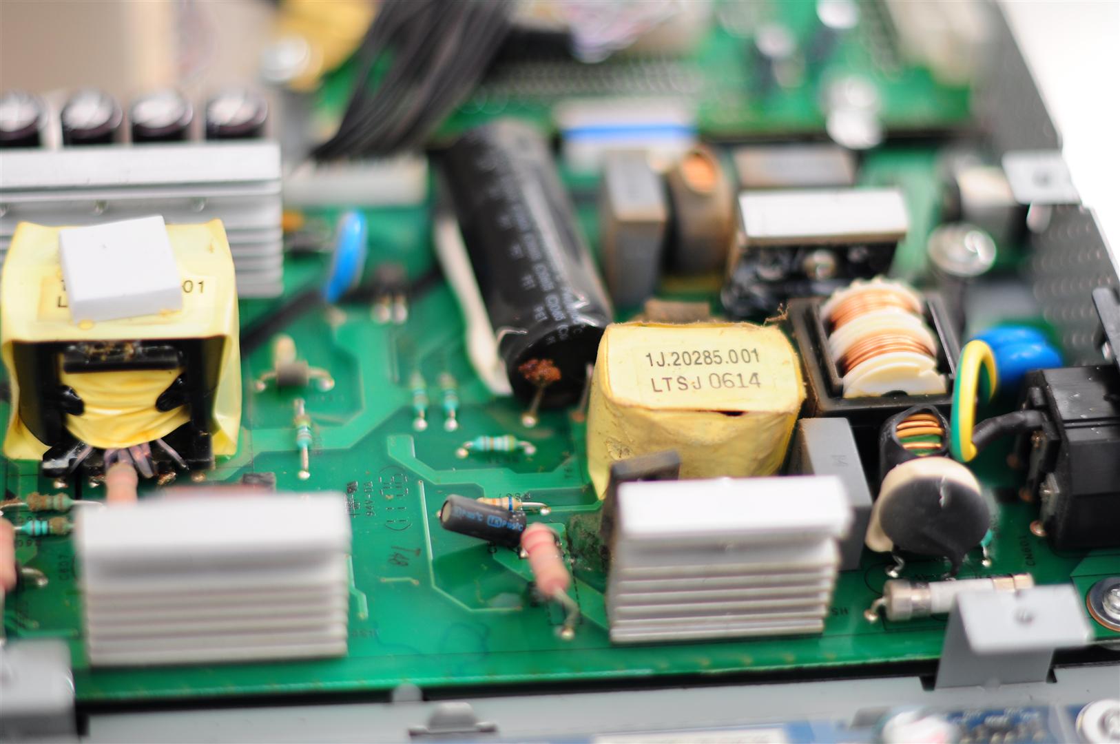

                          Hi there...
                          Since my WFP2407 stopped working yesterday and I have no service-tag (and the dealer I bought my display from is not doing anything regarding to PC-stuff anymore) I descided to open up my Display.
                          It was the F1 fuse that was broken (measured several M-Ohm inside the circuit over the fuse). So I searched through my boxes with stuff and found some old glass-fuses rated 2.5A. I did assume that the 2.0 on the fuse stands for 2.0A so 2.5A was close enough for me to test.
                          The Fuse with some wires soldered to it:
                          The replacement Fuse:
                          After the usual seconds of doubt I plugged in the device and got the DELL-Logo, it was alive again! Nice...
                          Since I cannot get my hands on a 2.0A SMD-Fuse currently I decided to just clean up the stuff I did a bit and repack my Display until I get a nicer fuse.
                          A bit nicer:
                          I think I will try to get my hands on
                          BOURNS - SF-1206S200-2 - FUSE, SMD, 1206, 2A
                          since the dimension fits, it is a slow fuse and rated 2.0A. But the minimum order value at Farnell (and resellers for private persons) keeps me off from testing it right now.
                          Maybe someone gets here via google (just like me) and gets motivated by the pictures
                          Regards

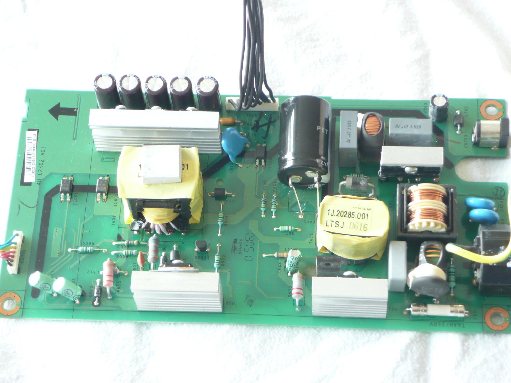

                            #73
                            Woah, you have lost me there cascade, that board doen't look the same as mine or the others posted here, you sure its a Dell 2407WFPb?
                            I am still waiting fo my replacement 450v 120uf cap to arrive but have noticed I too have a blown .22 ohm resistor as shown in this pic
                            https://www.badcaps.net/forum/attach...6&d=1305906535
                            the same resistor as psykosonik and discopig I guess (and therefore probably 'the wizard', you should check this resistor...)
                            Having a bit of trouble tracking down a resistor like this one, the only .22 ohm or '0R22' resistors available locally are big square blocky wire wound resistors. Is this one as pictured likely to be wirewound or carbon ? Does it matter? It is 11mm long and 4mm dia. Also what wattage do I require for the replacement?
                            I found a datasheet here:
                            https://cdn.badcaps-static.com/pdfs/...e724c6917a.pdf
                            and going by the dimensions on it the size that matches mine is 1W.
                            Still waiting to see that "my monitor is alive again" post. Suspect I am wasting my time and that there may be numerous ICs and other components on my (our) board(s) damaged.

                              #74
                              Well it didn't work for me either
                              Replaced the blown 450v cap, the .22ohm resistor and the 4a fuse and applied power, the monitor didn't come to life and the new fuse on the power board blew.
                              (I decided to only replace the one obviously blown capacitor for 2 reasons
                              1. Occams razor/if it aint broke don't fix it; 2. Others here have replaced all the caps and still had no success so it seemed like a waste of money/time)
                              Can anyone please advise what else on the board i should replace or test (inc how to test it, I'm a newbie).
                              The board model number is 4H.L2K02.A01 or altn number 5E.L2K02.001 made by BENQ. I cannot see any other damaged looking components or scorching on the board, including the ic on the underside of the board mentioned elsewhere. I have attached photos of both sides of the board. I read somewhere that when these large caps blow they often take out other components with them...

                                #75
                                Bad switcher MOSFET is where my money goes. From experience, when the mains caps go, they do take out the switchers.
                                The blown fuse and resistor are telltales.

                                  #76
                                  Thanks very much Toasty, that is just the kind of hint I needed to get me moving in the right direction. I take it the switcher MOSFET will be the one attached to (and obscured by) the heat sink next to the fuse on my pic.
                                  This seems especially logical because it is between the resistor that blew and the fuse that blew. I have tested it in situ and it has continuity between all combinations of D, G and S, which i take it indicates it is blown. I will pull it out and test it in isolation next.

                                        Same problem here, a completely dead 2407wfpb.
                                        I tried take some pictures of my powersupply, and I got thinking that there might be better to buy a new Dell, maby u2711 than try to fix this..
                                        I tried search for complete powersupplyes but all I could find was this repair kit:
                                        http://www.ebay.com/itm/Repair-Kit-D...ht_4154wt_1164
                                        But I don't know, my soldering skills isn't that good!
                                          Hi Guys
                                          I was not able to repair my power board. After replacing the Big Bad Cap, the burnt resistor, the fuse (many times) and the switching MOSFET (only to have it blow again straight away) I gave up.
                                          I sourced a replacement board through taobao, the chinese ebay, there are lots listed there under the board part number. I went through an english agent, taobaofocus.com. You pay them once and they bid and buy the item for you, then once they have received it in China you pay them a second payment for them to ship it internationally to you. Cost me about 50usd total including shipping to New Zealand.
                                          Monitor now up and good as new. I replaced the big cap with the new one I had bought for the repair which hopefully will be less likely to blow.
                                          Best of luck.
