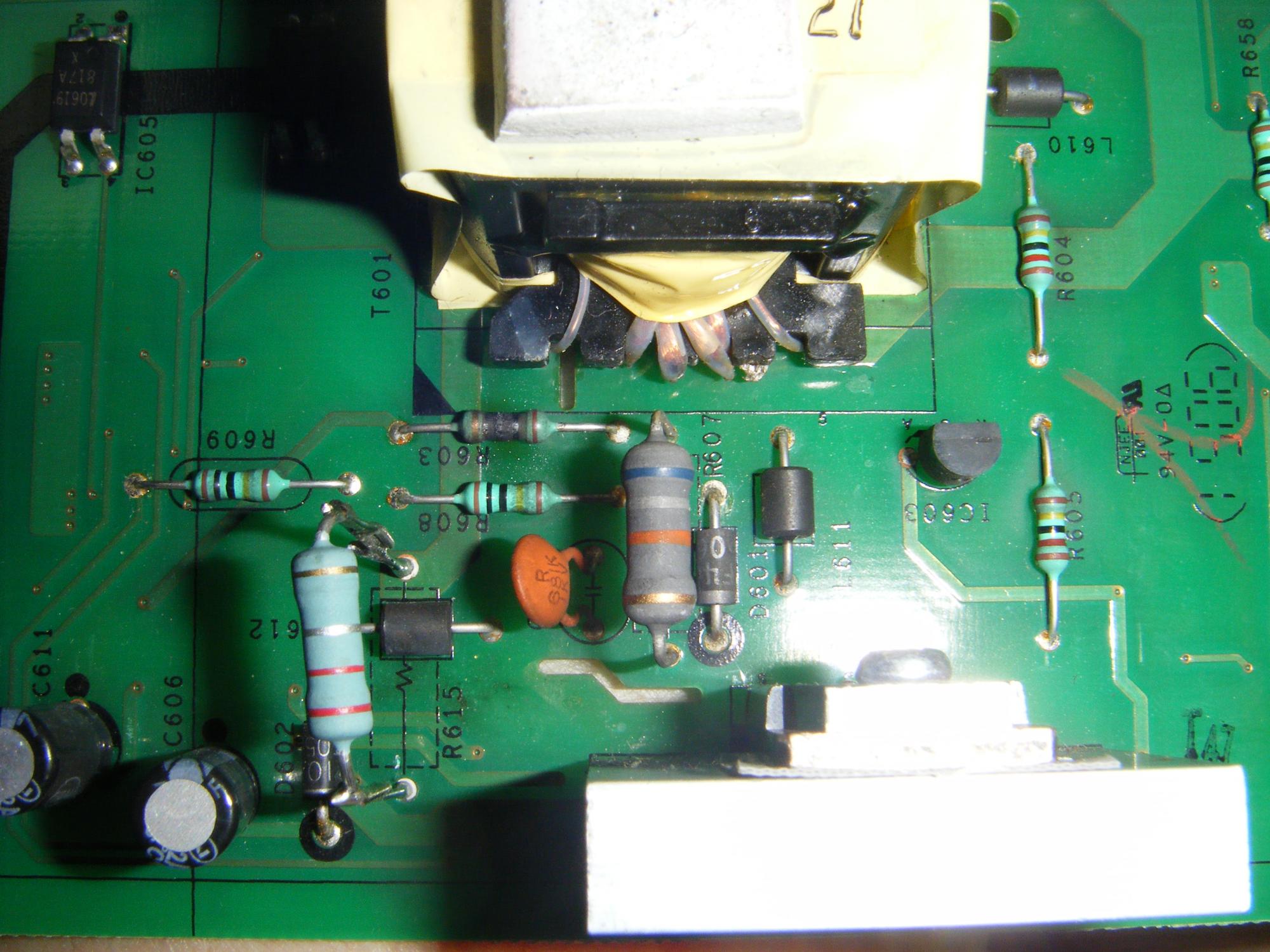

              referring to the other thread about this problem you think its the IC601 shown in this pic?
              this one looks factory new on my board... but nevertheless, if somebody could tell me, where i get one of these NCP1200A60-200A6 i´ll give it a try!

                The NCP1200A is available on eBay for under $6.00, including shipping. The L6561D is also available from the same seller, and at the same net cost.
                If the one on the board does in fact have a hole in the top, that would explain the fuse blowing. I STILL don't have a good handle on the operation of the PFC circuit, but looking at figure 7 of the datasheet, the FET is directly across the rectified mains voltage. When the resistor blew, the L6561D would take the hit.

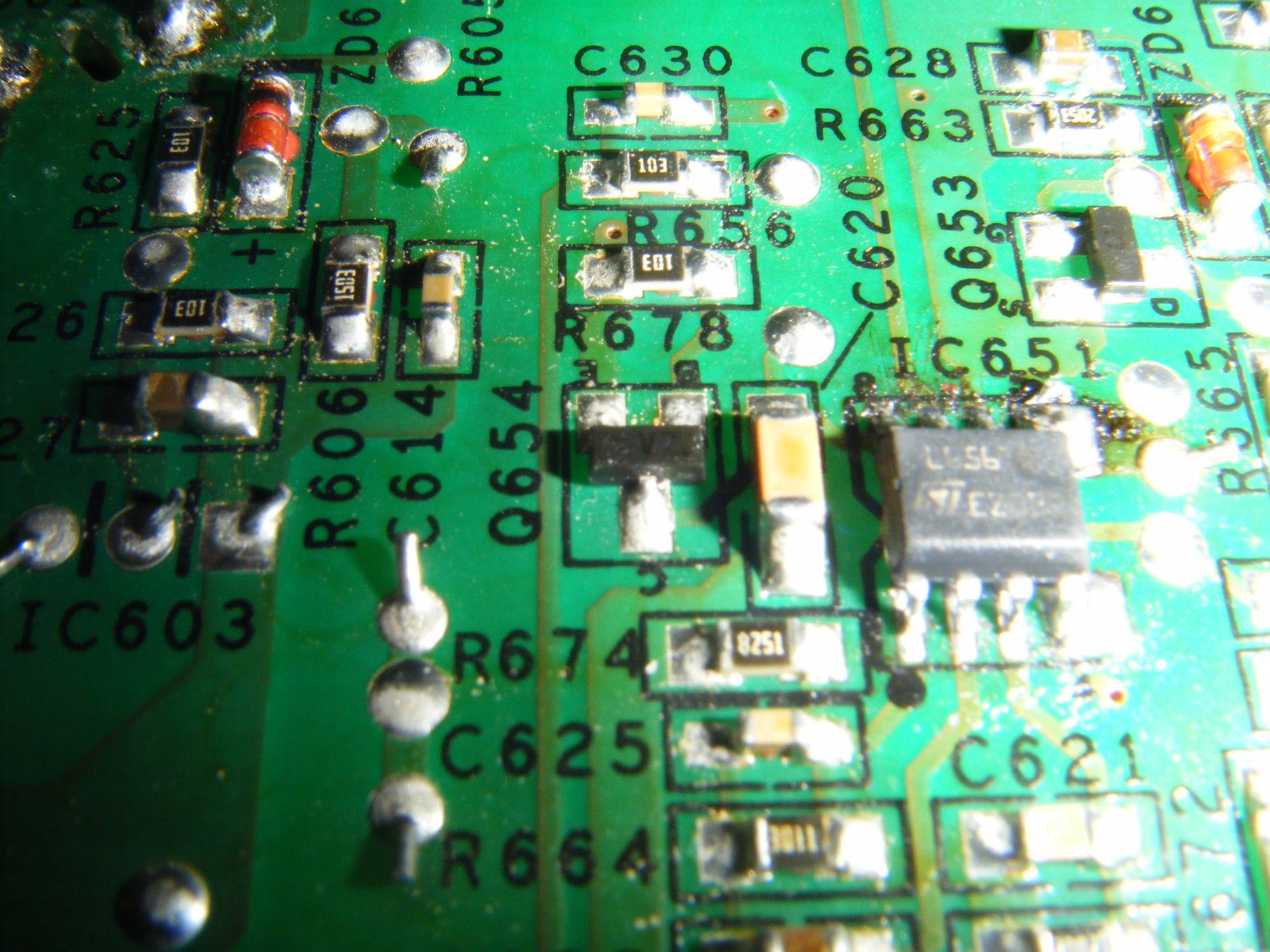

                        So back to square one. Upon measuring some of the diode, found out that Q654 pins C-B-E are all shorted to each other (0 ohms). Pin C is tied to a capacitor linking to the Pin 8 (VCC) of the L6565D. But i am not sure what type of diode it is..
                        What i can see on the top of the Q654 is marked ZA with a 16 or 9L at the side (not really sure though). Package width is approx 3mm. Pictures attached
                        Any thoughts what it is?..

                          ZA crosses to a diode. 2A is a 3906 equivalent PNP transistor. Information is here (follow the Marking SMD link).

                            yep, same here. And the "big" Cap next to it (C620) is also toast.
                                PlainBill
                                Thanks PlainBill!. Splendid website!!.. I wish i could say the same for my current repair though.
                                Update. Replaced the shorted SOT23 diode with a MMBT3906 (PDF attached). No joy! I measured 330V across the Big cap. But NO voltage output to the other card (Logic or inverter). I will TRY to flip over & measure voltages on the NCP1200D & L6565D (PDFs attached). If anybody could point out which particular pins on them i should be focusing on, that would be great!.
                                Tyan, may i know how do you tell it is toast? Visually, I can't see anything wrong with it. But i do not have a capacitance measurement to measure it though.
                                      ummm, it has nearly 0 resistance. But meanwhile i´ve read endors post and had to learn that this doesn´t have to mean it´s dead. It also can be, that there´s a short between the connected parts... so i have to admit: my statement may be wrong.

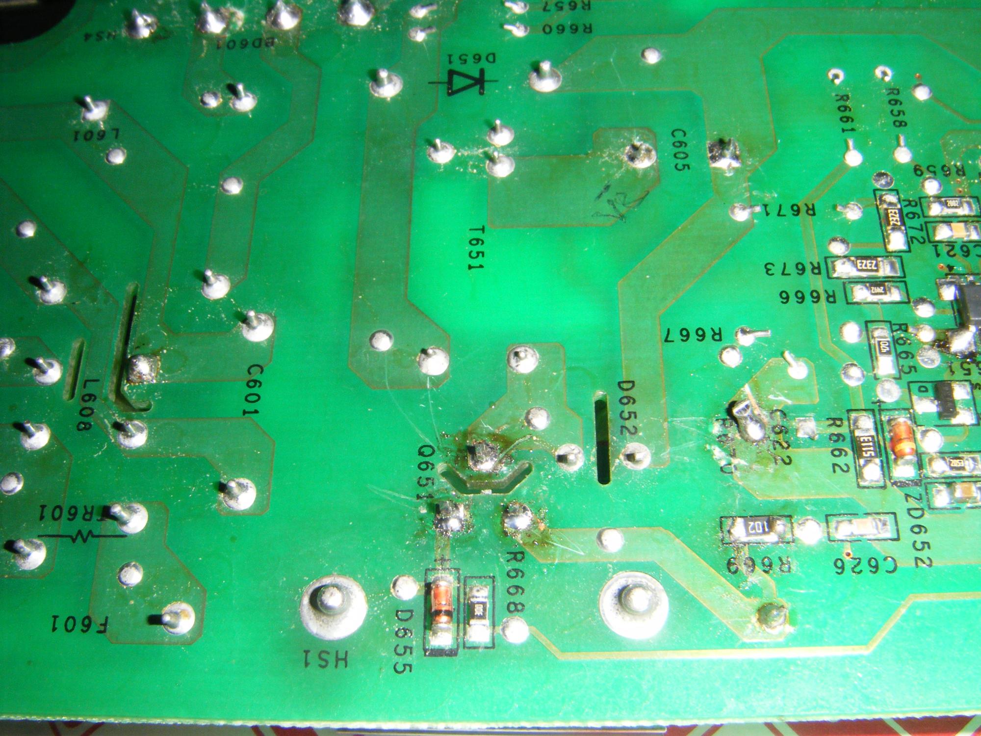

                                        I measured 326V on Pin 2 (DRAIN) of Q651 with respect to Gnd. But got 0V on both the Pin 1 (Gate) & Pin 3 (SOURCE). The I move the probes to measure voltage between Pin 1 (Gate) & Pin 3 (SOURCE), which is VGS. A SPARK, small FIRE & MAGIC SMOKE coming from Pin 8 (HV) of NCP1200!. Also MAGIC SMOKE coming from the other side near T601!!. I quickly unplugged the main Power. When I flipped the board over R603, linking to Pin 8 (HV) of NCP1200 is visibly burnt. So, again, I need the help from you guys.
                                        1) Could someone, with the same board, identify R603 so i could replace it? I think NCP1200 will be needed to be replaced as well, right? Sigh!
                                        2) Did measuring VGS of Q651 a WISE thing to do? Will it caused the SMOKE, FIRE & BURNT? or is there something else which i missed out?
