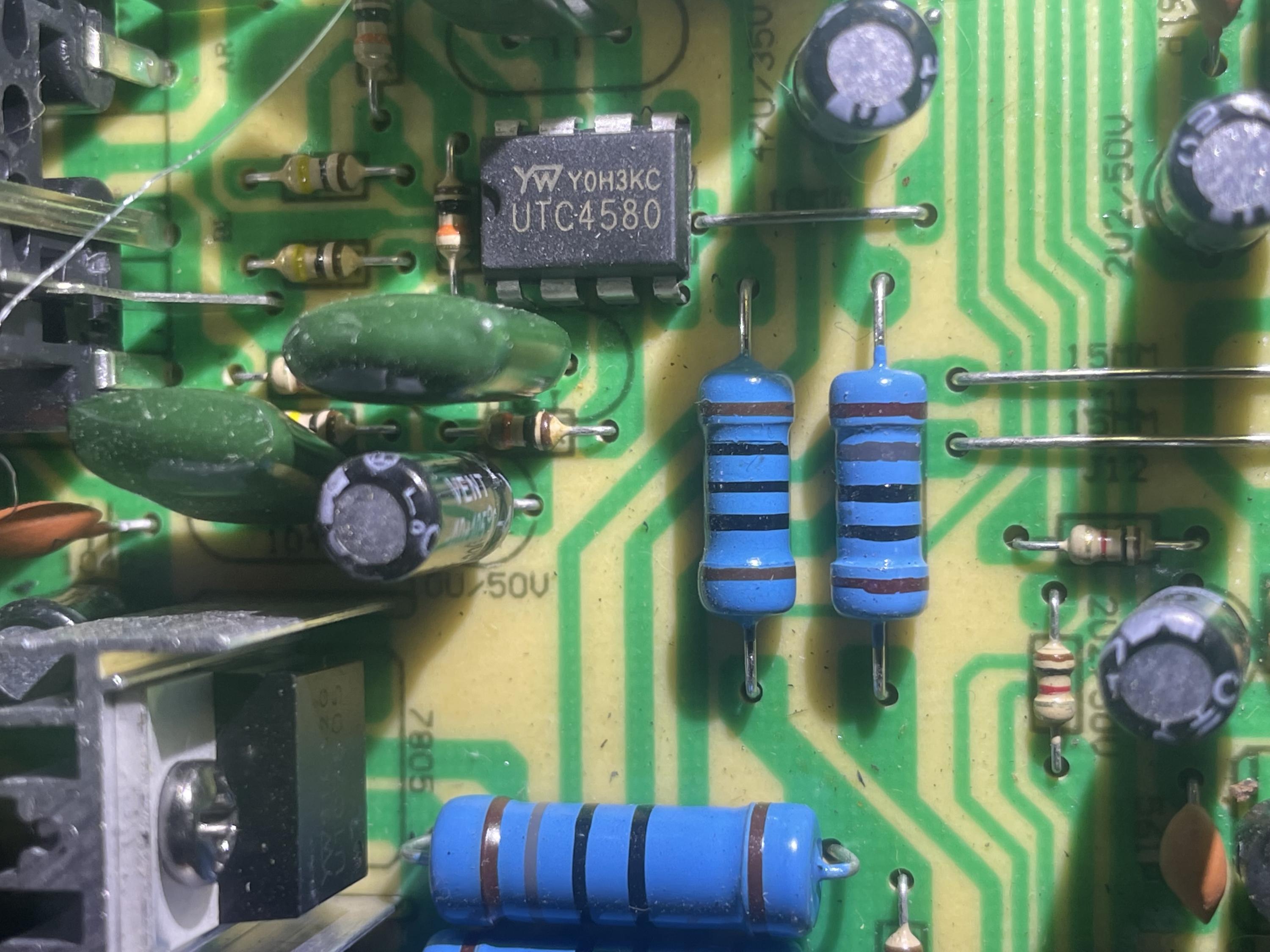

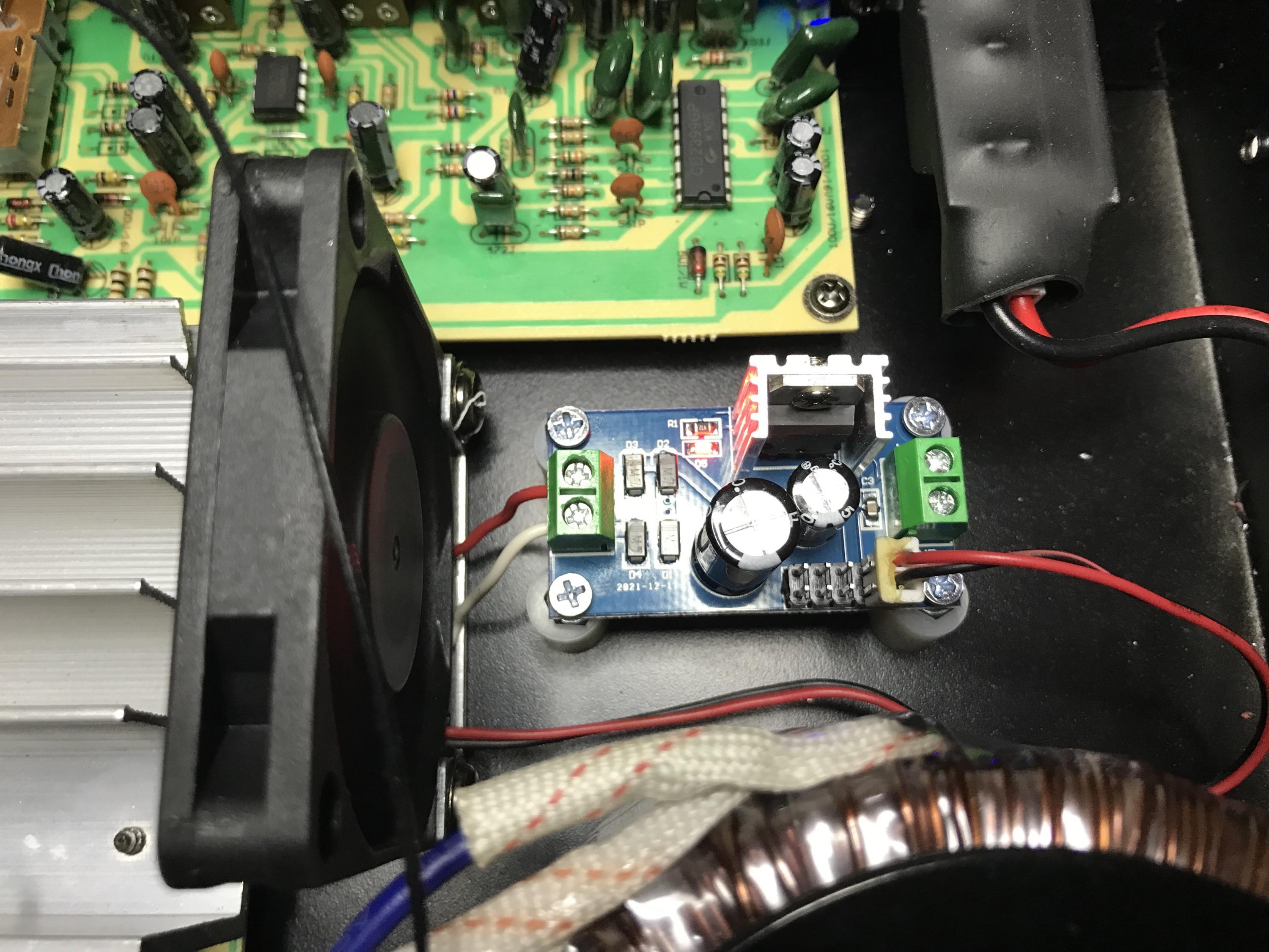

    OK, I soldered the 2W resistor in. With chips A-E & the power LED connected (F, G, and the CD IC disconnected), I read 6.23v across it.
    I soldered back in the resistors to connect up chips F & G. With chips A-G & the power LED connected (CD IC disconnected) I read 7.66v across it. The VCC+ of chip F & G were around 5v each (A-E are ~10v)
    I soldered back on the resistors and all the other components connecting the CD IC to the board, and read 11.70v across the new resistor. I took out my thermometer and the temp seems to stabilize at 137F-139F degrees. Certainly to hot to touch for more than a second, but I saw no white smoke and no burning resistor smell.
    Now here is where I earn my idiot reward. I was checking the fan, and I disconnected it to the board and connected the ends to a 9v battery, and it spun. So I thought maybe somehting is wrong with the board not turning it on, how about I just wire it right to the main power supply going into the unit? Nothing bad could happen by dumping 120 AC into a small 12v DC fan, could it?
    So yeah, now I need a new fan. And annoyingly its a 60mm fan and all I have on hand are 80mm fans, and even more annoyingly the unit is like 75mm tall so I can't fit an 80 in there as a replacement. Sigh
    So I'm ordering a new 60mm fan, I don't want to run the unit for a long time without the cooling fan attached, so while it's back together I have not extensively tested it yet. When I get the new fan in and run it through it's paces I will let you know what happens.

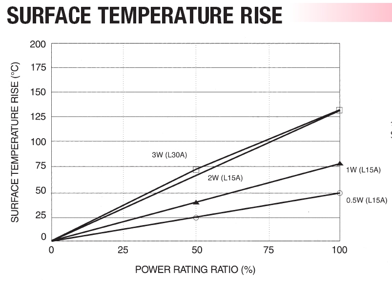

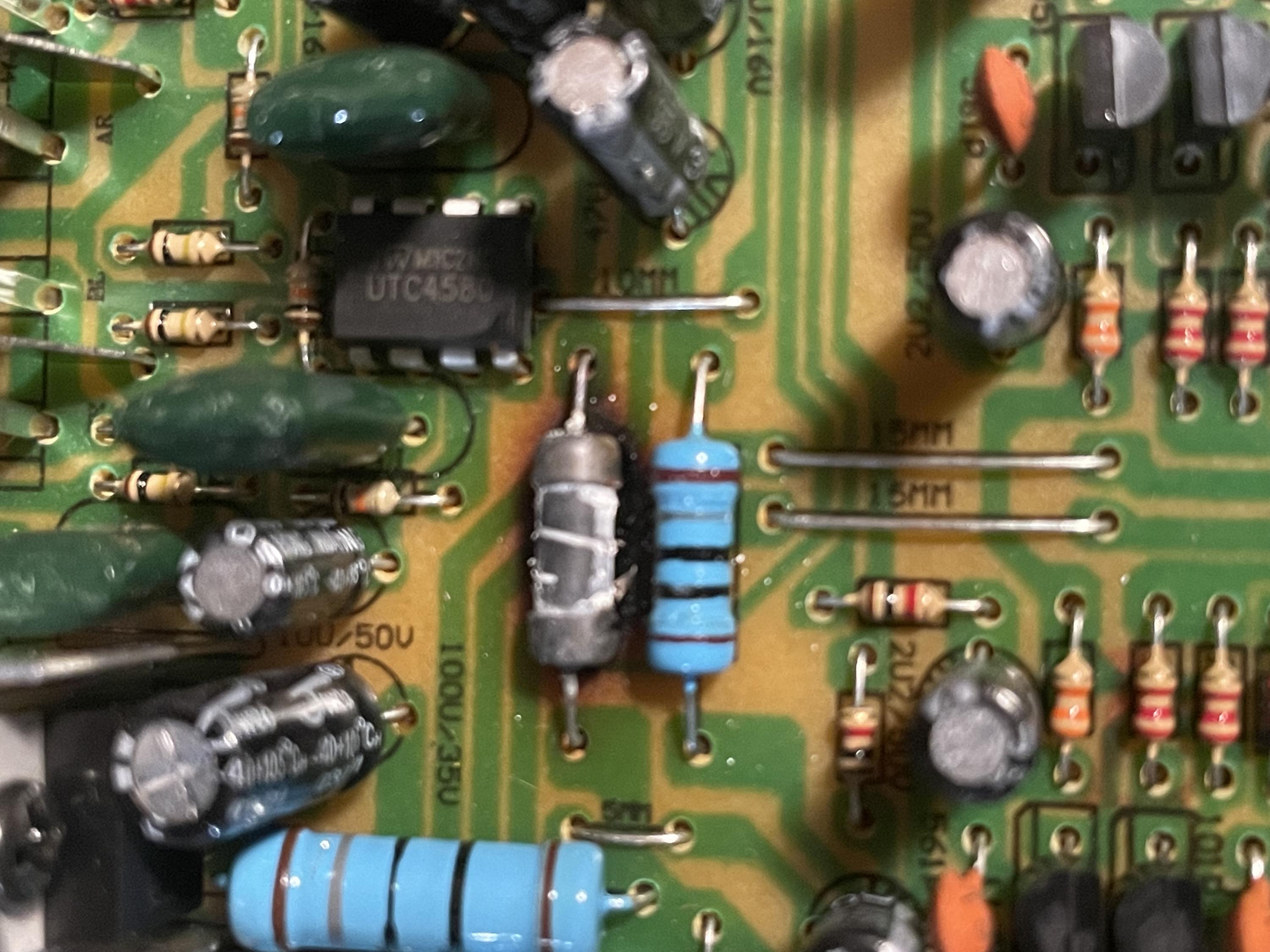

      So those Voltages are for the 180 Ohms 2W for the V+ only? No change in the reading for the 180 Ohms for the V-, correct?
      "I took out my thermometer and the temp seems to stabilize at 137F-139F degrees."
      So if room temp is 70F then temp rise is 69F (about 20c rise), so that is way below the handling spec of two Watts resistor.
      According to the chart for 2W with power dissipation of 0.76W (11.70V on 180 Ohms, 37.50 % of power rating ratio), the temp rise is expected to be
      50c (122F), so the resistor is cooler than expected since temp rise is only 69F.. less rise than using 1W dissipating 0.76W.
        Yes. I didn't check voltage on the V- cause I didn't add anything back onto it.
        The room was about 64 degree that I was working in. So about a 76F rise. But that's still less than 122F. I also mounted the resistor about as far above the board as the legs would lift it.

          "But that's still less than 122F" Do you want to see 122F temp rise instead?
          Well, it is good that the measured temp rise is not 122F, if it is then the resistor will be 191F!, the lower the measured temp rise you see the better.

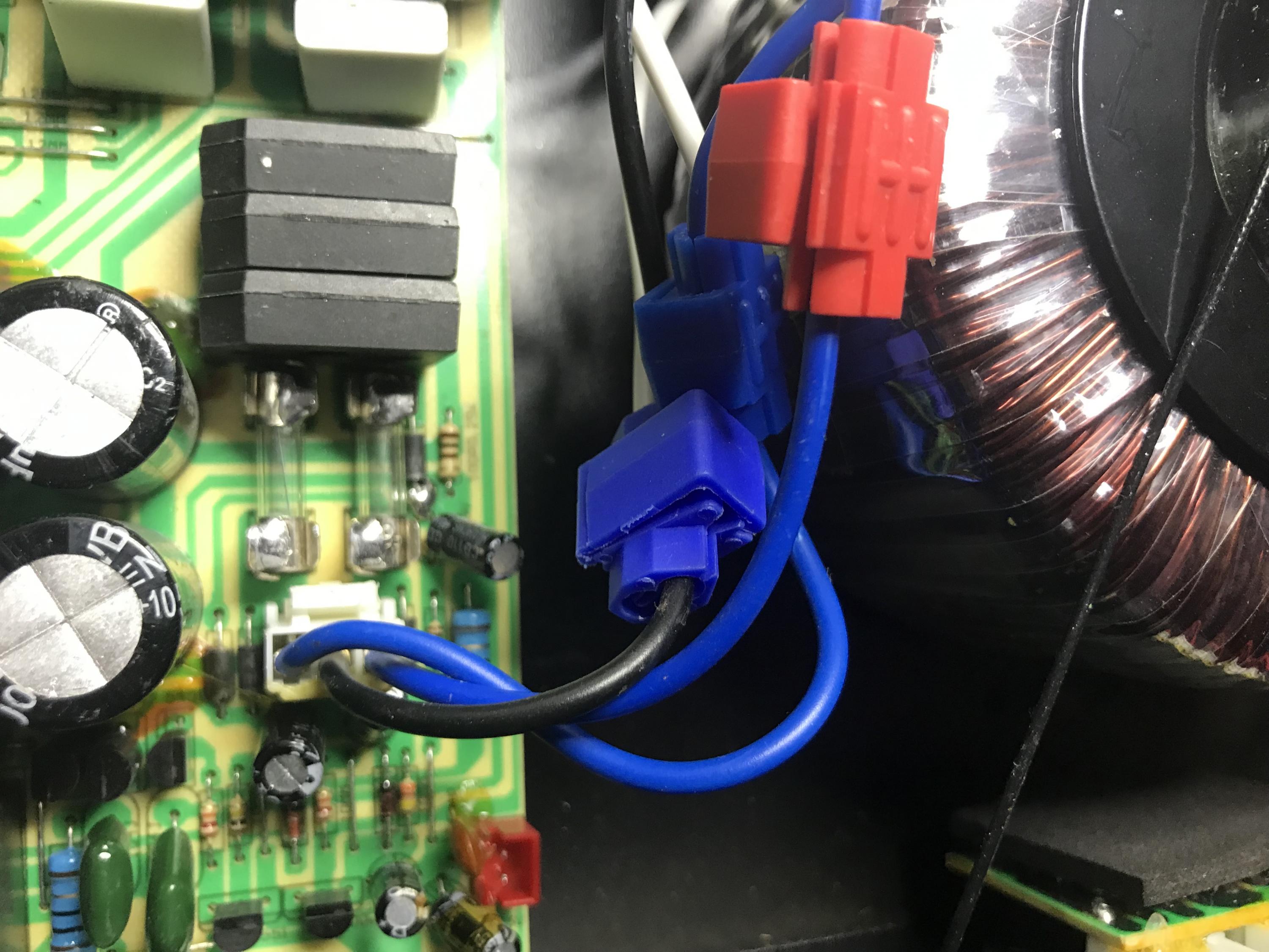

                  Final update: I installed the new fan, plugged in a speaker, connected to my phone's Bluetooth, and played about 30 minutes of music. I kept the thermal probe resting on the new 2W resistor and it held steady at 137-139F the whole time. I reassembled the unit, gave it one last test run, and I'm calling it fixed. It goes back to the owner on Sat.
                  Again huge huge huge thanks to budm for all the help, I've learned a ton and had a blast! Here's to the next one!

                        I tried following this as best as I could and I am probably missing something.
                        I have a unit that has the exact same issue with that resistor burned up. Does anyone happen to remember what was the cause?
                          #132
                          Re: Help diagnosing Pyle Receiver PTA66BT with burned resistors
                          It is due to failed Voltage transistors, read post 41 and lots after that.

                            Thank you budm, I replaced all of the blown transistors and also upgraded the Resistors to 3 watt. The unit is working great now. Your input was most helpful.

                                    Have repaired about 4 burnt resistors units. None have had fans running. Bought new unopened 66bt.It's fans not running. Traced 12v+ line of fan back to 47ohm-66ohm b647 have 32 Vdc on emitter and base and nothing on collector which appears to feed the 12vdc to the fan?
                                    Any suggestions?
                                    • dragonmas
                                      • May 2018
                                      • 9

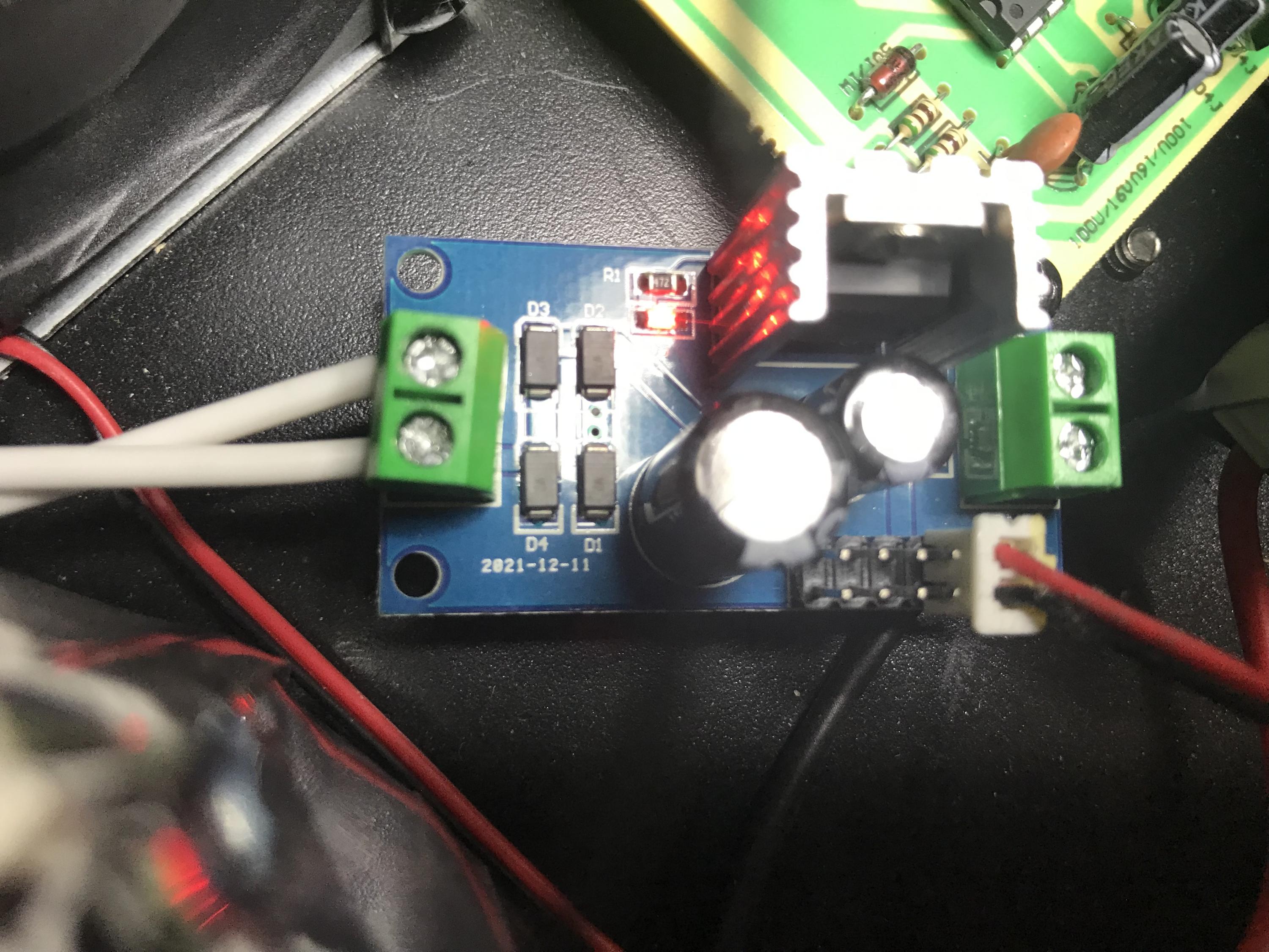

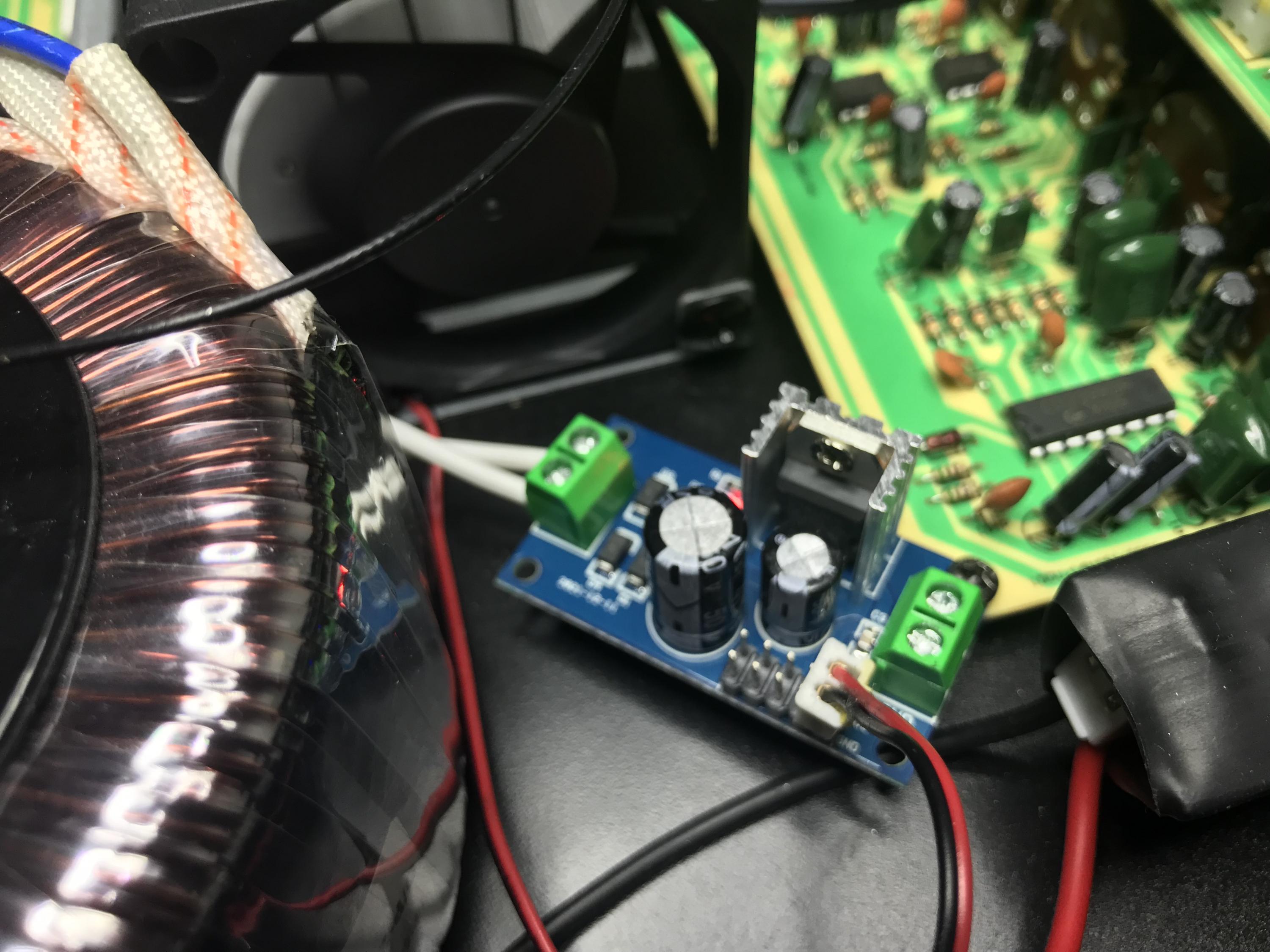

                                      #138
                                      My $3.50 fix for non-operational fan.

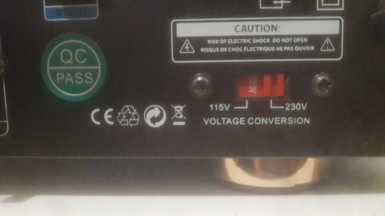

                                          #140
                                          Originally posted by Flacooo1
                                          Hi everyone and thanks for those that are helping on this tread I Know is kind of old now, I have some help not the real fix just some help, the burned resistor is NOT 180ohm I have 3 units 2 pta66bt one brand new and one burnt that i purchase off ebay for $25 and one brand new pta44bt that stopped working but with warranty, so I sended the pta44bt to pyle and they in fact fixed I don't want to open the unit and see what they did to it but i can confirm they put a bigger resistor same ohm but 2w and it looks like the 3 caps next to it are bigger in size I don't have pictures of that one from inside since I did not opened but i do have pictures from the pta66bt new unit and burnt unit, on the burn unit i put a 2w 100ohm resistor and it did smoke as well so next is to check transistors and see if i can upsize the caps
                                          Hi, i have the same problem. I found that is you move to switch to 220V instead of 110V and connect to 110V, the system work great. I don't know how it's work, but it's working great.
