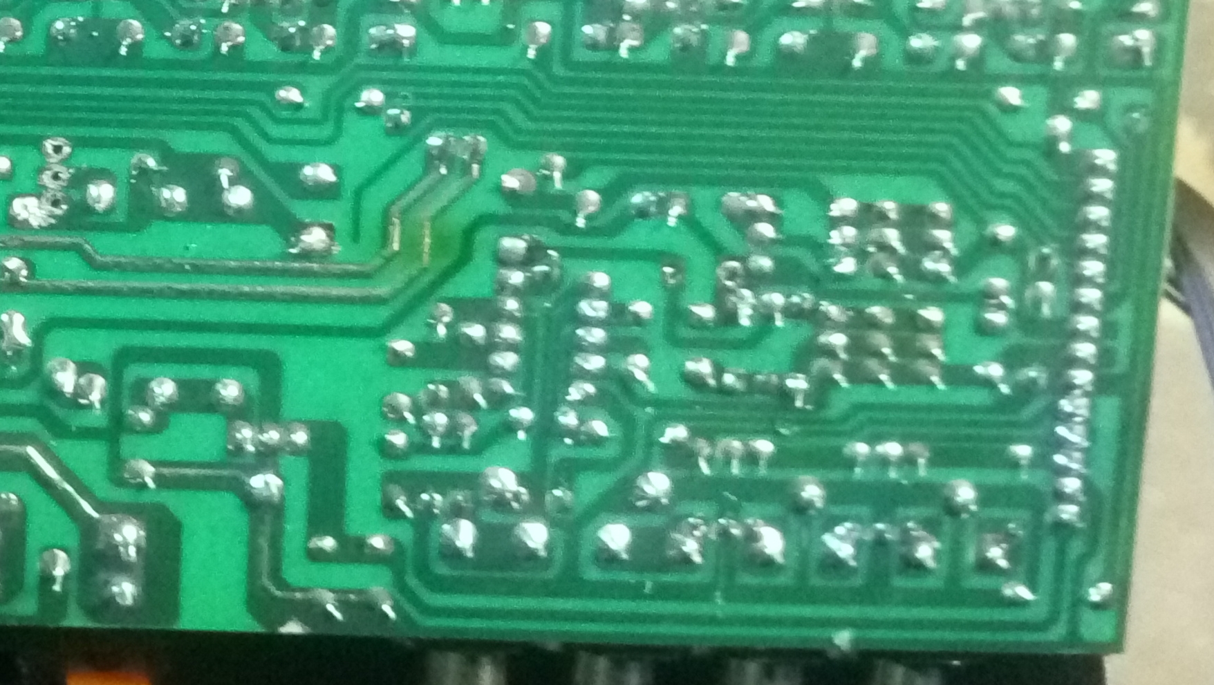

My buddy has an audio receiver that stopped worked, everything turns on and functions but no sound comes out of any output (Speaker, AV, or Headphone) So I said I would take a look at it. I popped the cover off, and saw an obvious issue: One of the resistors on the board had burned up.
Photos:
Now I'm still learning but I know you need the color bands on the resistor to see what the resistance is, but the wrapping is burned off the resistor. The good resistor next to it is Brown-Silver-Brown which if I understand the mapping correctly would indicate a 180 Ohm resistor. So I bought myself a resistor pack off Amazon, and it showed up today. Unfortunately I didn't realize different resistors sizes exist and bought 1/4 watt resistors for what looks like a 1W resistor
. But I popped a 180 ohm resistor in just to see what would happen, and predictably it smoked and burned up. I have ordered a set of 1W resistors that will be here in a few days.
I googled how to find the value of a burned resistor, and a PDF told me to measure from the leads to the end of the spiral grooves on the resistor, and doing that gave a value of 35 megaohms, I checked both directions and it read the same both sways. I don't think that's right.
I checked the big blueish resistors by the burned one, they all tested fine.
I followed the trace from the resistor back to the big caps over to the left on the photo, and saw it did connect to one of them. I unsoldered that from the board, and tried testing it a bit and it seemed to be OK. Just to check, I unsoldered another one of the big caps, and it tested identically, so I assume that would make it likely they were good.
I then followed the trace to the right, and removed the first capacitor that I came to. It was 45 mF at 35V, my capacitor pack had a bunch of 45mF caps but not 35V, so I put in a 50V since the internet told me it was OK. Flipped everything back on, still got a burning resistor.
I did try and test the zener diodes over to the right but I'm not sure if they are right. When I got negative terminal to the black lead and positive terminal to the red lead, i get an OL, when I switch the leads, I get readings, but I thought the opposite should happen?
I've gone over the board can't find anything else that looks faulty, none of the caps are bulging or leaked, the fuses all test fine, connections are all solid. Just shooting in the dark at this point and look for advice.
