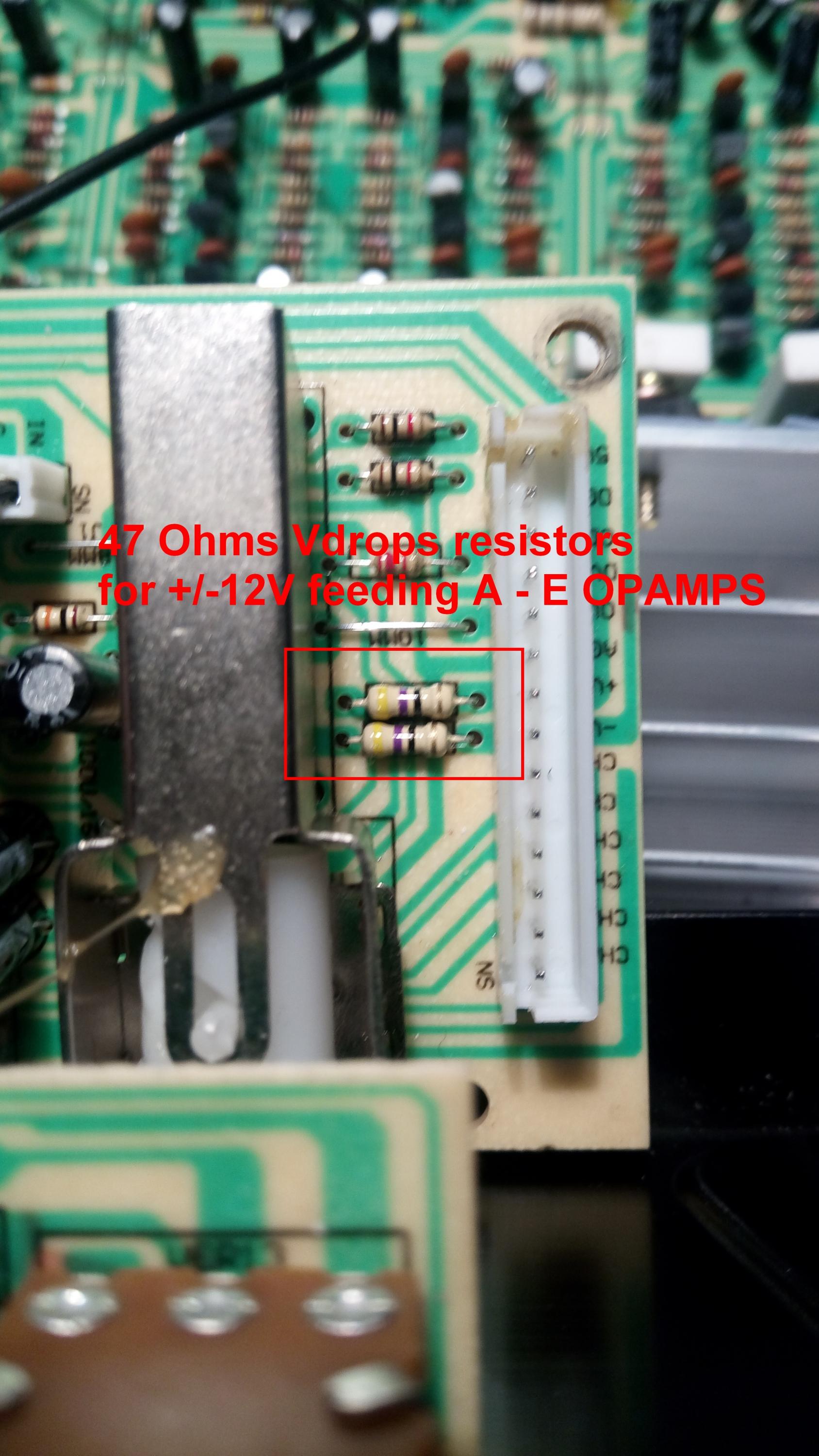

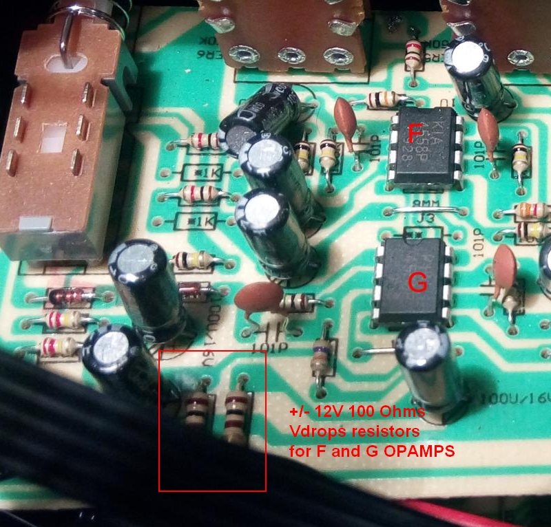

2) Lift one end of each 47 Ohms resistors that feed +/- 12V to OPAMP A ~ E, this will isolate the OPAMP A ~ E from +/- 12V power supply, so the only loads we have will be OPAMP F ~ G, CD IC, and LED indicator lights. See picture attached.
