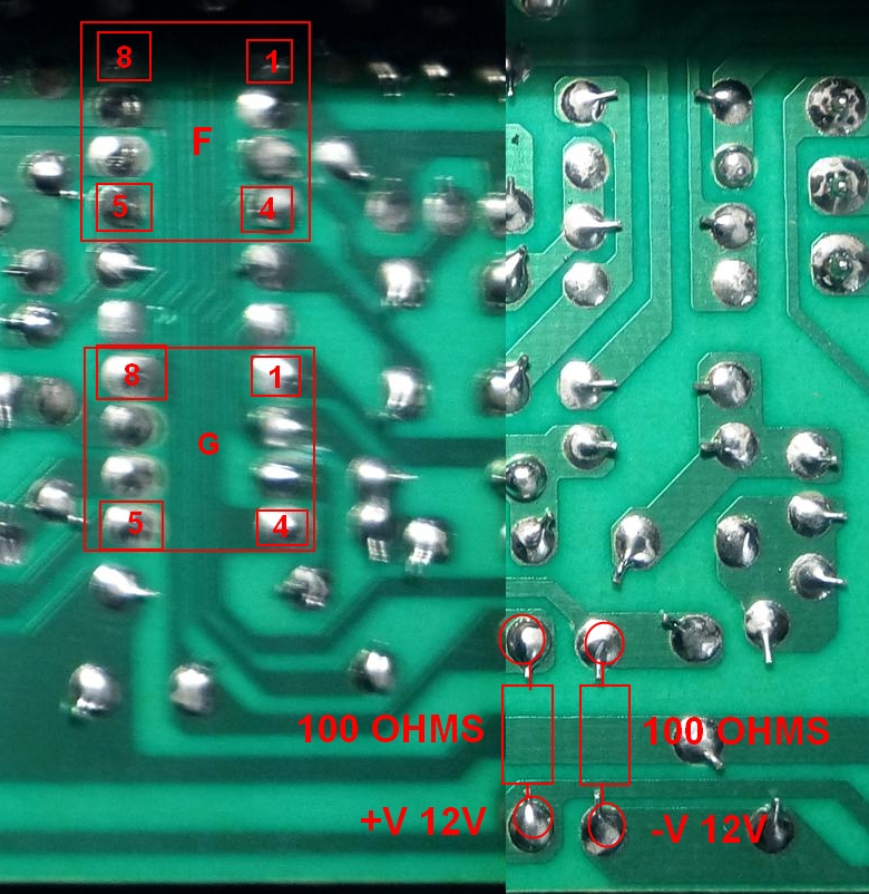

                      #70
                      Re: Help diagnosing Pyle Receiver PTA66BT with burned resistors
                      Post #69
                      Resistance measurement of -VCC pin 4 of OPAMP 'F' and 'G' readings against Ground:
                      Chip E - 4.71 kilo ohms.
                      Chip F - 12.41 kilo ohms. This was a steady reading, no slow climb.
                      Chip G - 94.7 kilo ohms. This was a steady reading, no slow climb
                      This must be measurement error since Pin 4 of Chip F is connected directly to pin 4 of Chip G, the readings of both chips should be the same.
                      See the picture of the bottom side of the board where OPAMP IC 'F' and IC 'G' pin 4 are directly connected together, so the reading of pin 4 of IC 'F' and IC 'G' should be about the same as IC 'E' pin 4.
                      Please recheck your measurement.

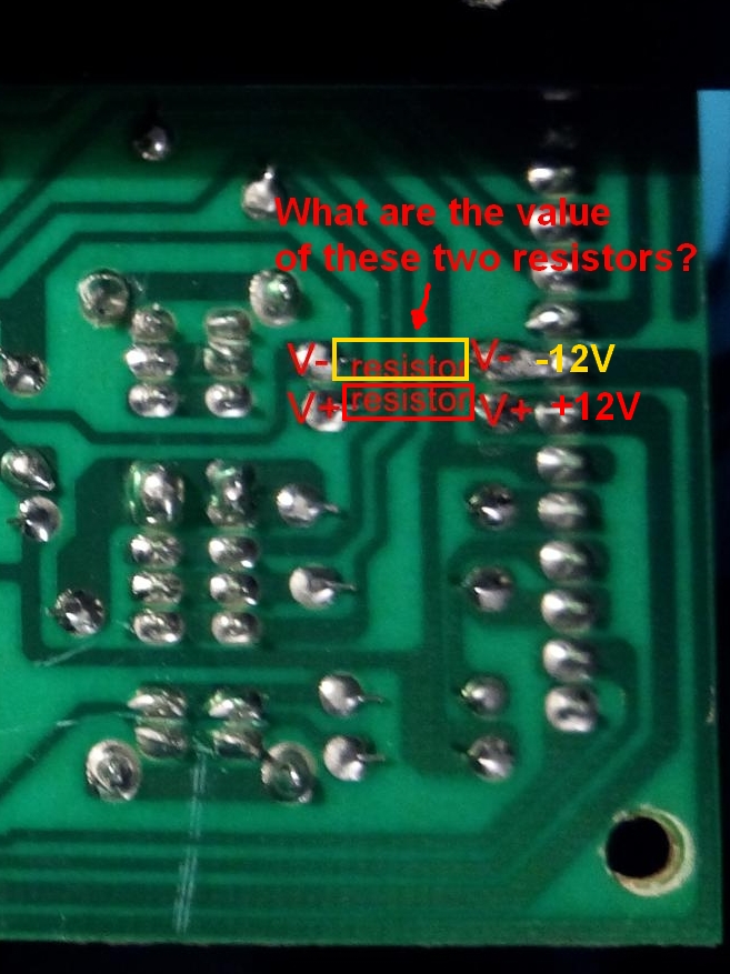

                        #71
                        What are the values of these two resistors? I cannot see them in the picture of the full front board.

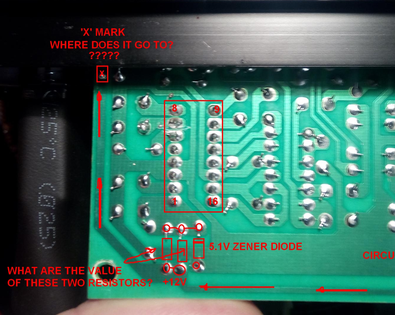

                          #72
                          Where does the 'X' go to as marked in the picture attached?
                          What are the value of the two resistors in the picture attached?

                              #74
                              As you can see, you have:
                              1) A set of resistors (waiting for the values in post #71) for feeding +12V and -12V to OPAMP A ~ E.
                              2 A second set of resistors (100 Ohms as shown in post #70) for feeding the +12V and -12V to OPAMP F and G.
                              3) A set of resistors (unknown value in post #72) connected in parallel fed by +12v to feed 5.1V Zener to run IC CD2399G.
                              4) We have unknown point 'X' (see post #72) which is also fed by +12V. You also need to see if the trace goes beyond point 'X' that I marked.
                              So as you can see the +12V regulator feeds more circuits than the -12V with those extra two loads described in step 3 & 4, that is why they use 3 Transistors in the +12V regulator circuit to handle more loads than the -12V.
                              In my post #66 I talk about isolating the circuits, as you can see we can easily isolate each set of OPAMP's (A ~ E, F ~ G) from +12V and -12V by lifting the set of resistors, isolating the CD2399G by lifting the two resistors (connected in parallel) feeding the 5.1V Zener, Isolated the connection at the 'X' can be by disconnect what ever connected to 'X' and the trace beyond 'X'.

                                See the picture of the bottom side of the board where OPAMP IC 'F' and IC 'G' pin 4 are directly connected together, so the reading of pin 4 of IC 'F' and IC 'G' should be about the same as IC 'E' pin 4. Please recheck your measurement.
                                I rechecked the measurement and here is what I got. For both F and G, with my meter on Ohm's, when I put the black probe to Ground, and the red probe on the pin 4, I got OL. When I switched the probes and put the red lead on ground and the black lead on pin 4, I got a lot of movement of the numbers, but eventually F settled on 98 kilo ohms and G settled on 97.7 kilo ohms.
                                The resistor fed from V- read 47.1 ohms, the resistor fed from V+ read 46.7 ohms.
                                Here is a better picture of the top of that part of the board.
                                Here is a better picture of the bottom of that part of the board.
                                X is one leg of a resistor. The other leg connects to a wire, and that wire leads to the Power On Indicator LED on the front panel. Here are pictures with notes
                                Closer shot of the underside of that part of the board with X, I marked the resistor and the wire going to the LED
                                Top of that section of the board with X and the LED marked
                                Both of those resistores measured 0.245 kilo ohms. Here is a shot of the top section of that board showing the resistors and the zener

                                  #76
                                  OK, thank you for all the info provide.
                                  1) Leave the front board unconnected, then power up the unit and then put the meter probe on each end of the 180 Ohms for the +12V to see what the Voltage drops on that resistor is, the do the same on the 180 Ohms resistor for -12V.
                                  Then we can calculate the current flow through each one of those two 180 Ohms resistors to establish the base line of current flowing through the resistors when no load (Front board) connected. Please make sure that the readings are repeat able.
                                  2) Please check the resistance in both directions of 5.1V Zener diode that is connected to pin 1 of CD IC.
                                  3) What is the resistance value of that resistor that is connected to the LED?

                                          #80
                                          I put my multimeter to DC Volts for this measurement.
                                          Across the resistor on the V+ rail, I got 2.02V
                                          Across the resistor on the V- rail, I got 2.03V
                                          Black probe on the marked side, Red probe on the unmarked side: 7.56 kilo ohms
                                          Red probe on the marked side, Black probe on the unmarked side: 8.9 kilo ohms.
                                          9.8 kilo ohms
