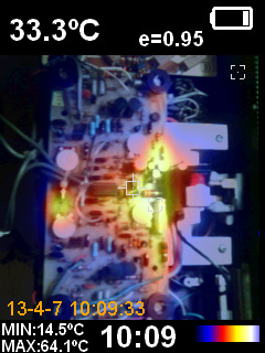

                              Passed the "bulb test" this morning. Then powered up with nothing plugged in and left idling (1/2 hour) to see if anything tipped over. Nothing happened, rails check out. Plugged in preamp and cd player, and now have "clean" sound from both channels. Will let it run at low to medium level for a while and check some areas. Also as a test, I will run at a bit higher level and check things with a thermal imager to see if possibly there is an issue therein (ie. the replacements are running hotter than expected or whatever). I am reluctant to do much more... ie switching input, pushing volume, etc at this point. Hopefully, joy will return and stay a while. :-)
                              • budwich
                                • Jul 2015
                                • 3097
                                #95
                                Re: Crown Amp DC300A - One channel distirted, other good.
                                Its still running at medium volume. Attached is a thermal shot of the control board. There was not much happening at the output boards so I didn't include those. The control board seems to get pretty "toasty" although I don't know what it should be and whether this is contributing to any subsequent failure there and elsewhere.

                                  #96
                                  just a thought regarding outputs sharing current you could measure voltage across each output transistor emitter resistor .this will maybe be a bit out though because of resistor resistance tolerance .
