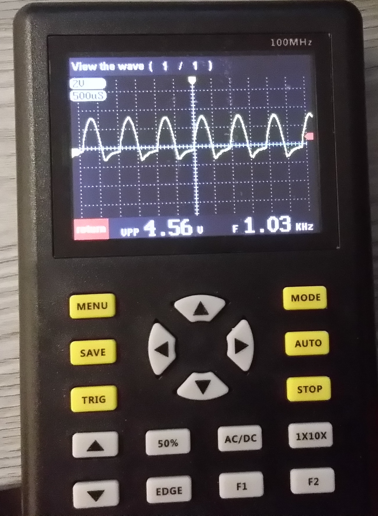

          Re: Crown Amp DC300A - One channel distirted, other good.
          thanks for this.... not sure about the "dc offsets" measurement but certainly can measure and calculate the resulting current.
          I will add some new stuff. While I was waiting for parts and such, I gathered my "pennies" and picked up a small handheld one channel scope. First use. :-)
          Attached is a picture of the display from the bad channel. The good channel (not posted) shows a "normal sine wave" while the bad channel appears to have lost most of the bottom half. :-( This was at the speaker output. I have not gone further to see where things went bad as the last time I did further "checks" with a meter on the good side, I wasn't careful and took out that channel completely so I am "trigger shy" at this point.

              #46
              offsets are acceptable .
              does the amp have trimmers for idle current ?
              the scope trace looks like there is a problem with the negative current . check output transistors collector voltage first .then base voltages that should be about 600mv

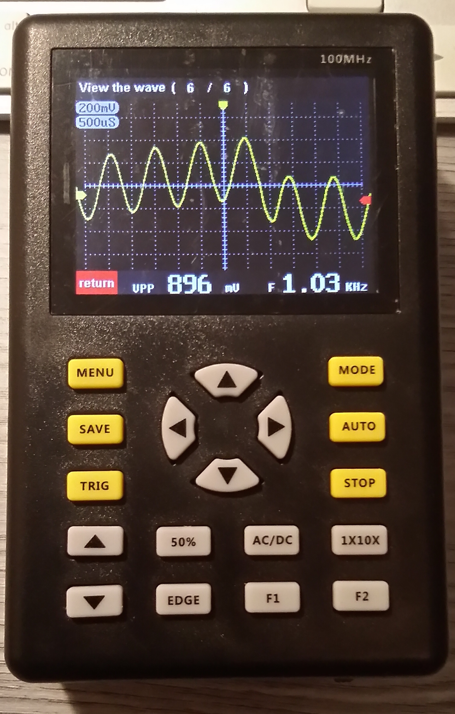

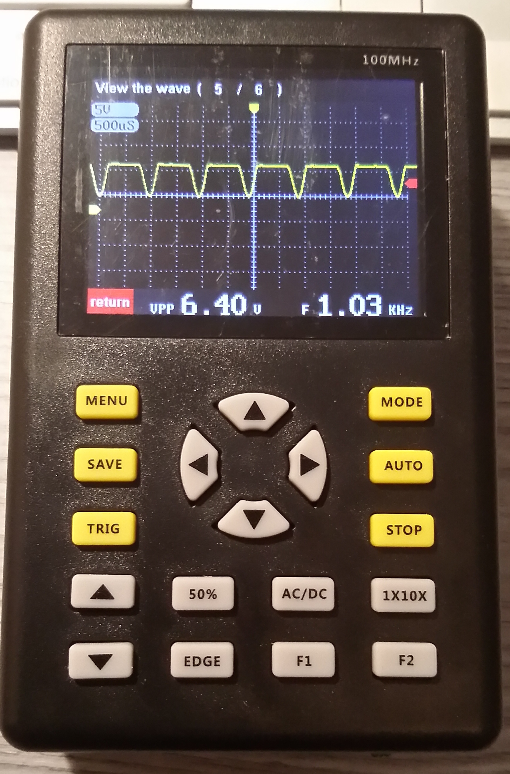

                              #54
                              I took a closer look at the board layout versus the schematic as the main board has no labeling so transposing where / what component is where is somewhat difficult outside of obvious main components... plus my eyes ain't so good... :-)
                              Anyway, I think I located the points... just after the output of the op amps towards a first transistor (base pin). The "outs" are on pin 13 and 1 of the "dual op ic".
                              Attached is scope shots from each channel.... 1khz feed into the amp.
                              The first is the "good" channel. This shows a reasonably good wave form. Although not shown, the wave form is "superimposed" on top of a 60hz wave form... not sure why or what... maybe some form of hum / grounding issue. The "60 cycle" does not appear in a scope look at the speaker output jacks.
                              The second picture is the waveform come out for the bad channel. Not sure what to make of it other than the frequency is correct but the wave form is "unrecognizeable". The voltage value seems rather high almost like some form of both dc offset plus just plain large signal. I don't believe that the channel gain pot was turned up that high but I need to check.
                              It would appear that perhaps my channel distortion may originate in and around the op amp ic (and supporting circuits) as opposed to the output transistor boards... maybe?

                                  #56
                                  waveform looks like positive dc on bad one .it should be ac .
