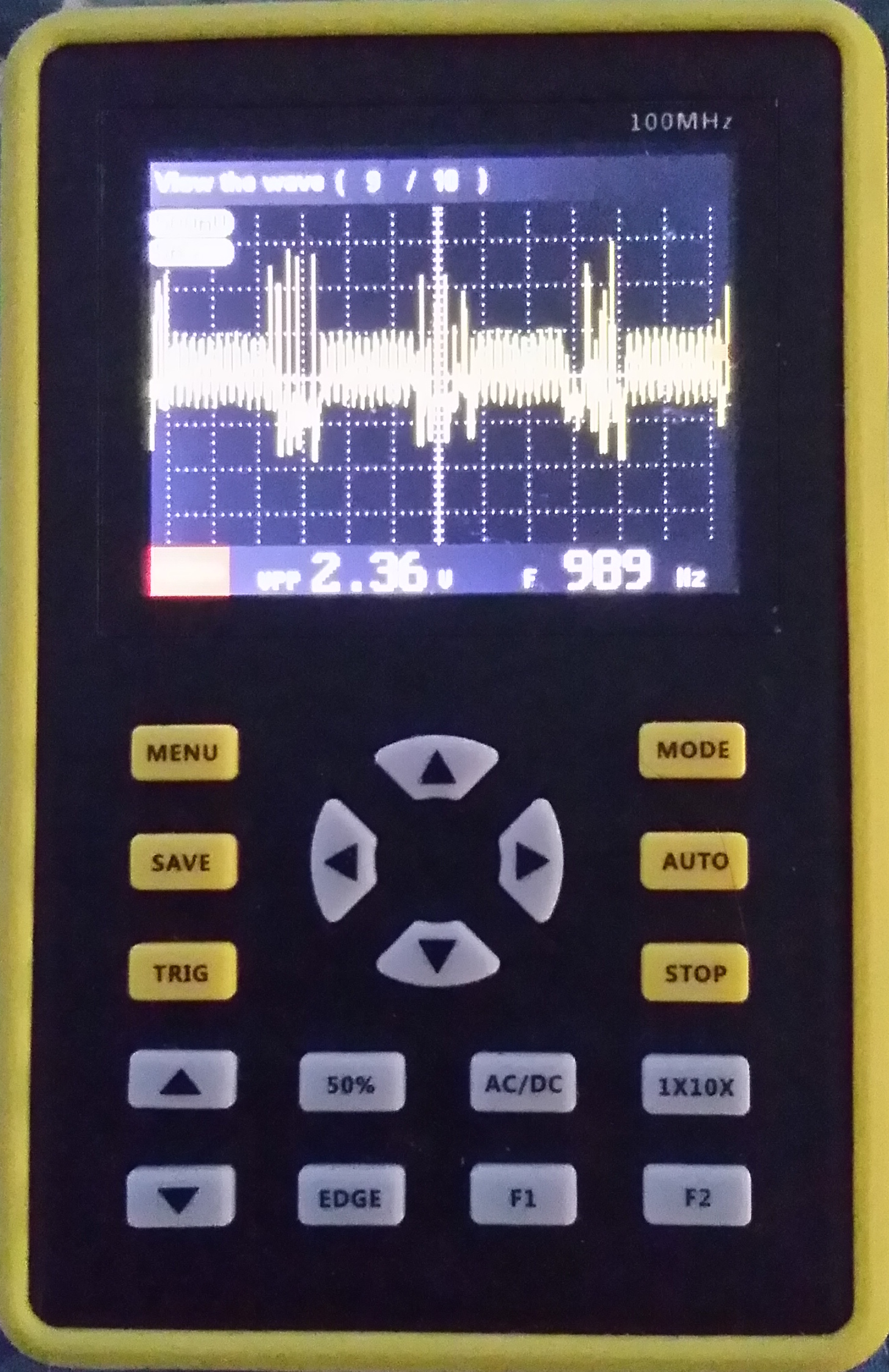

            Re: Crown Amp DC300A - One channel distirted, other good.
            with a 1khz tone input, looked at channel one. Maybe hard to see but it shows about a 1v DC level out. The other channel shows a similar output but less DC, ~.25 maybe. I don't know what the "block of pulses", that appear regularly across / over top of the 1khz, are. There are similar ones on the other channel. They are somewhat gain dependent. If I turn the gain to full on, they disappear. Adjusting the gain, intermediately, has somewhat little impact on their magnitude. At full gain and having them not showing, if I push up the input volume, they reappear. I guess some sort of input level dependency somewhere maybe? It appears that the frequency inside the "burst" is about 2.4khz. I would think that it would be audible although maybe my ears ain't that good. Is this the "buzz"? I haven't tried any heating of components to see what the resulting waveform is when the heat appears to improve / remove the buzz, nor have I tried tracing the signal back to see where it originates.
              dc is generally clipping . maybe something is being overdriven .is the sinewave clean all the way through the circuit ?
              or it could be leakage i suppose .
              whats the dc offset like at idle no signal ?
                    my confusion continues even with simple signal checks along the circuit. I can see a "nice" 1khz at the gain output control going into the opamp. Check the outputs at pins 1 and 13, I don't see any 1khz but I do see the "block of pulses" as seen at the terminal output trace posted.... yet I hear the 1 khz tone plus the lower level "buzz". I am not sure why I can't see any 1khz in the trace at the output, perhaps a level issue or I don't know what I am looking at. The DC values at the opamp out is in line with the SM about 1.4v "nominal", depending on the volume / gain. The +/-10v for the opamp is there although I haven't verify its "condition" (ripple or otherwise).
