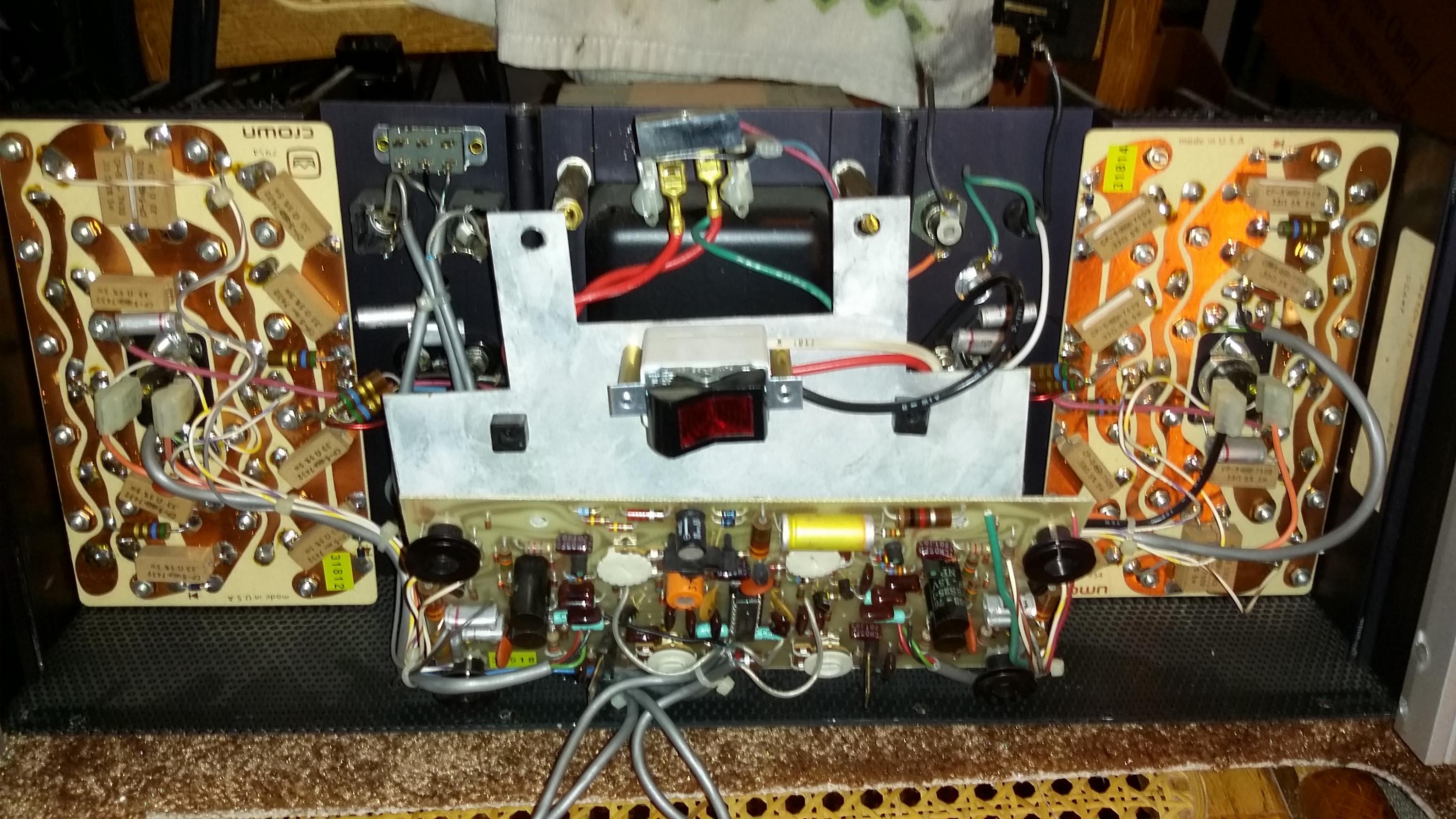

    Started taking it apart. Attached is the layout of the boards with the front panel removed and main control board "loosely mounted".
    Because the one channel works and other is distorted, I started checking all the resistor / capacitors (resistance reading) and comparing across sides of the output boards. The only significant difference that I could find was a resistance difference on a capacitor across the output terminals. On the good side, it reads resistively as 2.96k while on the bad side, it reads 3.97k. Its a .1 MF 200v Filmatic ITW. I don't have an ESR meter, just a regular DVM.
    I know that a resistance measurement of capacitor doesn't have much meaning / use but is that difference enough to indicate a bad cap. In "amp land", I don't even know what the purpose of the cap is going across the output terminals.... getting rid of high frequency noise?
    Any guidance on this thing would be greatly appreciated as I would love to get it working again as it deserves a better fate.

                Anyway, was able to power the unit up with the main board demounted so the access to the other boards is possible. Measured the two "rails" for each side. Basically, they were each about 61.75 / -61.75v (with some "drift"... up to .8) "unloaded" (ie. nothing connected to the input or output terminals). The nominal voltage for the rails is 60/-60v.
                It would appear that the rails are good.
                Doing some diode mode testing on the output boards didn't find any differences between the sides although without demounting the output transistors, it would not be possible to find an open circuit since they are connected in parallel. There were no shorts per se.
                I haven't done any testing on the main board yet. Looks like maybe the problem lies in the "pre section" of the main board for that side possibly although still wondering why such a big difference in the resistance measurement of the capacitor across the output for each side.

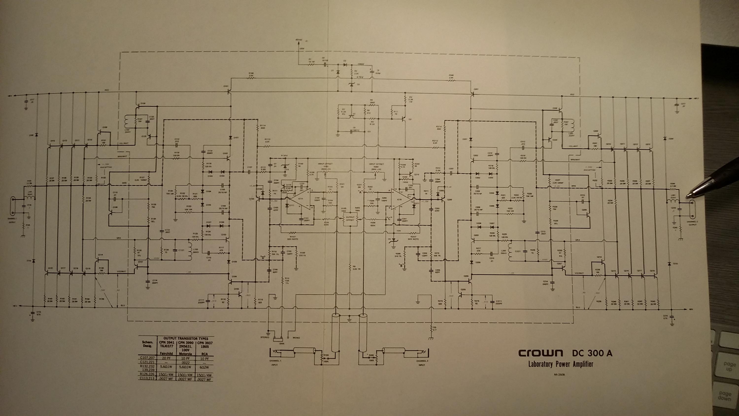

                  Attached is a schematic that I was able to dig up in my files.
                  One question that I have with respects to the capacitor across the output (c218 by the pen pointer), can I just remove / disconnect it without an operational issue for a brief test?
                  Crown assemblers must use some big soldering irons as everything has large solder points to attach to / heat up (ie. screw ends, terminal lugs, etc).

                    One of the quickest ways of troubleshooting just one bad channel is to feed the amp with the same, say, 1 kHz sine on both channels and then just working from either the inputs or the outputs, checking the signal shape on the good and comparing it to the bad.
                    I usually start from the outputs, because the higher the power, the more often it breaks.
                    Edit: Removing C218 might result in HF oscillation of the amplifier, but it probably won't.
