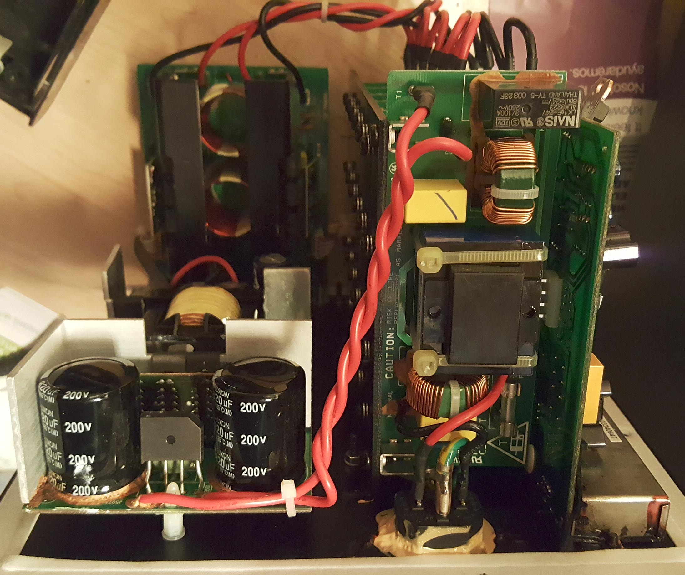

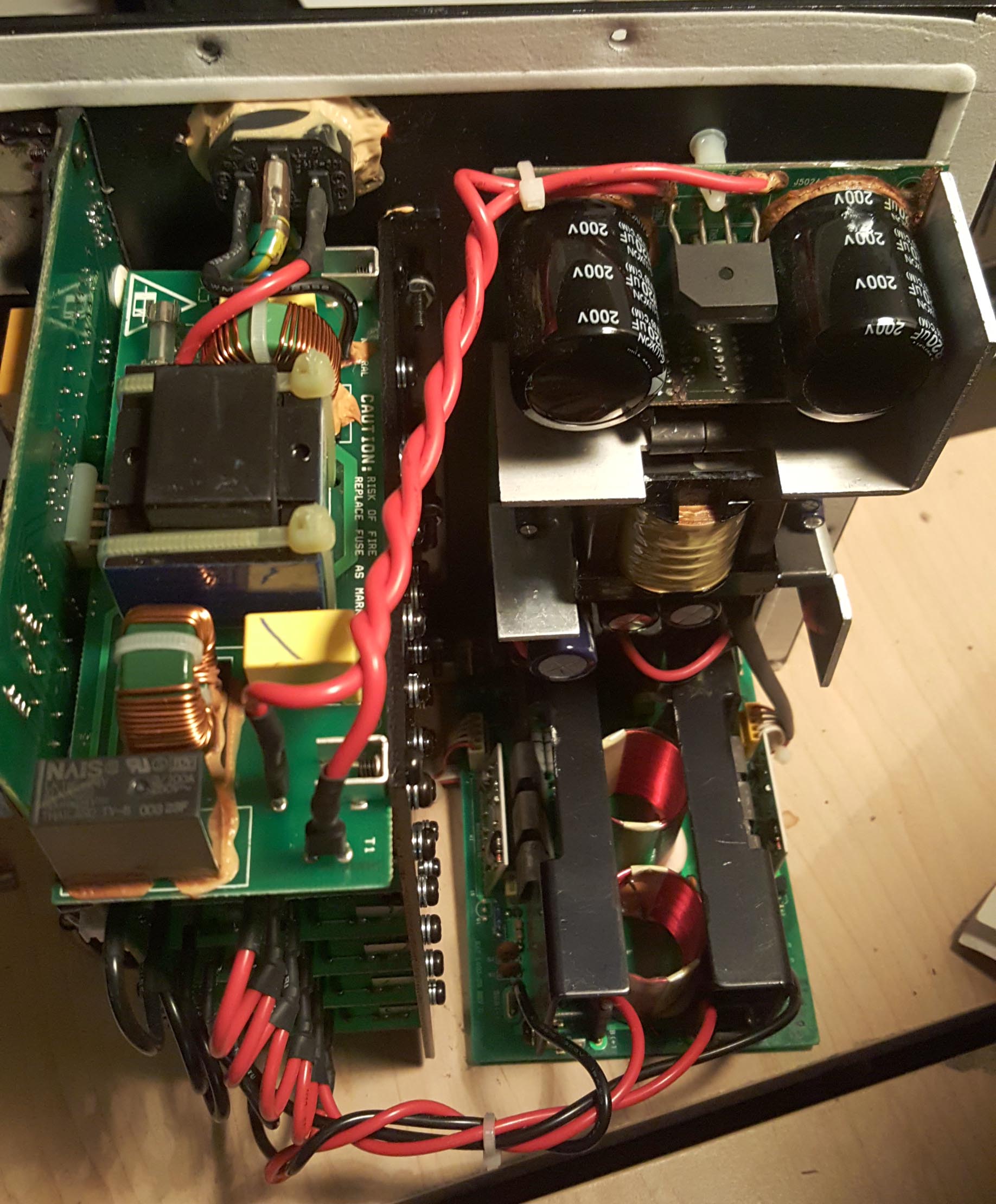

    Here is what my very untrained eye found:

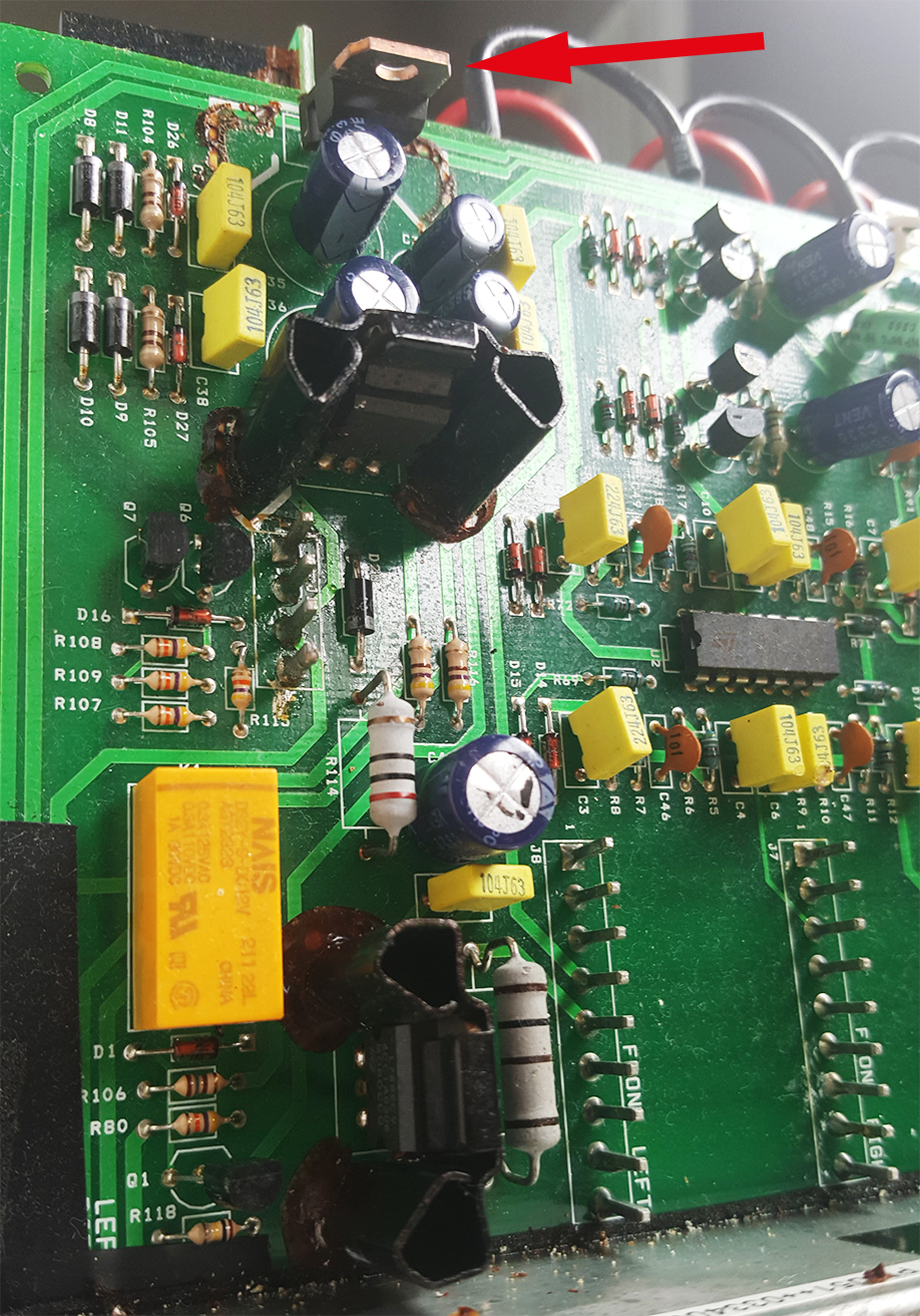

    FIRST THING I NOTICED
    I noticed there is a missing metal clip that was attached to 1 of these MOSFETS in the photo below. I found the metal heatsink in the subwoofer box, so I might be able to stick it on there with some thermal tape or something. Those three mosfets seem to be different however... The one that is missing the heatsink reads "ST 0248 MOROCCO TIP31C" and a google search lead me to THIS PAGE.
    So I guess it might have overheated and died somehow. I have a multimeter, but after watching a few youtube videos I am still not sure how to test it. Could someone explain how to do that?
    SECOND THING I NOTICED
    I looked at all the caps and one is clearly bulging. These are the biggest and seem to be 820uF 200V. The one next to it on the left doesn't seem to be bulging, but I guess might as well do both..?
    I have a multimeter, but don't know how to test CAPS. Could someone explain how to do that?

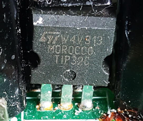

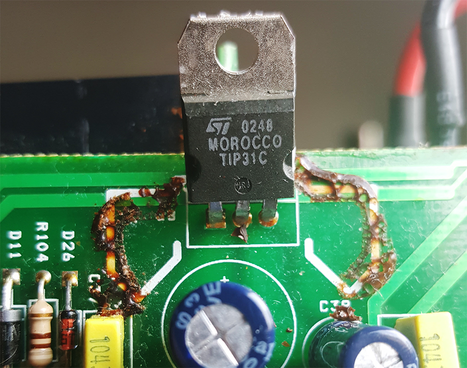

        Just before you replied I noticed that those 3 mosfets are different... oops! So I replaced the close up photo with one of the actual one that is missing the heatsink and I also edited my first post.
        It reads "ST 0248 MOROCCO TIP31C". ST seems to be the brand STMicroelectronics", not sure what 0248 means, MOROCCO might be where they make them I guess, and TIP31C seems to be the actual part. I found this http://www.mouser.com/ProductDetail/...FUKUfgodEQkJ6g
        Would you know how to test that part? If it makes a difference the multimeter I bought is this one: Craftsman 82141

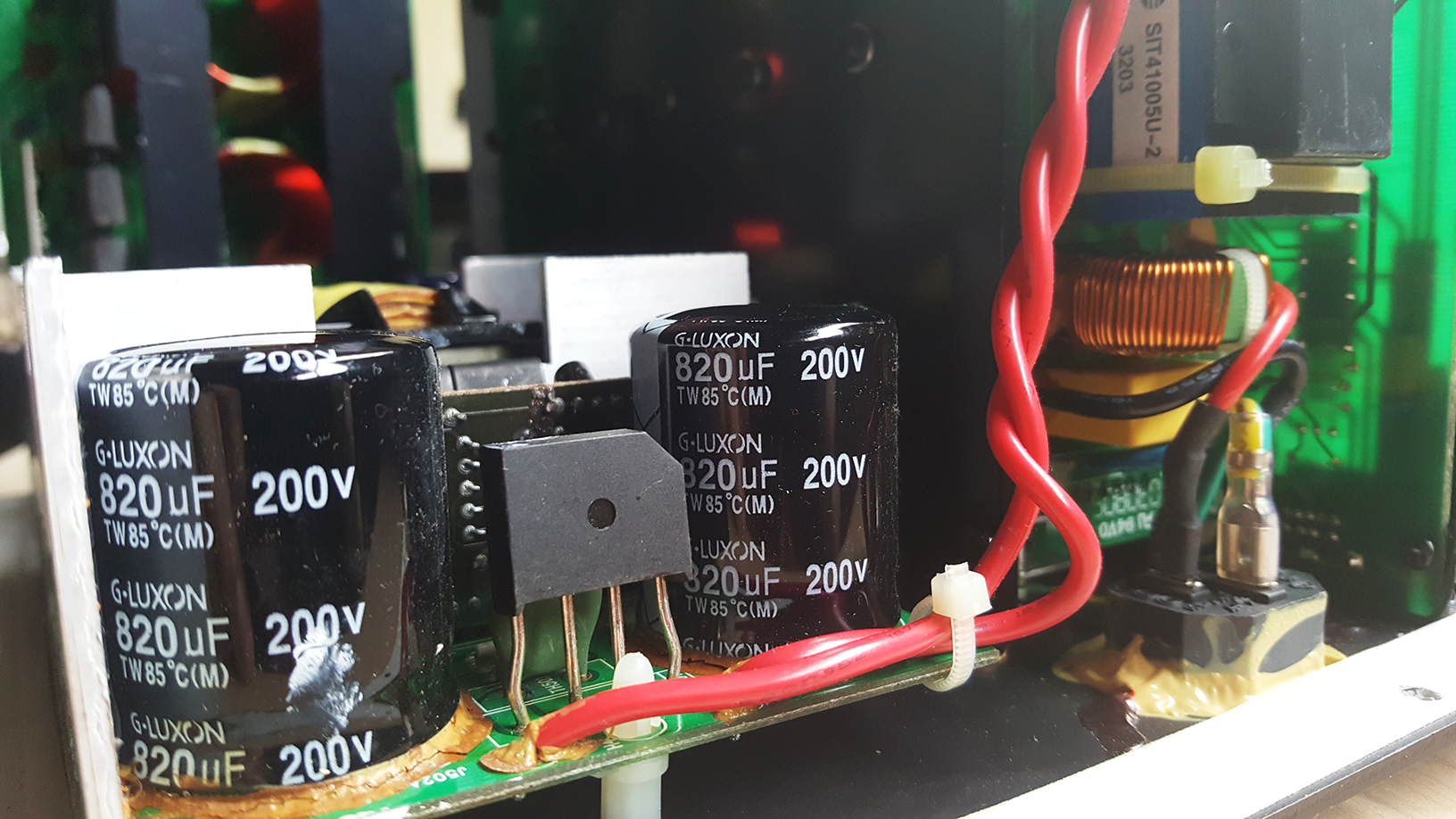

          Those big caps have a plastic sleeve on top. Sometimes, that plastic sleeve will warp with age and/or heat. Press firmly on the plastic sleeve of the bulged cap and see if it "gives in". If YES, then it's just the plastic sleeve that's warped and the cap may not be bulged. But if the plastic sleeve is hard, that cap is definitely bulged.
          I see those are G-Luxon brand, which is a brand not well regarded here... so yes, they could have failed.
          Loose metal parts falling from the circuit board - that's not good!
          Shame on you Klipsch!!
          Anyways, all goofiness aside, you can use regular PC thermal compound to create a good thermal transfer between the heatsink and the Transistor (it's actually not a MOSFET, but more on that in a bit). Then use glue to attach the heatsink to the PCB.
          And speaking of glue... your circuit board appears to have the dreaded tan glue that likes to go conductive when it turns brown with heat and age. So try to remove as much of it as you can from any components or traces you see it on.
          Yes, TIP31C is indeed the actual part number. ST is simply one of the many companies that makes them.
          That "MOSFET" is actually BJT (Bi-polar Junction Transistor). There are two types of BJTs: NPN and PNP. Your's is NPN.
          These you *can* test with a multimeter. To do that for a *NPN* BJT:
          1) Set multimeter to Diode / Continuity test mode (the setting with the diode symbol).
          2) Put the red (+) multimeter probe on the BJT's Base pin and the black (-) multimeter probe on Emitter pin. You should get a reading of 500 to 800 mV (or 0.5 to 0.8 V.)
          3) Now move the black (-) multimeter probe to the Collector pin. You should get a reading of 500 to 800 mV (or 0.50 to 0.80 V) again.
          If you ever need to test a PNP BJT, simply reverse the multimeter probes. (That is, put red probe where you had black probe and put black probe where you had red. Readings should be the same.)
          Since you are beginning to learn how to test these, I encourage you to post your reading here so we can verify your results.
          Note that this test above is only valid for when the BJT is removed from the circuit. When testing in circuit (you CAN), note that the reading may be slightly *lower*. But in any case, you should never get a reading much higher than those listed above and if you get a short-circuit (audible beep or less than 100-ish mV / 0.10 V), then remove the BJT and test out of circuit again. Also, when out of circuit, you should *never* get any reading on your multimeter between Collector and Emitter pins, regardless of which way you have the probes.
            Clearly bulged. The one on the left feels and looks pretty flat... but I guess might as well swap both since they are not well regarded.

            1) I am not sure which is the flat side of this BJT, but I am assuming the "flat" side is supposed to be the one attached to the metal plate with a hole.
            2) I got a reading of 540
            3) I got a reading of 895

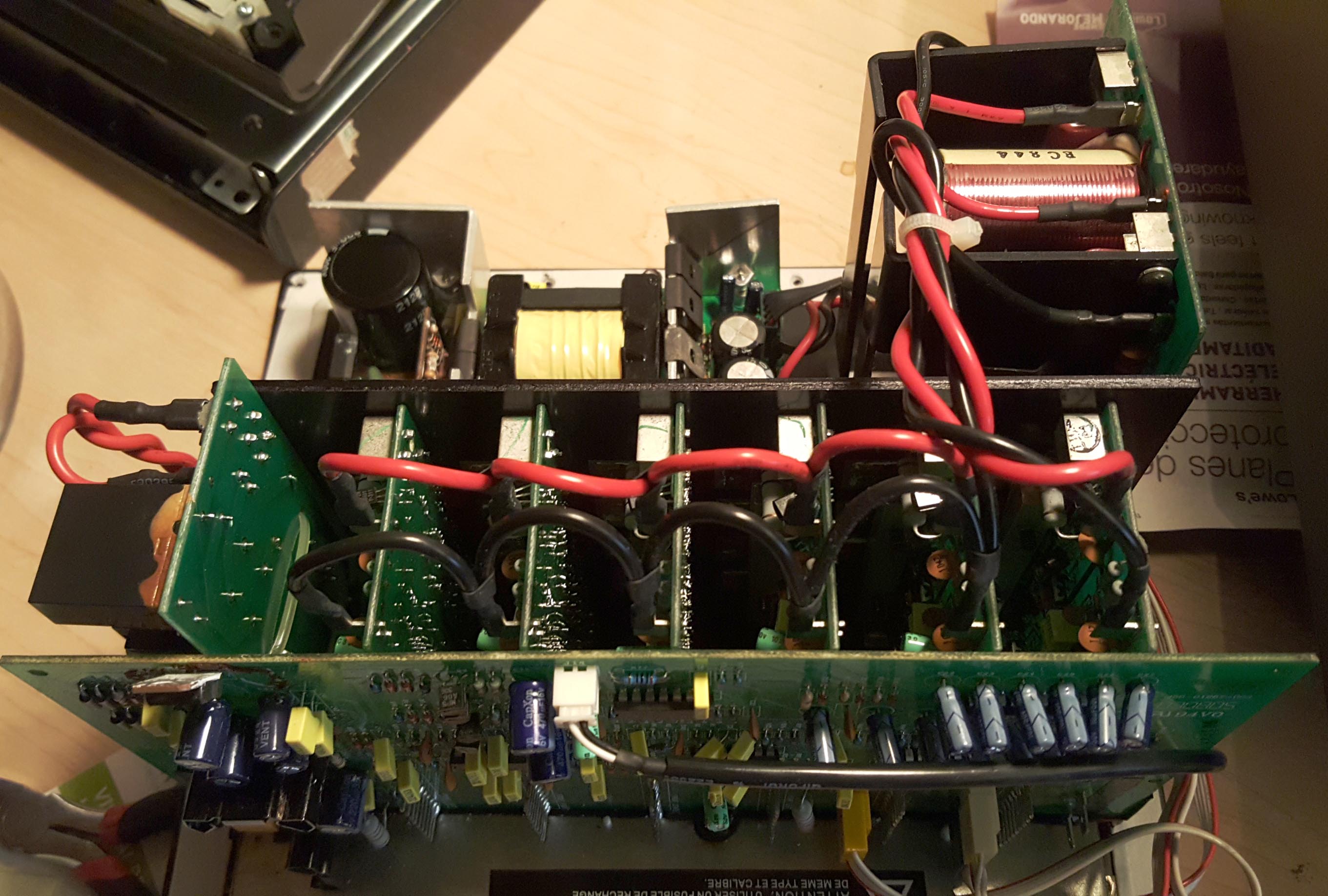

            Last but not least, please post some pictures if possible. In particular, post a top- and bottom-side pictures of each board. That way, we can see what is going on in the amplifier and how components and boards are connected.

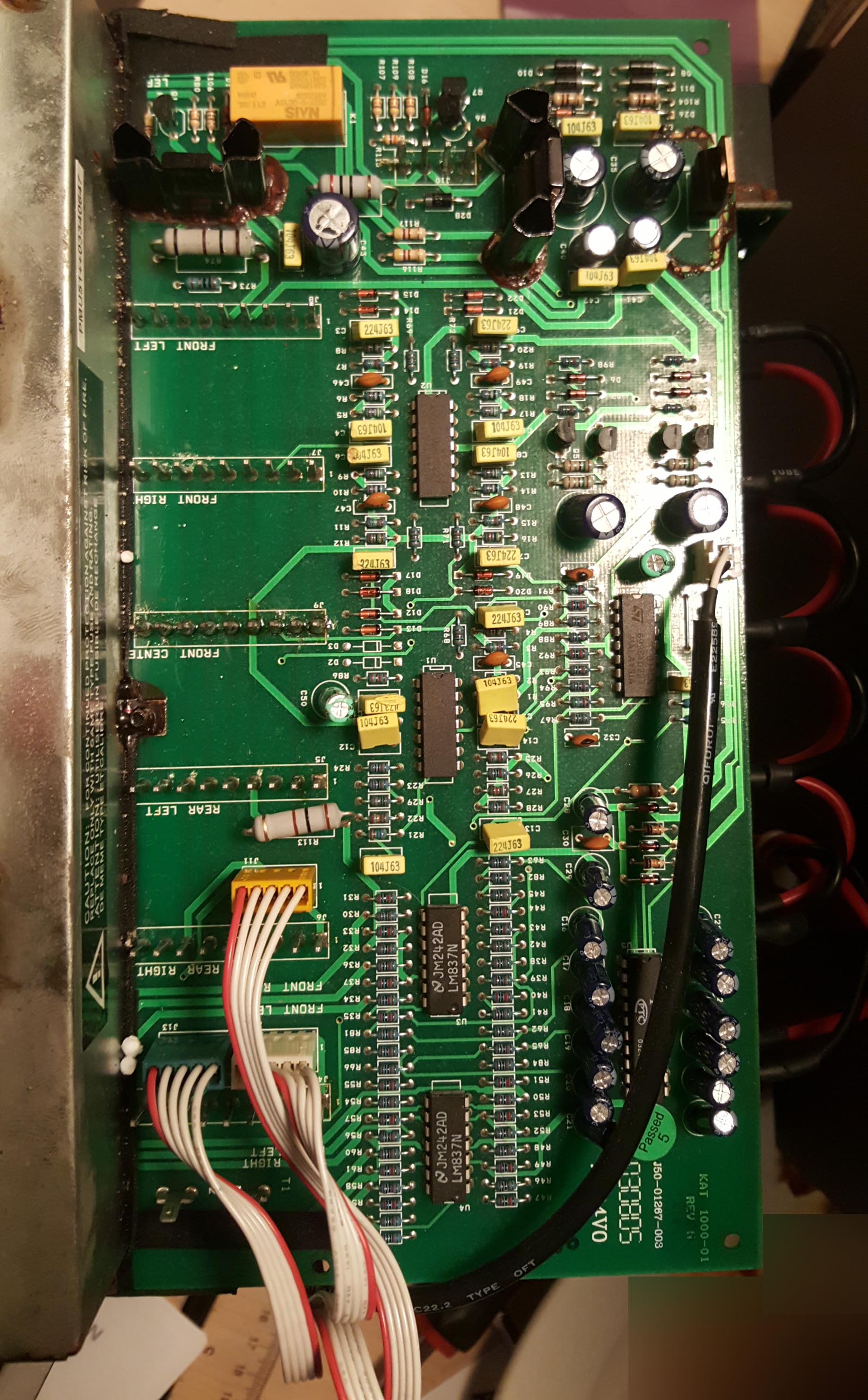

            I will shoot better photos during the day tomorrow, but here are three that will give you a rough idea.

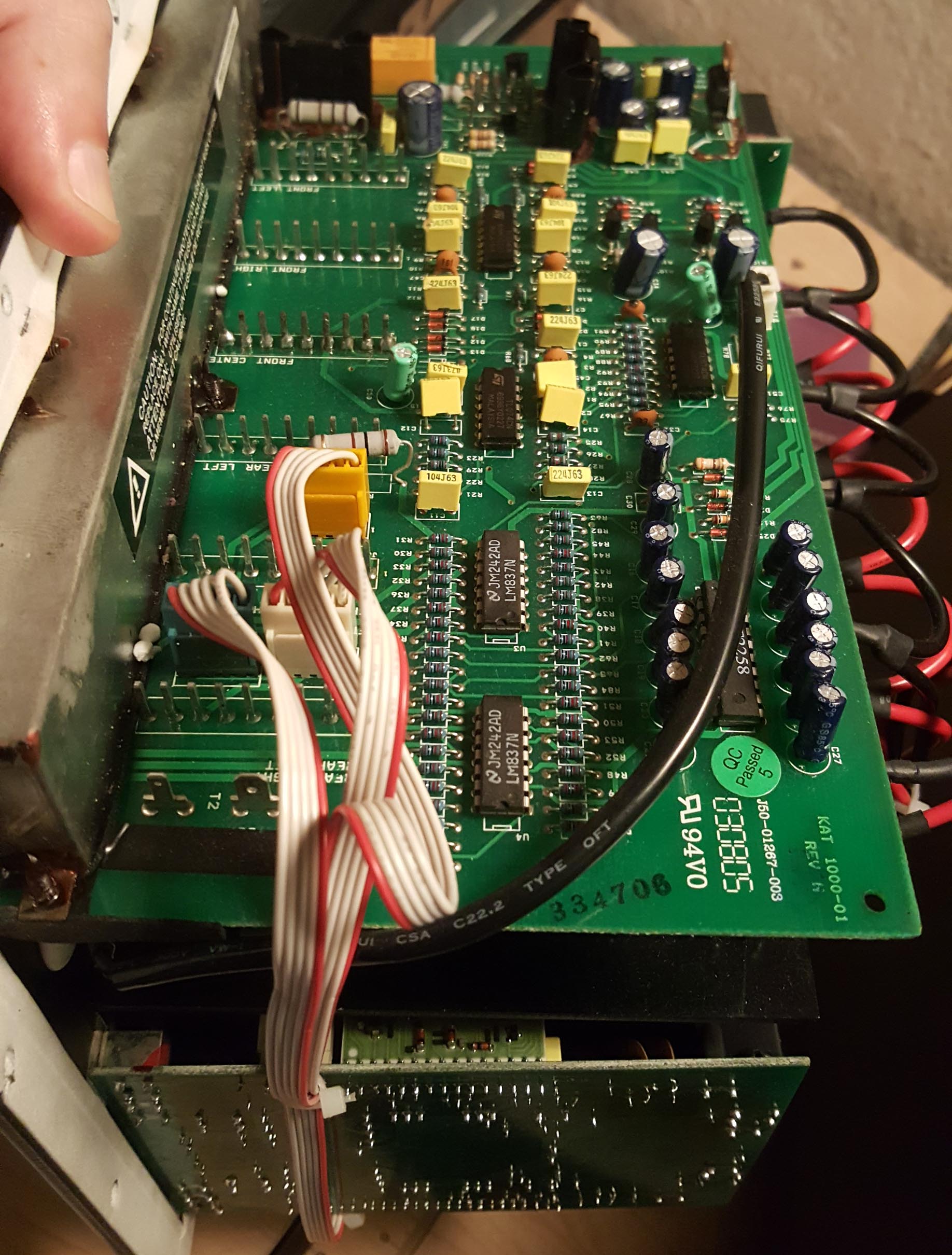

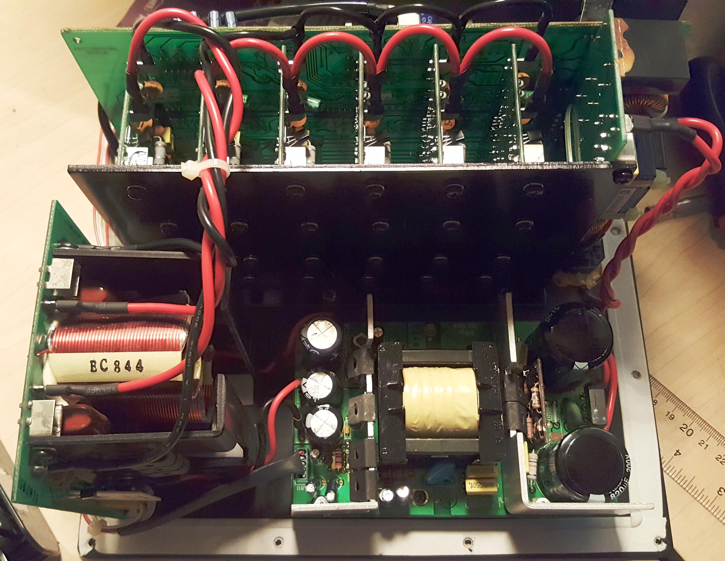

              Here's a few more

                That TIP31 Transistor and the one below it with heatsink are the setup as linear regulators to supply +/- regulated Voltages for the OP-AMPS.
                Just check the DCV on all 3 pins with ref to GND on both Transistors to see what you have.

                              Oh, I have been doing all of this with the unit off. I went to power it on (without any speakers plugged in) and I immediately heard a weird sound... hahahah. I think this was why I stopped using them, for fear they would blow up hahaha
                              Ok, so I am assuming you guys will have something to say about this new piece of information

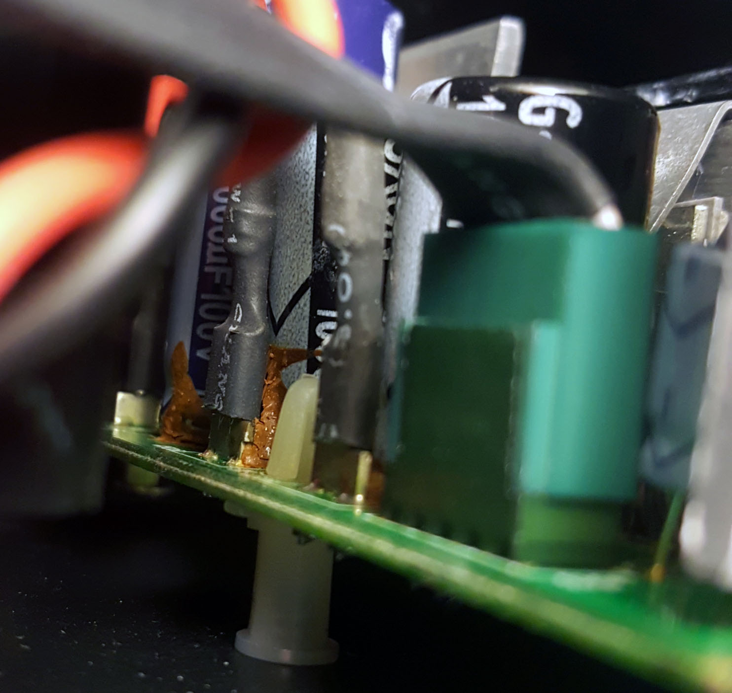

                                  Looking around I noticed quite a bit of that brown paste, which if it did turn conductive it could be connecting that cable and the cap against it.
                                  Could this be it?

                                    now for main board
                                    DB1 with rs606M due to 200amp max surge as opposed to 150amp of original
                                    C517/C518/C525 with 647-UKW2A470MPD
                                    C519/C520/C532 with 647-UKW2A220MED
                                    1000u 100v cap with 647-UKW2A102MHD
                                    1000u 63v (couldnt go bigger due to space) with 647-UKW1J102MHD
                                    R527 with 71-CPF3-J-4.7-E3
                                    R529 with 273-5.11K-RC
                                    (next to R529 unlabeled) with 71-RN70E6800F
                                    D5/D6 with 583-FR204-B
                                    Q510 with 863-2N5551RLRAG
                                    Q501/Q502 with 512-IRF740B
                                    D510 with 863-MUR1620CTG
                                    D504 with 863-MUR1660CTG
                                    U501 with 511-L7815CV
                                    U502 with 511-L7915CV
                                    R524 with 71-CCF02-J-47K

                                      You don't need to replace the glue, just remove it. It was put in by klipsch to keep everything in place during manufacture. Usually acetone will soften it so you can remove it easier. If you have a dental pick for removing it on wires and such a plastic scraper for on the boards.
                                      The lists you refer to are just what others used. It doesn't necessarily mean you need to replace those components. BudM will help you track down the problem you have. I was just trying to show that there are websites dedicated to this system which will give you clues as to how it operates and what components it has. Knowledge is power.
                                      sigpicThe Sky Is Falling
                                        Re: Klipsch ProMedia 5.1
                                        Something interesting here: Look to see if those two caps are on that audio processing board (the board with the missing heatsink I think that is what they are talking about).
                                        https://community.klipsch.com/index....ol-pod-or-amp/
                                        https://www.badcaps.net/forum/attach...5&d=1465898128
                                        You should also remove all those glues and see if the traces and the components legs are eaten away or damaged by the glues.
